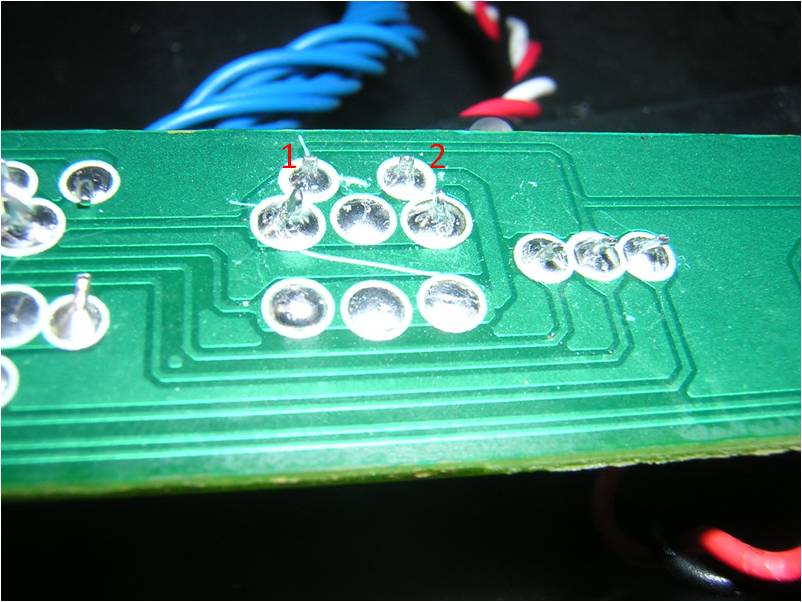

    See enclosed pic.
    Basically when the button is pushed you get a short between 1 and 2. But what i cant figure out is how the LED lights up? I would have thought that by pressing the button this would allow a voltage to go through to the led but i am thinking this is wwrong.
    Also, if anyone has a datasheet or ideas when i can get a replacement part (see enclosed pic).

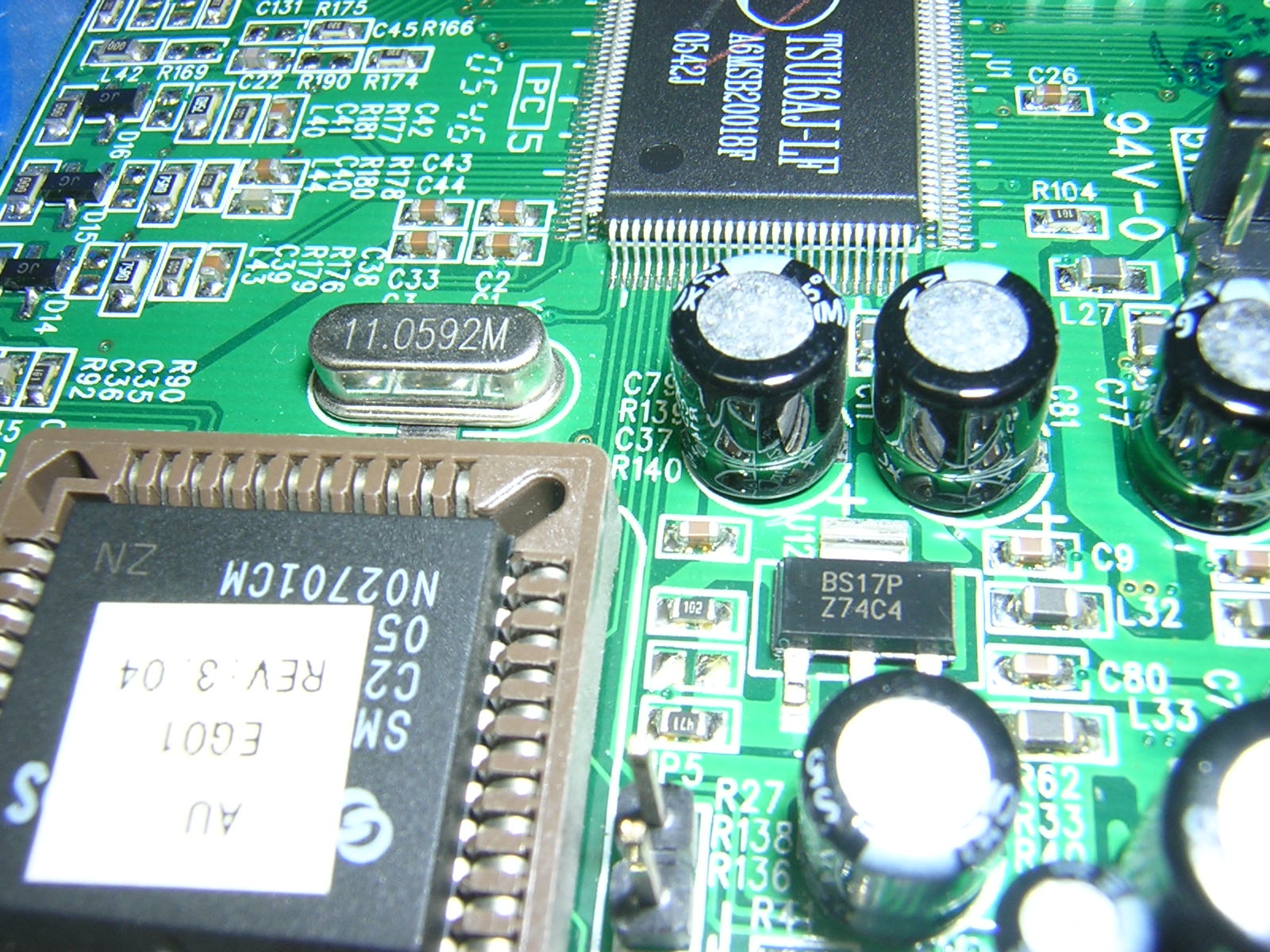

      note: replacement part i am looking for has the marking of "BS17P" on it.

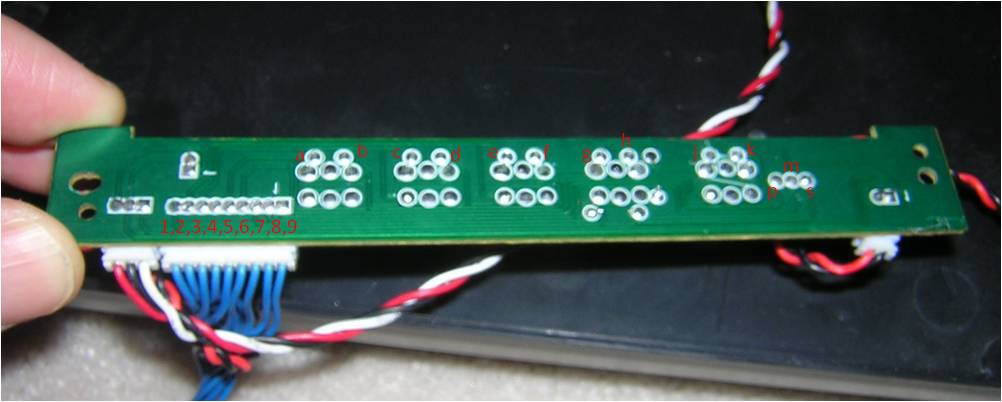

        I hooked up negative lead of voltmeter to a ground screw, The positive lead was used to probe each pin on the front panel switch

          I finally got around to making the measurements.
          See enclosed pic for reference.
          I may have changed the nomenclature for the pins sorry about that.
          Pin5 shorted/connected to "a"
          Pin8 shorted/connected to "b"
          Pin3 shorted/connected to "c"
          Pin8 shorted/connected to "d"
          Pin2 shorted/connected to "e"
          Pin8 shorted/connected to "f"
          Pin1 shorted/connected to "g"
          Pin8 shorted/connected to "h"
          Pin8 shorted/connected to "j"
          Pin6 shorted/connected to "k"
          Pin5 measured 5.06V
          Pin8 measured 0V
          Pin3 measured 5.06V
          Pin8 measured 0V
          Pin2 measured 5.06V
          Pin8 measured 0V
          Pin1 measured 5.06V
          Pin8 measured 0V
          "note how j and k are different than the other push buttons"
          Pin6 measured 5.06V
          Pin8 measured 0V
          Note: Pin 8 is connected to Pin "m" and is connected to the cathode of the LED. Not sure where the annode (pins "p" and "s") is connected.
          Not sure what all this means?

            So do you think if i replace the regulator this will correct the problem?

              All I can tell you is what I measured on my monitor that was working. Sometimes you have to take small steps to repair a problem.
              Did you ever find the pin on the front panel switch with 2.1volts that should change from a high voltage to a low voltage as the power button is pushed?

                  I don't know of anything else for you to check, If you don't see 2.1v on
                  pin 11, I think the problem is on the logic board
