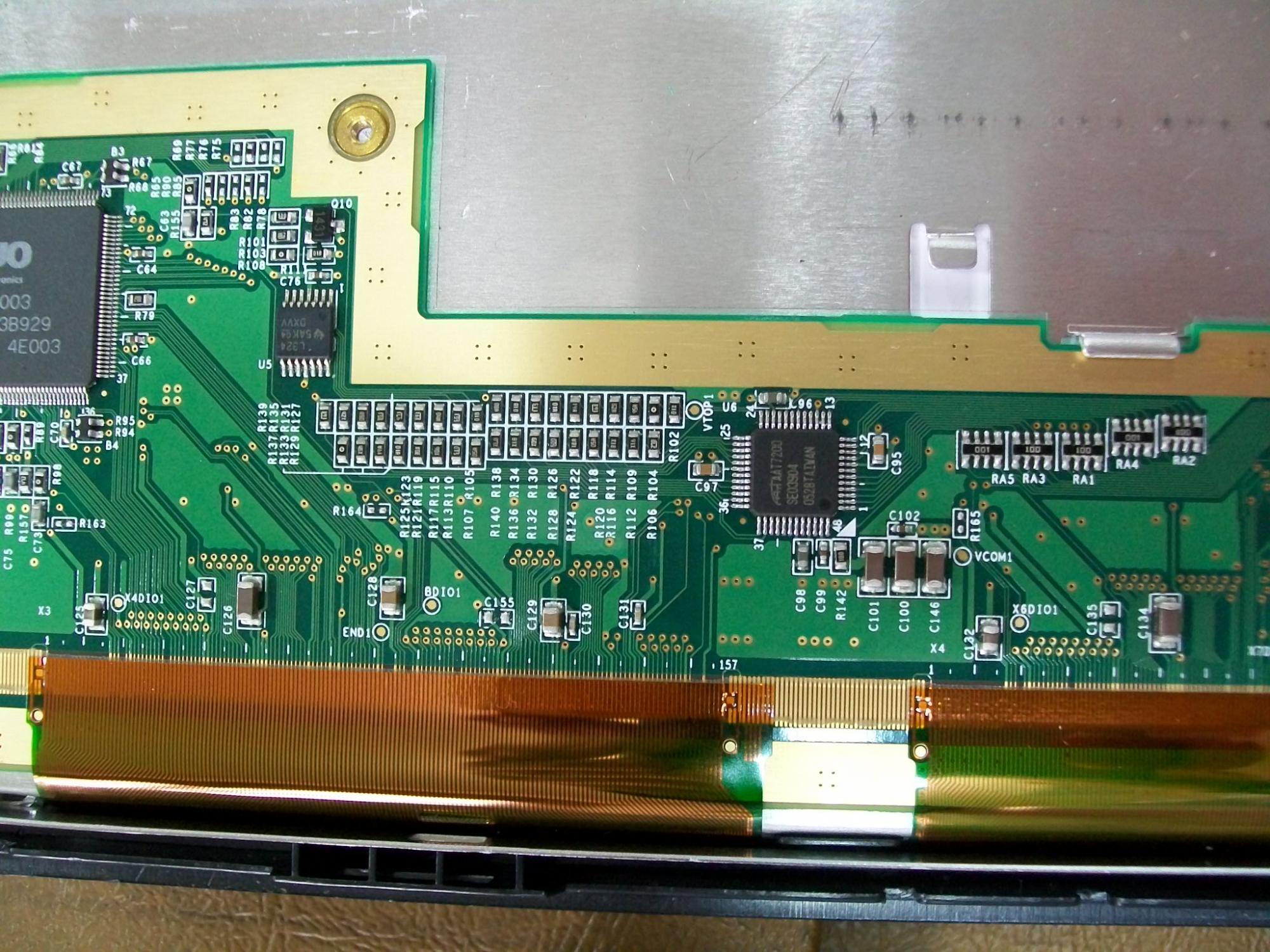

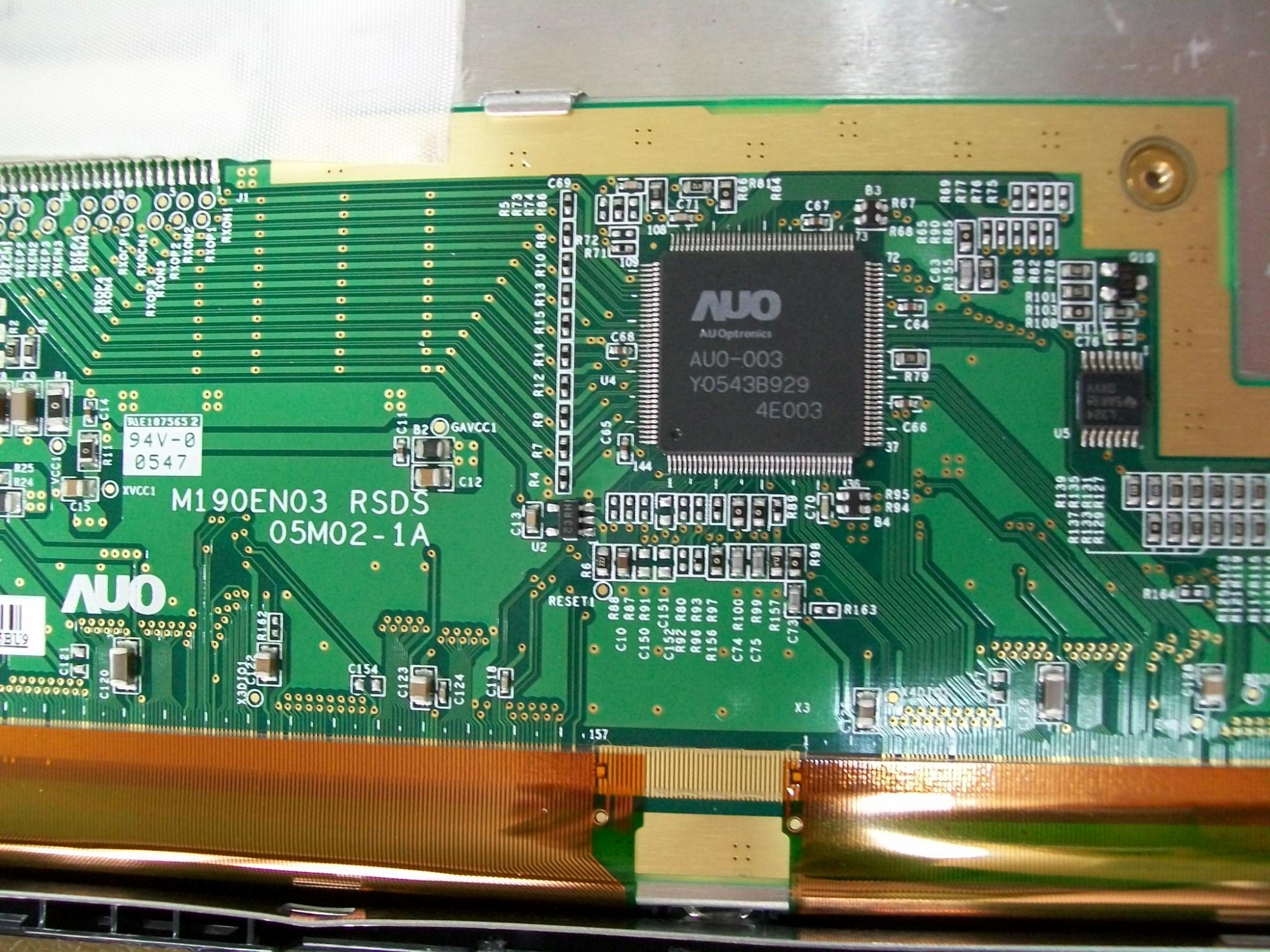

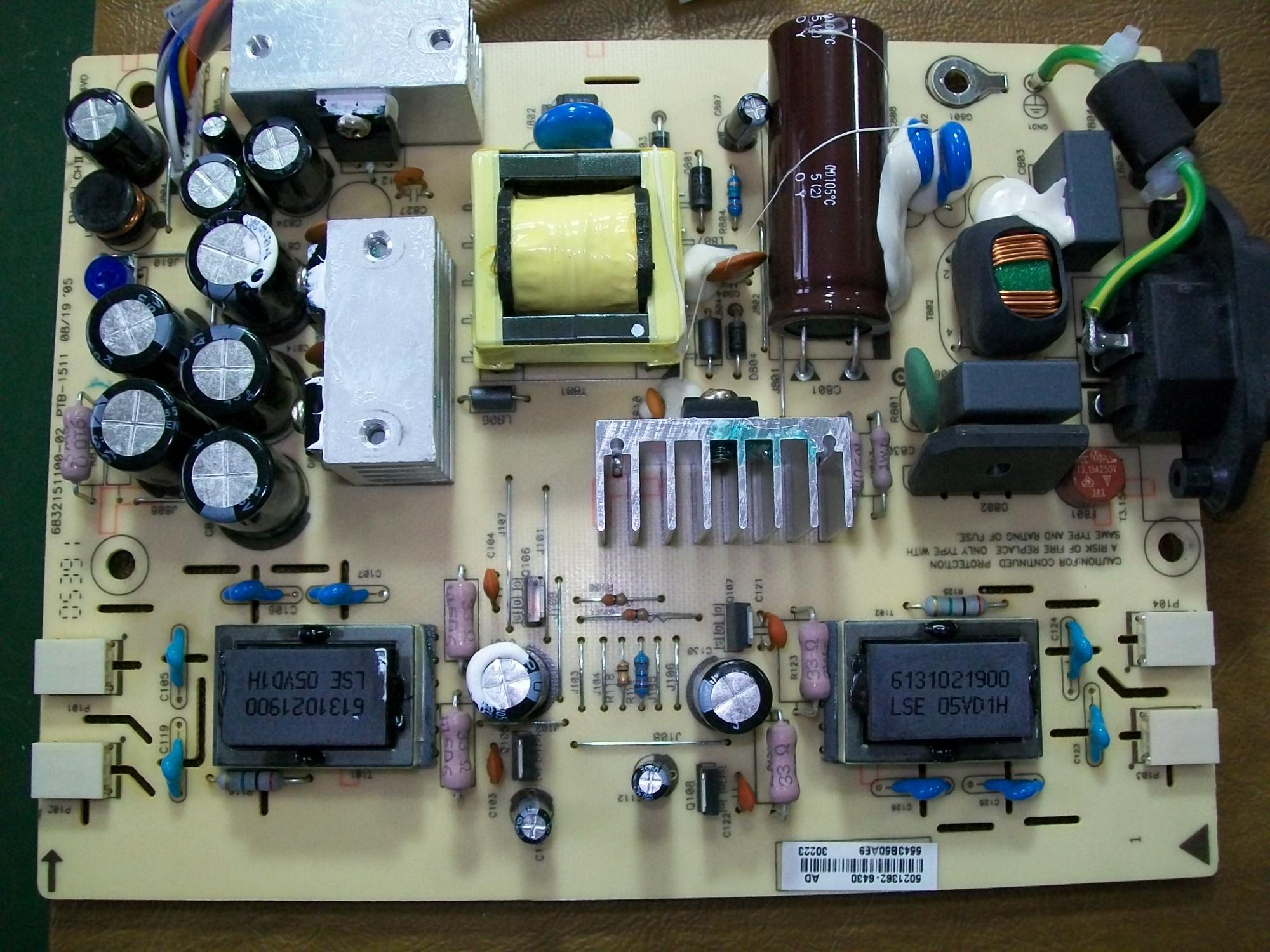

    This LCD will power on and the power button stays green as normal at all times when the the panel is turned on. When turned on the diagnostics screen displays for about 1.5 seconds then it goes dark. I have swapped a known good inverter in the panel and it performs the same way. I have not seen any caps that look abnormal on any of the boards. When I shine a light on the panel after it has gone dark, but is still powered up, but I do not see any image.
    I have not been able to see if all of the lamps are coming on when the diagnostic display is working. I do not have an easy way to see the lamps turn on or swap them out. That is the direction I am headed next, but I am running out of ideas and would appreciate any help on other things to try. I do not have any other boards to swap with. The know good inverter I used just happened to be the same board as used in a good 1704FP.

    Post pics of the top/bottom of both the power supply, inverter (if separate) and logic/main board (use "Manage Attachments" instead of linking inline, please). There is a treasure trove of information and test methods in this forum if you search for "two seconds to black".
      Re: Dell 1905FP Powers on then black
      Here are the pictures. I could not see an image once it went to black, even with a flashlight. The information that I find at about this LCD refer to the power and inverter as one board, but I believe that works, since a know good board gave the same performance. I have included several pictures of a board that is the width of the panel and therefore too long to get one good picture. Getting to the lamps looks intimidating. Thanks.

          Fairly easy test. Note the cable from the IPS (Inverter / Power Supply) to the logic card. The two wires closest to the middle of the board appear to be white and gray. Does the voltage on these two pins change when the CCFLs go off?

                Well, I wasn't real clear, was I? I was referring to the pins at the IPS, no biggie. The signal I am interested in is BKLT En. That should go high (> 3 Volts) to turn the backlights on. If it stays high when the backlights go off, the problem is either with the CCFLs or the IPS. Since you have tried a known good IPS, the conclusion would be the problem is the CCFLs or the wiring to them.

                                    Plain Bill suggested you check the BKLT EN Voltage between the pin and any of the GND on the same plug..... and does it change etc ??we may be able to help more if you can give the resut of that test.
                                      That voltage reads 3.25 when the panel is turned on and the backlights light up and then drops to zero in two seconds.
                                        Under magnification that bklt en pin looks like a bad solder joint. I am not very good at soldering but the joint looks corroded and I can see what I would call copper traces in the board coming from that joint that are exposed. Possible has gotten hot. Could this just be a cold solder joint that is my problem?
