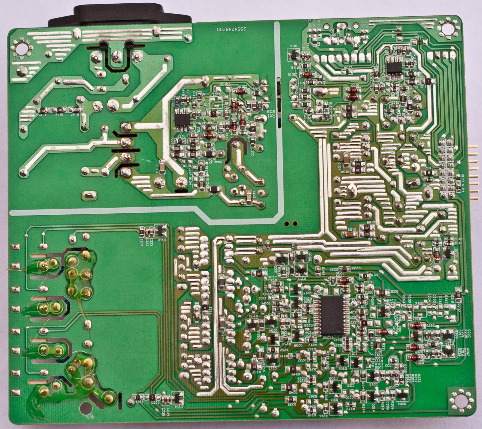

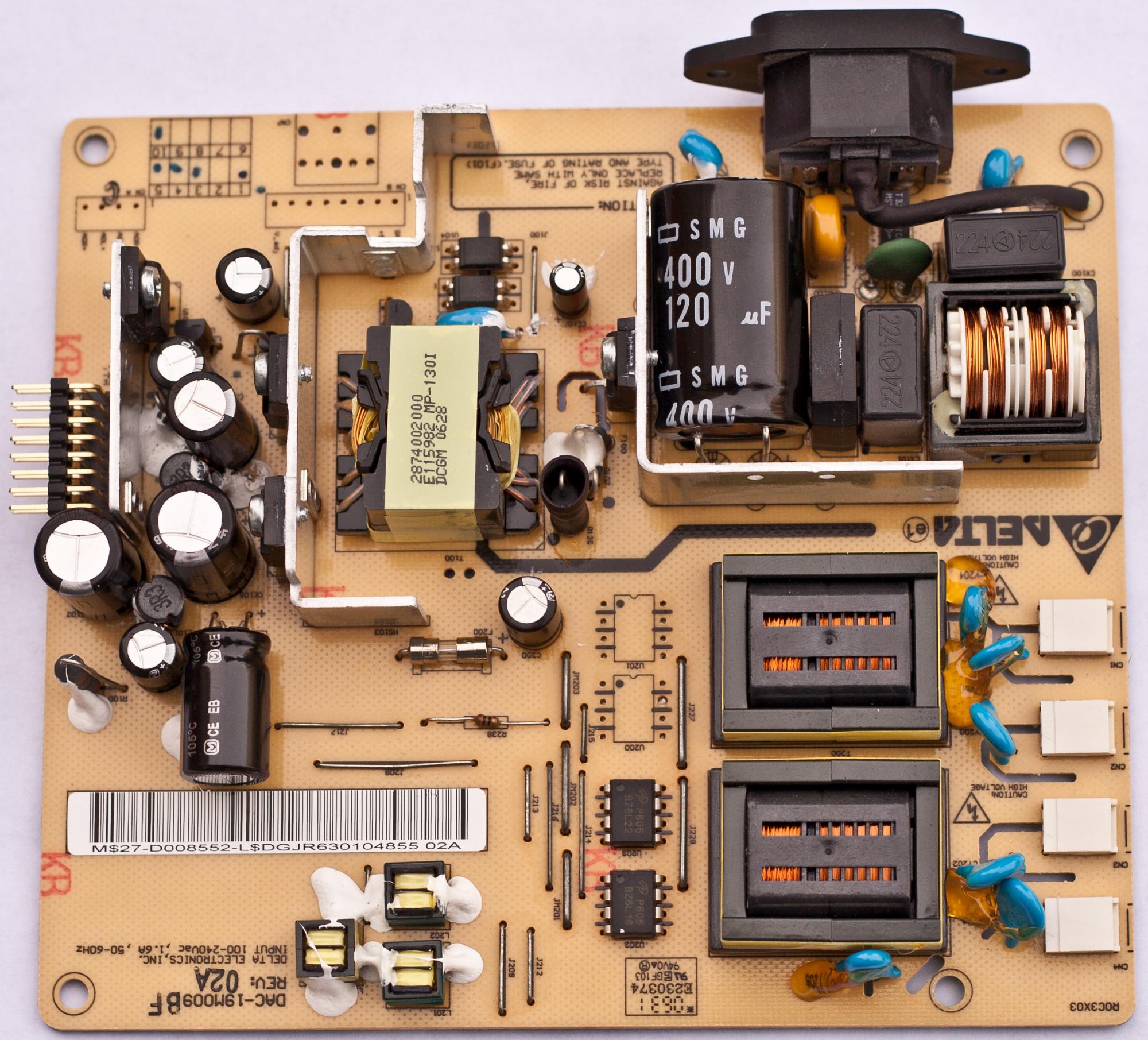

    Hi I am new to badcaps and electronic repair in general. I have a LCM-22w2 and like most others the screen will turn on for about 1 second then the back light turns off. I have replaced ALL of the caps on the yellow power board and the bridge rectifier to no avail. I am still having the same problem. Does anyone have any other possible solutions that I should look at?

    Please provide front and back pictures of your boards.

                  OK. Sorry for the delay but I got busy with real work and put this on the back burner. So I just replaced all the capacitors with Panasonic FM except for the 400v 120uf that I left the original in. Still have the same problem, also I confirmed that I can see the screen when I put a light on it. reiredcaps I looked over your thread and its a little to much for me. I am very new with this stuff. Does anyone know what the second most common problem is after replacing the caps?

                    Since you're getting a second or two of the backlights coming on, that would indicate that the inverter circuit is getting it's 12-14V. The problem could be caused by a shorted inverter transformer winding, bad CCFL wiring or a bad CCFL tube.
                      Re: Westinghouse LCM-22W2, Same symptom different solution.
                      OK so I have narrowed down the problem to a ccfl tube not lighting. I saw someone say that if you don't have an extra tube to plug each one in by it self and see if it turns on and shuts off and if you find one that does not turn on then you found the bad one. Well sure enough one does not turn on. Also another one makes some noise and kind of flashes before it goes out. Is that one bad too? Now I need to know if its the tube or the wire. How can I go about doing that?
