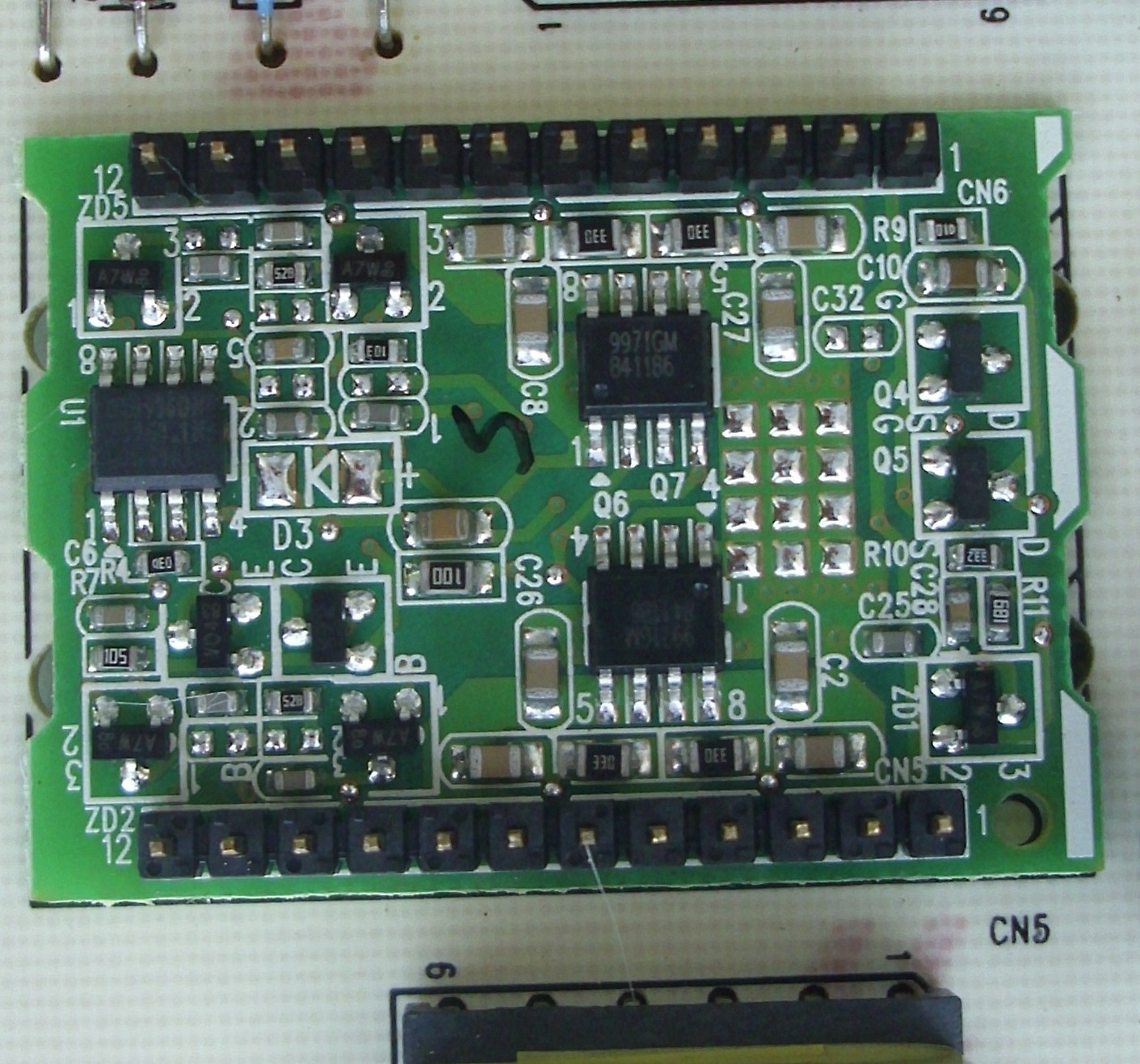

    U1 is an oz59360n. The two other 8 leg chips are 9971gm mosfets.

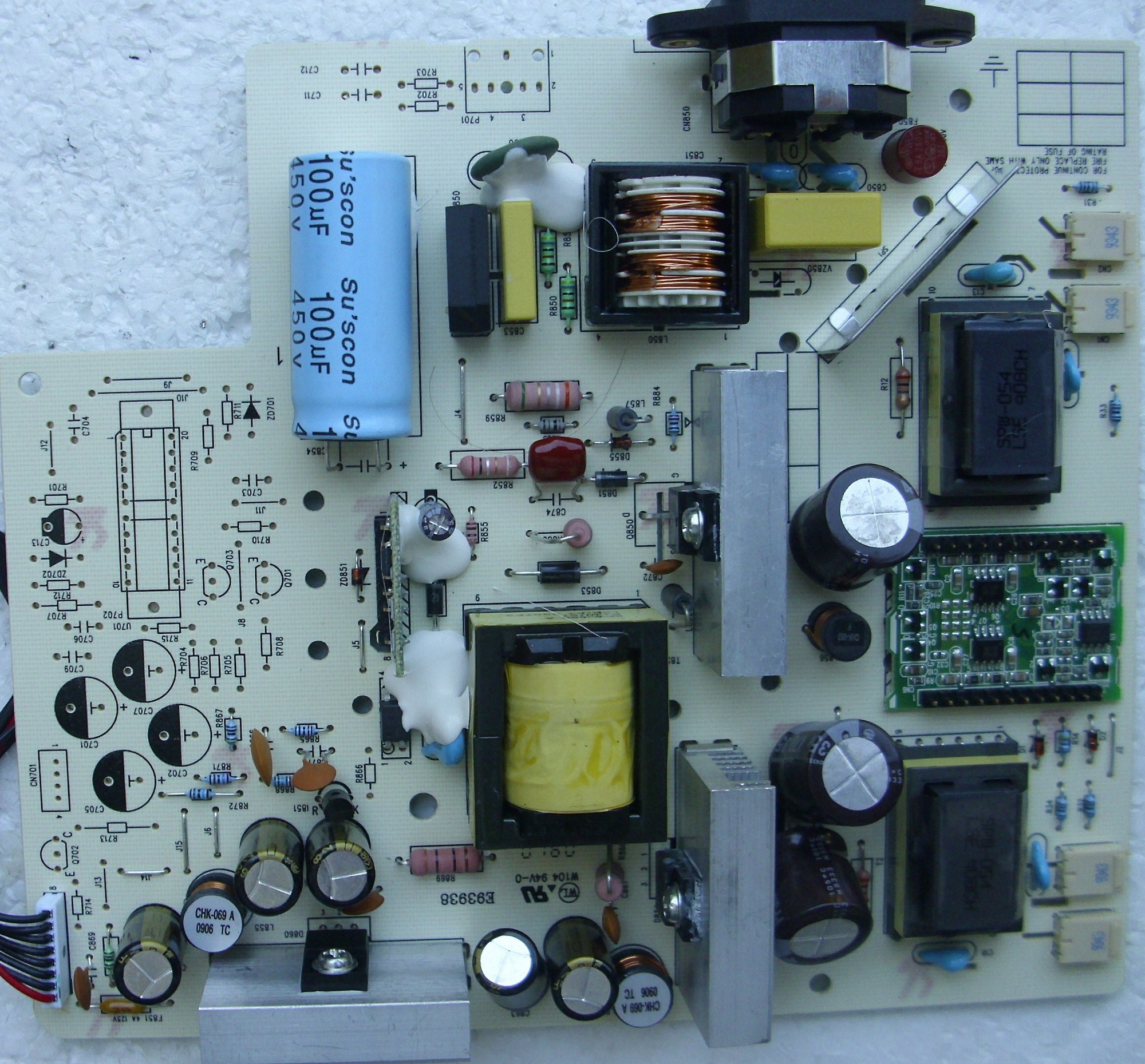

            I need some help on this one.
            When the back lamps are working on this monitor measuring the voltage at the drains of ap9971 mosfet I read 1.63v I also read a similar voltage at pins 1 and 8 at the oz controller, little bit higher 1.72v.
            When the back lights go off the voltages of both the mosfet drain and the controller pin 1 and 8 voltages go to 0v indicating no current flow.
            My questions is if the oz controller is not providing a ground to the mosfet shouldn't I be reading whatever the source voltage is at the drain of the mosfet?

              When I measured the voltages on the return lines of the ccfls on this monitor there was a big difference in them. And when measuring current flow of the ccfls the readings I am getting are in U.A. or micro amps.#1 is reading 3.50UA #2 is 6.28UA #3 is 3.23UuA and #4 is 4.20 UA.
              With the ammeter not connected this monitor will run about 2 hours until back light failure occurs, When I have the ammeter hooked up to the #1 ccfl its has the classic 2 second to black problem, when I test the other 3 ccfls with the ammeter connected the lamps stay on [no 2 sec problem].when I change the positions of the ccfls on connector from one to two the 2 sec problem occurs only when the ammeter is connected to ccfl connector #1
              I am wondering if this monitor may have more than one problem, Like something wrong with the over or under voltage protection of the inverter and possibly a bad ccfl or maybe one of the poly caps in the inverter area?

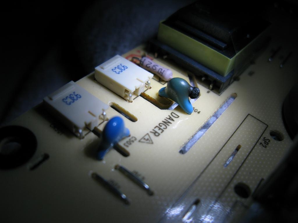

                  I got thinking about the poly caps in the inverter area as may be causing a problem, I have no way to measure them but the markings on them are 12j 3kv and n3 3kv.
                  I searched n3 3kv and got some hits on these two capacitors being used together and some have been causing problems, No one could identify the cap n3 3kv.
                  I searched my spare parts and found two 22j 3kv, and tried them on the inverter in the area of ccfl connector #1 and#2 and it is causing a two sec to black problem immediately after powering on the monitor. I wonder if I might be on to something with the poly caps?
                  Does anyone know the value of the cap that's marked with the 3n? And could raising the capacitance of the two poly caps caused the back light failure to occur sooner?

                    If these are the circular blue ones, they are ceramic caps. I've never seen the N3 3KV one go bad, but I've seen a couple 12J 3KV burn out. If they go bad, you'll immediately know because it'll be physically damaged (see attachment). The 12J 3KV is a 12 picofarad 3 kilovolt (as noted in this thread here on badcaps) but not sure what the n3 3kv might be.

                        When I was checking amperage draw on the ccfl circuits I could get what I thought was a more meaningful reading measuring in U.A. for amps. And when I had my ammeter hooked to the #1 ccfl connector the 2 sec. to black symptom occurred almost immediately on power up of the LCD ,I could test 2-3-and 4 circuits with no problem.
                        Last night I tried replacing caps c14 the n3 3kv and c13 the 12j 3kv with two 22j 3kv caps and a two sec black problem occurred almost immediately. I was able to find another 12j 3kv cap and I installed it position c13 and I reinstalled the n3 3kv back at c14.
                        Right now I am able to install my ammeter on the #1 connector and the 2 sec to black problem has gone away.
                        Also when measuring current flow of each of the other ccfls the amperage reading has gone up a little and appears more stable .The reading I am get in now is between .07ma and .08ma.On all the ccfls.
                        I will let you know what happens after about 3 hours of running the monitor.

                          • PlainBill
                            • Feb 2009
                            • 7034
                            Re: H.P. L1710 back lamps turning off
                            What is the part number of U1 on the daughter board?

                              After my first post I have purchased a better magnifying glass, I am coming up with a different number for u1.It reads
                              OZ5936GN
                              23963.1N
                              0849A1
                              I am unable to find a data sheet.

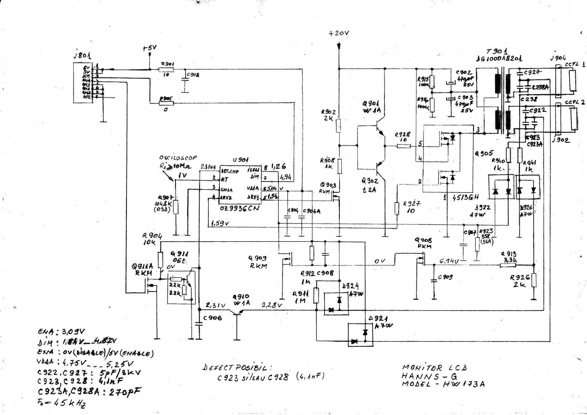

                                Maybe OZ9936GN? That's a legitimate part number, but I can't find a datasheet either.
                                PlainBill
                                • PlainBill
                                  • Feb 2009
                                  • 7034
                                  Here's a hand drawn schematic of an inverter using the OZ9936GN. It's crude, but should be enough to go on.
