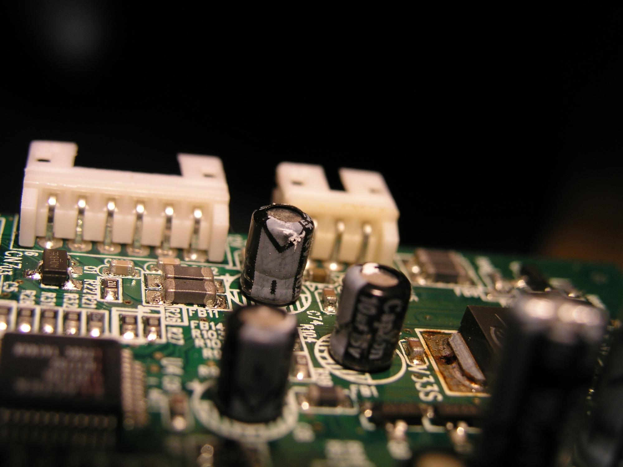

      OK. I've just found 3 dry caps (C603,606 and 707). Going to buy repair kit and replace all of them. Thanks to every body for your support.

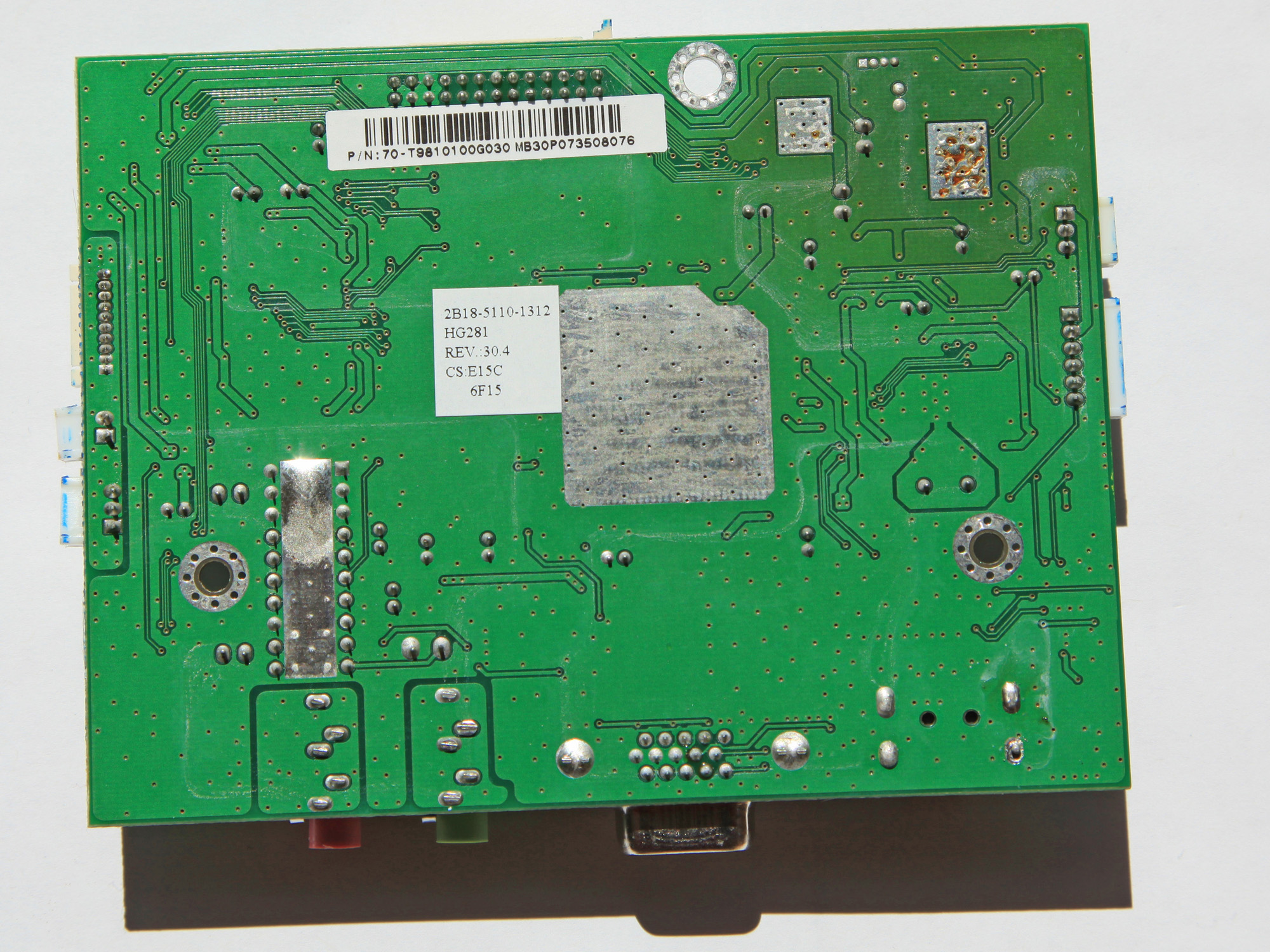

        I have taken the monitor apart and doubt that it is the inverter board.

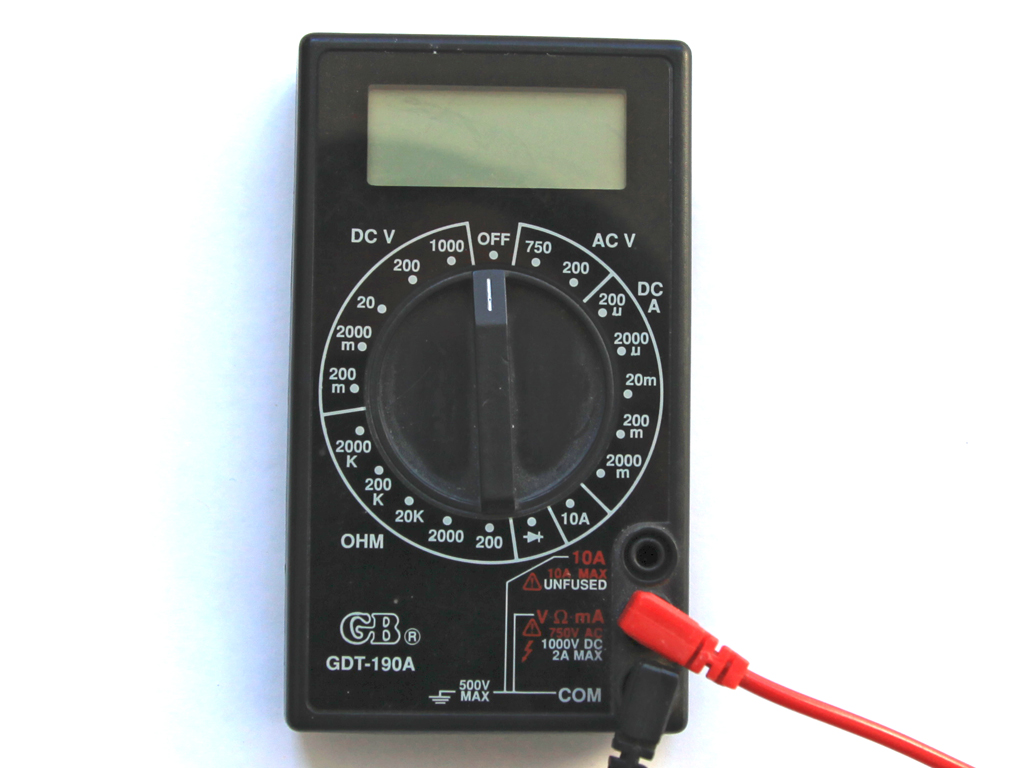

        1) Post clear focused 2000x2000 resolution pictures of YOUR boards using the manage attachments button. Please do not post inline.
        Using someone else's pictures is like asking a surgeon to operate on you using someone else's x-rays.
        2) Also post a picture of your multimeter.

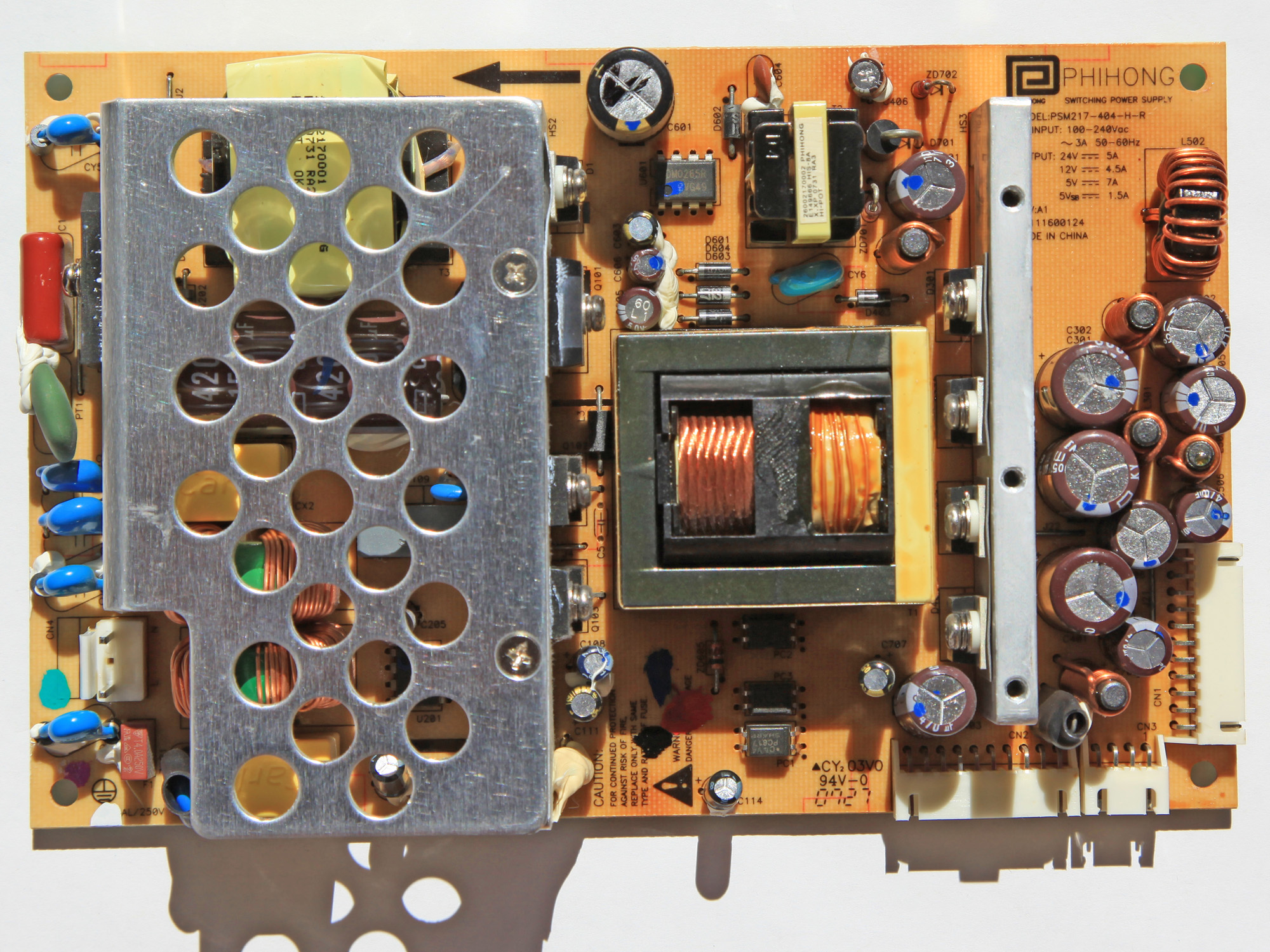

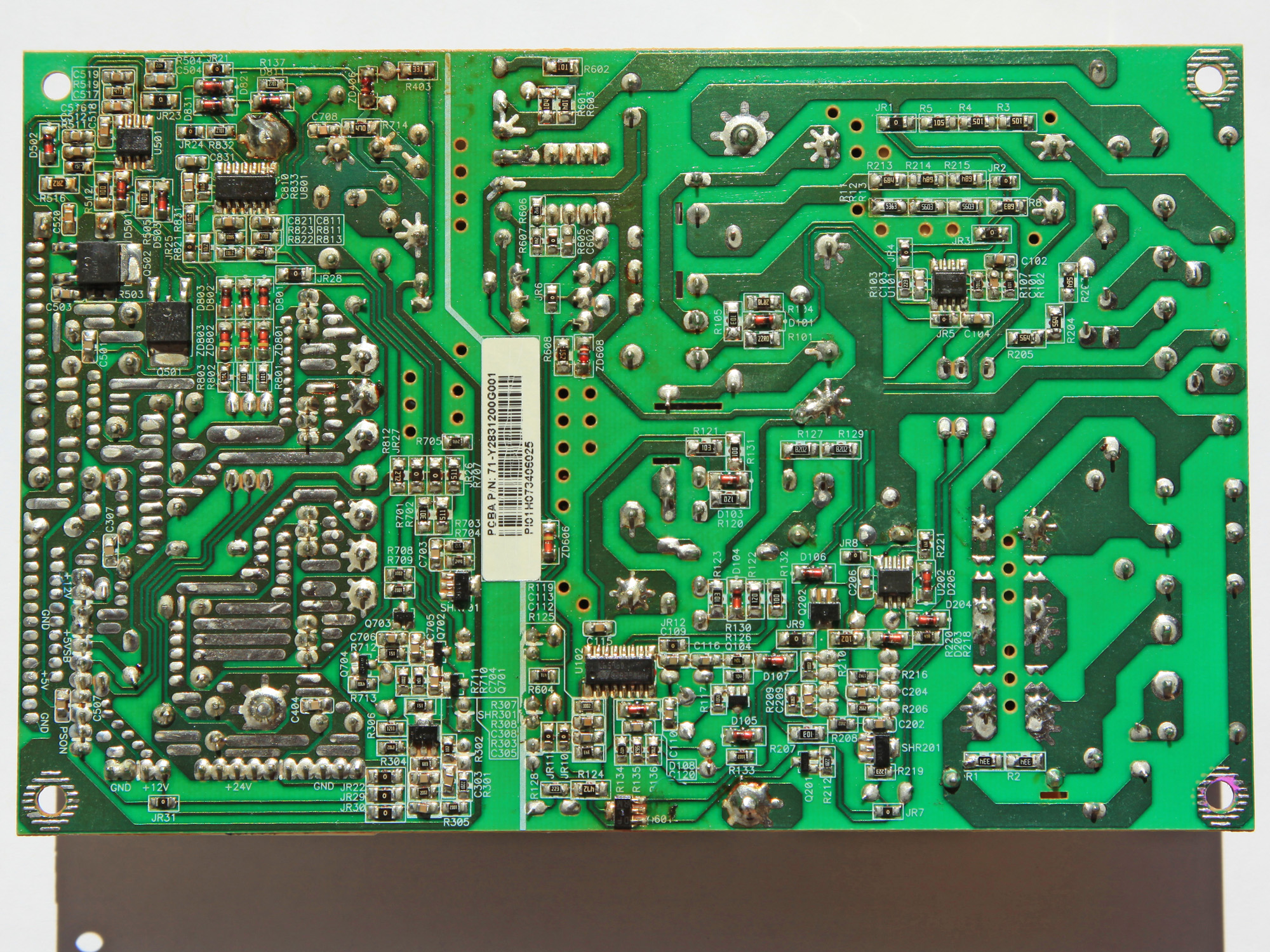

          Yes, perfectly understand. Attached please find the images and I hope they will be good enough to get you the info you will need.
          Thanks for responding - I really would love to have more electronics background. I hope we can get this puzzle solved.

              #66
              Re: Hanns-G HG281D, LCD Monitor no power
              1) Those are excellent clear focused pictures. It will be used a bit later.

              3) To use your multimeter, there is a written tutorial in addition to the youtube videos at

                    I've scanned your other posts and see no sign that you have replaced any capacitors. The symptoms you describe are consistent with bad capacitors (but could have other causes).

                      To expand on PlainBill's comments:
                      1) Capacitors (C designation on the PCB board) die from age, heat, and shoddy build quality. Capacitors DO NOT have to be visibly bloated in order to bad. They can be out of tolerance uF (a 1000uF measures 20uF) and/or have high ESR (ohm). A multimeter will be insufficient to test for ESR. For that you need an ESR tester which costs between $50 and $300.
                      2) Most members here will recommend that you replace ALL capacitors with reputable brands from reputable sellers. Brands like Rubycon, Panasonic, and United Chemicon are suggested. A list of recommended caps can be found at
                      https://www.badcaps.net/forum/showthread.php?t=2280
                      If you live in the USA, you can order capacitors from digikey.com and get them in 2 days for $2.75 shipping costs. Most here will recommend Panasonic FR/FM or FC caps. PlainBill has instructions at
                      https://www.badcaps.net/forum/showpo...33&postcount=2
                      3) What might be happening is that as the lcd starts to get warm, the ESR (ohms) of the capacitors drop enough to let the SMPS start properly.
                      One test you could do is to use a hair dryer to briefly warm up sections of the power board where the capacitors are. If the lcd starts and stays on, then you know it is likely the capacitors.

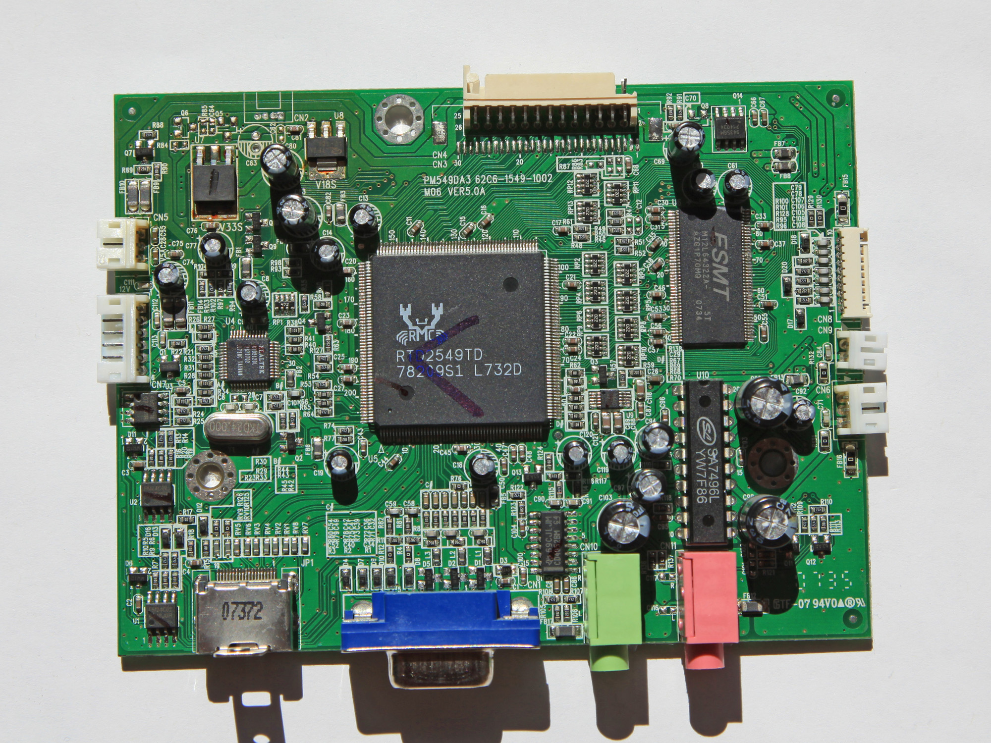

                        If you list your caps, someone will be glad to advise you on which parts to replace them with. Incidentally, I will probably be doing a re-cap of this monitor very soon so I can post a list of what I'll be using as soon as I get my hands on the PSU and logic board.
                        Note that the logic board on these models also uses cheap electrolytics (Which is not uncommon, but a lot of cheaply capped PSUs at least have polymer SMD caps on the logic board (Which almost never need replacing). These caps are small and difficult to replace, and should not be attempted unless you are willing to risk destroying the logic board. Most likely they do not need to be replaced, but I always do.

                                        Hi heli2reg,
                                        From the pictures you posted (which I too should say are absolutely excellent), notice in the last pic in post #64, IMG_3872, how the top-right corner is slightly darker than the rest of the board. This indicates excessive heat in that area. Now if you turn the board over (and look at IMG_3871), you will see that there are small electrolytic capacitors in that area. Chances are, they have been baked dry from the heat and are likely bad, so I would definitely recommend you replace all of them in that area. They look like CapXon KM or KF series as well - if they are indeed, you should definitely replace them because CapXon have a high failure rate, especially in hot places like LCD monitors.
                                        As for the output electrolytic capacitors on the power supply, they look like United Chemicon KY series - those are generally very reliable capacitors and probably don't need to be replaced. I usually leave good caps alone, unless they have been heat-abused, but other members here may not agree. Also, price-wise it might not be that much more expensive to get replacements for them too.
                                        I think a good start would be to post the info on all of the capacitors such as:
                                        1) Brand (or logo if there is no brand name - you can already see this on the brown capacitors on the right side of the 3rd picture you posted - those are United Chemicon, which are identified by their shield logo).
                                        2) Series (usually a 2,3, or 4 letter code, like KM, GL, etc...)
                                        3) capacitance (uF rating) and voltage (V rating)
                                        4) diameter and height in mm
                                        Also list how many of each type you have and which board they came from.

                                          Hi momaka,
                                          I have tried my best at taking a soldering iron and reworking some of the dark gray and not so shiny soldering points. The result is that it really did not change anything.
                                          However, I read through your post a couple times and it seems (correct me if I am wrong) that the power supply board may be OK despite the darker area that I could see on that as well. You clearly point out IMG_3871 and IMG_3872, which is the logic board, am I correct?
                                          I now carefully inspected that board and found something that I wanted to share with you. I tried my best with the cam and took image P1010223.JPG.
                                          Is that irregularity on the side of the capacitor something abnormal? Does it indicate any problem at all, potentially, or most definitely?
                                          Logic board (IMG_3871):
                                          As you correctly analyzed, they are all CapXon KM.
                                          The one in question is 5mm high, has a diameter of 4.15mm
                                          The reading says 16V, 10uF, P735
                                          There are 12 of these total, 5 in the area you mentioned.
                                          The others are 16V, 100uF, P729, 11mm high, 5.25mm dia, 5 total, 2 in the area you mentioned.
                                          The 3rd type is 16V, 470mF, P735, 13mm high, 8.10mm dia, 3 total.
