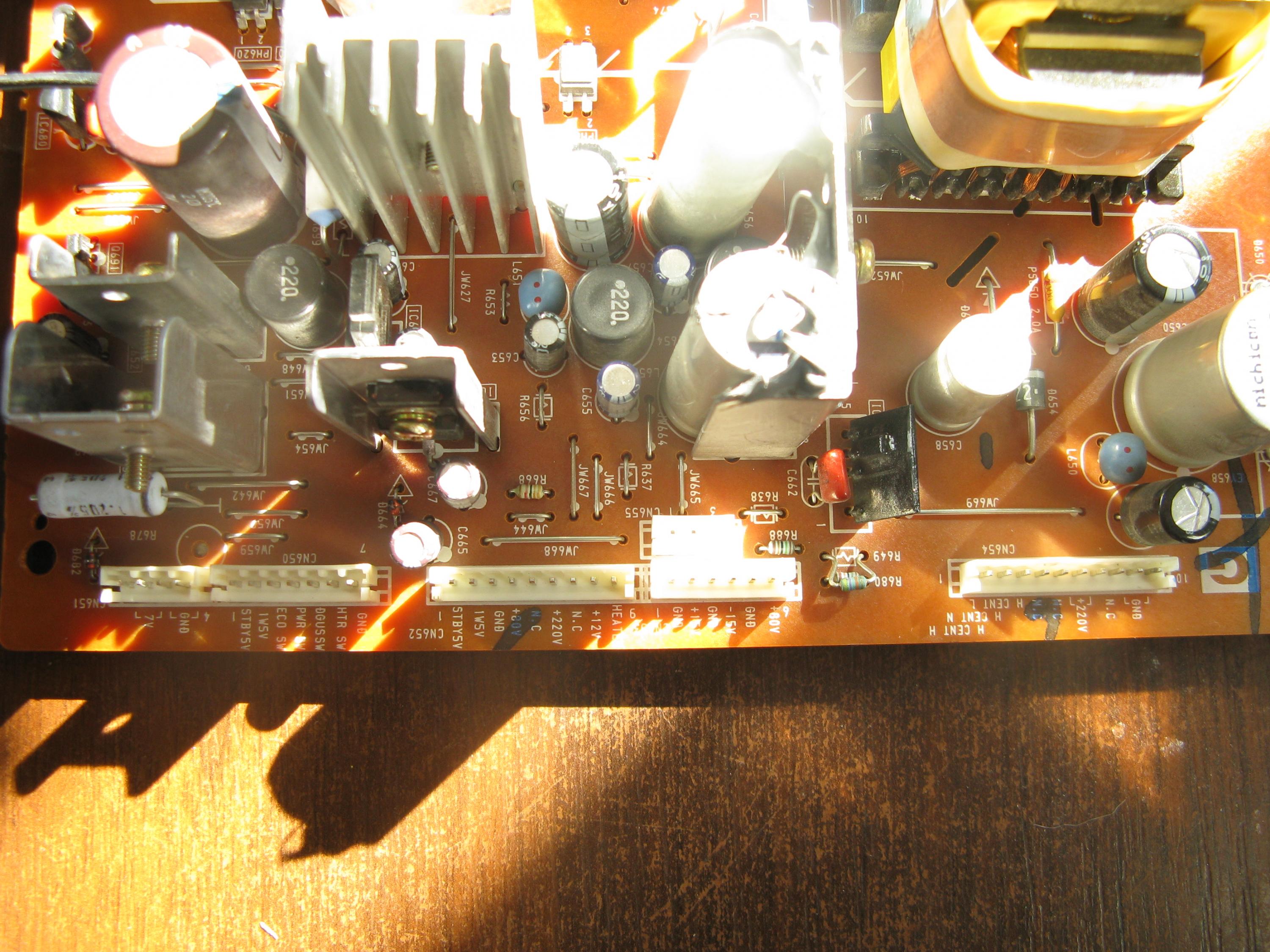

    - I have dissembled him and could not find any burned, discolored, odd electronic elements.
    - I couldn't spot any cold joints with a magnifying glass.
    - I measured the output G board voltages upon turning on the monitor (green diode).
    CN651
    7V = 7V
    CN650
    STB5V = 5V
    1W5V = 5V
    ECO SW = 5V -> po chwili 3.5V
    HTR SW = 4.9V
    DGUSSW = 4.8V -> 0V
    PWR SW = 5V
    CN652
    STBY5V = 5V
    1W5V = 5V
    +80V = ~15V for 1/2s -> 0V
    +220V = ~90V-200V for 1/2s -> 0V
    +12V = ~3.43V for 1/2s -> 0.04V
    HEATER = 5V
    CN653
    +15V = ~1.36V for 1/2s -> 0.02V
    -15V = ~2.43V for 1/2s -> 0.02V
    +80V = ~3.8V for 1/2s -> 0V
    CN653
    H CENT H = ~4.3V for 1/2s -> 0V
    H CENT N = ~6.3V for 1/2s -> 0V
    H CENT L = ~7.2V for 1/2s -> 0V
    +220V = ~15V for 1/2s -> 0V
    - I have also measured the input on pins 1 to 9 on IC620 MCZ3001D SW REG CONTROL. They are not correct according to the Service Manual. I have voltages on GND and 0. The complete measurements in my playlist https://www.youtube.com/playlist?lis...rUeEXE58CKJpQU
    First video from the playlist https://youtu.be/Bfiso9O2bV4
    At this point, I don't know where should I look for a failing component and how to proceed. If someone has an idea what should I check next and how it suppose to behave I would be grateful for any help. Please, I don't wanna hurt my friend, and it is hard for me to proceed on my own.

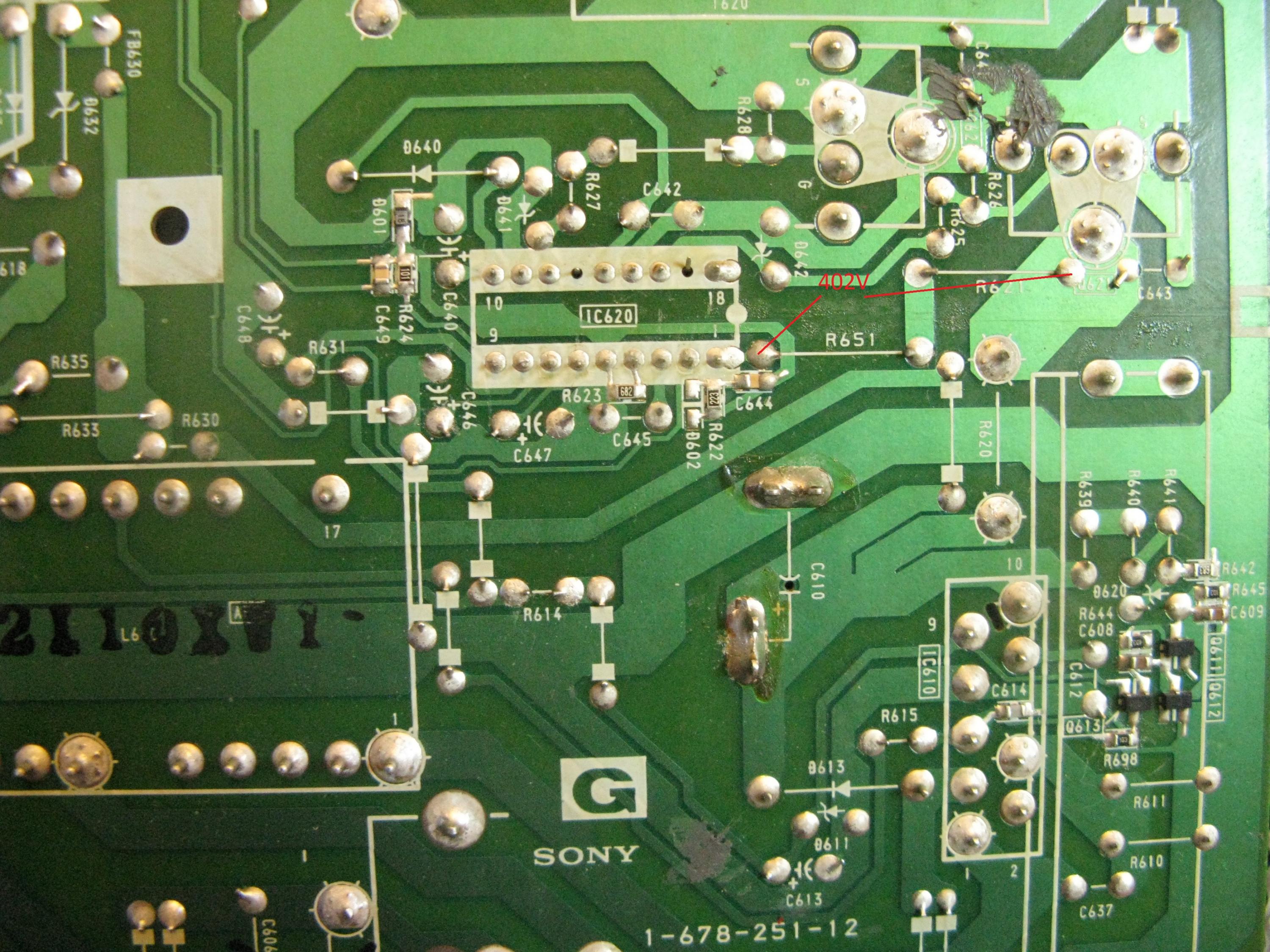

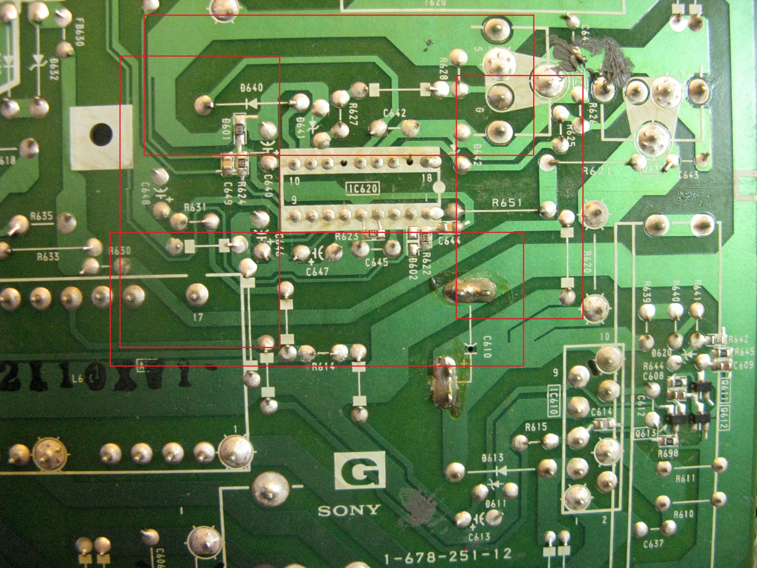

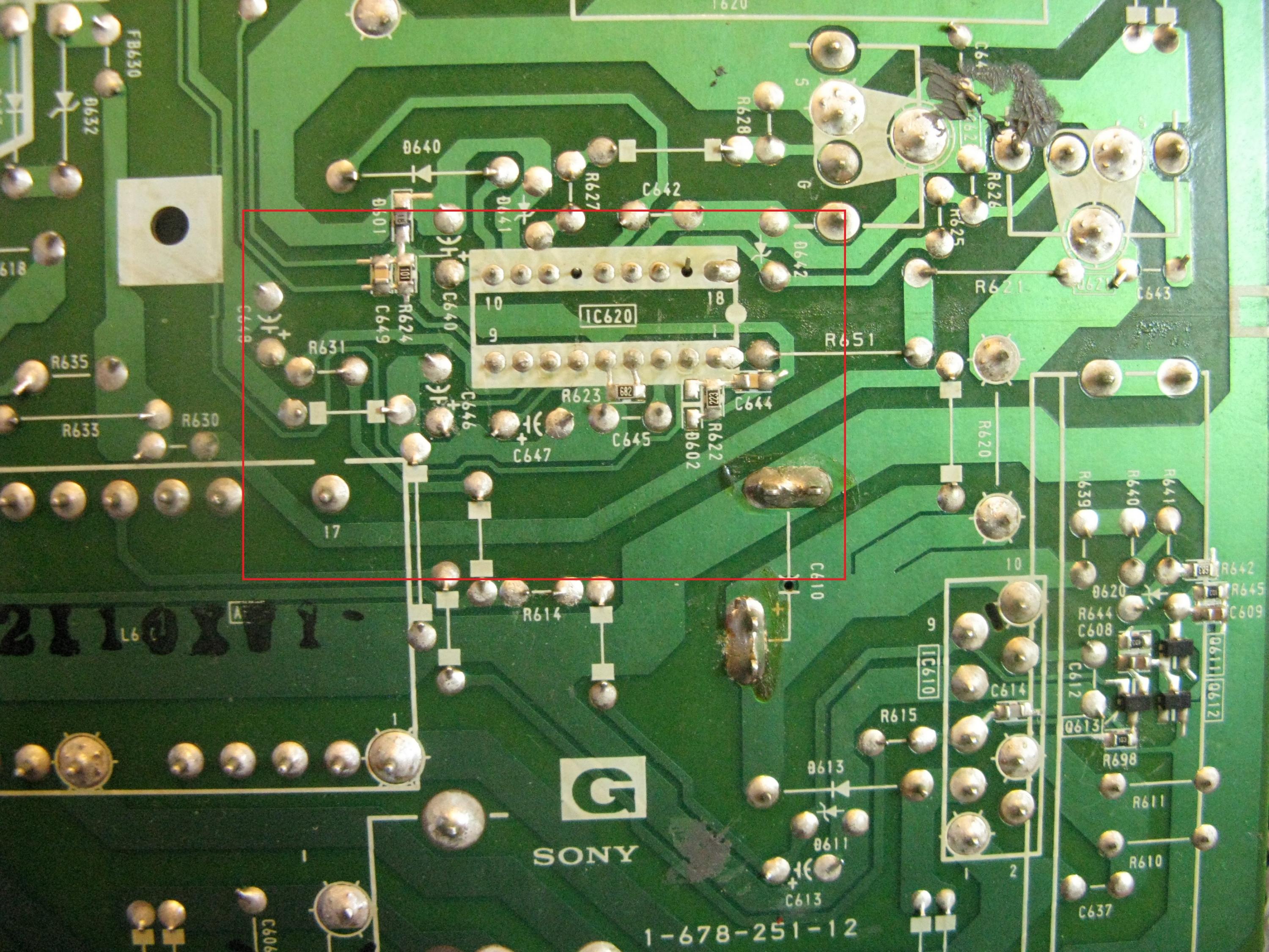

                  Hello again! I have performed some measurements around the G power supply and it has raised more questions.
                  G2 Voltage on A board = 0.00V
                  [G board (Power Supply)]
                  Measurements around IC610
                  C611 = 420V - (10) CATHODE but according to the Service manual it should be 376V
                  R643 = 0.0V
                  R629 = 0.0V
                  C639 = 9.3V
                  C648 = 14.8 V
                  R625 = 0.00V - should be 192V - (16) VG (H) (IC620 MCZ3001D SW REG CONTROL)
                  Those 2 resistors are on the red line going straight to (8) VC1 (IC620 MCZ3001D SW REG CONTROL)
                  R631 = 0.9V
                  R696 = 3.1 V
                  Out from VCC z IC610 - red line
                  R614 = 2.5V
                  C613 = 13.5V
                  C611 = 250V it is connected to (3) AC SEN IC610 (but in the Service manual it says it should be 86.2 V)
                  R620 = 0.0V
                  C643 = 0.15V
                  R621 = 97.0V
                  I don't understand what is going on with the R651 resistor, he is not present in any service manual
                  R651 = 73.0 V (photograph below)
                  https://imgur.com/cqDzTNZ
                  The leg of R651 is connected to (1) V SENSE and the voltage across resistors is
                  R651 and R621 = 402 V is connected to (1) V SENSE of (IC620 MCZ3001D SW REG CONTROL) but in the service manual is printed it should be there 1.7V
                  C645 = 2.2V (3) CT - OK - Service manual = 2.2V (IC620 MCZ3001D SW REG CONTROL)
                  C647 = 0.00V (6) TIMER - OK - Service manual = 0 V (IC620 MCZ3001D SW REG CONTROL)
                  Here, does it mean that C646 is failing and needs to be replaced?
                  C646 = 0.17V (7) SS - WRONG - Service manual = 4.5V (IC620 MCZ3001D SW REG CONTROL)
                  I don't understand why when I am touching with only one prob of the multimeter on the legs of C646 I have 2.7V readings (the 2nd probe is in the air, not touching anything)
                  C640 = 10.8V (10) VC2 - OK - Service manual = 10.3 V (IC620 MCZ3001D SW REG CONTROL)
                  C642 - 0.00 V
                  R625 - 0.00 V
                  R626 - 0.00 V

                    Re: I need help with my friend Sony GDM-FW900 24” CRT
                    I have replaced C646 (2.2uF 50V) now I have voltage on him
                    C646 = 28V, the weird part is the monitor woke up and gave a screen with an OSD picture. But the picture was very bright with a greenish picture on it. I turned him off and was able to turn him on one more time. Now, when I turned on the monitor no change, but the voltage on C646 is present. But when I put a multimeter on C647 to measure voltage the monitor powered on again (only a few times).
                    I have replaced C646 again and noticed, the monitor power on the first try. Only once, again very bright. When he was heated with a hair dryer there was no over brightness.
                    I think the monitor was powered on because he was heated in this area.
                    Used to be C646 = = 0.17V (7) SS - WRONG - Service manual = 4.5V (IC620 MCZ3001D SW REG CONTROL)
                    Correct: now when I heat back the area for 30 seconds with the hair dryer he is always powering up very bright (I am turning him off, don't wanna harm him). Not sure how to locate which component needs to be heated (failing) and needs to be replaced. Any ideas?

                        Hello, there is an update, the monitor is now turning on. But it seems it's now harder for me to figure it out the main issue.
                        I have noticed that heating up IC620 powers on the monitor I think the 7 or 8 leg was responsible for that state. So I have replaced IC620 and the monitor is powering on every time but the screen is RED / GREEN.
                        I have noticed that shortly heating UP with a hairdryer back of PCB (not IC620) but closely around gives a proper picture for 2-4seconds (black background and this color input osd)
                        I have replaced 3 electrolytic caps around C645, C647, C646 but no difference
                        I think that there is something that killed IC and is doing this color problem (later CRT has proper colors after a very long time warmup and switching input 1 to input 2)
                        Any idea which type of component might be doing that, caps, res diodes? I don't know how to locate the component that is failing
                          The PSU output without heating the PCB
                          CN652
                          STB = 5V
                          80V = 79V
                          220V = 218V
                          12V = 12.0V
                          Heater = 5V
                          Moreover, when I turn the monitor on and off 5x times in a row each time, he has less red/green.
                          After 3 times, there is no red color anymore only green.
                          The picture is black after 2-5 sec -> green.
                          After 5 - 7, monitors turn on in the row picture stays black and has no color issue.
                          After that colors are normal permanently, this issue occurs only when the monitor is starting up and warming up.
                          Have no idea what is going on at this point.
