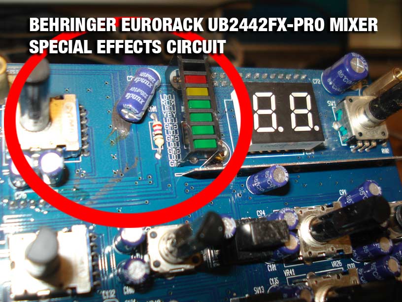

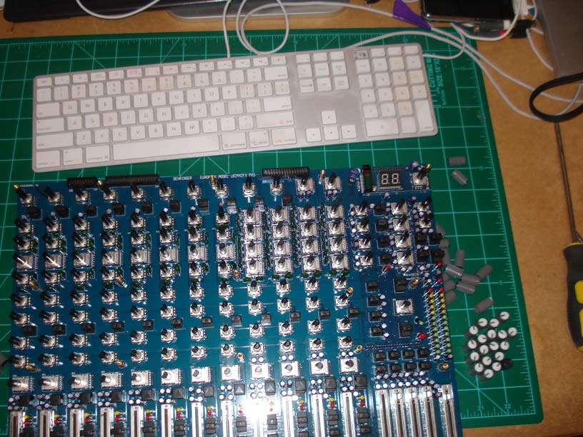

    Here is another project, but this one is on stand by.

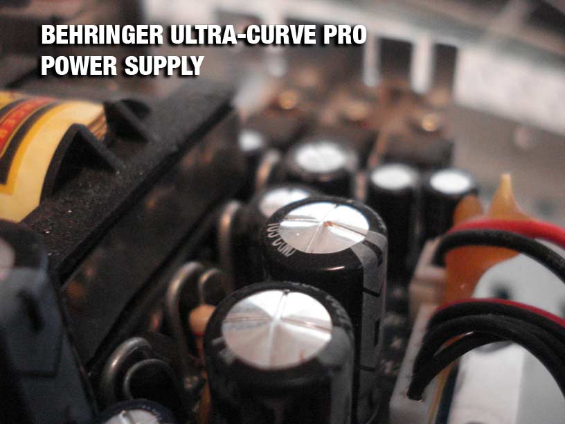

    BEHRINGER Eurorack UB2442FX-PRO first.
    As soon I finish to open this sucker (with infinite amount of knobs) the aha moment was just waiting for me. One capacitor leaking showing why the effects on the mixer doesn't work anymore.

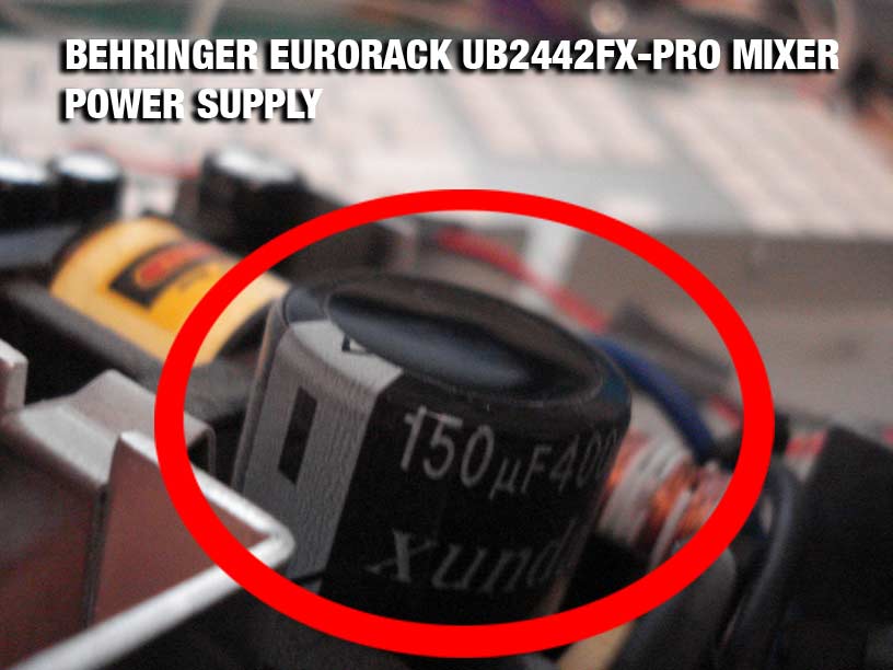

    Another bulged capacitors where found on the power supply. No brainer, I'll change those one too. To make the story short on the ULTRA-CURVE PRO, the same problem with the power supply.
    Those capacitors are all from XUNDA. Looks like was reported on the Bad Capacitors list already, so no surprise for you guys.

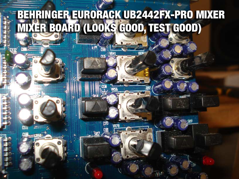

    But the problem is not that. The problem is that this mixer have almost 200 capacitors... and all happen to be XUNDA capacitors.
    The capacitors on for the mixers doesn't look bad at all. I've removed a couple of caps and they are good, looks good and tested good.
    Should I change all the capacitors just because are Xunda?
    This is not going to be a fun project at all.

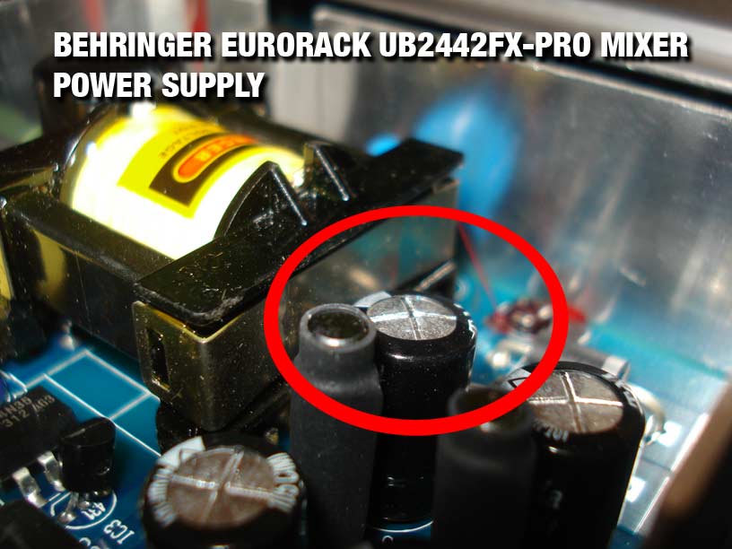

    I would replace all of the Xunda units on the power supply board.
    Recommended replacements are Nippon Chemi-Con KY (or KZM if you can get them), and for the 200/250/350/400/450V unit, Chemi-Con KMH/KMM/KMQ (snap-in) or KMG/KMQ (radial).
    I've seen Kaon KTF-200S set-top boxes with bad Xunda units on the power supply board, and none of the Xunda units were bulging on the main logic board.

      The one you circled in your second picture (the purple Xunda 220uF, 10v cap) may not be bad - the brown stuff on the side of the cap is just glue to hold in down during manufacturing.
      As for the power supply - yes, definitely change all the Xunda caps there.
      Use low ESR electrolytic caps. The following may be used:
      KY, KZE, LXY, and LXZ series from United Chemicon
      PW, PM, HE, and HD series from Nichicon
      FC, FK, and FM series from Panasonic
      YXG and ZL series from Rubycon
      RS series from Samxon
      The only exception is the big 400v cap - this one can be replaced with any cap of the same voltage and capacitance rating. 85C rating is fine, but 105C is better. Another thing worth mentioning is these high voltage caps rarely fail. The fact that your looks bulged may also be because the plastic sleeve is warping due to age or heat. With your thumb, press down on the plastic sleeve on top. If you can't push it down easily, then it's probably bad.
        Just to clarify you should feel the metal under, if you can push it down a bit and feel the metal being flat then it's fine, just the plastic cover being "bulged"
        The caps on the power board fails because they become hotter than in the rest of the unit, and also have to work much harder
        The other caps are mostly for logic boards and signals, not much stress on them so will likely be fine a much longer time...

          All power supply caps must go. I don't want to take chances and they are affecting the board already in a big way.
          I am pretty much sure that all the problems that I have with the mixer is because the power supply.
          I've been doing extensive testing with oscilloscope and multimeter today and my early conclusion is that the power supply is the only problem.
          The audio problems and effects problems are not from the main board... *(thanks for catching the glue, that's the same assumption that I did with the M-Audio monitors)...
          ... and if this is the case I just save myself a lot of trouble.
          I expent all morning testing capacitors and the main board and I can't find any problem. The power supply on the other hand is a disaster. I'm just waiting for the parts.

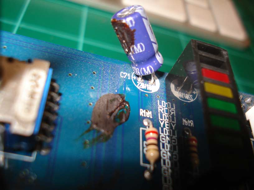

                              I would also get rid of that gunk that was holding the cap on the mixer board. This stuff goes conductive after a few years and I find it unbelievable that some manufacturers still use it. Scrape it off with something plastic so it doesn't fracture the etch resist (assuming it hasn't eaten through it already).

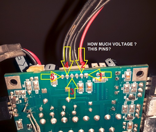

                                    please help me . thanks .
                                    Hi
                                    Please help me.
                                    One kind to me and say how much the order of the output voltage of a power supply pins?
                                    Please answer faster.
                                    What makes the mixer rips? Lds is off and caustic
                                    very thanks.
                                    behringer UB2442FX-PRO

                                          Hi guys
                                          I have this faulty mixer here. Basically the owner says it worked fine at one gig, then the next one it didn't
                                          When I power on, both the L & R LED Meters go to +4 and stay there. This is without any input and with all sliders Level Set knobs set to zero
                                          Also the LED meter on the 24-bit dual engine DSP goes to red (clip)
                                          I didn't connect an speakers but if I use headphones I can hear what I can best describe as a purring noise on both channels
                                          I found a schematic for the PSU There is a 10 way ribbon cable going from the PA/PSU...
