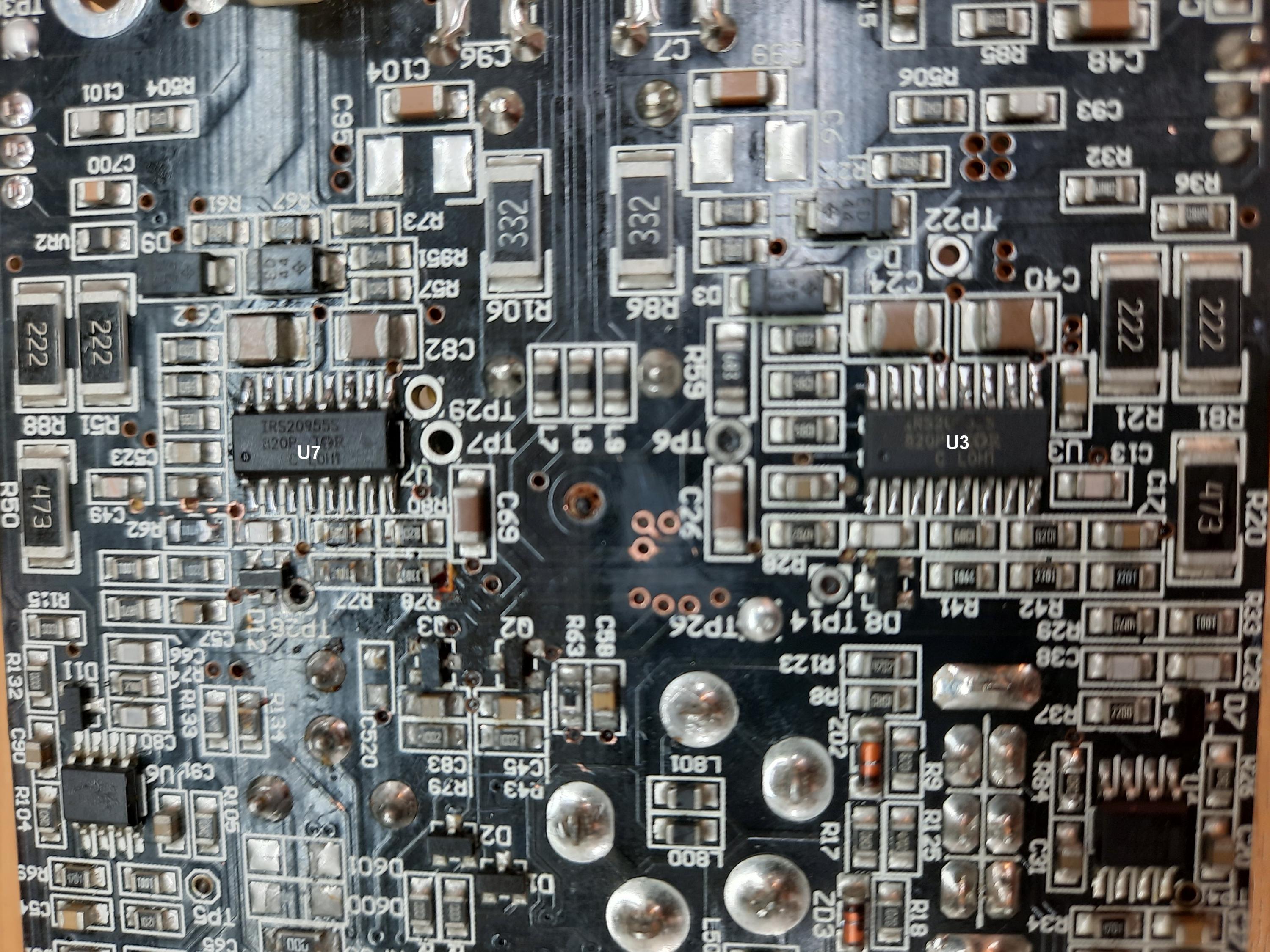

    HI all
    It's yet another monitor speaker.
    Trying to rebuild the audio circuitry.

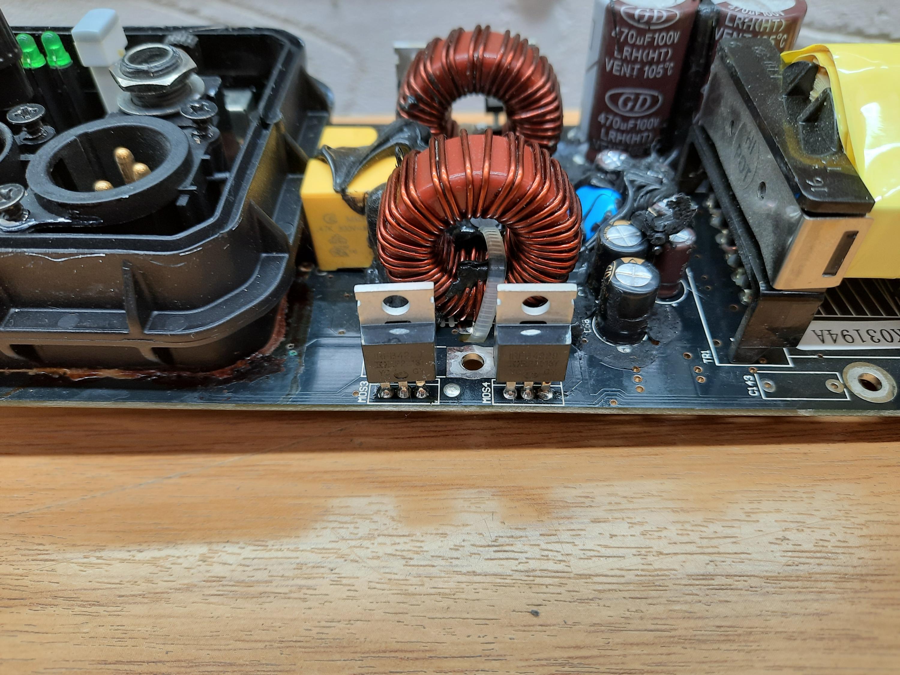

    The story so far, after removing loads of glue.
    MOS3 & MOS4, both type IRFB4229, S/C
    Also replaced Gate drive chip for them, U7 type IRS20955S, plus U3 which is same chip type for a different set of FETS.
    Anyone have experience working on this model?

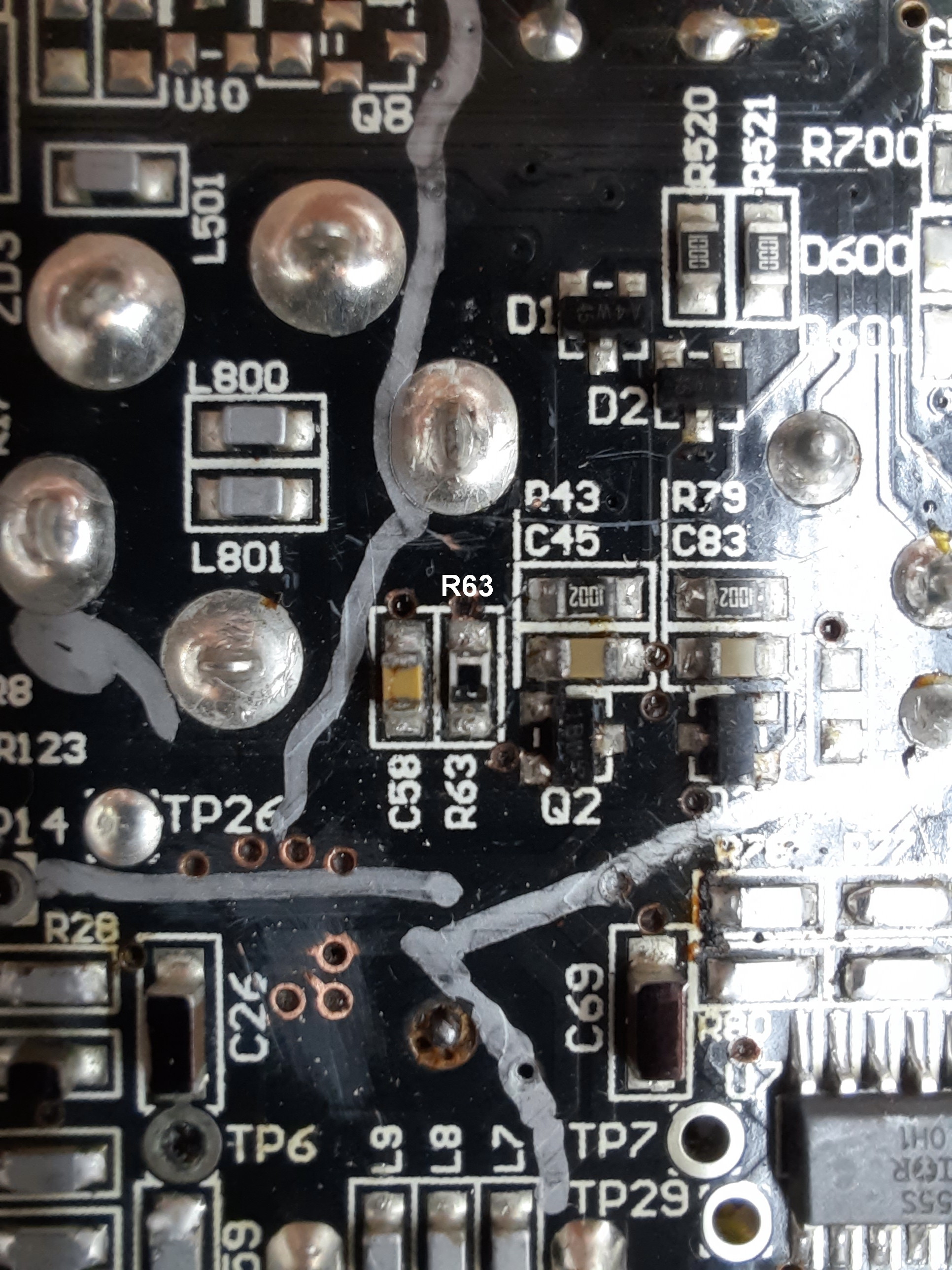

    Re: ART710A, RCF monitor speaker schematic/advice please
    Require value of R63.
    Measures 2K2 but has been corroded by glue & need to know if it's ok.
      Suspect R63 is correct as there is no real link from it to damaged parts of circuitry.

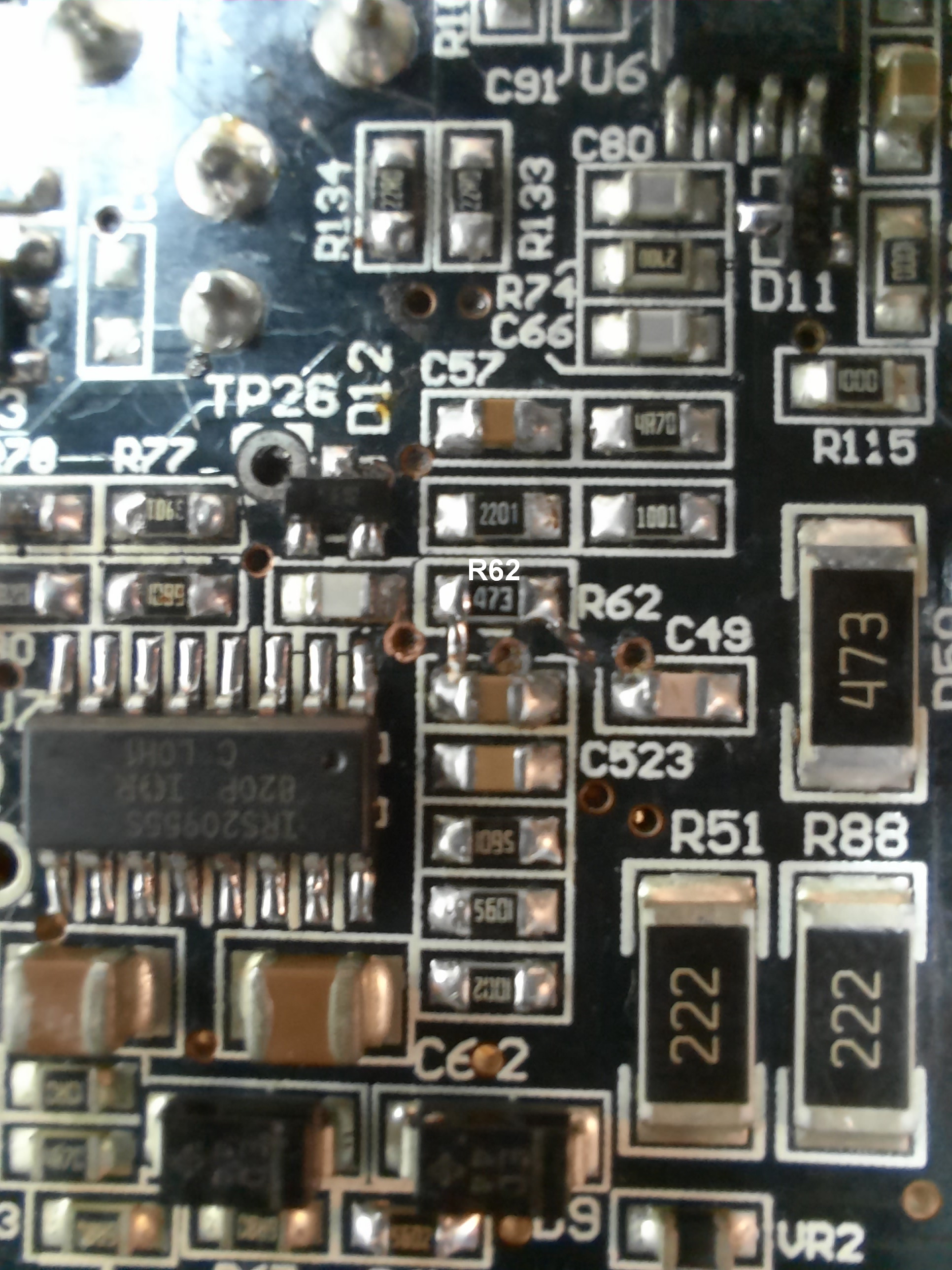

        A previously found corroded resistor that I must have replaced by error with wrong value.
        R62 which is on the VCC line to U7 is where I went wrong.
        Used a 4K7, but when I compared the mirror circuitry for the tweeter drive value is 47K.
        Replaced with correct value & now main driver producing audio, but the main output FETS getting quite hot.
          One of the previously replaced FETS had shorted therefore swapped out both plus U7
          • zen
            • 511
            MOS 3 seems to be the FET that keep failing, then DC finds its way to the tweeter, which has in turn blown it.Cannot seem to work out why.
