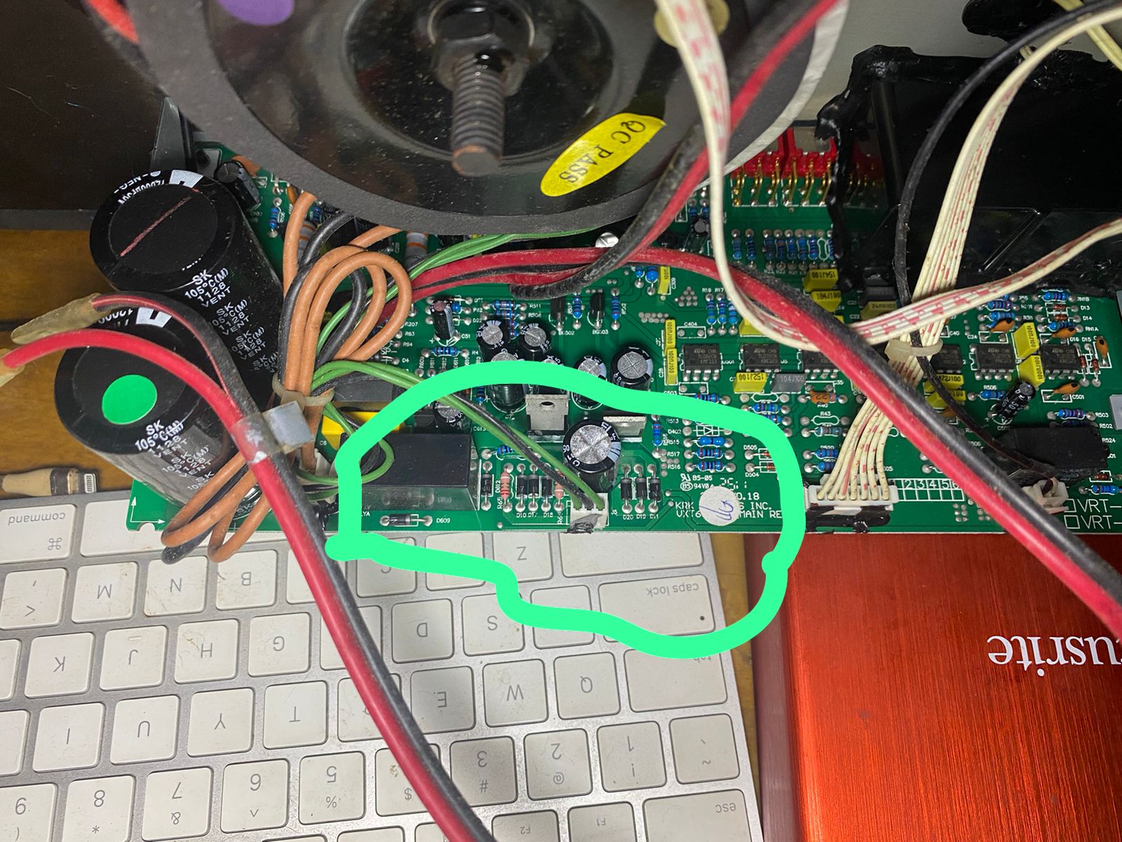

          I know its an old thread but i have a VXT8 i bought used with these exact two resistors, R65 & R66, missing... someone replaced them with wires.
          Do you know what are their roles in the circuit? i could not find the schematics and i was wondering if it is safe to run the monitor like this. It works, but it does not seems right....

            Used as a fuse and probably were flame proof too.

              i attached two pictures, one of the monitor that is missing components and other of the untouched monitor, as you can see, 2 diodes (D10 & D11) are also missing. Are them supposed to act as fuses too?

                Either something is disabled, or got modified somehow. The diodes rectify AC to DC. I guess you have to see where these traces go.

                  Yes, you guessed right. Theres a mod, it is hardwired to 230V, the switch is disconnected and it only works on 230 volts. Image attached.
                  The only modifications on the circuit are the two resistors bypassed and the two diodes removed.
                  Does the missing components correlates with the hard wired 230v only mod?
