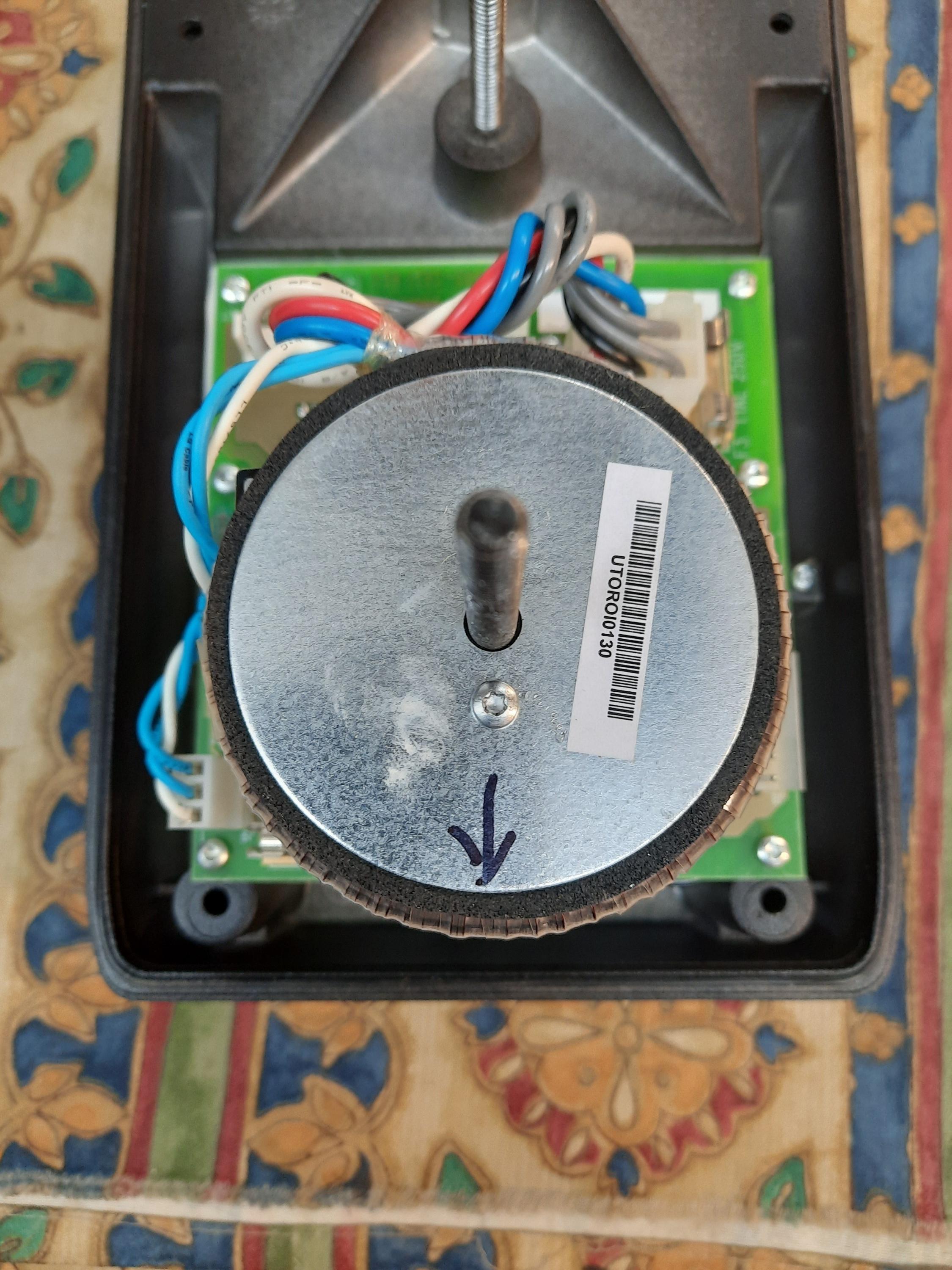

    Hi all
    Customer connected to UK mains whilst it had been set to 115V.
    Mains Toroid transformer blown.
    Require help sourcing original, or a schematic for speaker so that I can work out an equivalent to use.
    Only 3 wires at output, so I'm guessing 2 X 12V or something close to that.
  • zen
    • 511
    Re: 1029A Genelec speaker, transformer help please
    Customer dropped in his working speaker, & now can confirm output is AC 24 X 2, with WHITE lead being the common.
    Managed to match up a stock transformer.

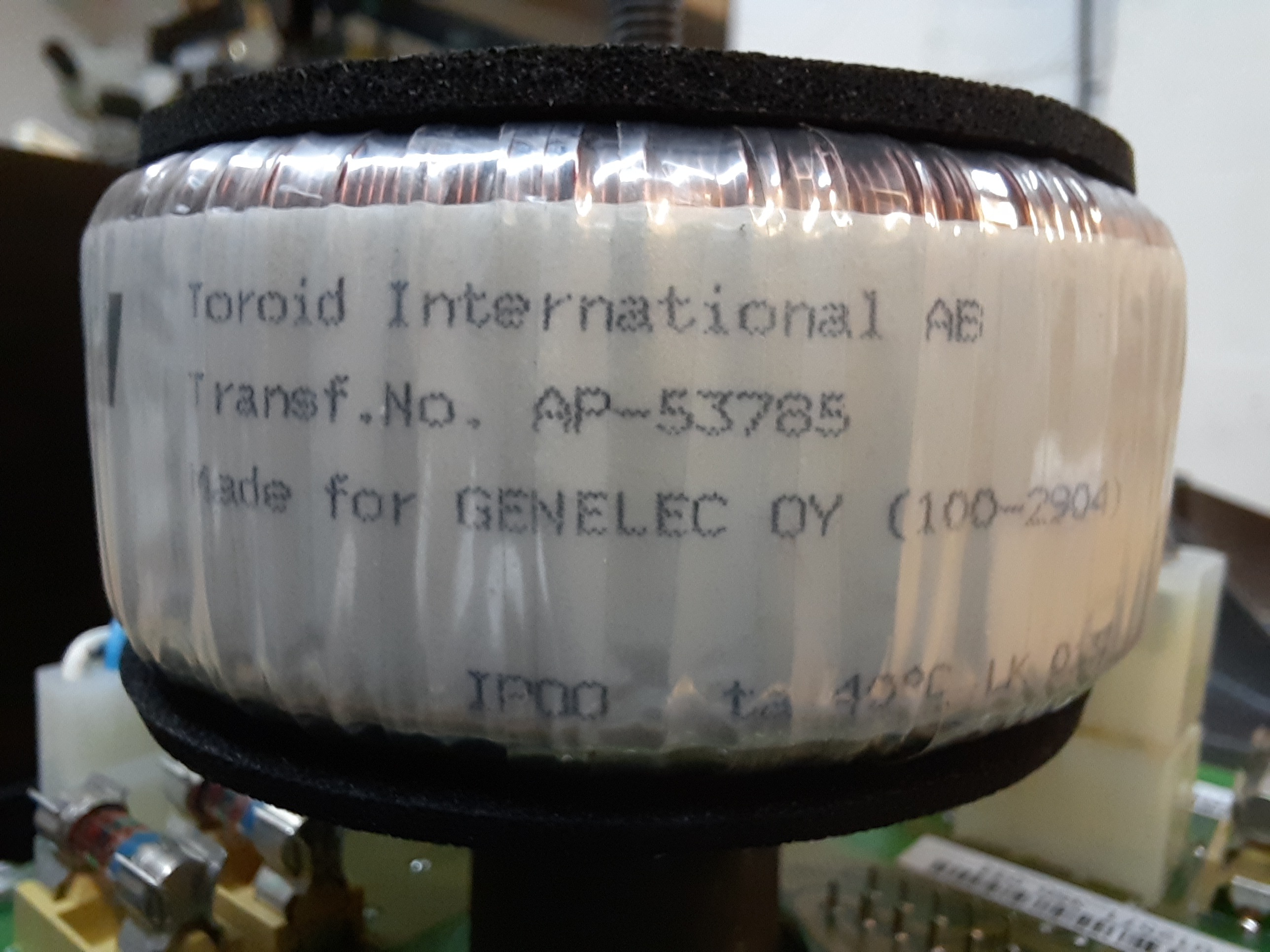

    • Raymondtech
      • Oct 2024
      Hi Zen,
      Did you get the speaker working, if so could you tell me which transformer you used please.
      It seems like the transformer in one of my Genelec 1029a speakers has blown. I am now looking for a replacement transformer.
      Thanks in advance.
