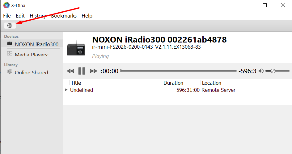

                        [SOLUTION 2023 and forever ]
                        Hi All, I have found way, how to use our dead Noxon iradio. It is not perfect, but it is better than having this radio like a furniture. I have iRadio 300. Here is how I am using it:
                        1. On pc, which is in the same local network as iradio, install X-DLNA, it is freeware.
                        2. Make sure your noxon is connected. If you are on wifi, you have to click "internetradio", it connects to wifi, but shows network error, but it is OK.
                        3. In X-DLNA click on webglobe:
                        4. Navigate to direct stream link like this one: http://s2-webradio.rockantenne.de/rockantenne or try other. Some radios you can find here: https://github.com/schreibfaul1/ESP3...Webstreams.txt
                        5. It plays automatically on PC, but you can stop it.
                        6. Click "Cast via" button:
                        7. Click on play.
                        8. Now It plays from iradio. You can now close X-Dlna, it will play forever, until you do not turn off radio.
