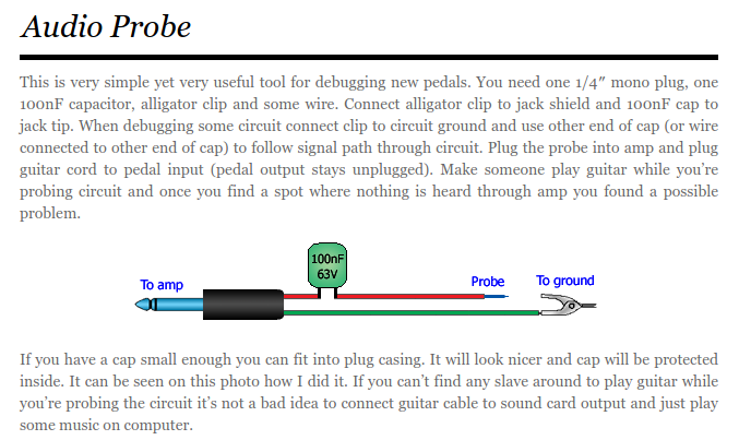

      The easiest way I could suggest to you would be to play some audio into the inputs and then use a simple audio probe to trace to where the signal stops.
      Here are links to a simple probe for use with another combo amplifier (e.g.small guitar amp) .... and the Peavey XR684 schematic for a map of the circuit ... which may or may not be very similar.
      Audio probe: https://www.diypedalgearparts.com/en...e-how-to-build
      I'll attach the schematic ...

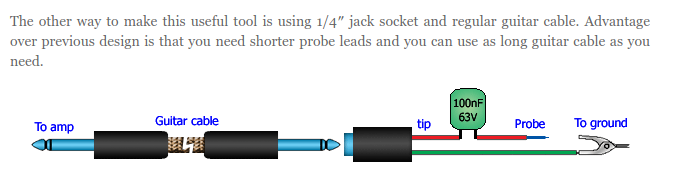

          Actually here's better images showing the probe construction better ... wired to a plug or socket ... the grounding on the original link is a bit confusing if your new to this.
