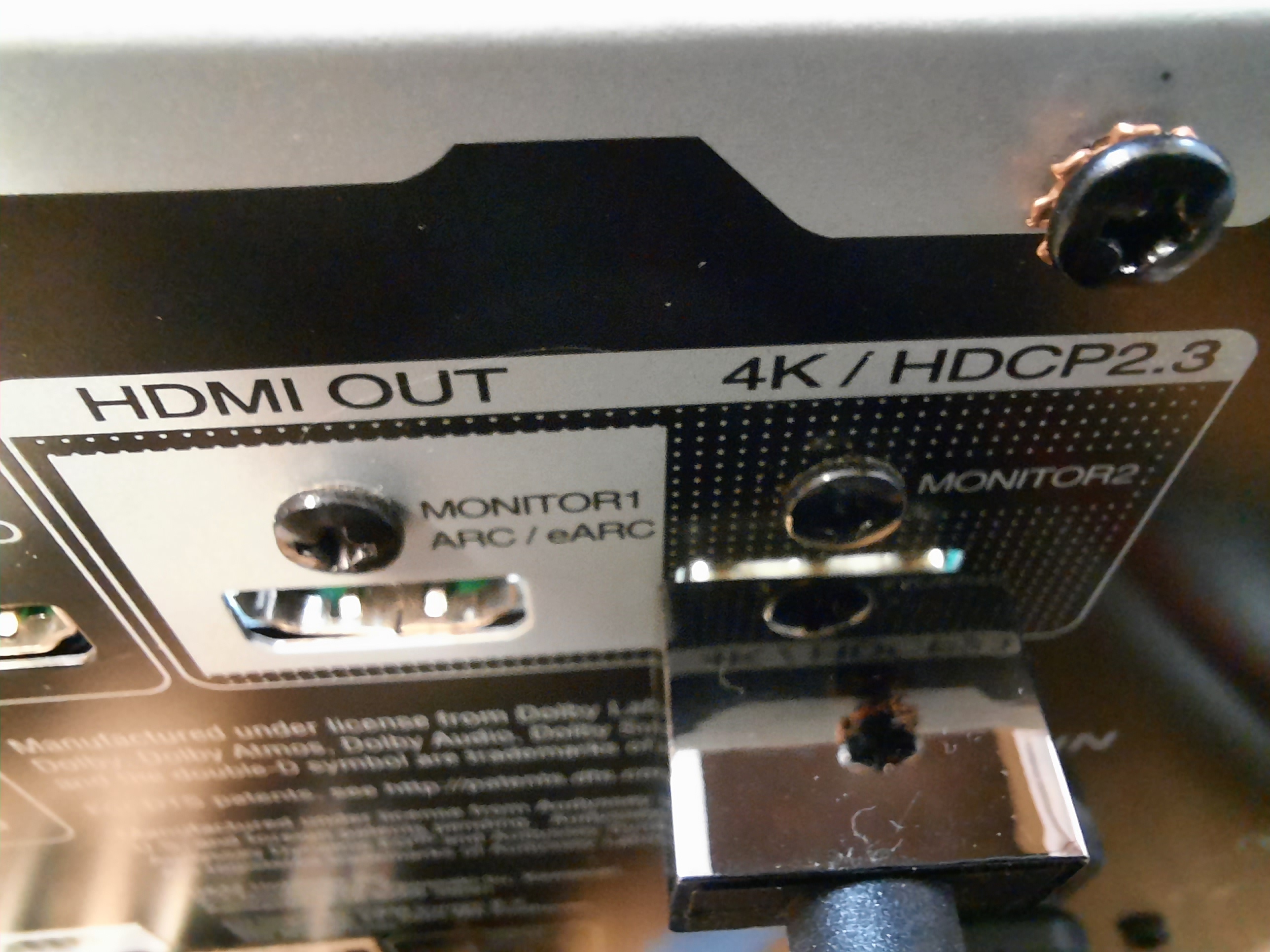

    Hi all
    HDMI out is unreliable .
    On occasion will work , but most of the time ,either no signal , or hangs on Marantz logo .
  • zen
    • 511
    Re: SR5014 Marantz AV receiver software / advice please
    Could be on to a winner .
    2 updates
    First one is listed as a forced update . 14.6 MB file ,which took 24 mins to complete .
    Second is the HEOS update . 66.9 MB , yet only took 5 mins to complete .
    Both are just plug & play , IE power unit on , insert USB , then wait .
    Still requires more testing but HDMI signal now seems stable .
    Only obtaining video via HDMI monitor 2 out ( 4K / HDCP2.3 )
    Via monitor 1 ( ARC ) only audio , but that could just be a setting .
    Will test all 8 of the HDMI input ports then report back .
