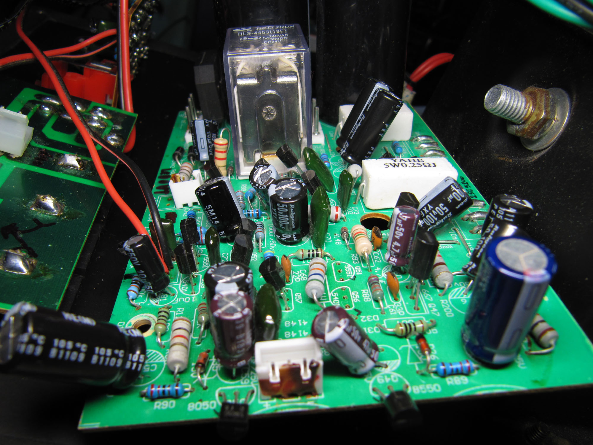

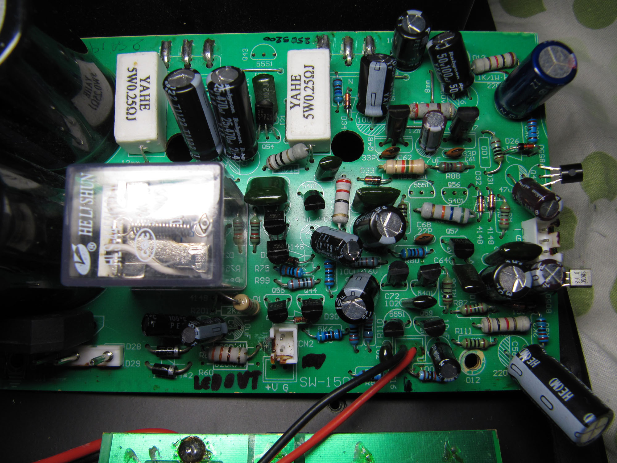

    I got this subwoofer for 40€, previous owner said that the amplifier broke down again and he doesn't want to fix it again. Said he already fixed it once and the technician he went to fix it told him that those who designed this thing did a lousy job.
    This unit is designed and made in Greece, it claims to output 150W RMS real power and the woofer is large 10" inch and can go very low, down to 20HZ maybe.

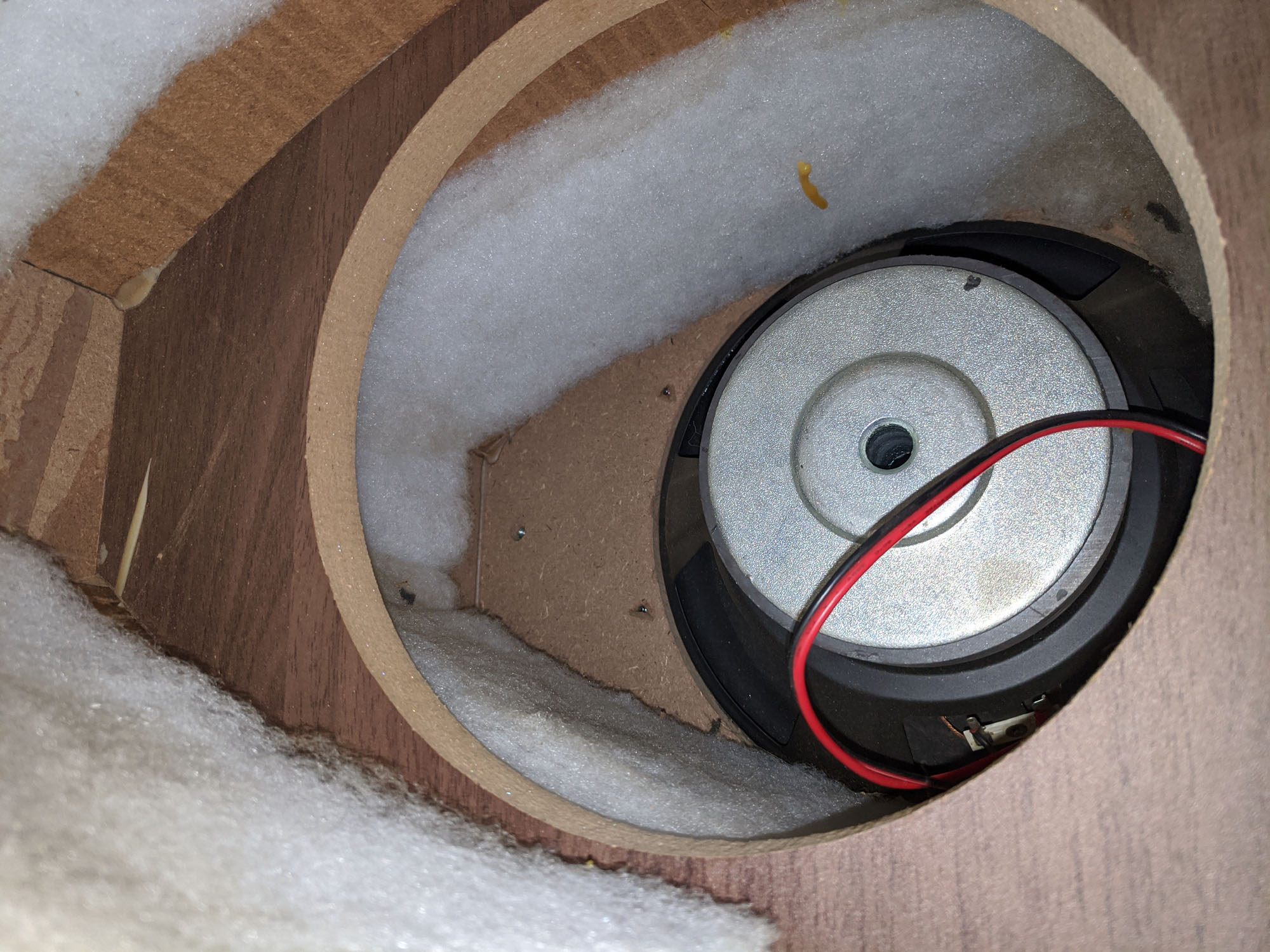

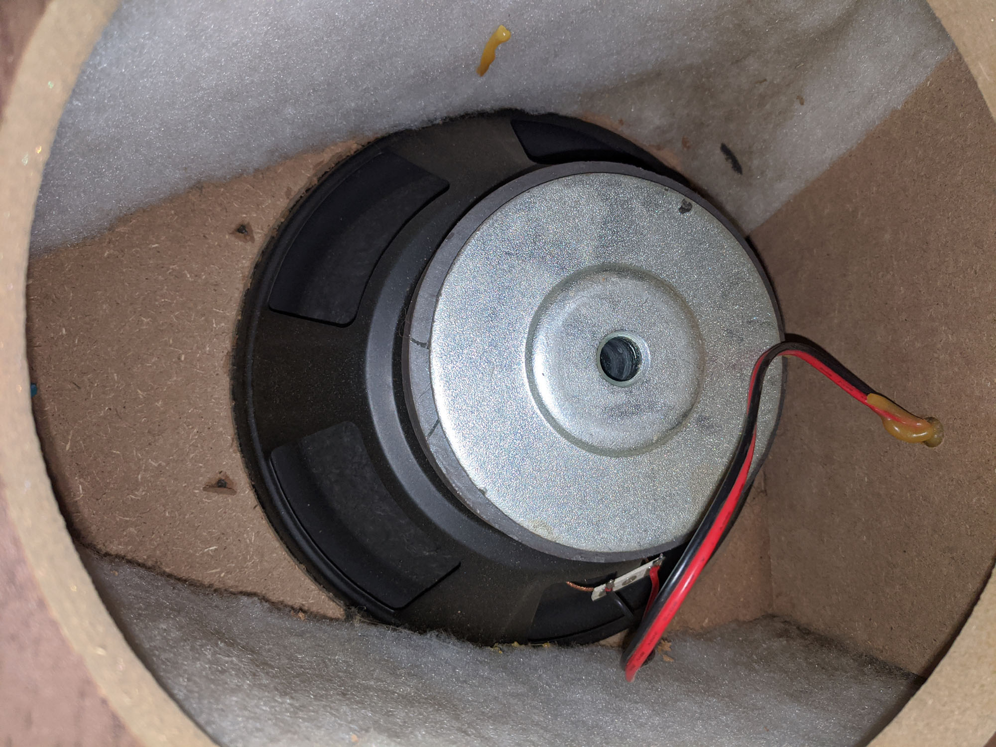

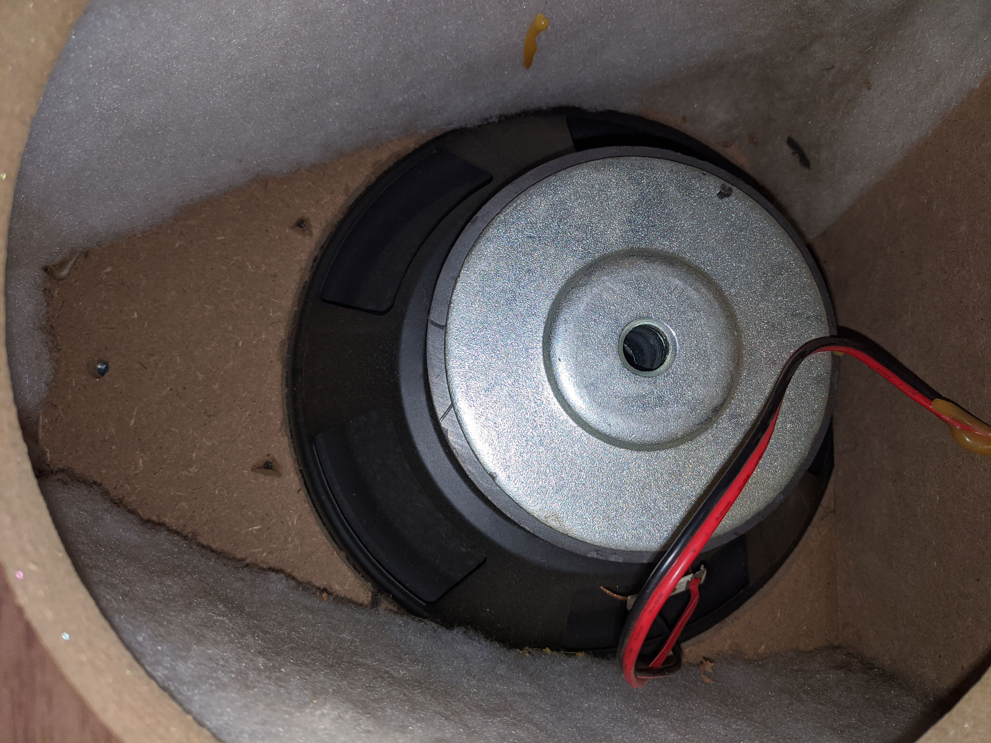

    I will attach just some overall pics of the sub for now, due to lack of time and will resume tomorrow posting pics of the different boards and description of the issues.
    I removed one bass reflex port waveguide to be able to insert my hand and take those inside the cabinet pics

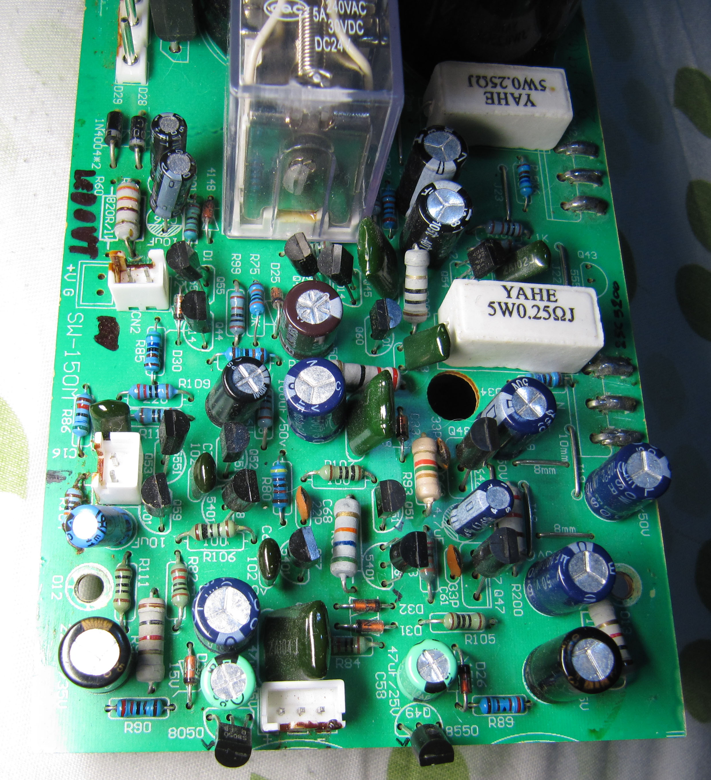

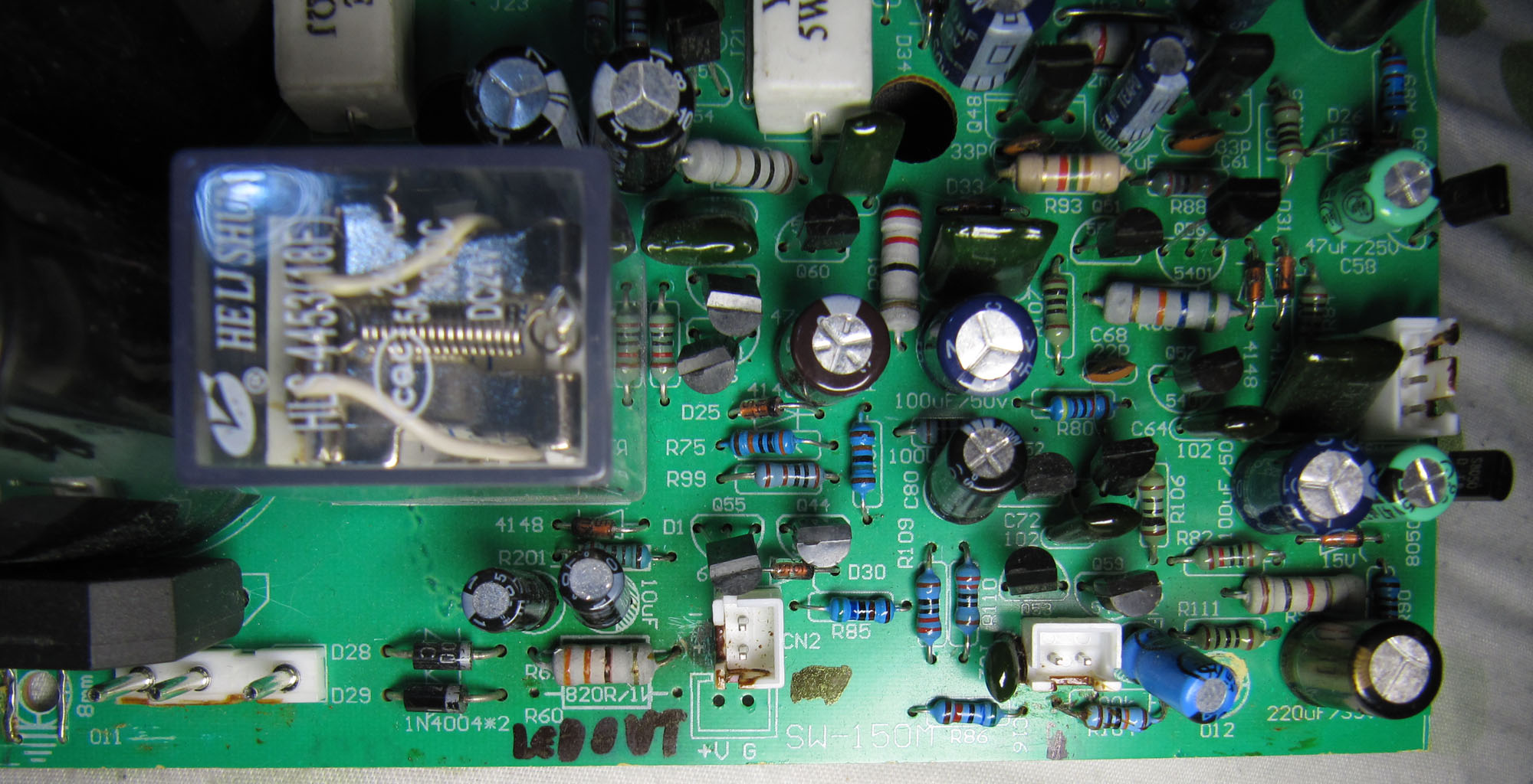

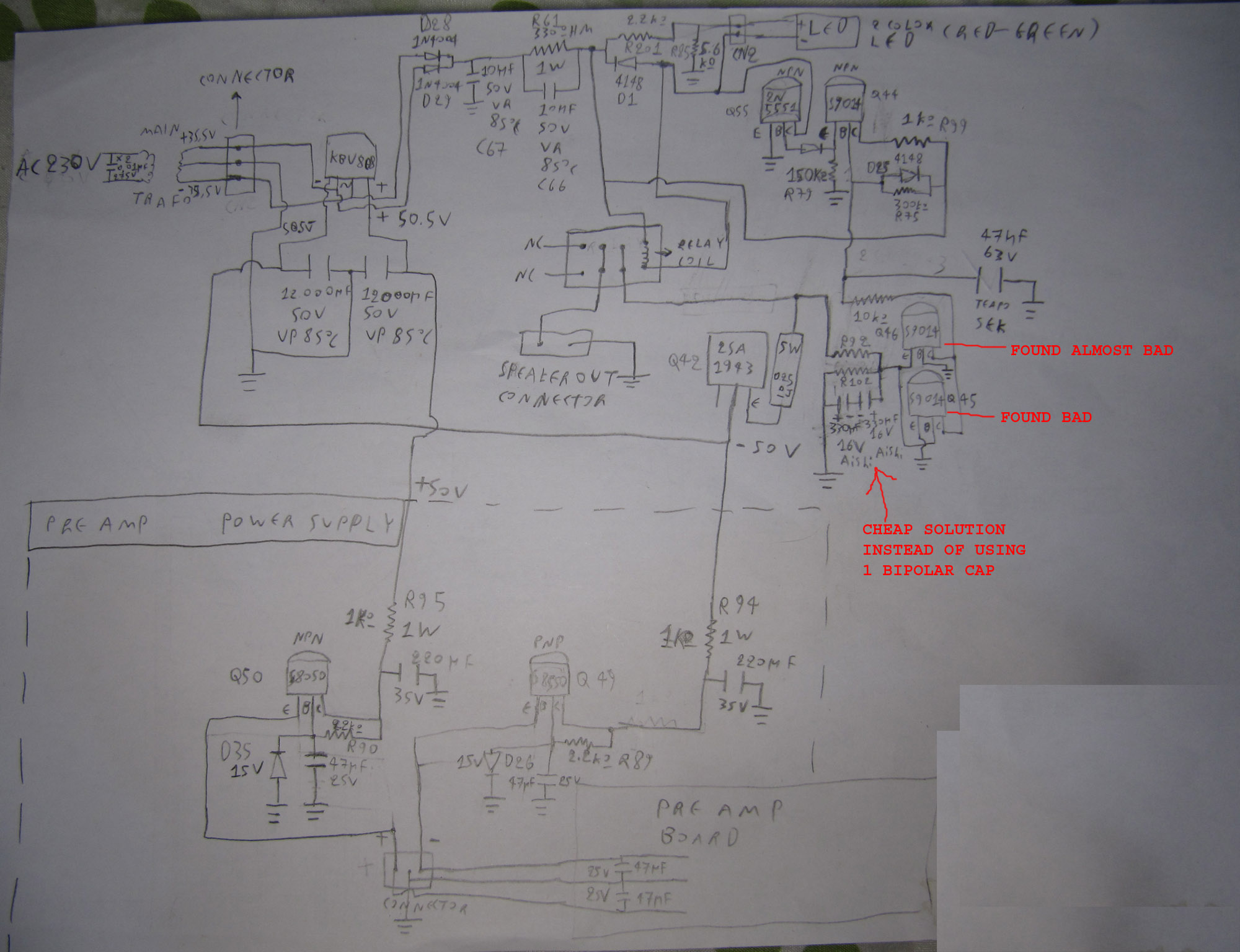

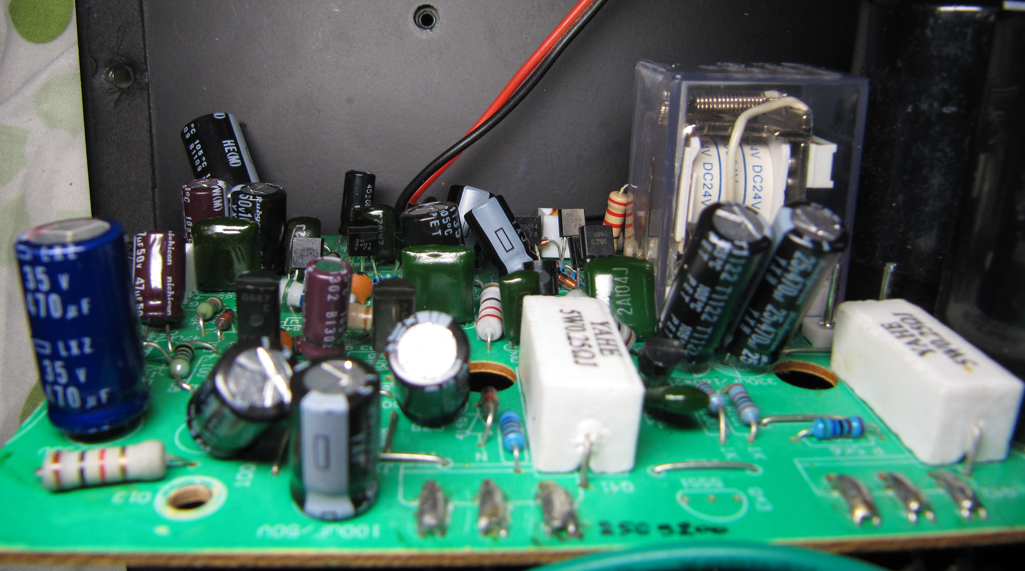

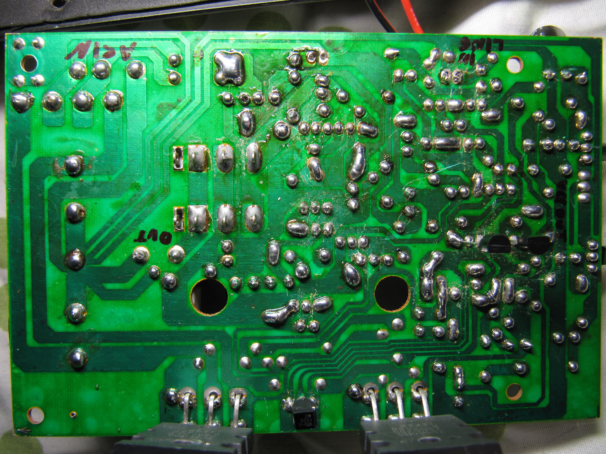

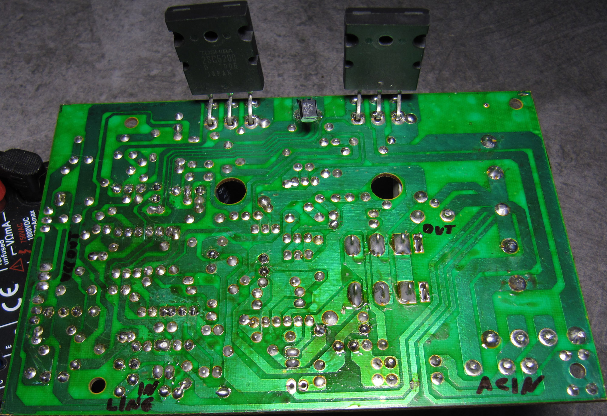

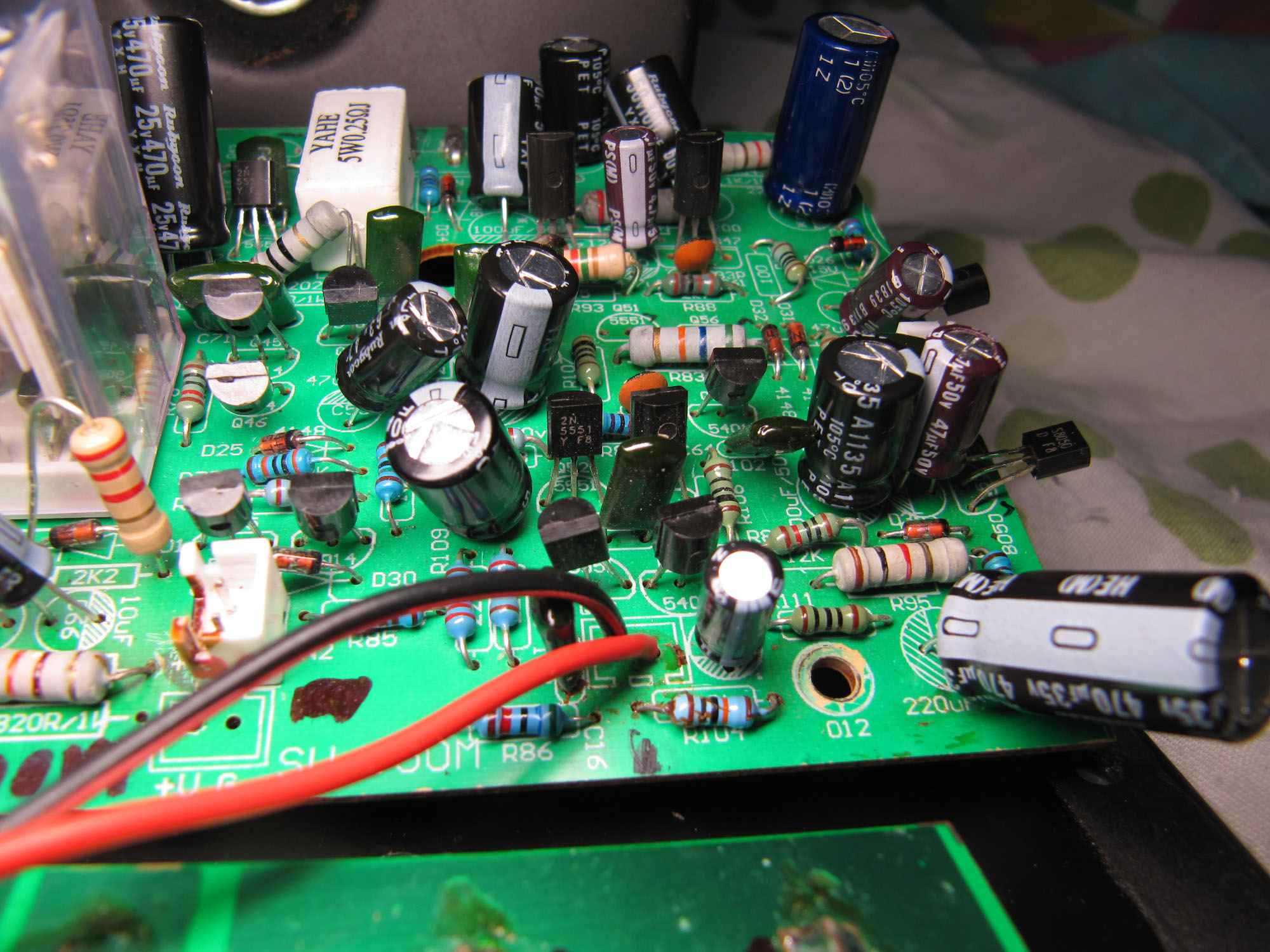

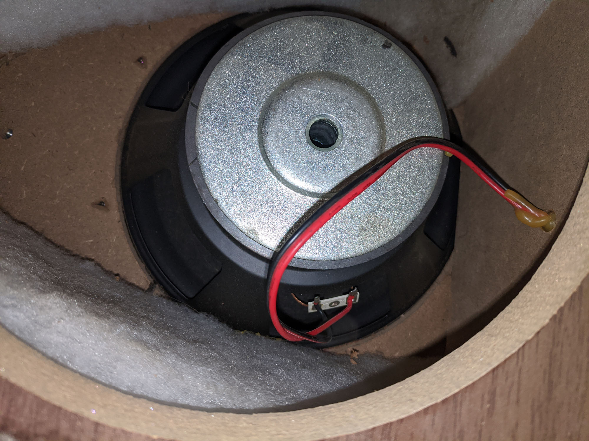

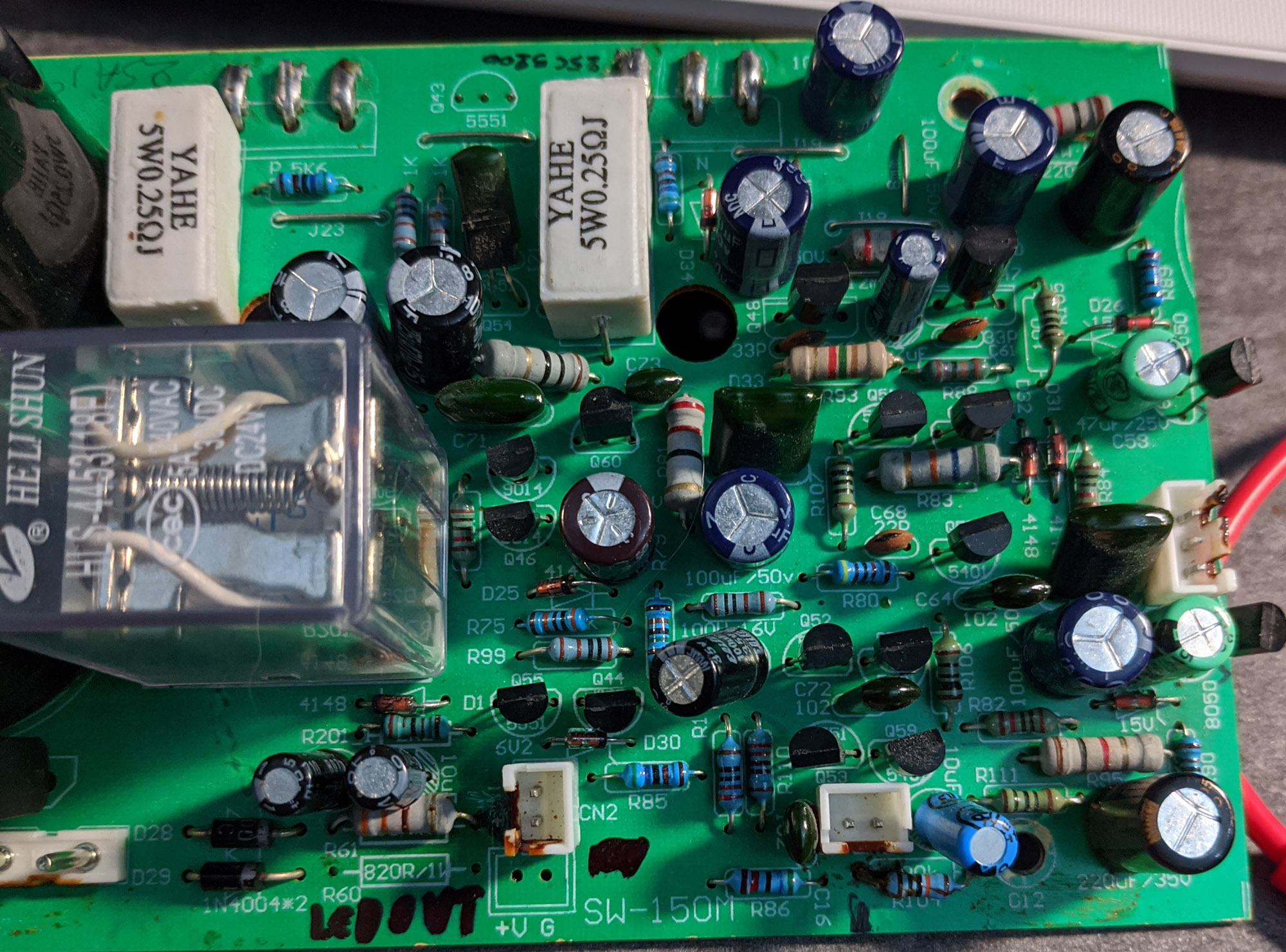

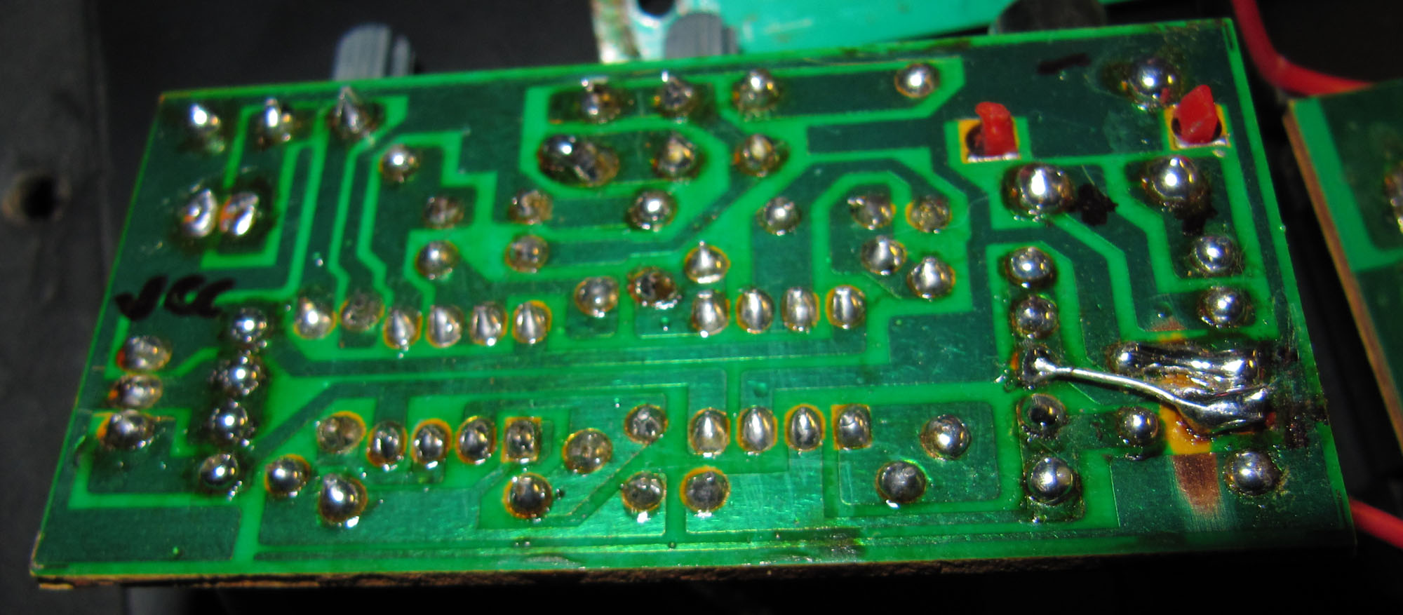

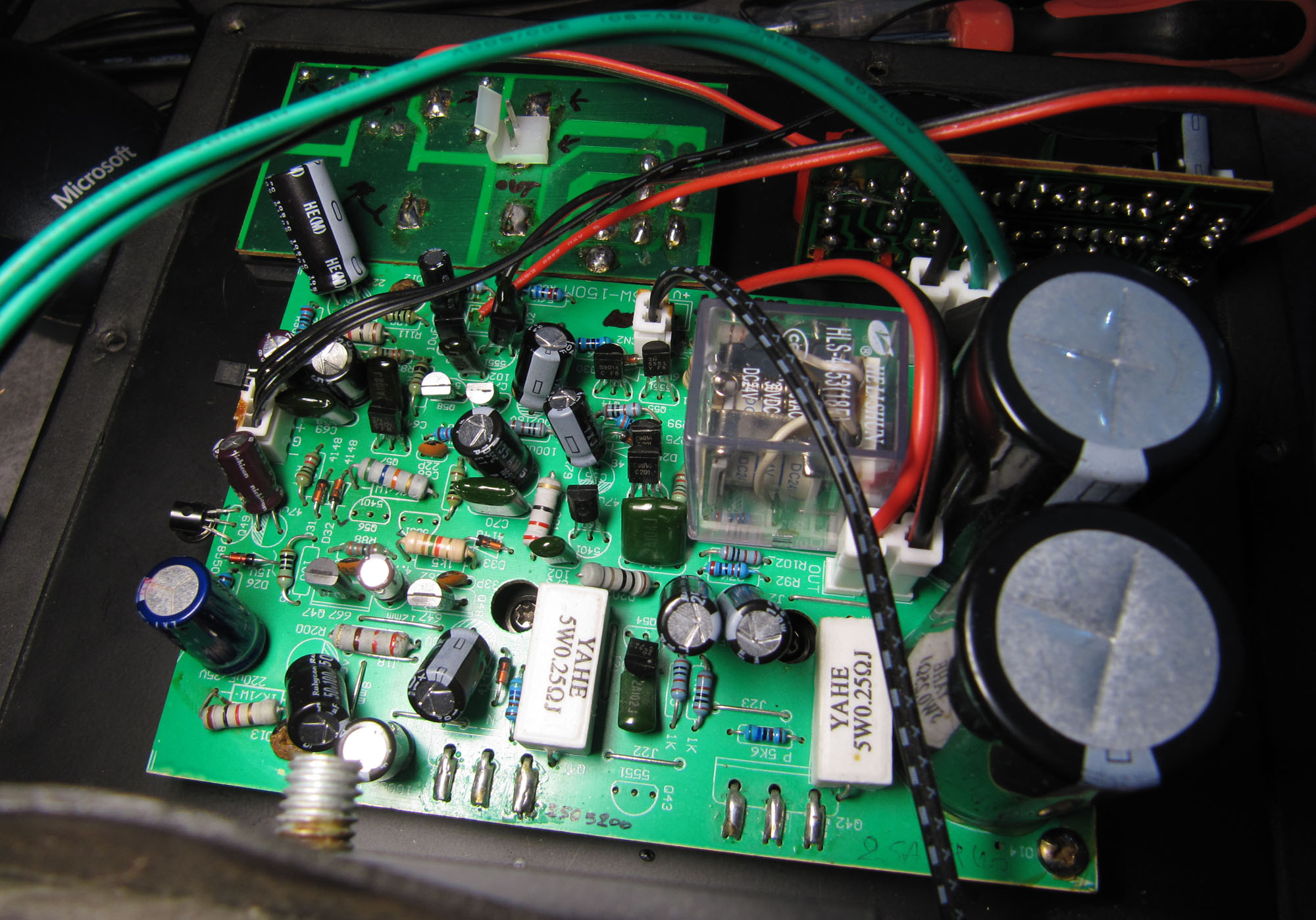

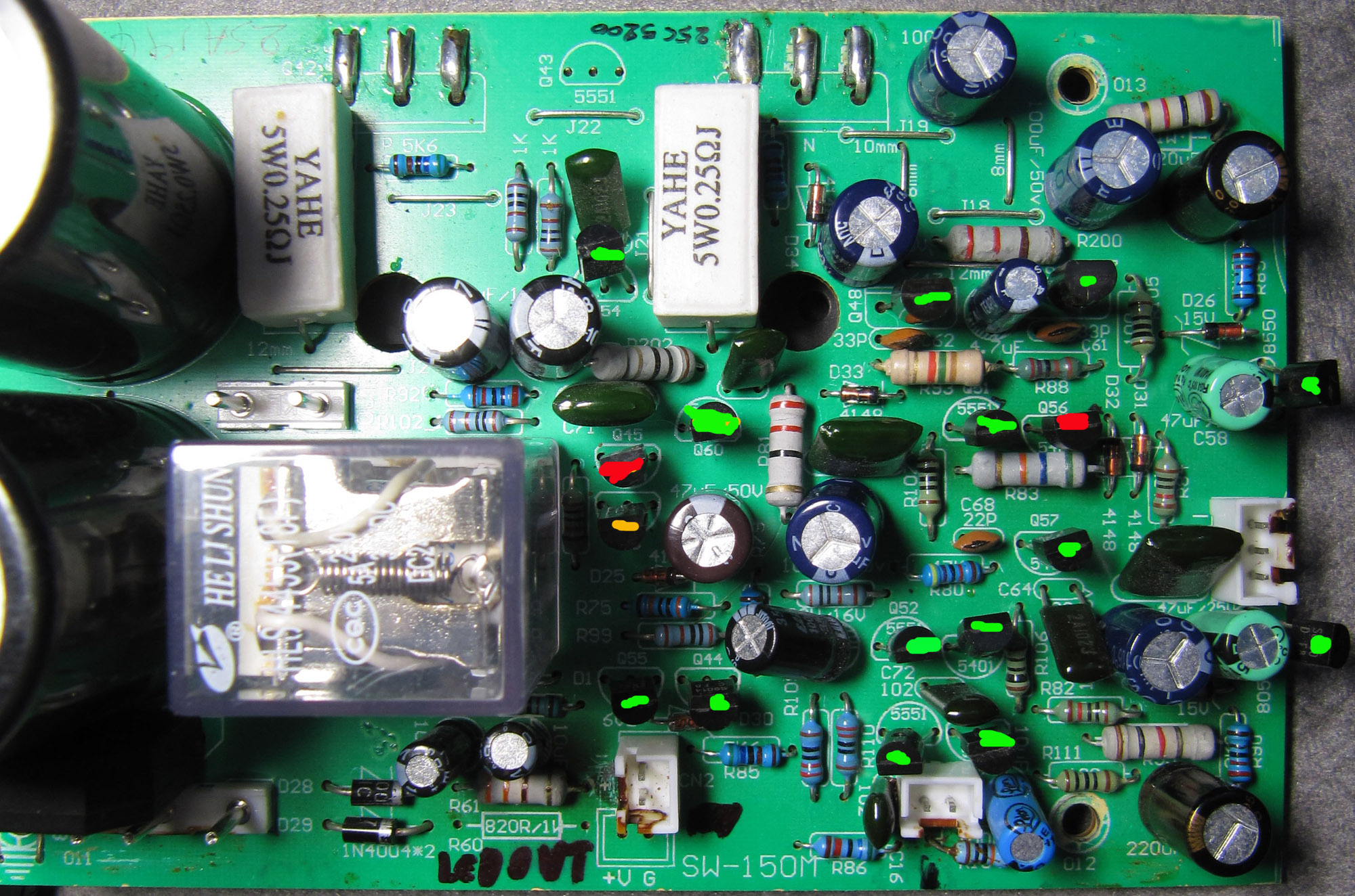

    First I checked the woofer, hooked it to the speaker output of a cheap Philips Mini Hi-Fi system and verified it is not damaged.
    Then started checking every component on the amplifier board and found 2 bad and 1 that when testing with multi-meter found values slightly off so replaced all 3 of them anyway
    https://www.badcaps.net/forum/attach...1&d=1642457710
    green color means component OK
    yellow = suspicious
    red = bad

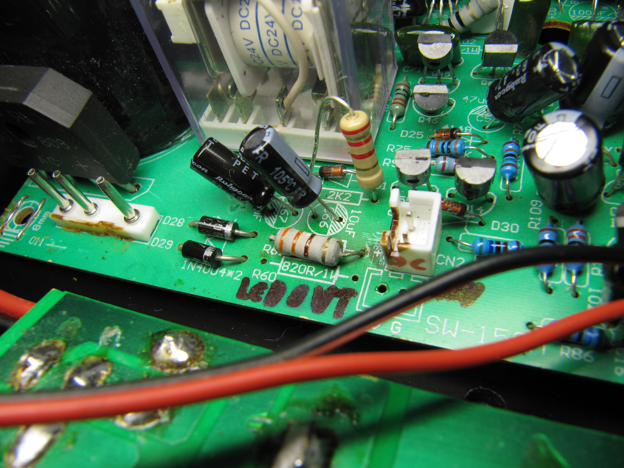

    The components that I replaced are 2n5401 and S9014. Total repair cost less than 2€
    I also carefully removed that terrible glue that gets conductive and corrosive.
    Then checked subwoofer and it works!

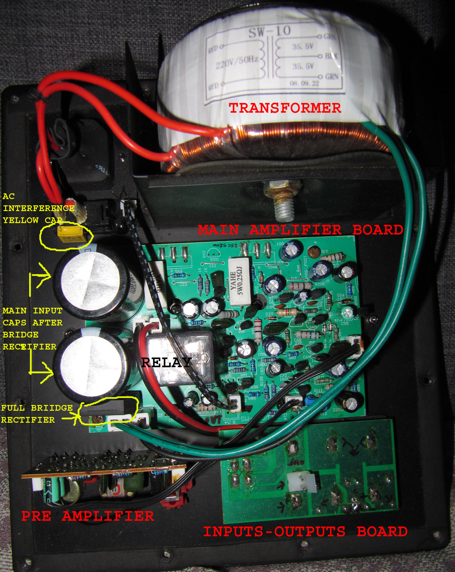

    But now I have to decide what else needs to be done to help the unit not die again.
    I have noticed on this forum that active subwoofers of different brands and price range are prone to amp failure due to a variety of reasons such as bad caps, overheating because the amp is in an enclosed space with limited airflow.
    I also noticed something absolutely stupid.

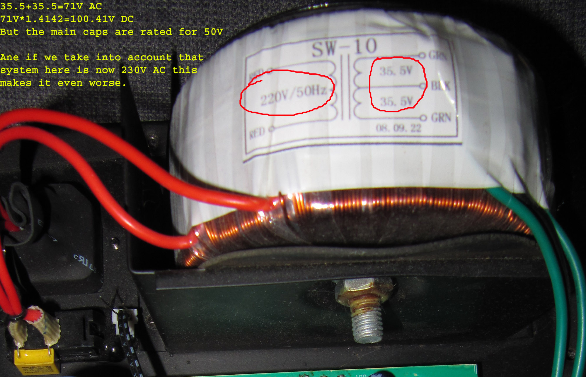

    As you can see on the pic attached, they used 50V rated main caps but the transformer outputs 71V AC.
    I tested voltage across the caps with multimeter and each one had around 50.2 to 50.5V
    But this unit has been working for years and the caps tested with my esr/capacitance/leakage testers and were perfectly fine.
    Buying new caps rated more than 50V and keeping original capacitance of 12000uF or even going one size more to 15000uF , will make the total cost too high and getting this subwoofer for 40€ wont be good deal anymore.
    What do you think I should do? Leave them alone? Do you think that the fact that the sub was made in 2009 and the caps lasted all those years means that they will probably be OK?
    Caps are 2x 12000uF 50V Panasonic CE 85C

      No you don't multiply 35.5V * 2, it's simply 35.5*1.41 and if the max DCV of the capacitors are 50V you have no room for error. With high quality capacitors that 50V is the "working voltage" (instead of "max voltage") this is fine, as long as you don't exhibit long durations of higher than nominal line voltage. If you have cheap underspecced leaky capacitors your capacitors would have exploded already.
      Seems you got it working, congratulations. Unfortunately it's hard to say what design issues there are without a schematic, or at least I have no vested interest in reverse engineering this, sorry.

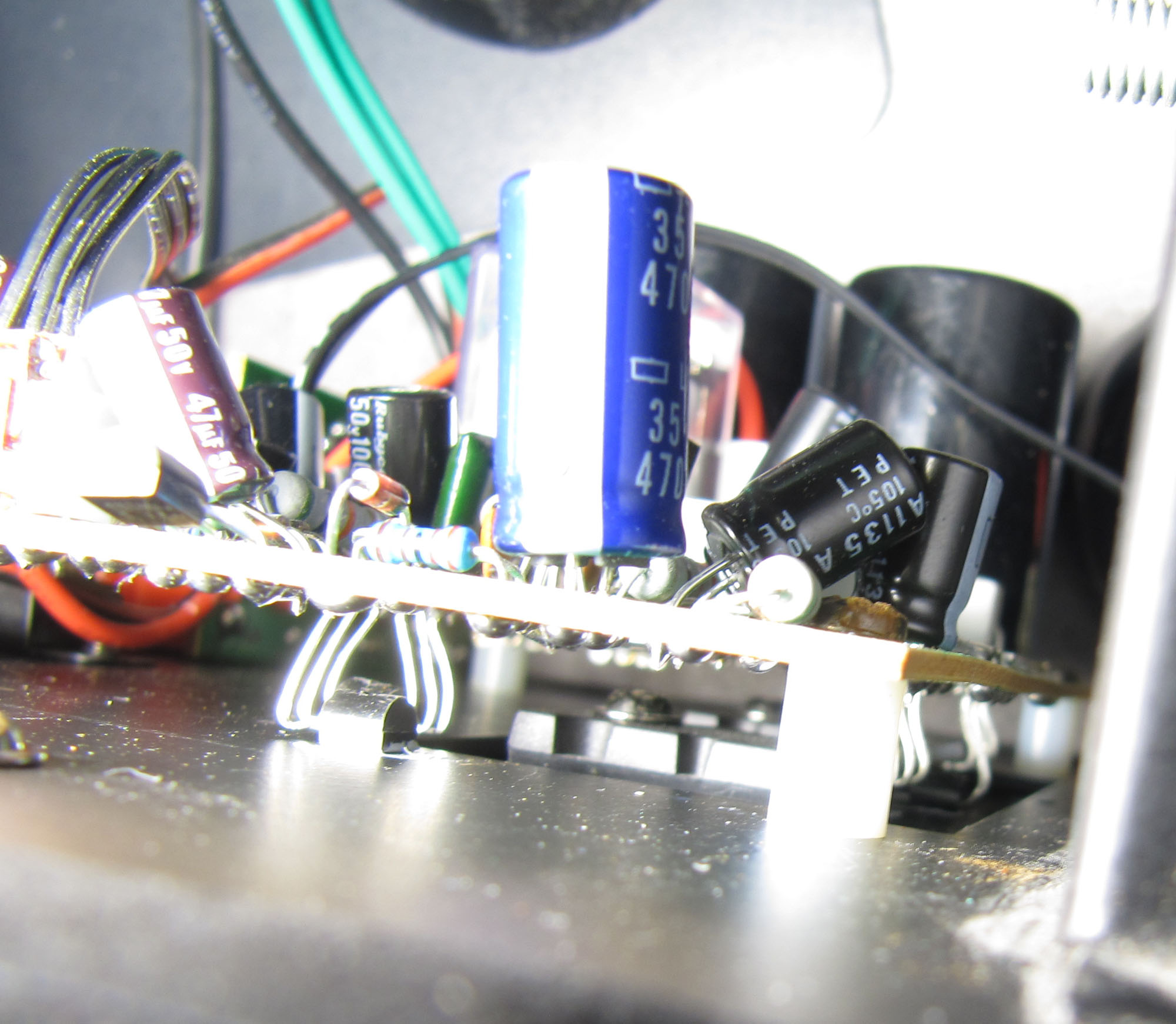

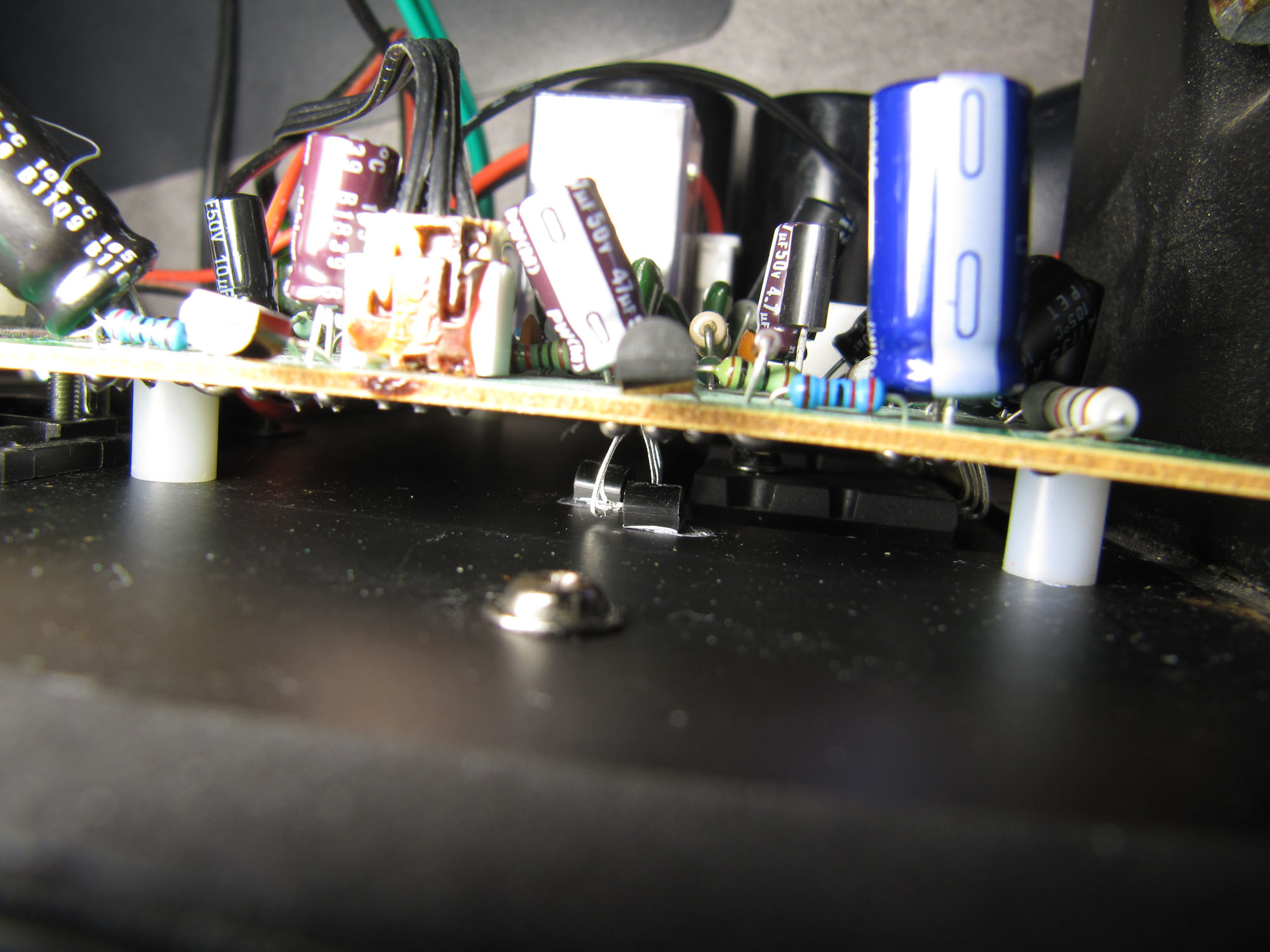

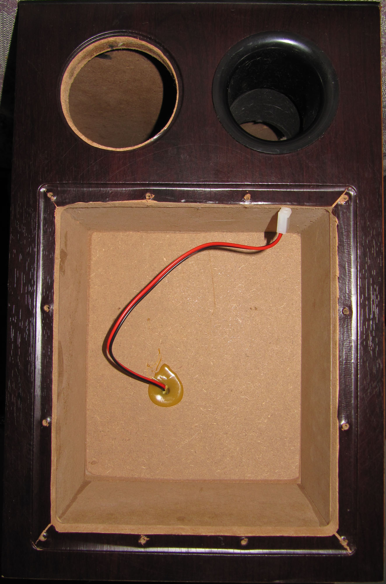

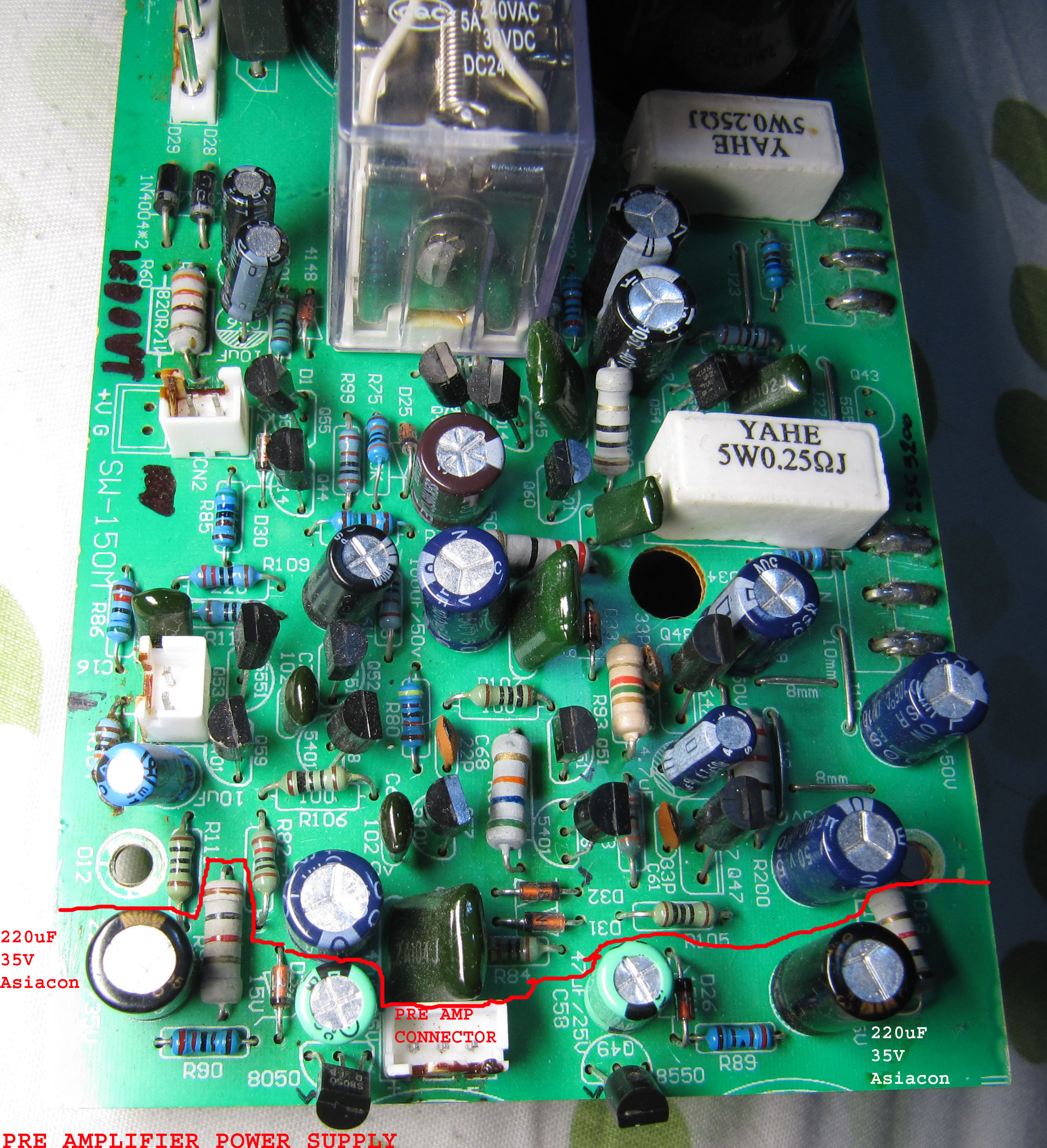

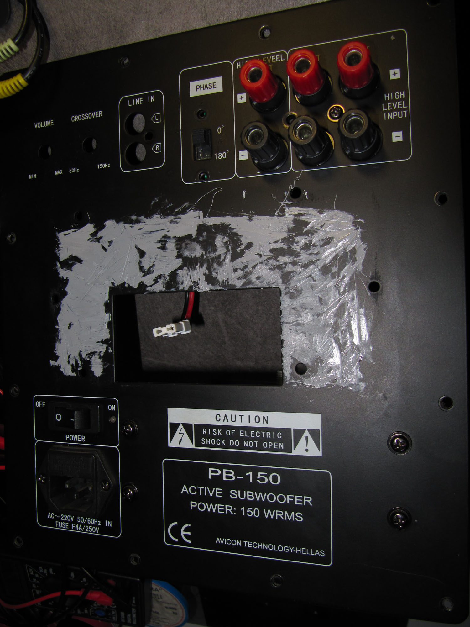

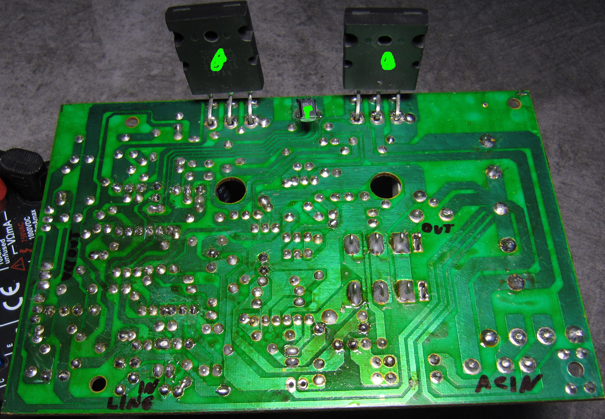

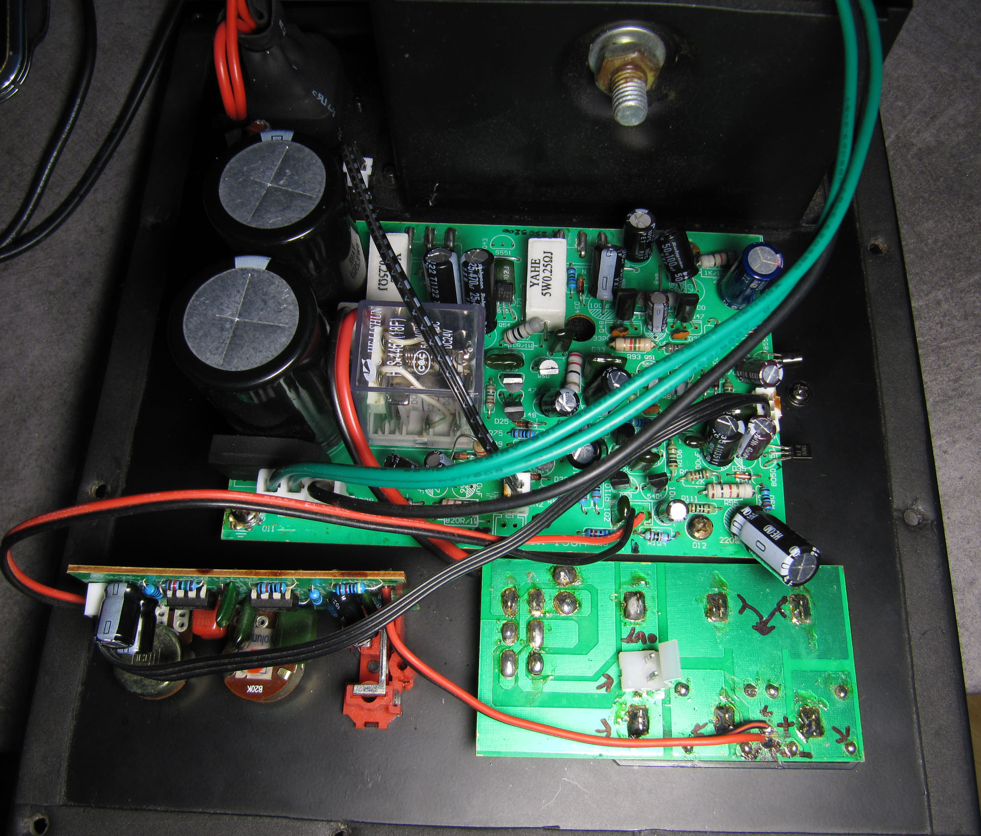

        Anyway, I think that the reason of the failures is mainly the fact that all the components that you see here:
        https://www.badcaps.net/forum/attach...4&d=1642457707
        are totally sealed:
        https://www.badcaps.net/forum/attach...2&d=1642379917
        I have seen quite a lot of subwoofers, several cheap plastic pc speaker ones and only a couple of more expensive like this, including Yamaha, Creative, Altec Lansing, Logitech and more. I have never seen a design like this, where the amplifier is air tight sealed.
        Usually the amplifier parts get fresh air through the subwoofer bass reflex port(s) and there is quite a respectable amount of air circulation when the subs are used at moderate to high volume.
        On the contrary, this thing is totally unable to take advantage of the woofer movement.
        Yes, there is the classic metal heatsink that is outside the subwoofer but only 3 components are attached on it: 2SA1943 2sc5200 and 2N5551.
        So the big resistors could be actually cooking nearby caps and the TO-92 transistors.
        Can you please tell me if this is some type of novelty, totally sealing the amplifier parts ,or you've seen it on other subwoofers too?

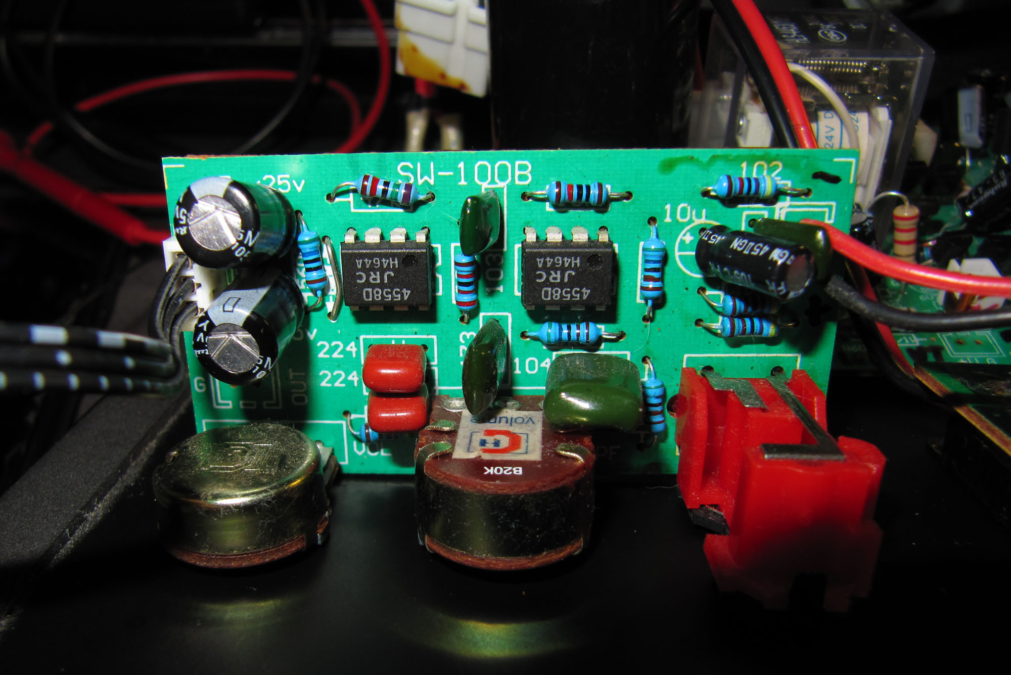

        I attach pdfs of all the silicon of the amplifier board and the preamplifier board.

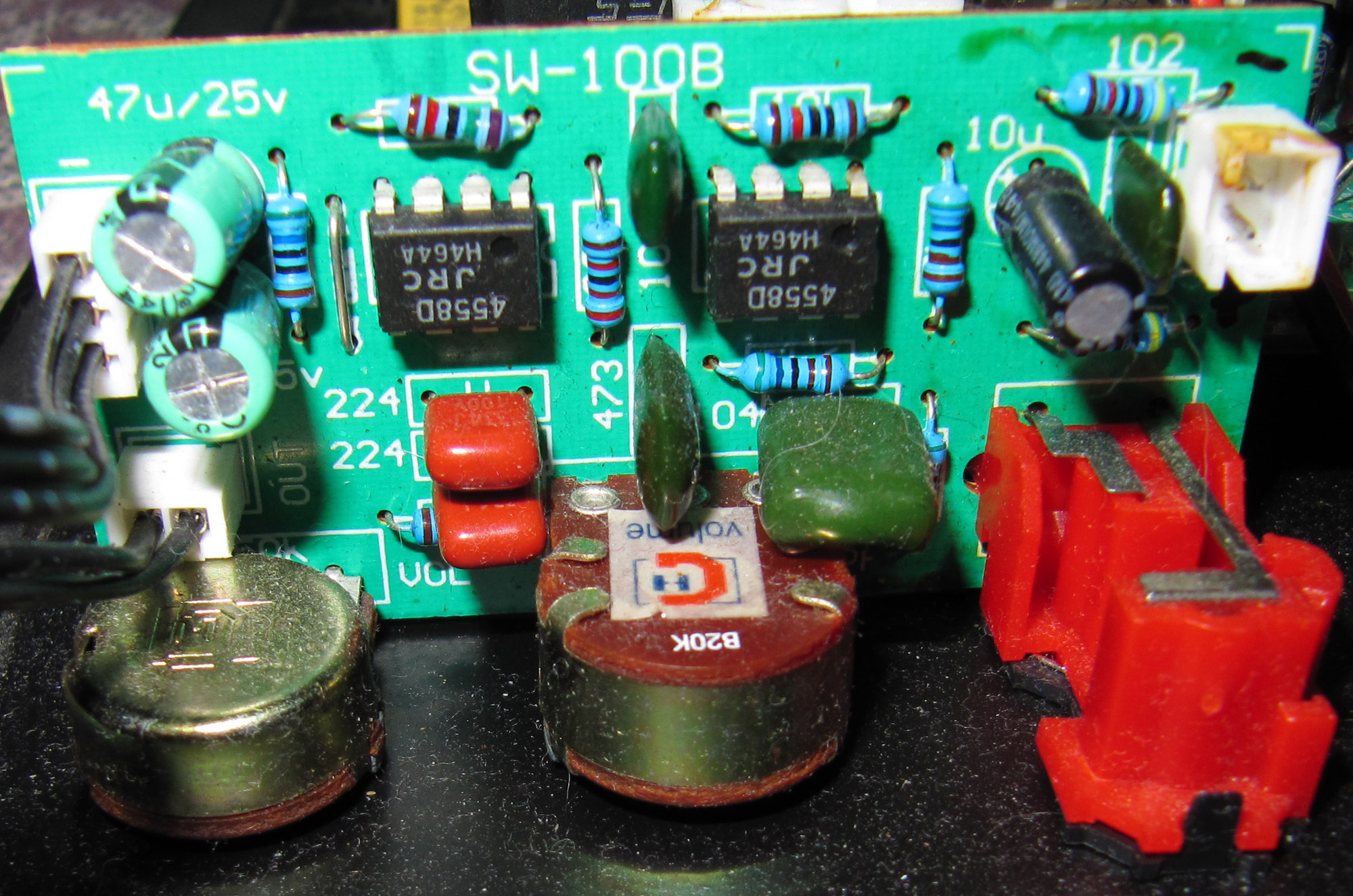

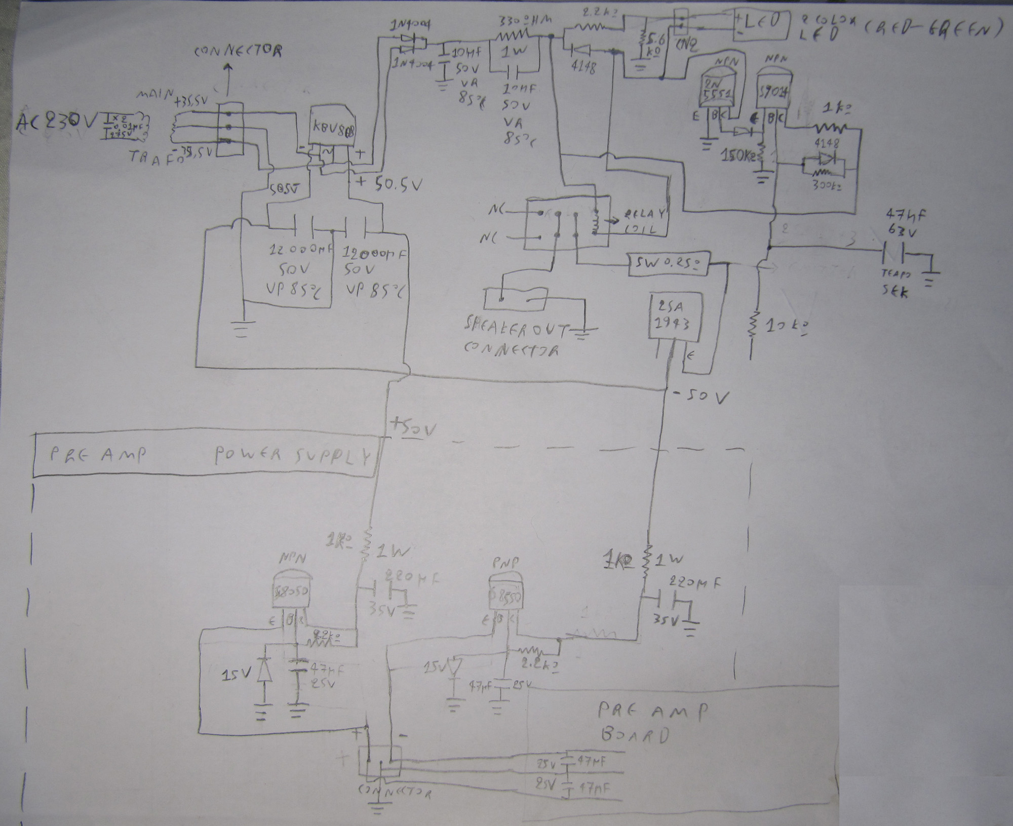

            Well, if these two transistors burned... and assuming that's what went wrong the first time around... then they must clearly be undersized for the task. The question is, where are they lacking? It could be the power dissipation rating, it could be the current... or maybe even the voltage, despite nothing in the circuit being able to provide a voltage that high.
            So to answer that, check what these two transistors are connected to. I suspect you're going to find these are the "linear droppers" for a complementary +/-12V supply for the op-amps. Since the transformer seems to have only one set of complementary output (the +/-35V AC taps... meaning 50V DC, as you found), then that means somewhere on your main amp board, there will be two transistors that generate the +/-12V (or could be up to +/-15V) rails from the +/-50V DC of the big caps. I only see small TO-92 transistors from the pictures you provided (except for the main output drivers, of course), so that means two of these TO-92 transistors will be tasked with generating those lower voltage rails. And because they would be dropping close to at least 35V DC (well, possibly less if there are any resistors in front of them to "assist" with the power dissipation), then it really wouldn't be too hard for them to overheat and fail.
            Thus, I suggest you find which transistors generate your pre-amp complementary power rails (+/-12V or however much) and see if these are the ones that failed. If yes, switch them out for bigger transistors, like B772/D882... and maybe have them connected on an aluminum piece of heatsink, since they are enclosed in a box with no ventilation.
            **EDIT**
            I had a quick trace around the circuit, and Q56 seems like a possible pre-driver for the big 2SC5200 transistor... so probably a little too week for it.
            /edit
            This is very similar to what I saw in a pair of JBL S412PII active speakers I posted about here:
            https://www.badcaps.net/forum/showthread.php?t=73625
            ^ For those, the main caps were rated at 63V and the transformer was outputting about 42V AC (59-60V DC after rectification.) The speakers were from the early 2000's and I did the repair in early 2018... so they lasted about 15 years - and that's with those main caps being CapXon brand.
            So FWIW, you probably could leave those caps in there, provided your AC line doesn't spike up a lot and too often above 230V. But IMO, it's not a good idea. According to several Panasonic cap data sheets I've read: if you run a cap at or very near its rated voltage, the chances of the cap failing increase a lot more (typically the cap may fail open-circuit.) And in my case above, one of the caps was indeed failed open-circuit. Granted it is CapXon and not a good brand... but I just don't like the idea of caps running that close to their rated voltage. For my repair, I used 80V caps. As for your model, I suggest going up a notch in the voltage to 63V... and if you wish to keep costs lower, perhaps lower the capacity one notch. 10000 uF caps should still be plenty adequate for the 150W RMS of one lone speaker driver.
            are totally sealed:
            And you're probably right.
            Yeah, I like subwoofers that do this. It's much easier on the electronics, especially if they are indeed located near the port(s).
            Again, have a look at the thread for the JBL S412PII above - it's the same thing with those plastic boxes on the plate amps.
            One reason why the electronics on really high power amps are sometimes enclosed in a box is so to keep air from escaping and making "whistling" noises through various holes on the plate amp (like knobs, switches, input jacks, and etc.) Otherwise, they would have to pot the whole thing in glue. Also, a separate box may reduce resonance noises produced by the plate amp. But yeah... the tradeoff is a box full of hot electronics.
            And again, since I don't see anything but TO-92 transistors anywhere, I imagine it's the linear power supply droppers that are running too hot and dying there. On the JBL S412PII, these ran mad-hot... and they were in TO-126 packages. The heatsinks I added probably barely mattered... but better than nothing!

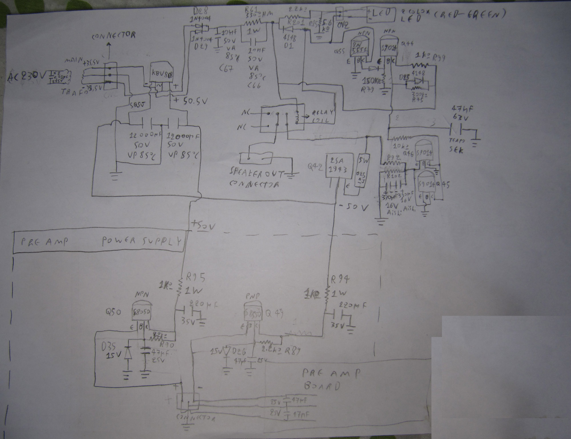

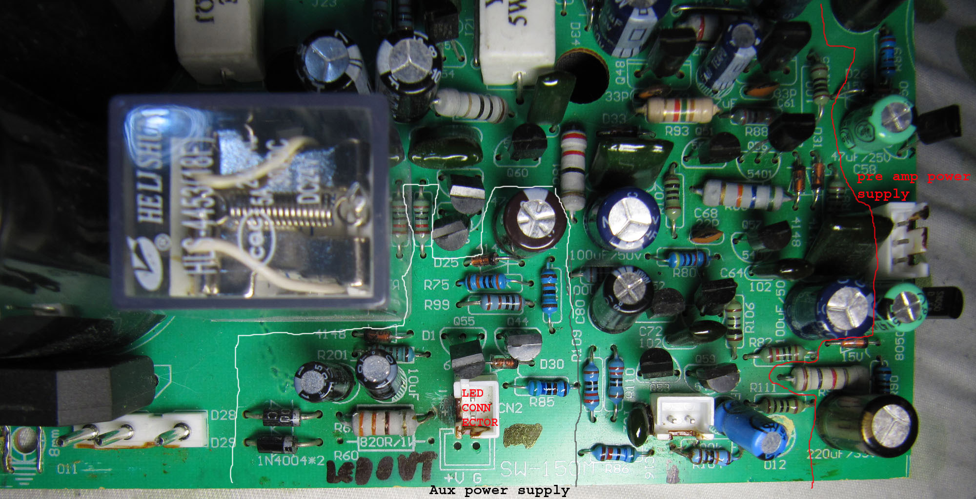

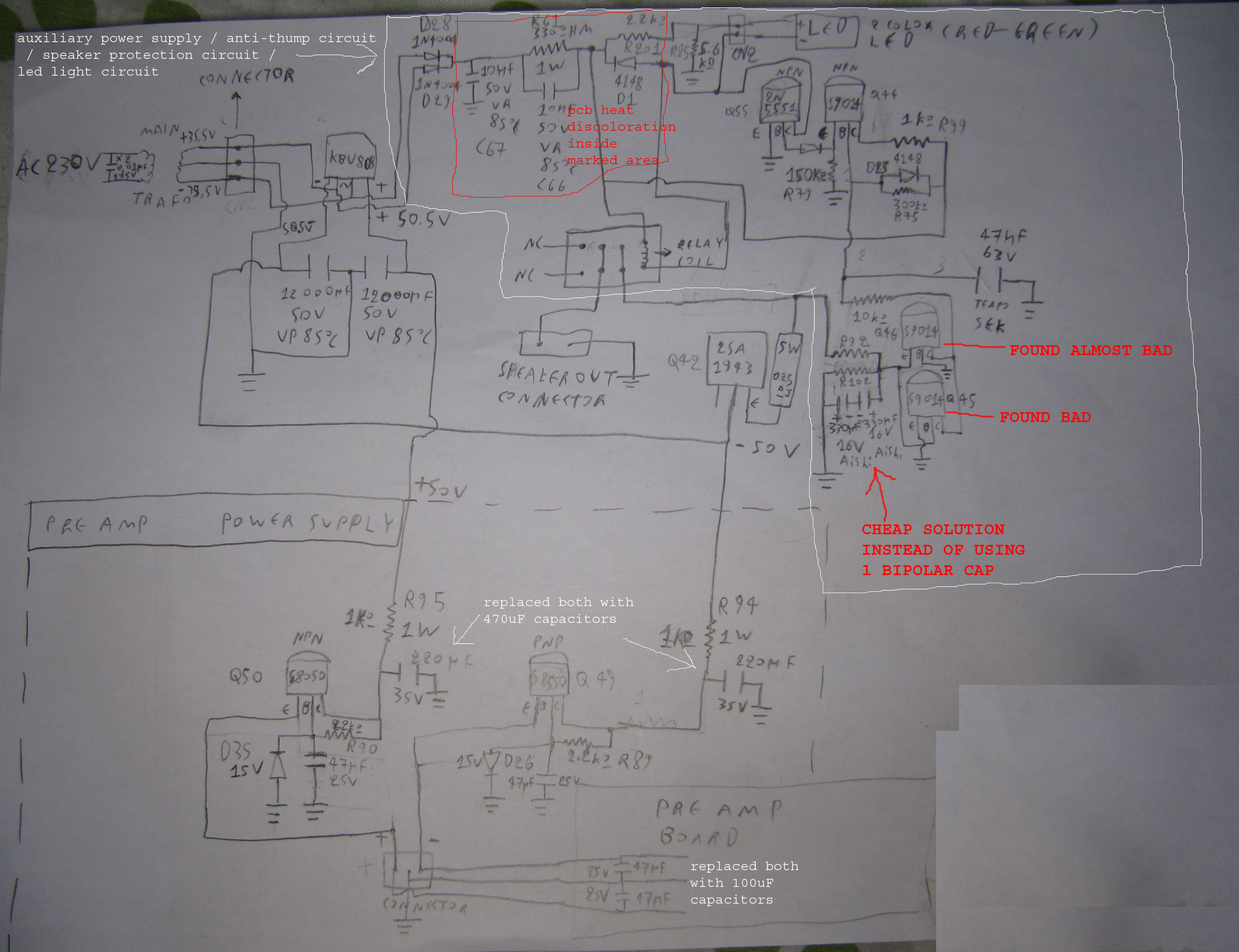

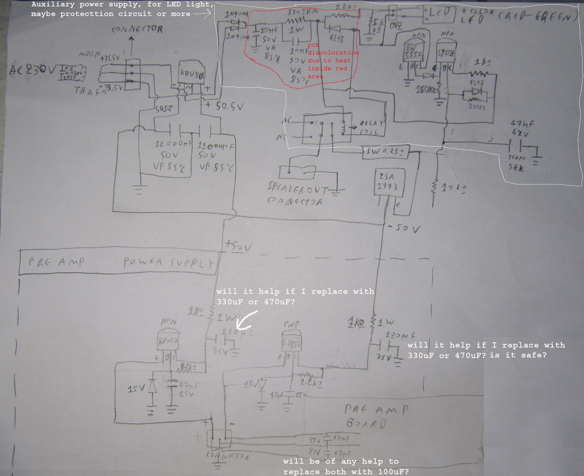

                  I drew a partial schematic of the thing.
                  I focused on the power supply of the pre-amplifier and an auxiliary power supply that I am not sure how it's used. I am sure that the working led light of the unit is powered from this aux psu. It's a 2 color led, red color to show it got power and green light when everything is OK and the relay connnects the amp to the speaker. So, I thought it might also be part of a protection circuit.
                  On the links I posted above with the Chinese boards that use the same main complementary transistors, it is strongly recommended to add some type of protection to avoid damaging speaker in case amp blows.
                  Unfortunately, you will not find on my drawing none of the 2 transistors that failed.
                  It is getting really late here, so I have to go to sleep now, but I promise that I will return to read again your posts and thoroughly reply.
                  I also attach pics with the areas that I was able to reverse engineer marked in circles to help you understand my terrible work.
                  As you can see on the pics and the drawing, based on their role on the circuit, I am thinking to change some cap values with higher to help the audio quality and more importantly lower the stress / overheating of some parts.

                    Re: Roister Pb-150 Subwoofer repaired, how to prevent from failing again?
                    Most of the schematic you drew is the PSU.
                    As far as I can tell the discolored area is the auxiliary power supply for the anti-thump circuitry to prevent the speakers from bumping when powering up... so none of the known failed transistors are here or is it drawn?
                    Seems this auxiliary PSU will constantly draw power and thus heat up as long as the amp is powered up and after it connects the speaker after the power settles, so I'd expect that 330Ω resistor along with the two transistors in the anti thump circuit would constantly be drawing power and heating up though tough to gauge how much the components would heat up - maybe a little, estimate indicates the semiconductors may be brunting part of the heat while pulling the relay.
                    • eccerr0r
                      Solder Sloth
                      • Nov 2012
                      • 8680
                      BTW it would be nice to put component designators like Q45, C3, R6, etc., etc. so we could textually mark which device we're talking about.
                      I don't think any of the capacitors that you query in the schematic - whether increasing capacitance would affect things much. You might improve audio quality if you're hearing hum but this would more be of a PSRR issue of the preamp, otherwise it may increase turn on time.
                      The two transistors drawn in the upper right of the schematics are what I'm slightly concerned about. These will probably heat up. Question next is where does that 10K resistor on the right of the drawing go... to prove that's the anti-thump.

                        Correct, I also checked the traces and they are connected. There is a big resistor R83 56K 1W that could also generate a considerable amount of heat making things worse for Q51 and Q56. What if I unsolder it and solder it from the other side?
                        Or else, solder Q51 and Q56 from the other side of the PCB and make them touch the external heatsink of the subwoofer? Is this crazy enough?
                        The external heatsink I am talking about is this:
                        https://www.badcaps.net/forum/attach...3&d=1642379917
                        Look at this pic:
                        https://www.badcaps.net/forum/attach...5&d=1642457707
                        The transistor in the middle, Q43 2N5551 was originally mounted to the heatsink with thermal paste. They didn't use any enforcing method other than its legs though. If I understood correct, this transistor should be touching the heatsink to provide some type of thermal feedback to the driving circuit for the main transistors to avoid burning them, or something like that.
                        So, why not try to do the same with Q51 and Q56? Solder them on the other side of the PCB, apply some thermal paste, then screw board trying to get them to make contact with the heatsink?

                        Well, if the failure is always those 2-3 small transistors that you replaced, that's probably not due to pushing the design too far, but rather pushing cost-savings too far with using really small transistors.
                        Actually, now that I mention this, it may also be worthwhile to check the pre-drivers for those large transistors. Are those TO-92 stuff too? If so, that's just too cheap. Again, I would expect to see transistors with packages more along the lines of TO-126 or bigger.
                        All transistors are TO-92 except 2 transistors: D667C and B647C, those are TO-92 Mod.

                        • goodpsusearch
                          • Oct 2009
                          Exactly
                          Precisely.
                          Now, we know that 1 of the 2 failed transistors, Q56, is part of the pre-drive circuit of the main large complementary transistors 1943 and 5200.
                          You are right, that was necessary and I failed to do it. I will try to add on the next version of schematic.
                          It goes to the collector pin of both Q45 and Q46 S9014 that one of them was found bad and the other affected too and replaced both. These are the ones with red and yellow color, located near relay:
                          https://www.badcaps.net/forum/attach...0&d=1642457707
                              done
                              Please check the new version of schematic attached bellow.
                              Please check schematic, I added the rest of this circuit at last.
                              Now, that we have the circuit of Q45 and Q46 complete, can we expain why Q45 and Q46 failed?
                              The area has no PCB discoloration implying overheating or parts like big wattage resistor next to the failed transistors. So, why they failed? They also don't appear to be connected to the other part that was found failed, Q56...
                                okay... now that Q44-Q46,Q55 circuit looks more like protection and integrated anti-thump. The two weak/bad transistors appear to be the protection portion but if the schematic is correct they shouldn't be very stressed under normal situations (i.e. if the PO transistors didn't die) ... but what are the values of R92 and R102?
                                  R102 1Kohm
                                      Finally found the time to finish this!
                                      The subwoofer is perfectly working and can get really loud. It's nothing like the mediocre Yamaha YST-SW030 that I fixed in another thread. This thing can really shake the house
                                      Here is the schematic with some comments about changes I made:
                                      https://www.badcaps.net/forum/attach...1&d=1645390601
                                      Replaced R201 , 2.2kohm, with same value, 1watt resistor.
                                      I could do the same and replace R61 that is 330ohm, 1 watt with 2watt resistor but I just tried to move it far from the nearby caps.
                                      If you check the pics, you might notice that I tried to do this with every component that generates some heat: move it away from capacitors or other hot components that would make it get more hot and even fail.
                                      Changed C67 10uF 50V with 22uF to lower the ripple of the power supply of the anti-thump/protection circuit.

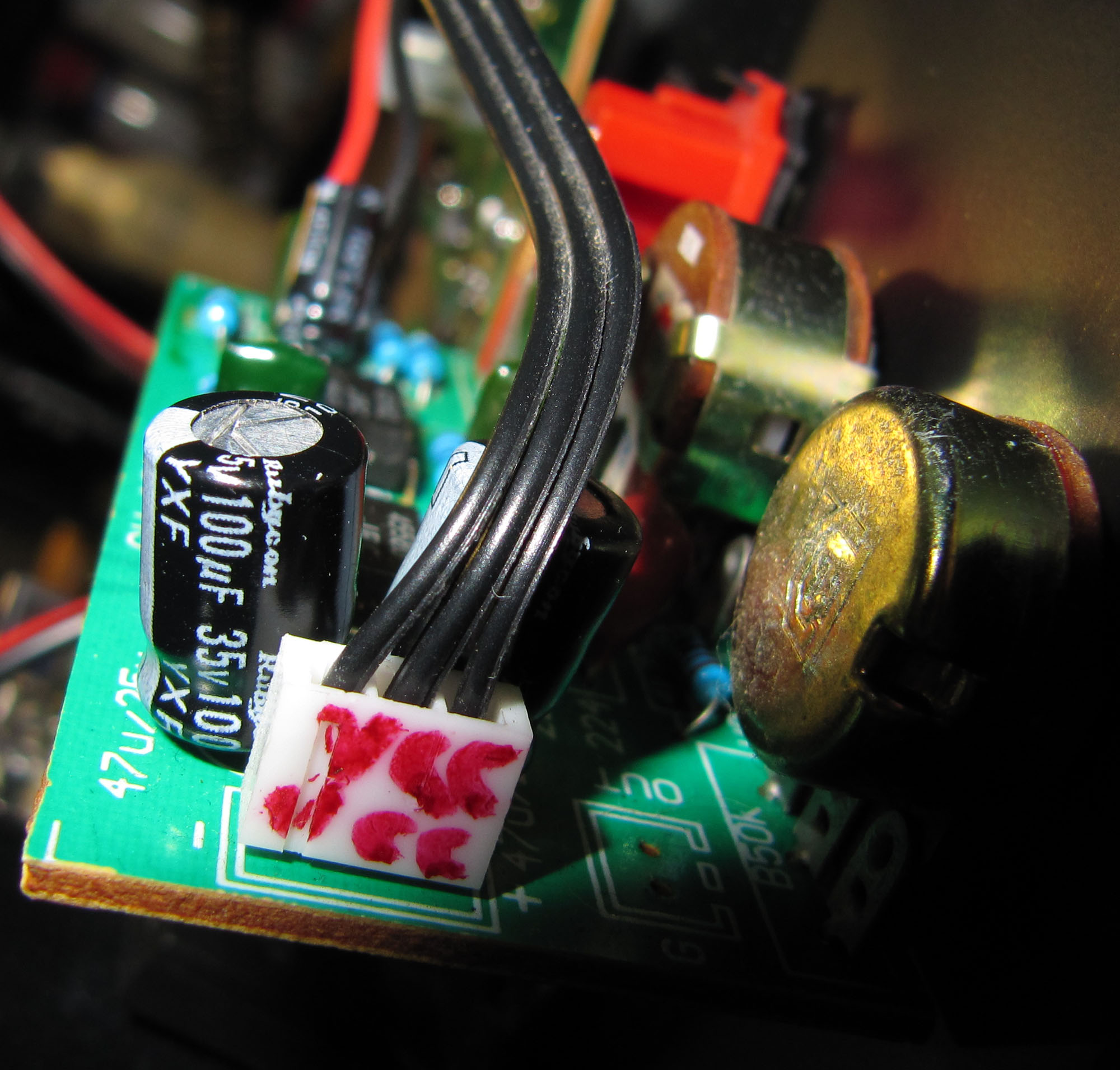

                                      The 2x 25V 47uF caps located on the preamplifier board were upgraded to 2x 100uF Rubycon YXF. This might increase audio quality.
                                      https://www.badcaps.net/forum/attach...7&d=1645390461
                                      https://www.badcaps.net/forum/attach...9&d=1645390461
                                      I left unchanged the 2 transistors S8050 , S8550 that drop down the 50V and -50V voltages for the vcc of the preamplifier board but I bent them to be as far away as possible from PCB.
                                      https://www.badcaps.net/forum/attach...1&d=1645390461
                                      I also upgraded 220uF 35V caps with 470uF 35V on that circuit.
                                      I soldered 2 pre-driver transistors from the other side of the PCB and attached them on the heatsink with generous amount of thermal paste
                                      I think the best fix would be to replace them with equivalent TO-126 parts but I didn't know how to easily find TO-126 transistors with exactly the same characteristics.
                                      D667C and B647C, possibly part of driver circuit of amp normally should have been replaced with TO-126 equivalents too but were left unchanged for the same reason as above.

                                      I should note that all of the original caps that I removed were tested with ESR micro and Chinese component tester and I found that some of them had started going high ESR and somehow high V leakage.
                                      I also redid every solder connection and I applied large amounts of solder and created ugly solder balls to help with the overheating of the big wattage resistors and transistors.
                                      I also replaced the terribly thin AWG28 cables used to transfer the audio signal from the preamp board to the main amp board and banana plugs board to the preamp board. I used AWG24 speaker cable from some cheap Philips speakers that were part from a 90s mini Hi Fi system from Philips . If I ever need to use those cheap Philips 2 way speakers I will use some heavier wire, because I think AWG24 is too thin for speaker cables, but perfectly fine for interconnect cable.
                                      The AWG28 cables used to power LED and preamplifier board were left unchanged.
                                      Last, I tried to thermally couple the amp heatsink with the metal cover of the sub applying tons of used thermal paste that I recovered from other projects
                                        Cool, it's great that you made this. Now anyone who may have this subwoofer can actually have a schematic for a reference.
                                        Was that resistor running hot? It seems like it feeds nothing else except for the LED (when it's ON)... though through doing some very quick & rough calculations, it's possible it may be dissipating up to 0.33 Watts (1/3W) when the sub is On... which if the original resistor was rated for 1/2W, then I can see it getting a bit hot. 1W definitely sounds safer.
                                        I did that to the JBL speakers - replaced the 330 Ohm resistor in series with the relay with same value, but 5W resistor, IIRC. In my case, the relay was 12V, and it was fed from the 30V rail... so the resistor was dropping ~18V, which equates to ~1 Watt of power dissipation. The 2W used originally was getting quite toasty.
                                        As for your Roister PB-150 circuit, I tried to do some calculations, but it doesn't quite add up. Assuming stable 50V DC comes out before R61 and the relay pulls down R61 on the other side to 24V level, then R61 will have approximately 26V across it, dissipating a little over 2 Watts! But I don't think that's the case, though, or you would have seen a charred resistor. I'm thinking more along the lines that perhaps the relay coil is getting a bit "over-driven" - possibly up to 30V. This should leave only 20V across R61, dropping P_d to 1.2 Watts... which honestly is still a lot. So perhaps it could be over-driven even further? Or perhaps the 10 uF capacitor isn't enough to provide a steady 50V DC, and that further lowers the overall DC voltage? Whichever way I look at it, though, it's honestly a mystery/mess to me. There really ought to be better ways to design that circuit and not use many/more/pricier parts.
                                        That's actually for the relay's coil supply and LED.
                                        Keep an eye on it after running the amp for a while. Higher capacitance could mean more stable (and thus higher) DC voltage... which may or may not increase the heat given off by R61... though at 22 uF, it's probably still not big enough to matter.
                                        These two caps filter the +/-15V rails for the pre-amps... so if anything, this should further decrease any line hum from going to the pre-amps. It may or may not bring noticeable results, depending on if the old 47 uF caps were enough for the filtering task or not (probably OK, given the +/-15V rails are linearly-regulated.) But the extra capacitance doesn't hurt here, so the upgrade is a good thing.
                                        Anything helps at this point.
                                        You'd have to draw a schematic of the output stage and pre-driver stage, then maybe compare it with circuits from other amplifiers. It's probably using a Sziklai pair configuration on the output, like many other amps are. So you may be able to copy-pasta the design of another amplifier (or at least use the biasing/resistor values to get an idea of what you might need to modify.)
                                        But hey, if the subwoofer isn't burning out when you're cranking it up hard, then I guess let it be.
                                        All the capacitors were replaced with Japanese caps of low ESR series, 105C (hopefully not too low ESR to cause issues).
                                        Nah, it's an audio amplifier, it won't matter. You can even use polymers and it probably won't care. Just good luck finding any 50V-rated polymers... or at that high of a capacity.
                                        That aside, you may want to glue some of the larger caps down (or ones with very long leads), because the vibration from the subwoofer may eventually damage their seals on the bottom. Probably won't happen in many years if at all, since you used Japanese caps... but generally, it's a good idea to glue down any heavy components in a subwoofer amp, due to the vibration. Regular household/bathroom silicone should be OK to use if kept away from metal pins and parts, due to being slightly corrosive while it cures. For places where you have to glue over metal parts, there are non-corrosive silicones for electronics... or just plain hot glue.
                                        So, what do you think?
                                        Excellent!
                                        That actually should help with the power dissipation quite a bit.
