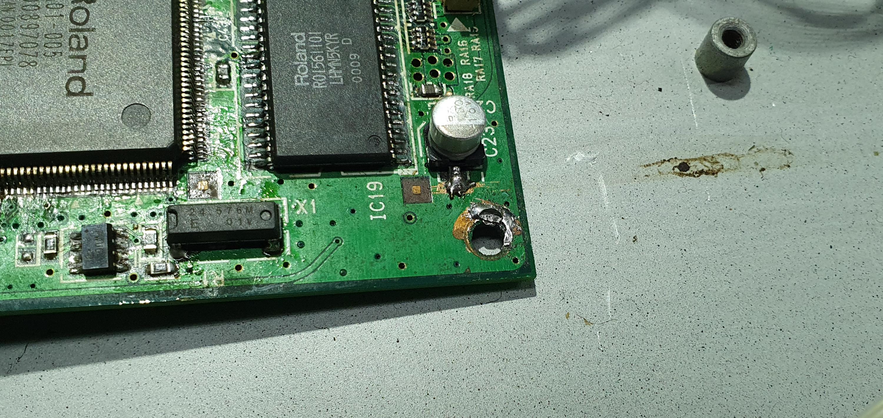

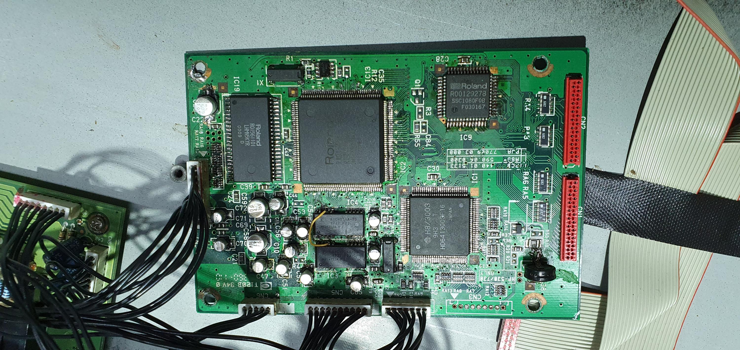

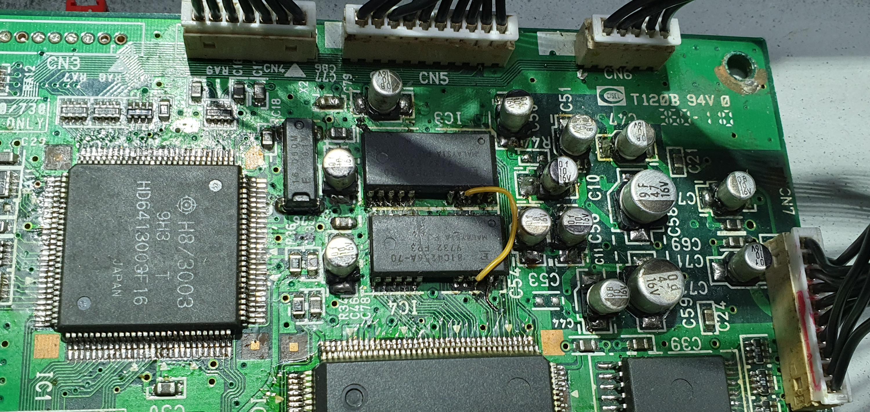

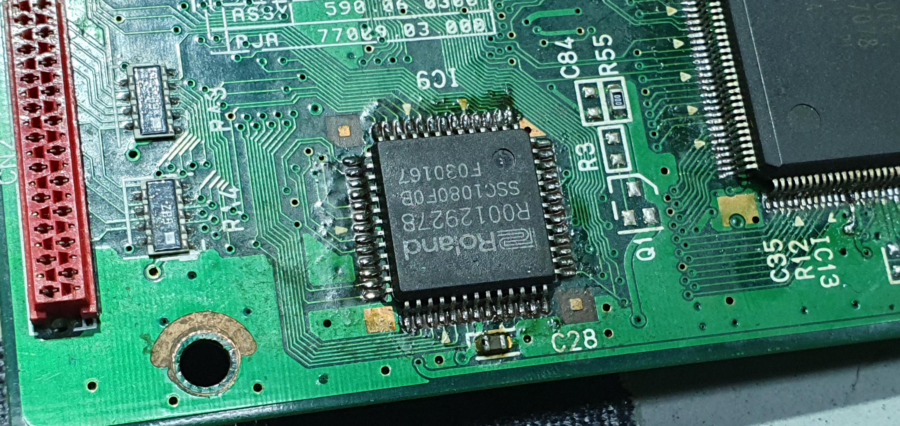

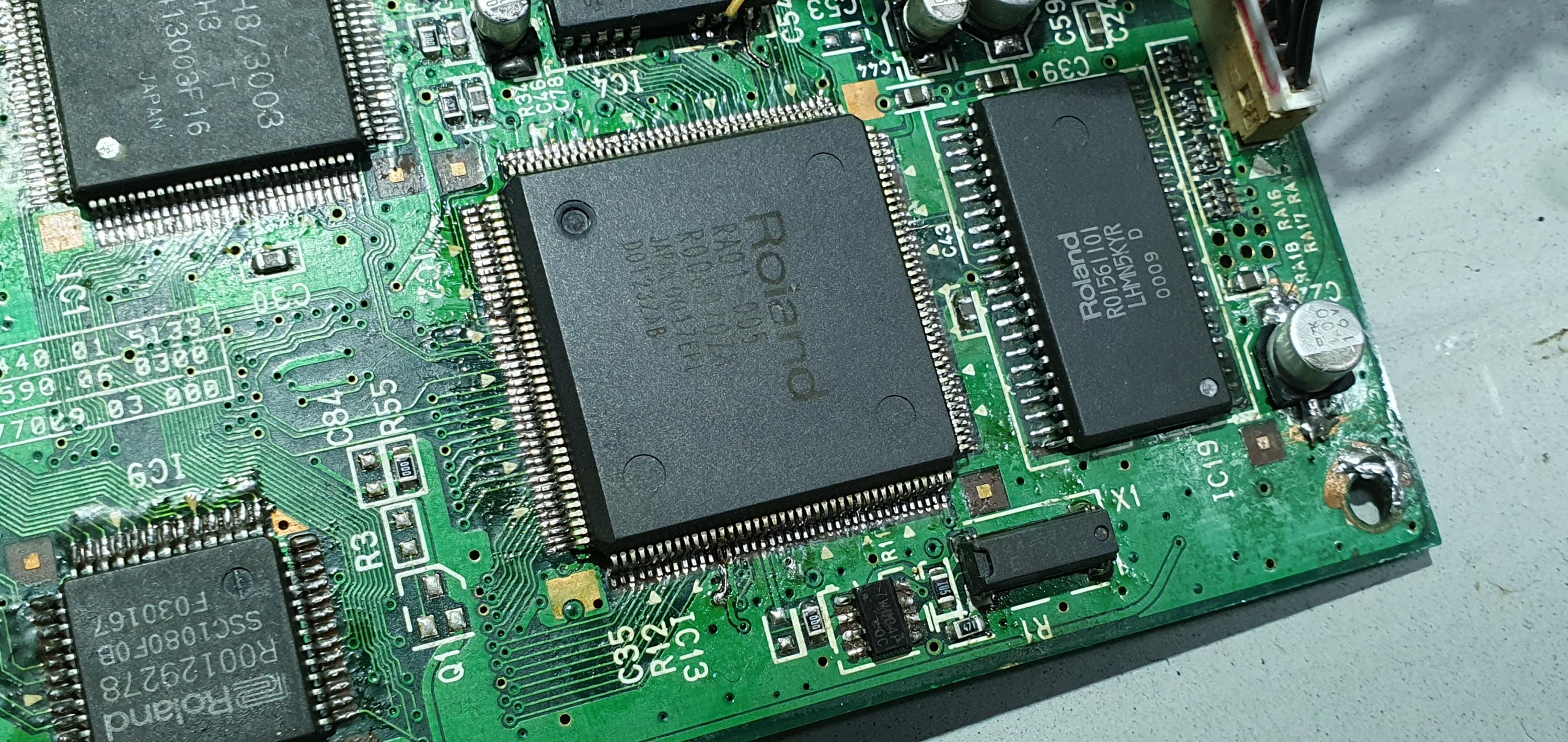

                          Re: Electric piano distorted notes (Roland RD100)
                          Ok guys, after a ridiculous amount of time, today I decided to crack open the piano to have a look inside. As you can see, the damage done by my "skilled" co-worker (who thankfully retired in the meantime) is quite extensive: there's almost no component that hasn't been touched with the iron and he broke some traces and had to repair them using jumpers...the list goes on. I mean I was expecting it to look bad, because it IS this guy we're talking about, but not like this !
                          Upon seeing this, I was just about ready to stop and put it all back together, but I decided to at least do what I suggested in the discussion and that is to try and "listen" to the signal at various points to try and close in on the component that's causing it to sound rough, if at all possible: I tried it right after IC7A and IC7B (page 9 of the manual) and sadly the same thing happens: the audio is an absolute mess of pops, which tells me the problem is likely somewhere in IC15 or before it and unfortunately this is where my knowledge of audio electronics and test equipment at my disposal also stops. Even if I DID find the culprit, it all proprietary parts with no way of sourcing them, so this piano is only good as MIDI controller or spare parts ATM. Cheers.
