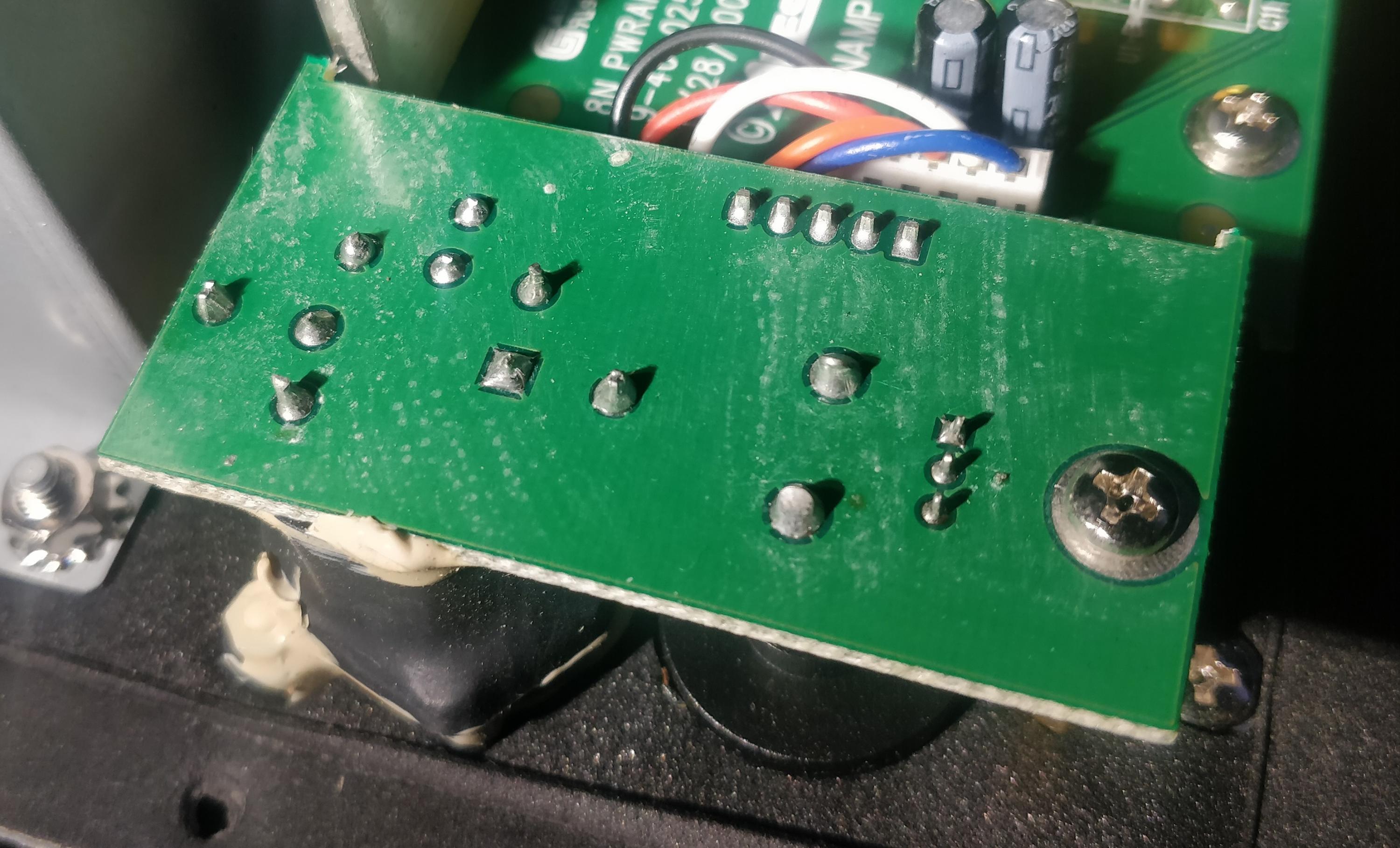

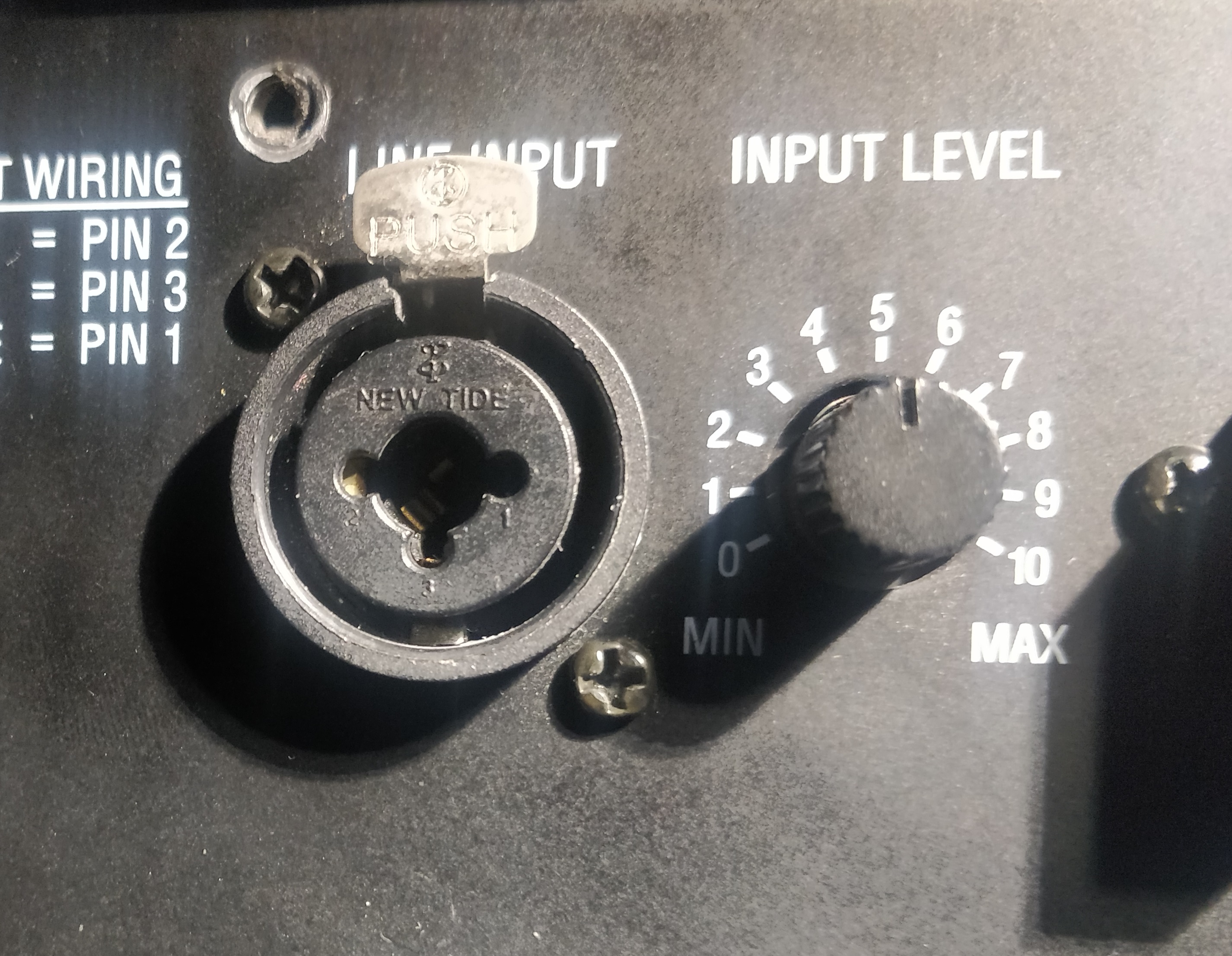

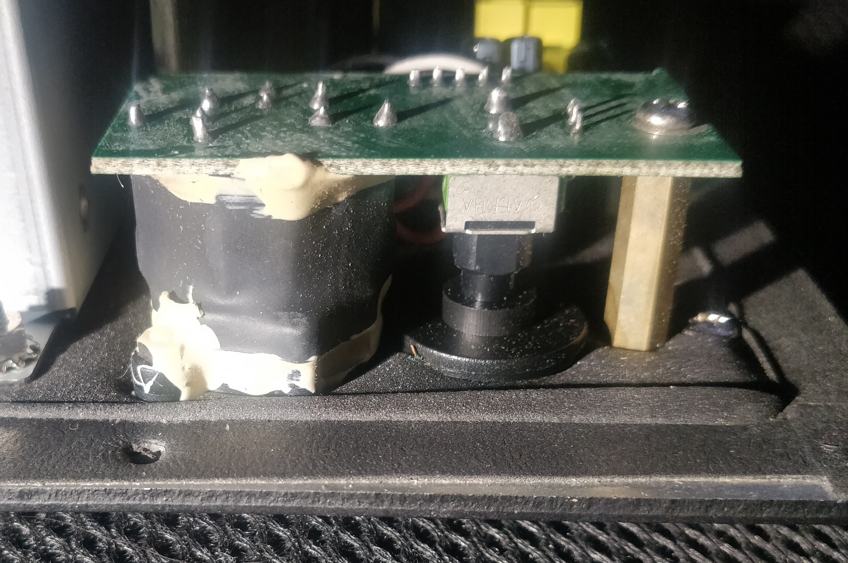

                Re: Repairing Alesis M1 MK2 Monitor Speakers
                Originally posted by Khron
                The connector is indeed PCB-mount (not solder-cup terminated), and is an NCJ6FI-V (Neutrik Cannon Jack, 6 pins, Female, I series, vertical mount).
                It may or may not be some "custom" version with a couple more mechanical-support pins though, but i can't be 10000% sure. The one i have here has the connector covered in some heatshrink and glued at both ends (where it meets the rear panel as well as the PCB), in order to minimize air leakage and potential air noise when playing loud bass notes.
                Full disclosure - might've slightly mis-spoke there. At least on my pair, the connectors are actually "New Tide" branded (have fun finding out / figuring out the part number), but they are regardless PCB-mount and vertical (not solder-cup terminated as in the earlier eBay link).
                As mentioned though, as opposed to the Neutrik options, these do seem to have two extra mechanical-reinforcement pins that are connected to ground.
                See attached photos regarding the heatshrink+glue treatment.
