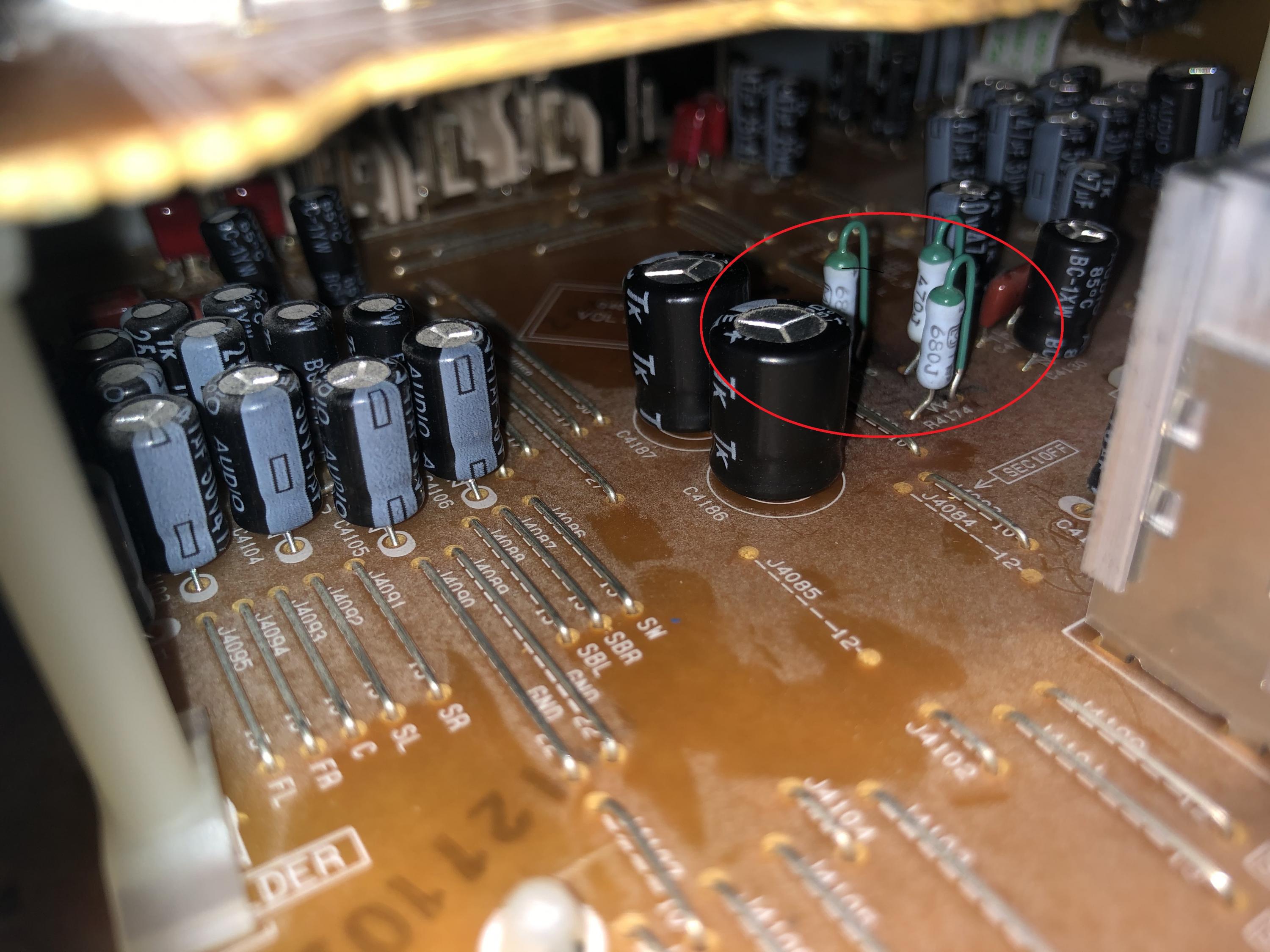

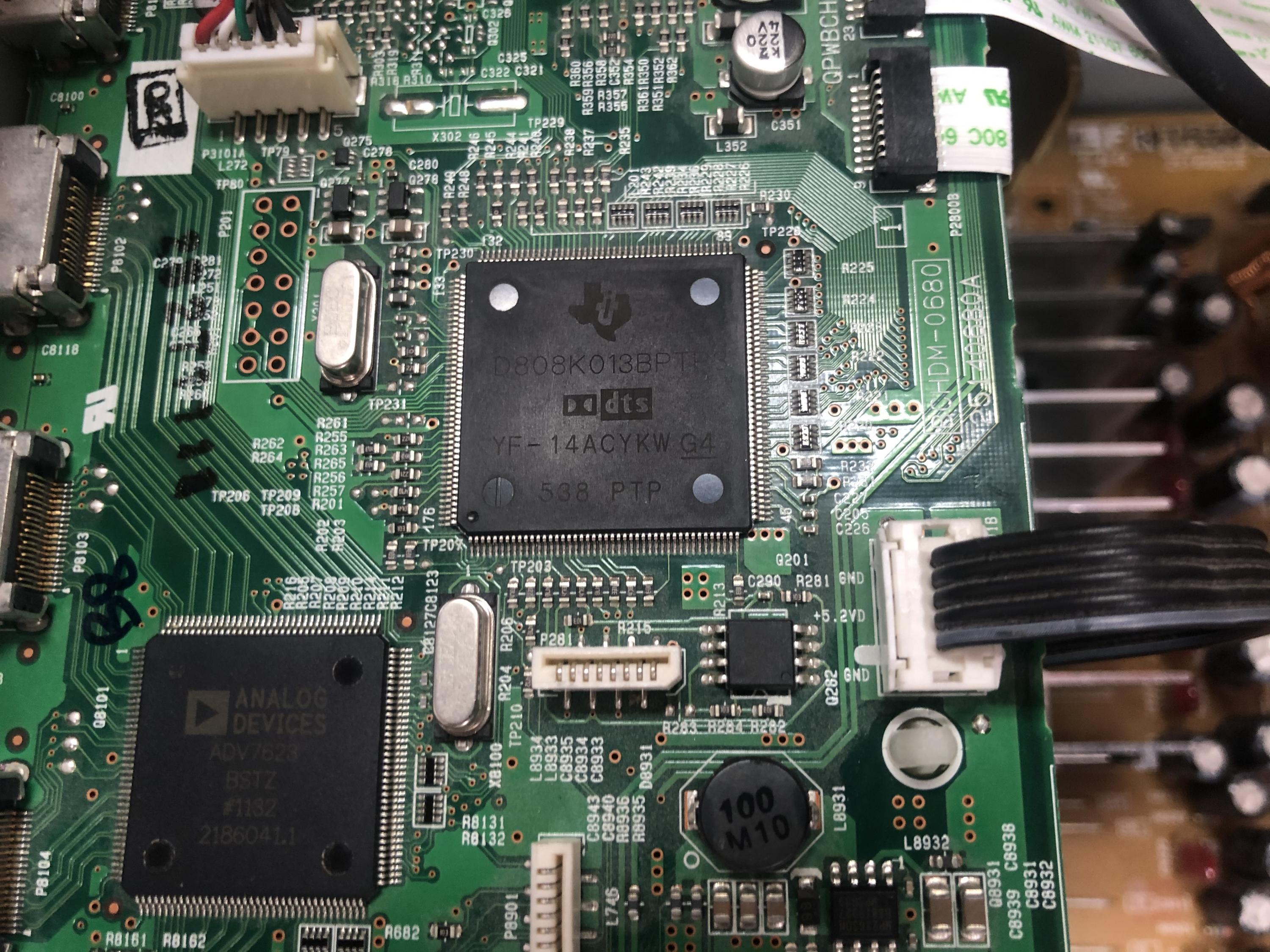

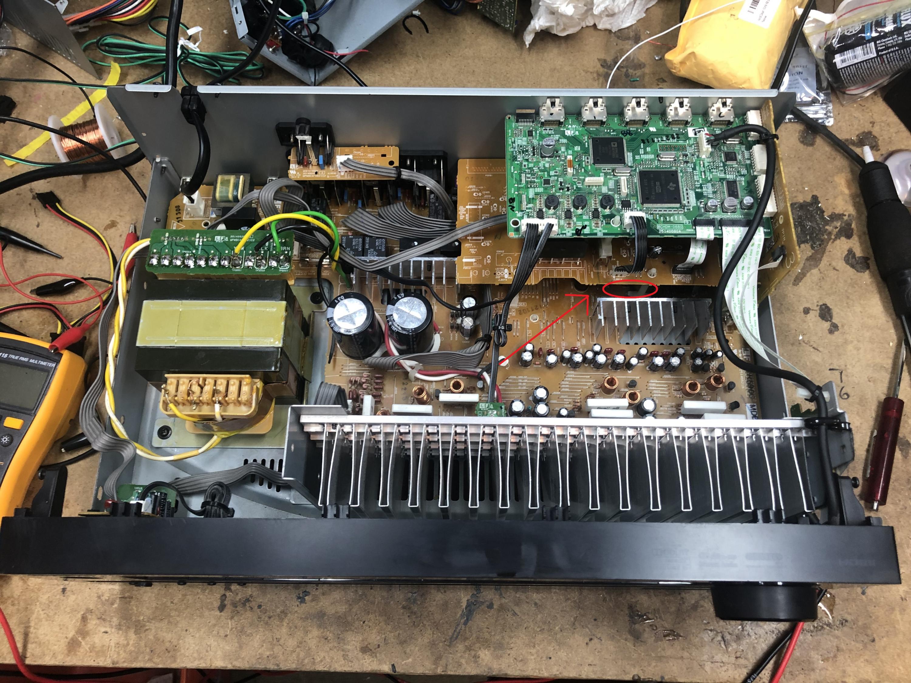

    HT-R590 No Sound
    Another Onkyo no-sound complaint, only a little late for warranty help
    My HT-R590 stopped outputting sound of any kind. Everything else seems to work (display on, HDMI video inputs/outputs to TV, AM/FM tune into correct stations). The TI chip on the HDMI board is wirebound, not BGA flip-chip. It is D808K013BPTP3, which appears to be in the list of TI chips from this link: https://cdn.badcaps-static.com/pdfs/...12b2bc512f.pdf
    Is this suspect (it's a rev.B chip, which seems to be part of the global issue)?
    Otherwise, any suggestions for debugging? I can hear multiple relays clicking when I power on the unit. I have measured the transformer primary and secondary voltages (it looks like 40 volts to the AMP board, I think nearly 100V to the power amplifiers on the large heat sink). I have the service manual and have been crawling through the schematics looking for anything interesting. The only sign of damage is a slight burn mark on the AMP board near the resistors for the +/-15V regulators, which is very near the undermounted R2A15218FP input selector chip. It just seems like the signal is not getting to the speakers (or maybe not even through the main amp, but I don't know how to tell). Any suggestions on where to probe next (I have good DMM and o-scope)?
    Thanks!

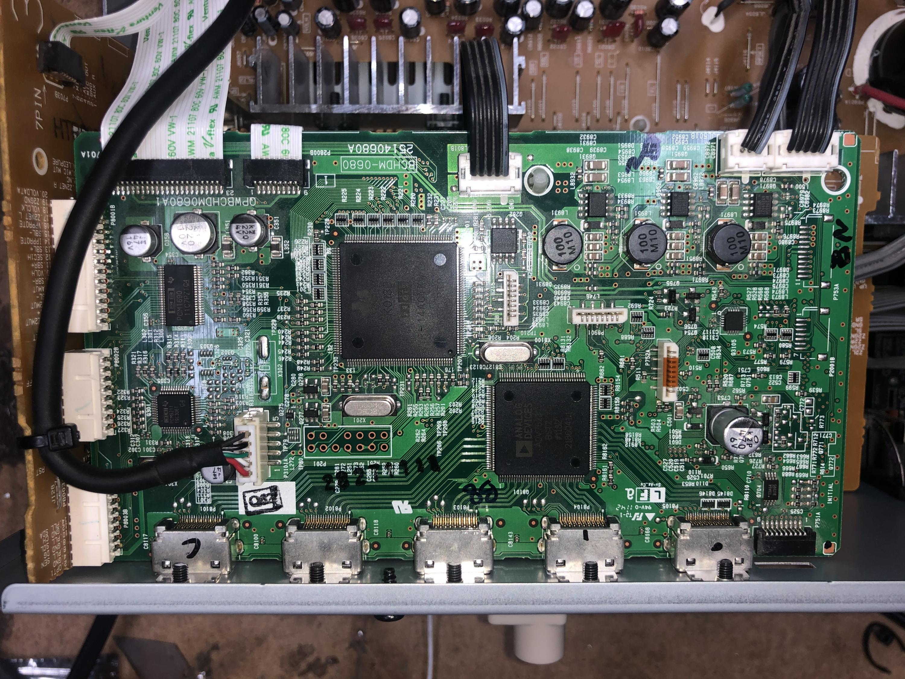

    Re: HT-R590 No Sound
    Adding some pictures, although I didn't take them when I had everything disassembled. The red circles/arrows point to the burn marks (the resistors, diodes, and caps in the area all measure fine when I had them de-soldered from the board).

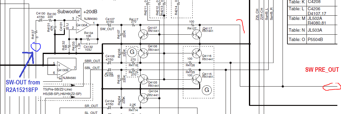

      Check out the subwoofer pre-out for signal. If I remember correctly, it's signal should come straight from the volume control/input selector IC ( the RA... one ).
      Just be sure to select a dsp mode which should use that output ( and to have the subwoofer activated in the amp's settings ).
        I don't recall ever seeing the speaker icons on this display (the manual doesn't show that as an option either). I actually looked for that when reading about similar issues with the TX units, but I think it's one less feature on these HT units.
        I checked the SW (subwoofer) PRE-OUT. I've got 0VAC regardless of which "music" mode output I'm in ("Direct" mode makes a relay toggle, I'm guessing that's as raw as it gets?). The sub is enabled in the menus. I plugged the sub in to make sure I wasn't getting any signal, and I also attached probes to the other end of the sub wire (fwiw, there is 20k resistance across the +/-).
        In the service manual, SW PRE-OUT comes from an op-amp (NJM4580), which is sourced from R2A chip, at least according to service manual (pic attached).
        Thanks!
            Right, checked the user manual - no speaker icons.
            About the subwoofer signal - yes, makes sense other components to be involved since its signal is generated by the "smart part" ( my bad, I was thinking about the FL/R and zone pre-output signals ).
            So, check page 4 of the SM - this is the analog signal flow chart.
            To see if the R2A ic is doing its job to switch the input signals and send the analog audio for digital processing, probe pins 47 and 48 on q301 ( the small square IC on the hdmi board, close to the connectors ). On those pins you should see/hear the selected input signal ( a DSP mode should be on ).
            Once the signal is processed by the "smart part", it is converted back to analog by q351 and fed again to the R2A.
            Try probing that processed signal on the side board that connects the HDMI with the main board.
            On that board there are several NJM4580 ICs. Q401, pin 1 is front left, so check if there is anything there ( it should be something similar to the input audio/analog signal ).
            And finally, on q6001 ( a power amp IC ) pins 14 and 15 are the FL and FR inputs, where you should also be able to see the analog input signals.
            Since you have a scope, just feed a sine wave signal ( 100hz for instance ) and then probe the above points with it.

              I was able to probe those points. The LTAD and RTAD signals (pins 47 and 48 on Q301) both have probe points on the HDMI card, and I can see a signal that correlates to my FM tuner (I can switch to different inputs and see the signal go flat or change depending on what I have attached). I don't have a signal generator (only a scope), but I have enough information to know that those are working. The AC voltage is ~0.5VAC peak-to-peak, with a 3.3V DC offset, which seems reasonable for an unamplified signal (I really have no idea ). Further, the LTAD/RTAD solder points on the riser card (BCDG-0639) from connector P8002 show a signal and continuity to Q301 pins 47 and 48. So, I think that means R2A is working.
              Unfortunately, those are almost the ONLY test points (solder points) on any of the P8001/P8002/P8003 ports that seem to have a signal. The only other non-zero values are TU_SCL/TU_SDA/~TU_RST (which looks like I2C on my scope, as expected by naming convention), and the 3.3V line. OPTI1 is also at 3.3V. The SPRLF, SPRLCS, SPRLSB signals are all a flat 3.3V, as well as SEC1OFF. More interesting, AMUT and MICMUT are both 3.3V (and I think AMUT is the most interesting of those, given what I've seen in other comments).

                    I'll not be able to help you much with the digital part - my experience ends with determining if the the digital ICs get their proper power supply.
                    By the way, check if the vol/input selector IC is switching the inputs - this will tell you if the main control unit is communicating with it ( like feed analog audio test signal to CD, then AUX, etc. and see if the IC is switching them ).
                    Also check the signal flow chart from the service manual - I think after the ADC, the signal goes through the DSP IC, then to the DAC and back to the R2A.
                    Basically you have 3 ICs which might not work properly or are missing power supply ( ADC, DSP, DAC + ram chip(s) and a CPU which seems to be working at least to a certain extent ) .
                    See if the service/debug mode doesn't have options to diagnose the proper communication between the main control unit ( CPU ), the DSP and the other smart parts ( I'm pretty sure there is such an option ).
                    If the unit has auto speaker setup, then you can use it to generate test signal through all outputs ( which you should be able to probe on the op-ams on the side board ). Such test signal option should also be present in the service/debug mode.

                      I reread through this, and have been spending some time on YouTube. It seems like this unit has some Debug reporting capabilities, but the Service Manual doesn't describe any of the procedure or the field decodes. I do see that the service manual for HT-R591 has a lot more info, but I am unsure if this would apply to HT-R590. Does anyone have more information on how to use the debug modes? One point; the DSP shows all ???, so that's something.
