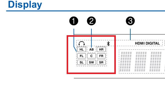

    if no speaker icons on the display - dsp/dts IC dead

      Please explain, I don't have any speakers connected to the avr while troubleshooting. The unit comes out of standby, applies half voltage "warmup" to the power amp section. All speaker outputs are failing self test, so the main enable relay never kicks in. I can try injecting different signals (toslink, hdmi, etc.)to see what the avr detects. I'm new to this unit. How should the front panel icons light up under what speaker condition or configuration option possibilities? I know the unit has audessey and auto tune, but nobody left me a microphone or a remote control.
        Re: Onkyo tx-sr674 no sound
        That icons ( see attached picture ).
        Basically, if that icons do not light up ( try different sound modes.. like stereo, surround, dolby, etc. ) the odds are that the fault is in the DTS/DSP chip*. It does not matter if you have any speakers attached or not.
        *a TI chip which is known to be defective until revision C (or D?) was released
        Indeed those units were sweet deals while the extended warranty was still ongoing.. onkyo would replace the HDMI boards for free without any questions asked.. unfortunately, it was terminated about a year or two ago.
        p.s. Just checked the service manual for your unit and the dsp/dts IC is listed as TMS320D707E001RFP250 which is not present in the official list of defective TI chips... so most likely it is something else. In this case, the service menu is a good starting point.

              What about the speaker icons on the display? Are they on?

                Previously, I did not see the speaker icons on the display. Standby light lit up when plugged into the wall outlet. Press power button and one relay click, face lit up and acted like it was trying to work. No sound, no flashing lights or protect messages. I got into the service menu, and all the speaker checks came up ng. Not 100 percent sure about the display yet, as the unit is still not buttoned and screwed back together. I'll be doing function testing and etcetera after it has more than a couple of screws per board holding things together.

                  Ok, got her all back together and tested. All of the speaker outputs work great, as well as a bunch of the inputs. Analog and toslink work great! HDMI not so great when it start cold, once the receiver warms up, the HDMI inputs fade in. I don't have a speaker icon array on the front display as madan1 suggested. When the unit is cold, and a surround signal is applied, the front display responds with red Dolby words. If you set the display correctly, the detected format will pop up in text. No sound when cold, turning to hash, turning to garble, fading into splattered music, then finally music.

                    Try heating the DSP chip ( https://www.youtube.com/watch?v=HeboYI2qzhE ). If you do not have the speaker icons, then it has nothing to do with the decoupling caps.
