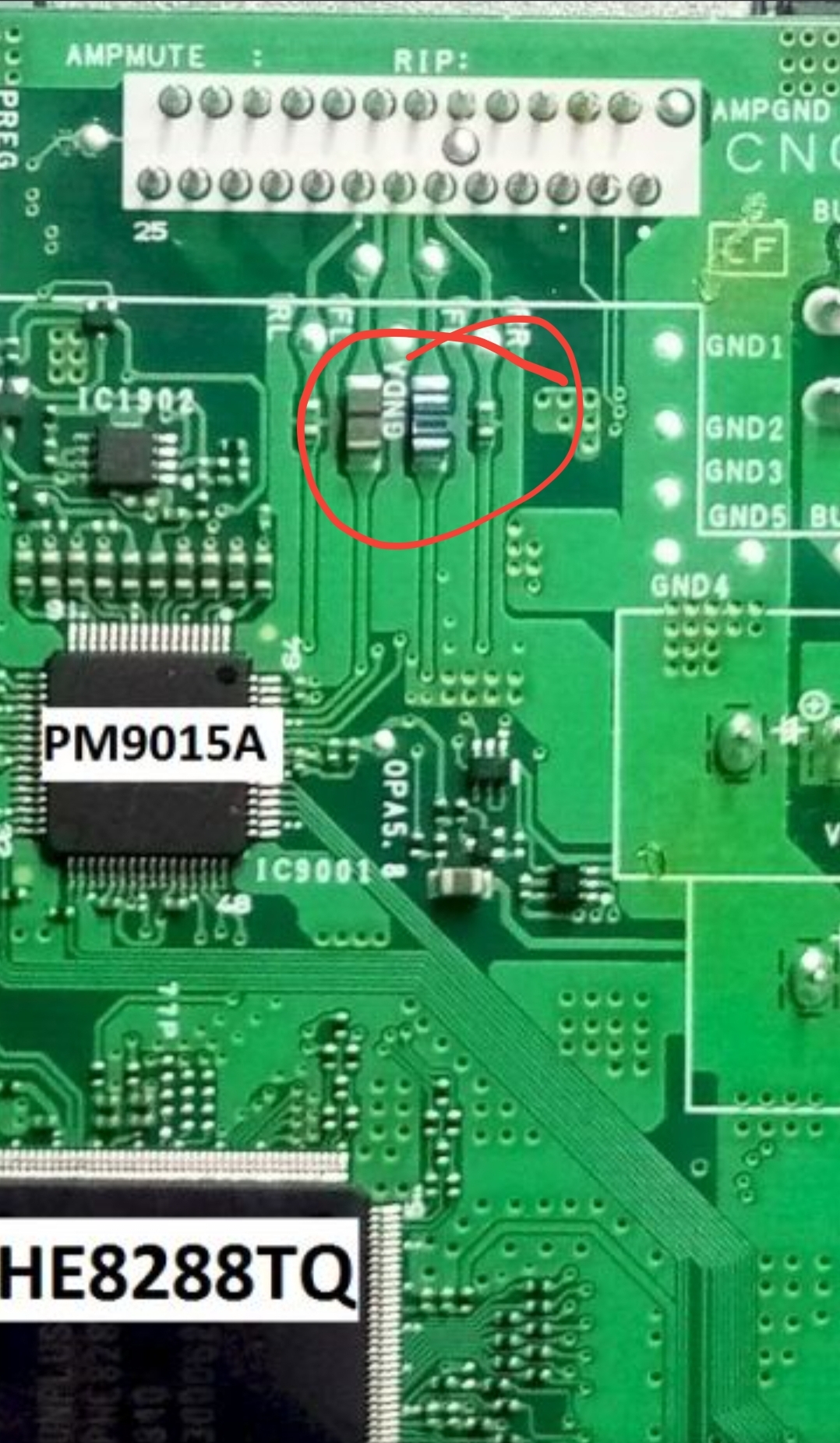

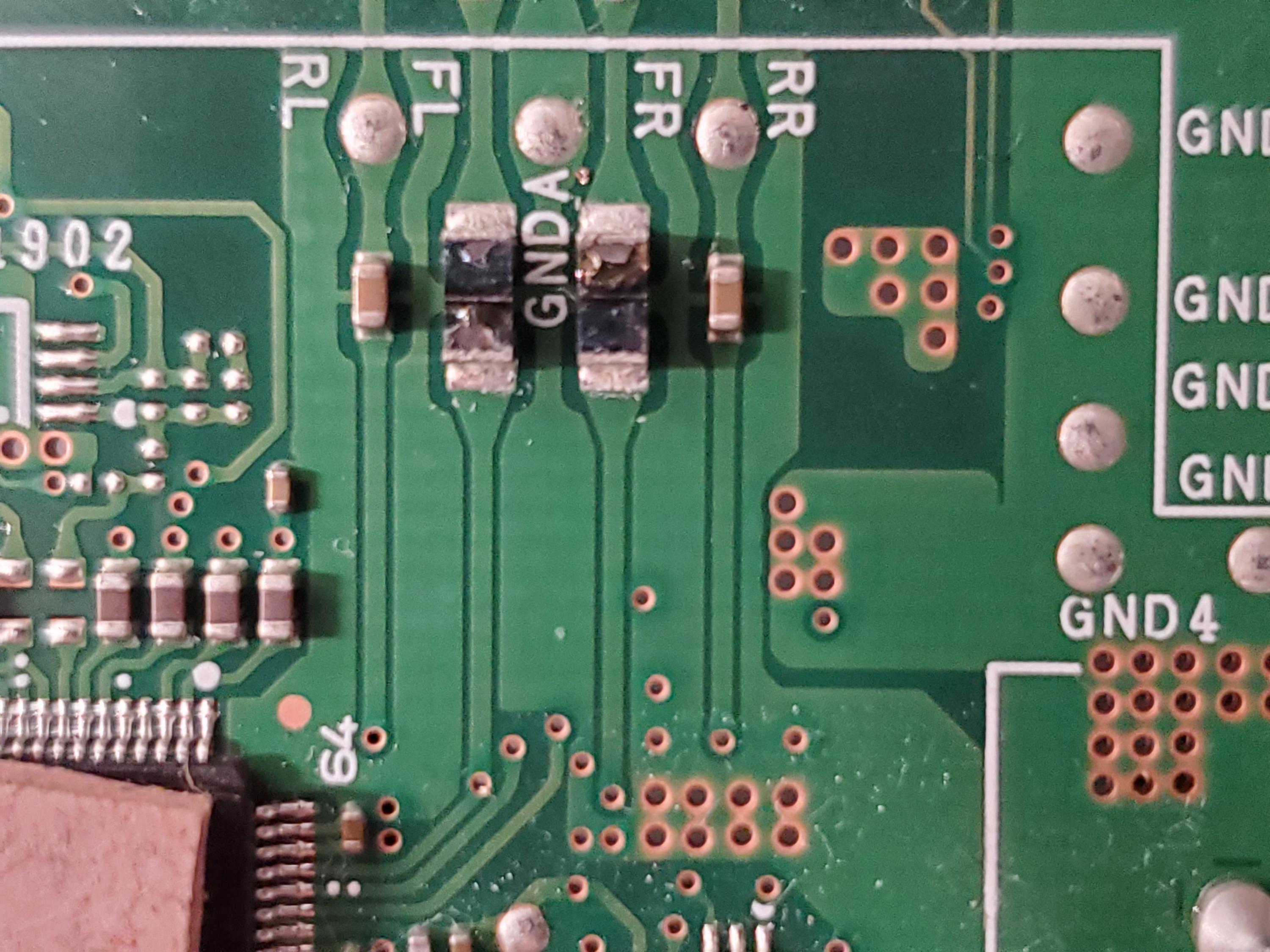

    Hey, guys.. I was replacing an amplifier in a Pioneer AVH-210EX. When I pulled off the kapton tape, the tops of two SMD components came off with it. Can anyone help me identify these two packages?

    By markings looks like fuses for left & right channels.

      They are not fuses but could be inductors (coils) Is there a legend off to the side (outside the white boarder) that shows what the component is IE L1, L2, C1 C2 etc.

        Inductor.

          Thanks for the help. I don't see any reference designators on the board for these components.

            Thanks. Is there any way to estimate the inductor rating? I'd rather replace it, but if it can be done with little detriment to the operation of the radio, I might just try jumping.
