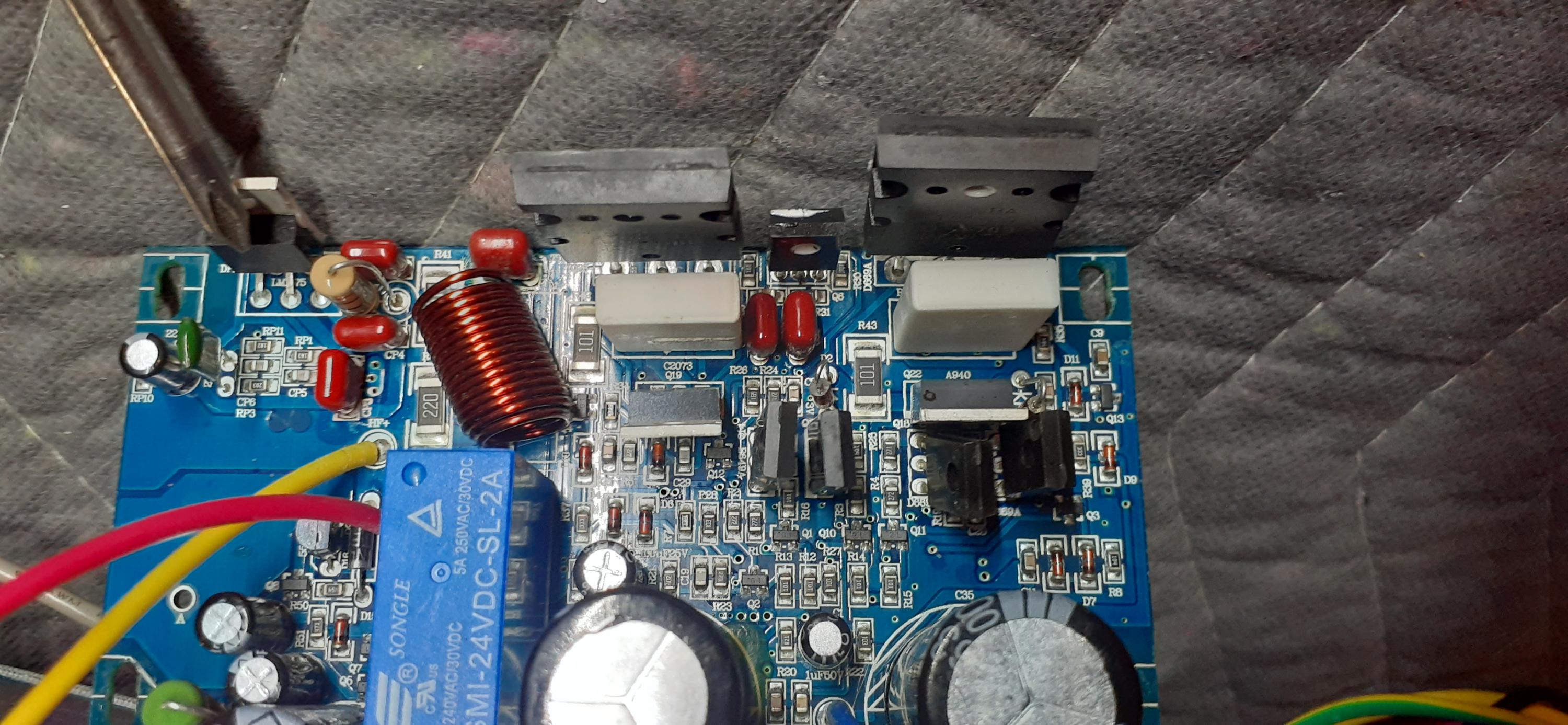

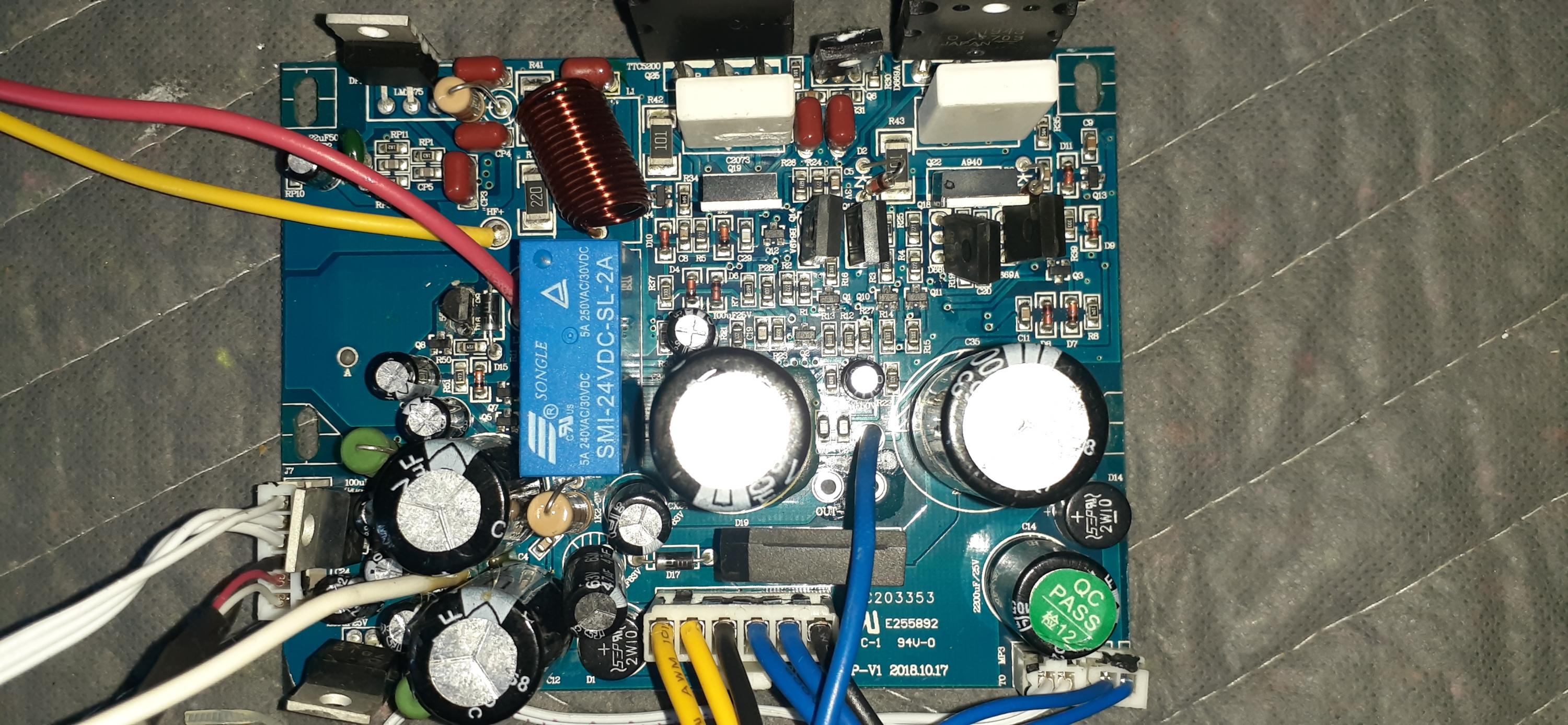

Ion total pa pro 15in speaker relay prolem
Re: Ion total pa pro 15in speaker relay prolem
Did you check the DC Voltage on the relay coils?
It may be in protection shutdown.Never stop learning
http://www.badcaps.net/forum/showthread.php?t=24809Comment
check the big transistors for short circuit
also check voltage on any end of the copper coil with reference to chassis groundLast edited by petehall347; 10-08-2020, 03:16 PM.Comment

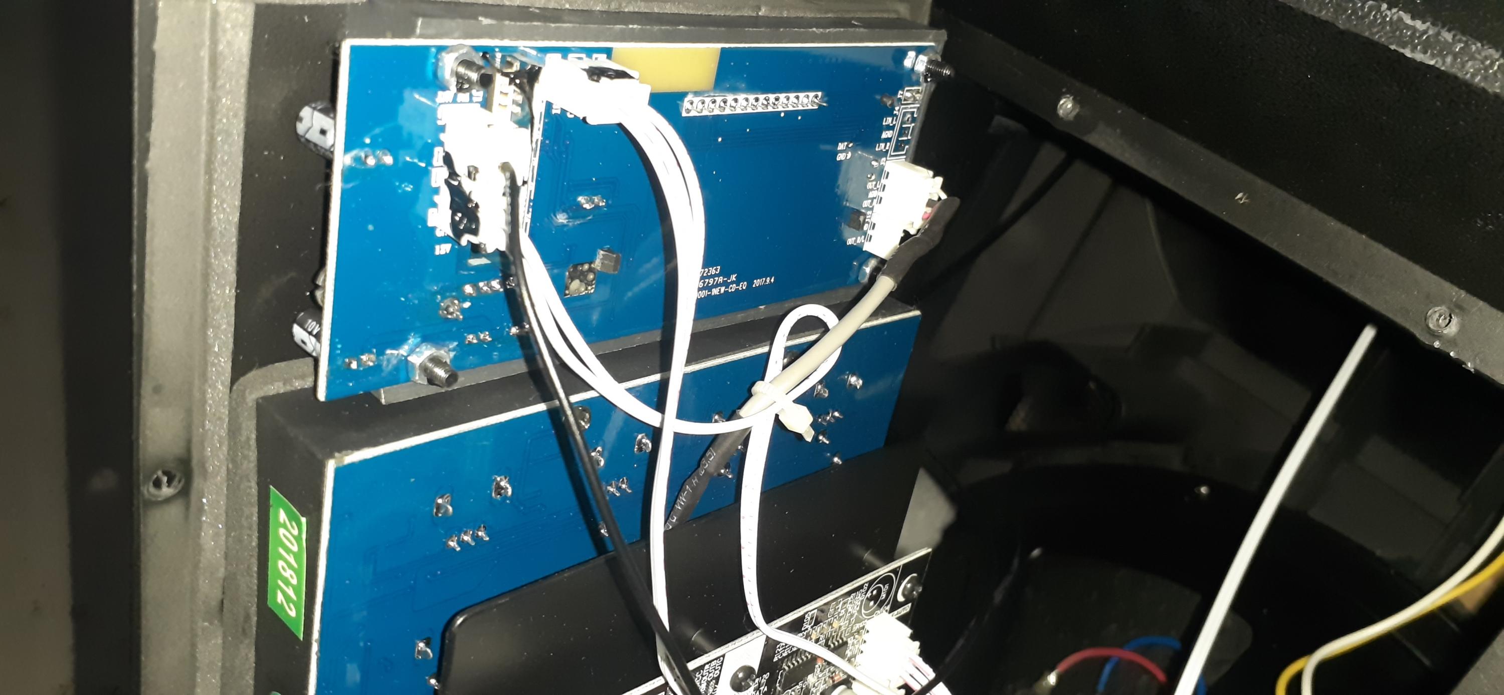

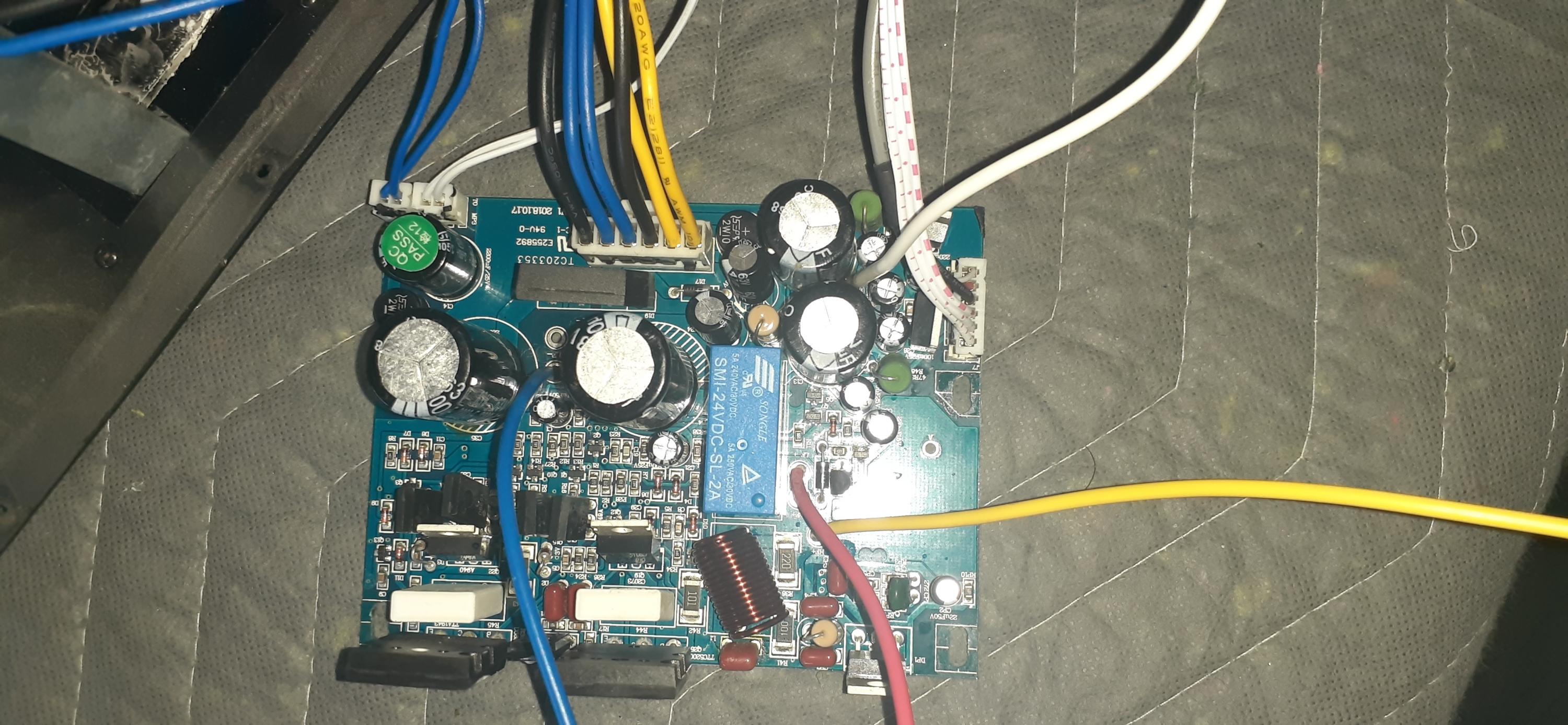

I am a little confused, you show TWO amplifier boards, which one of the two amplifer boards that the relay does not come on?Never stop learning

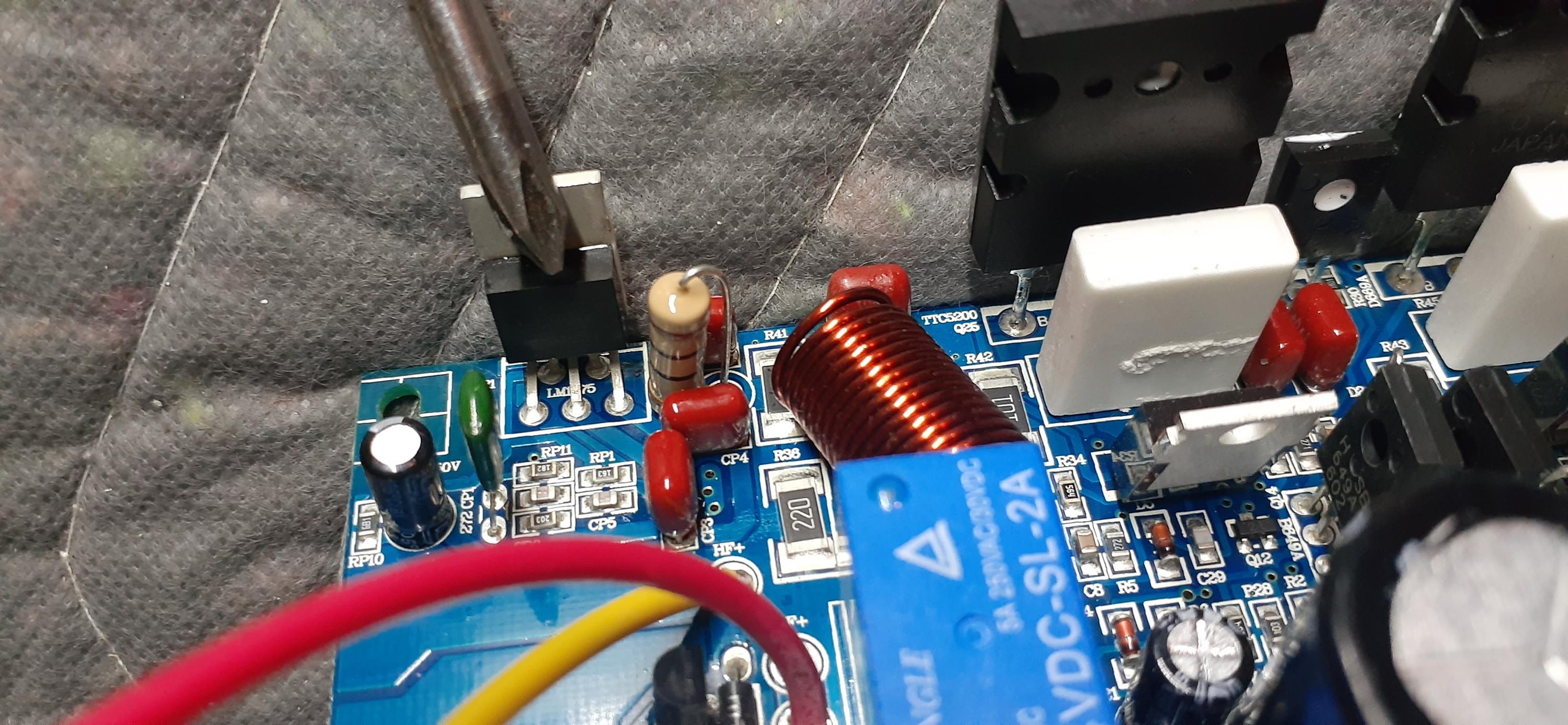

Oh dam i add the one with the big relay since both doisng the same thing...but, am focusing on the big relay amp...theres a transistor with 6 legs it get bit hot when indo turn on the amp...think is a controler transistor.Comment
It looks to be LM1?75.Never stop learning

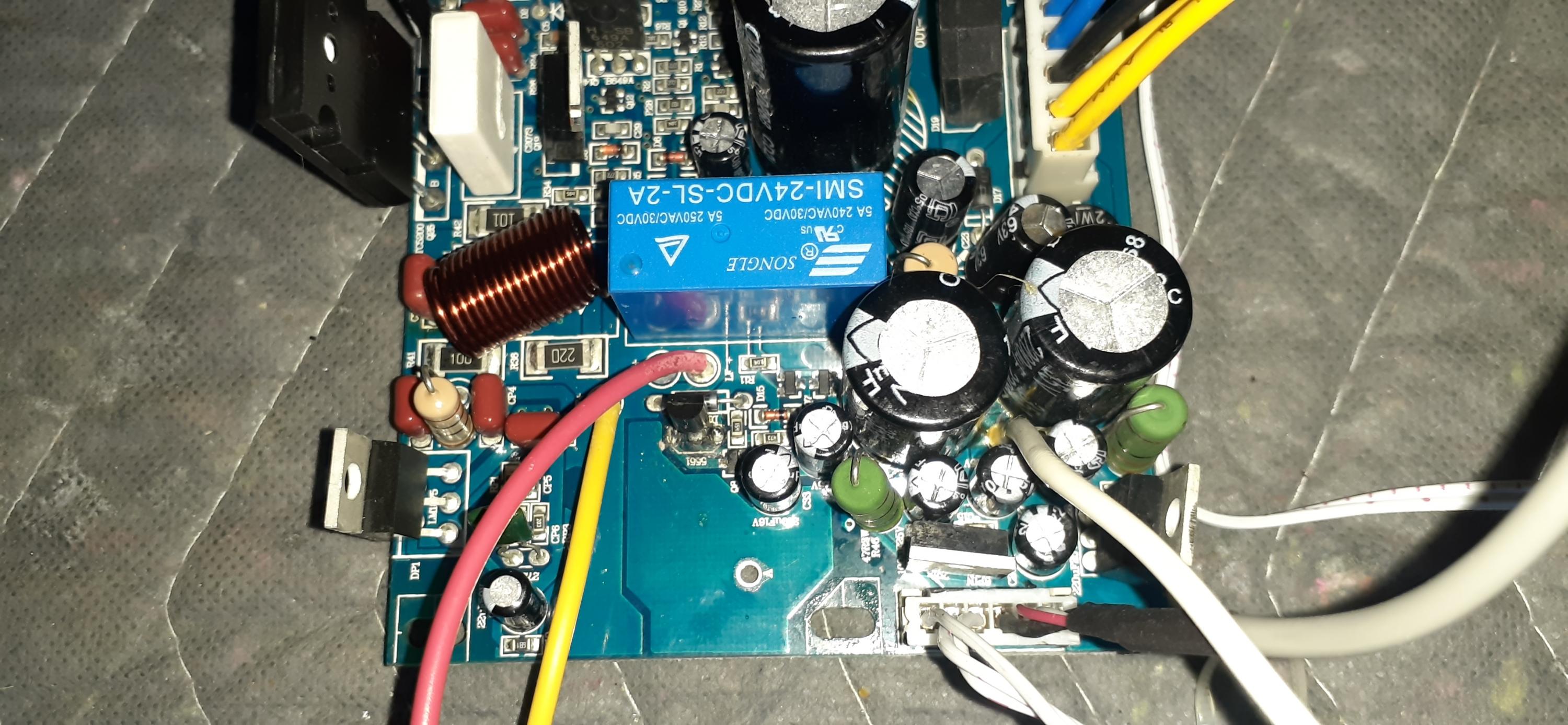

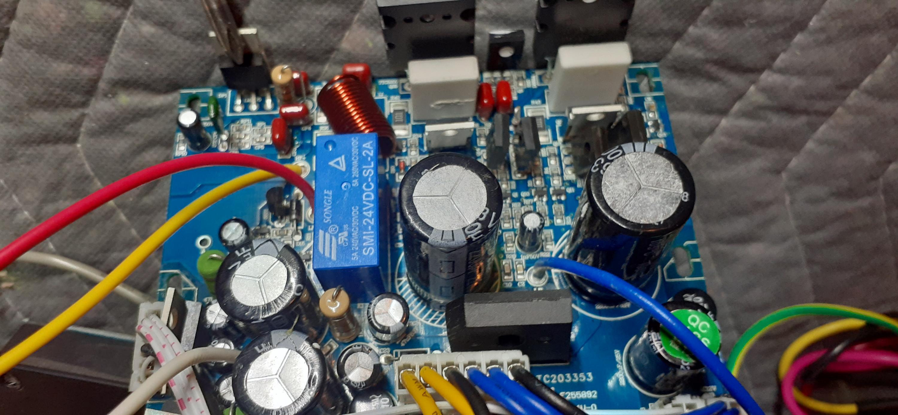

2) The big relay you are referring to this board, correct? https://www.badcaps.net/forum/attach...2&d=1602280760Never stop learning
1) So Both amplifier boards are in the same speaker cabinet?
No....for diferent cabinets but same problem.
2) The big relay you are referring to this board, correct? https://www.badcaps.net/forum/attach...2&d=1602280760Comment
OK, let me trace out the board so I can give you test points to test.Never stop learning

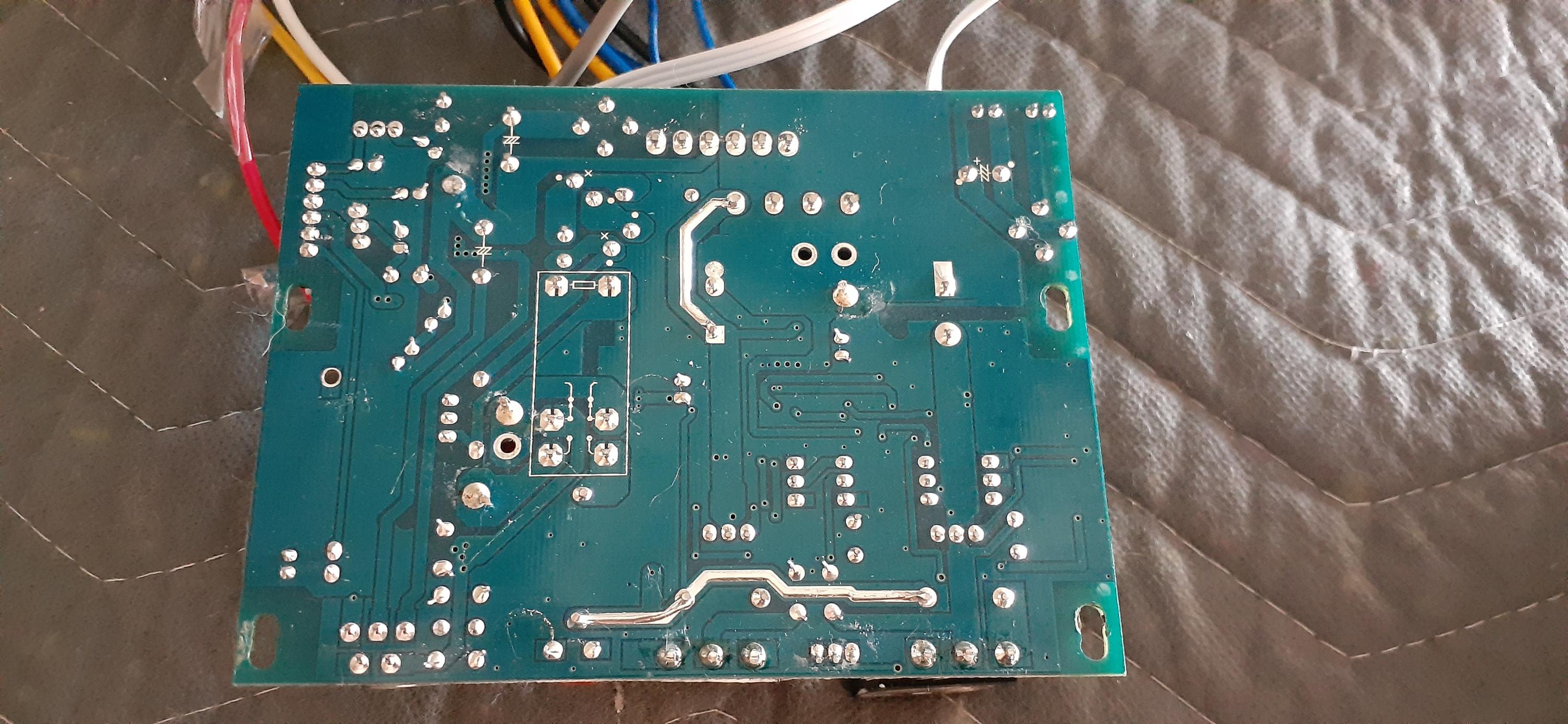

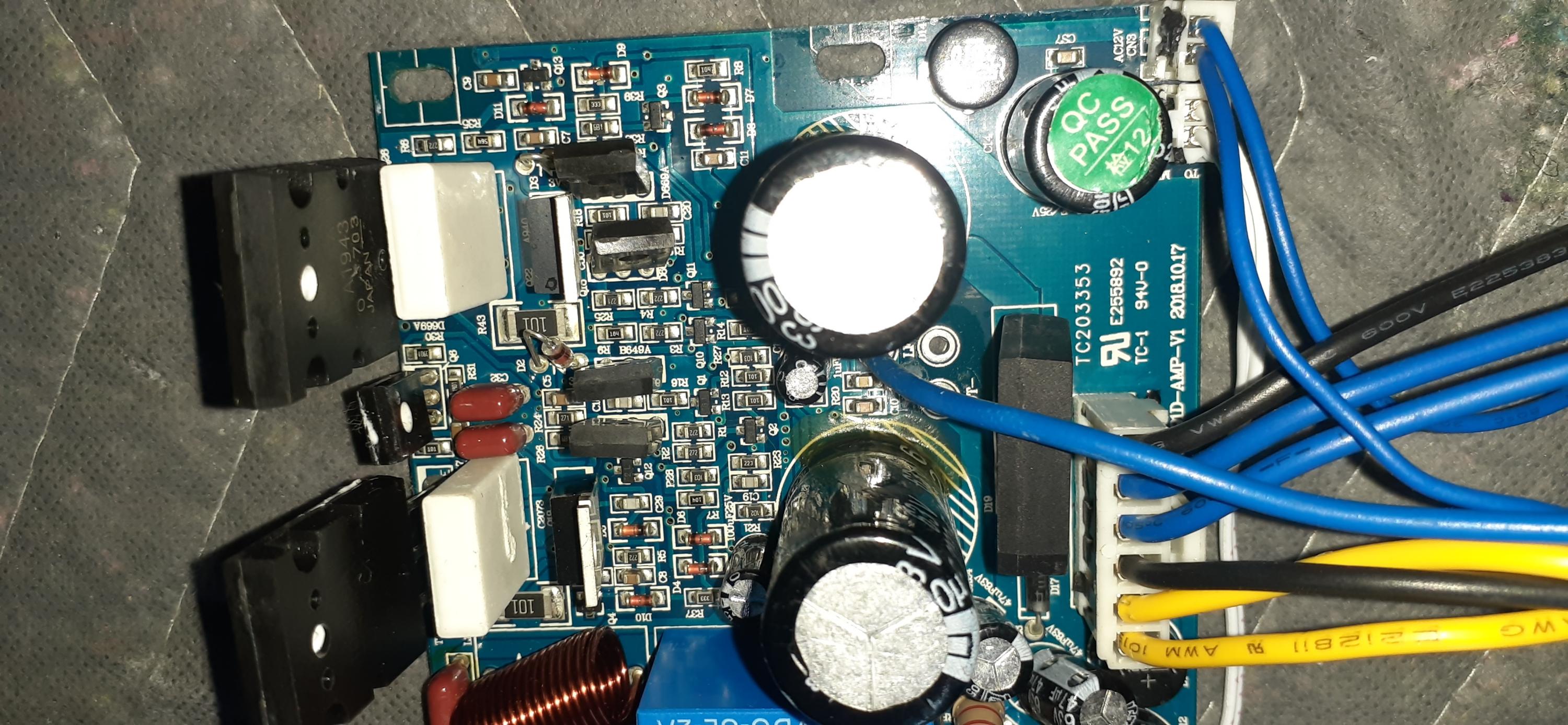

Can you please do straight shots hi-res pictures of this board top and bottom side?Never stop learning

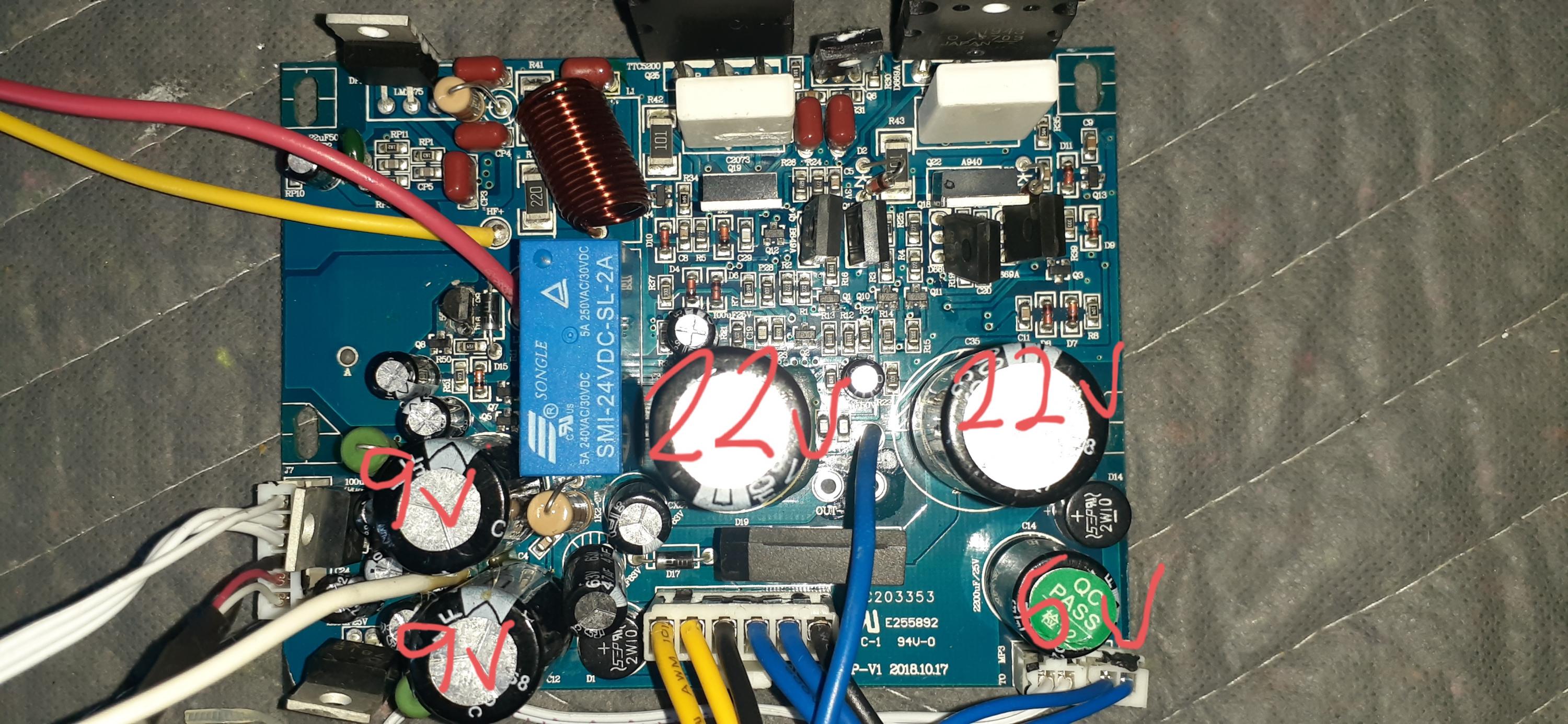

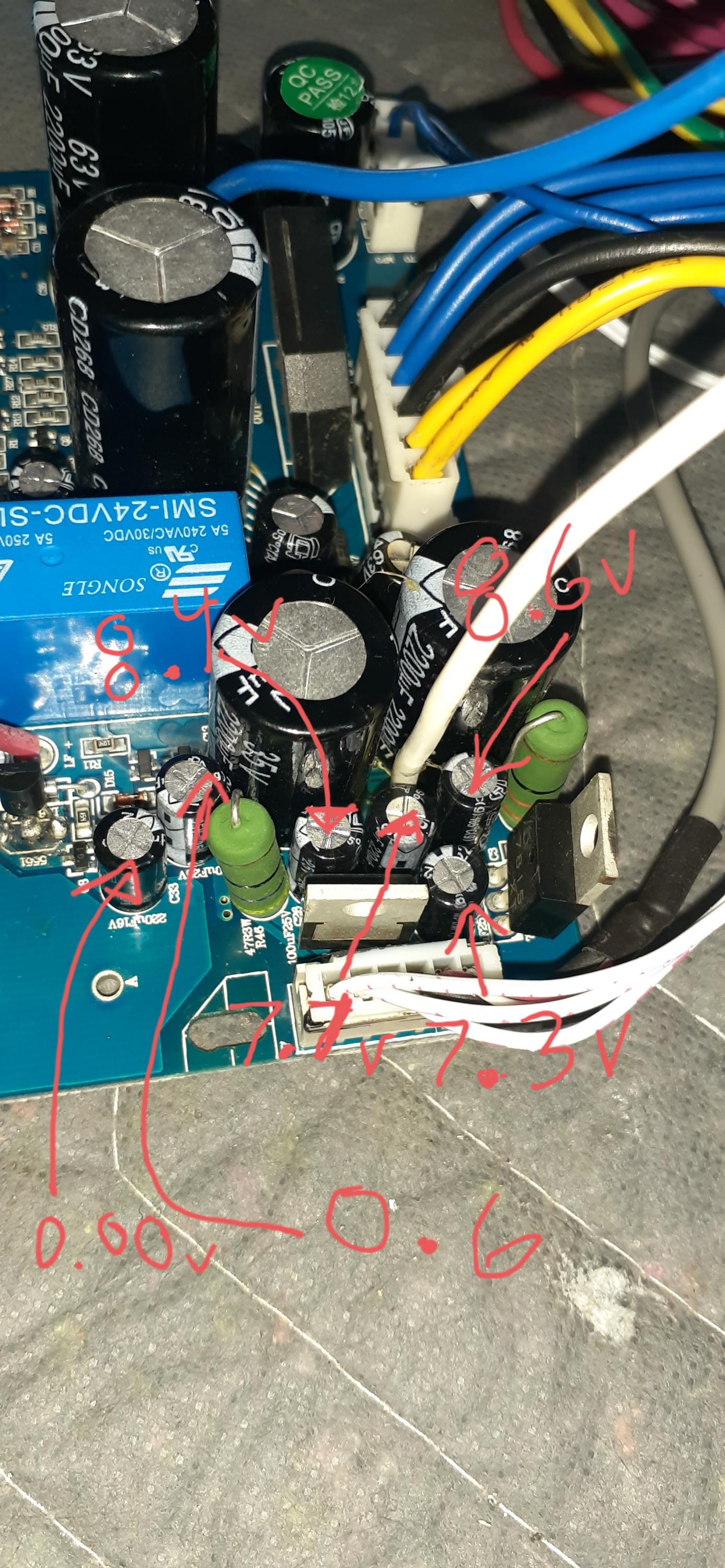

Thanks for the pictures.
https://www.badcaps.net/forum/attach...8&d=1602306171
There are 5 large lytics caps, what DC V do you get when measure right between the two legs of each cap?Never stop learning
