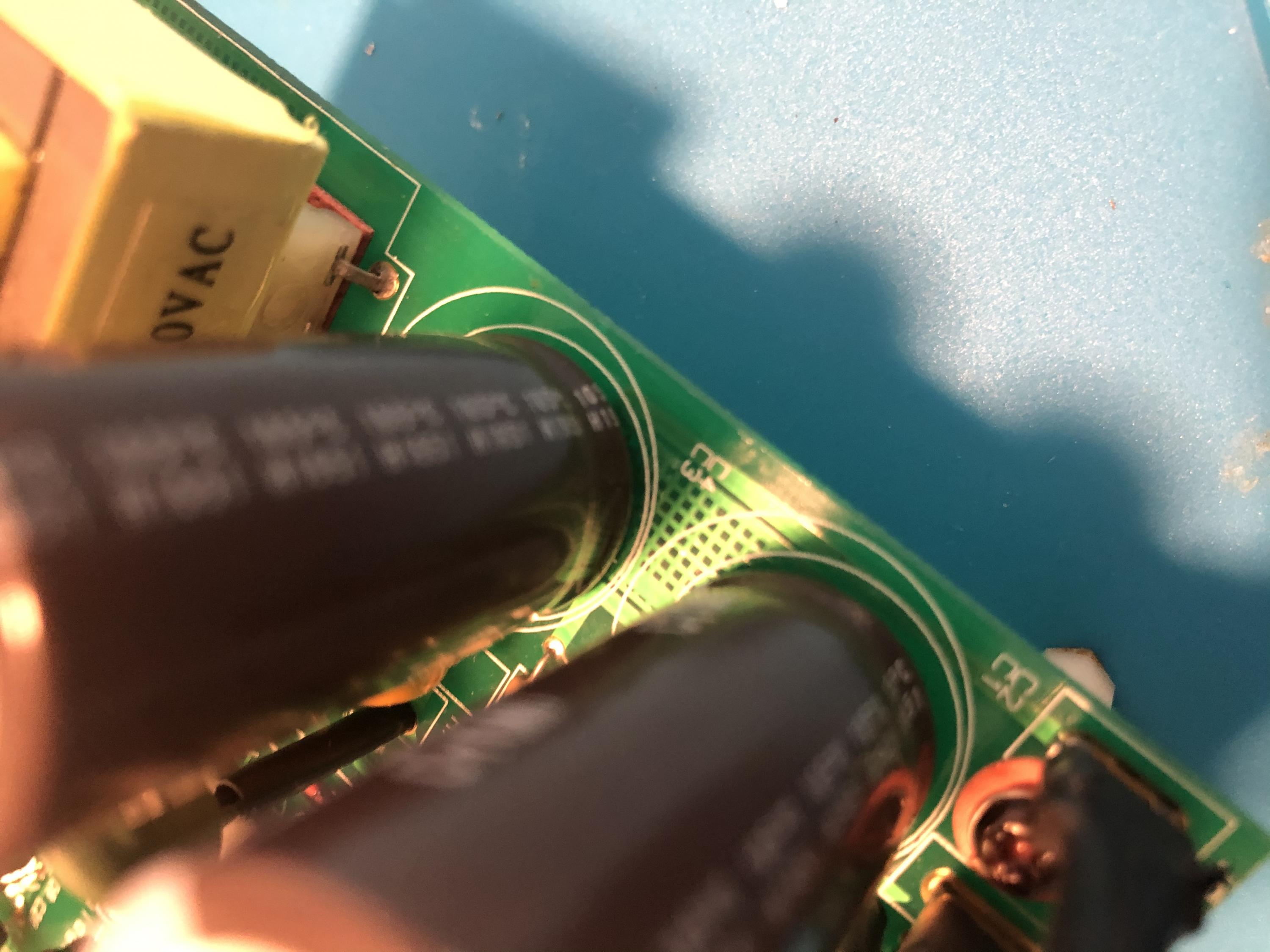

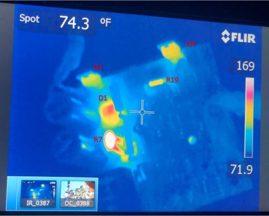

troubleshooting definitive technology prosub 60
  • khajr
    • Sep 2020
    • 19
    troubleshooting definitive technology prosub 60
    My prosub 60 is blowing fuses. I bought replacement 1.25 amp 125v/250v slo blo fuses. When I replace the fuse it blows immediately along with a loud buzzing/hum from the sub. Attached are the schematics from definitive technology. There was one bad resistor, R19, and I have replaced this with the correct 1/2watt 1ohm resistor. When I plugged the unit it that resistor pops and the fuse blows. I have also replaced the following: caps C2 and C4, the bridge rectifier D1, op amp U1D, and the power mosfets Q1 and Q7. I have also checked R18, R20, and R21 and they checkout fine (removed from board to check). I have also checked power thermistor R7 and it came back 17 ohms. I removed Z1 and Z4 and checked them and they read a 0.7 drop. I have also verified the subwoofer is viable per def tech by checking the resistance across + and - and it reads 59 ohms. It is supposed to be +/- 15% from 64 ohms. I have also gently applied even pressure on the sub and it moves without any noises. I am at a loss now. Anyone have any thoughts?
    I should mention that this happens w/o the amp being connected to the receiver.
    Thanks in advance.
    Last edited by khajr; 09-26-2020, 03:40 PM.
  • R_J
    • Jun 2012
    • 9607
    Re: troubleshooting definitive technology prosub 60
    If Q1 & Q7 were shorted and R19 open, it is very likely the gate drive circuit is also damaged, Z1, Z4, R1, R18, Q3, Q4, Q5 etc. Z1&z4 are zener diodes and may check like a diode but zener at the wrong voltage.
    If Q1 or Q7 shorts drain to gate, it applies 170vdc to the gate components, so it may have damaged U3d as well
    Last edited by R_J; 09-26-2020, 07:56 PM.
    • khajr
      • Sep 2020
      • 19
      Re: troubleshooting definitive technology prosub 60
      Originally posted by R_J
      If Q1 & Q7 were shorted and R19 open, it is very likely the gate drive circuit is also damaged, Z1, Z4, R1, R18, Q3, Q4, Q5 etc. Z1&z4 are zener diodes and may check like a diode but zener at the wrong voltage.
      If Q1 or Q7 shorts drain to gate, it applies 170vdc to the gate components, so it may have damaged U3d as well
      Thanks BadCaps. The new Q1 and Q7 are shorted source to gate. All pins were shorted on the ones I took out. I did replace U3d and more zener diodes are on order. I will check Q3, Q4, and Q5.
      • R_J
        • Jun 2012
        • 9607
        Re: troubleshooting definitive technology prosub 60
        Originally posted by khajr
        Thanks BadCaps. The new Q1 and Q7 are shorted source to gate. All pins were shorted on the ones I took out. I did replace U3d and more zener diodes are on order. I will check Q3, Q4, and Q5.
        You can use a 60~100 watt incandescent lamp in series with the a/c input, this will limit the current and may help prevent the amp from blowing up during troubleshooting.
        • khajr
          • Sep 2020
          • 19
          Re: troubleshooting definitive technology prosub 60
          Originally posted by R_J
          You can use a 60~100 watt incandescent lamp in series with the a/c input, this will limit the current and may help prevent the amp from blowing up during troubleshooting.
          I had to look that up. That is a great idea. I have access to a flir camera can I use this in conjunction with the flir and identify hotspots...or am I supposed to unplug the sub when I notice the light doesn't go out?
          • khajr
            • Sep 2020
            • 19
            Re: troubleshooting definitive technology prosub 60
            Originally posted by khajr
            I had to look that up. That is a great idea. I have access to a flir camera can I use this in conjunction with the flir and identify hotspots...or am I supposed to unplug the sub when I notice the light doesn't go out?
            Let me rephrase this...I understand that the bulb is drawing the current but if use a 100 watt bulb will it still be safe enough to leave on long enough to get a good thermal image w/o compromising any parts?
            • R_J
              • Jun 2012
              • 9607
              Re: troubleshooting definitive technology prosub 60
              If you have a variac, that would work the best so you could increase the a/c voltage slowly. If you don't have one then you can use a lamp, but the wattage of the lamp is not that critical. It is NOT the lamp that is drawing the current, it is the unit under test. If there is a short in the amp, the lamp will light up full brightness, if the amp is not drawing a lot of current, the lamp will usually light for a second (as caps charge etc.) then dim.
              Just a note that if you used a very low wattage lamp (25watt) even a working amp may not operate so you might assume a problem when there was none.
              Last edited by R_J; 09-27-2020, 10:36 AM.
              • khajr
                • Sep 2020
                • 19
                Re: troubleshooting definitive technology prosub 60
                I don't have a variac so I am going to use the lamp....I had all the parts in my garage to build one. I hope it stays on long enough to get a good thermal image of the board so I can pin point a problem.
                • khajr
                  • Sep 2020
                  • 19
                  Re: troubleshooting definitive technology prosub 60
                  Attached is the IR image of the board. Nothing blew. R7 is hot. The camera was set to auto scale temp range based on field of view. so it was 169 degrees F but it got as high as 200 degrees F when looking at it for a few more seconds before I turned the power off. Is it supposed to be that hot? I will have to order one but I am not sure what to order to replace it. The markings are SCK 202 and on the schematic it says 20 NTC SL20002 US Sensor. But I can't seem to find anything on mouser that matches that. D1 shows hot but it is directly down stream from R7. I will also buy another D1 (DF08) and I have plenty of 1 ohm 1/2 watt resistors for R19. I think Q4 and Q 1 are fine but I will get a couple more. C14 showed warm when I took this pic (lower right of image) but that was errant. It never showed warm again.
                  Badcaps thanks so much for your suggestion for the dim bulb tester.
                  Last edited by khajr; 09-27-2020, 09:09 PM.
                  • R_J
                    • Jun 2012
                    • 9607
                    Re: troubleshooting definitive technology prosub 60
                    R7 is a ntc thermistor, it gets hot and the resistance goes down, thats how it works. it will not be the problem. The cold temperature is 20Ω It is just for inrush protection. they can fail open but this one is working. The bridge rectifier is also likley ok, check if you have + & - 170 volts, this voltage is likely lower with the lamp in line. but both + & - voltages should be close to equal.
                    I see Q1 and Q4 (or should that be Q7) and R19 are quite hot, it could be that the mosfets are turned on hard.
                    What is the voltage on the speaker line? that needs to be near 0 volts
                    Last edited by R_J; 09-27-2020, 10:27 PM.
                    • khajr
                      • Sep 2020
                      • 19
                      Re: troubleshooting definitive technology prosub 60
                      Originally posted by R_J
                      R7 is a ntc thermistor, it gets hot and the resistance goes down, thats how it works. it will not be the problem. The cold temperature is 20Ω It is just for inrush protection. they can fail open but this one is working. The bridge rectifier is also likley ok, check if you have + & - 170 volts, this voltage is likely lower with the lamp in line. but both + & - voltages should be close to equal.
                      I see Q1 and Q4 (or should that be Q7) and R19 are quite hot, it could be that the mosfets are turned on hard.
                      What is the voltage on the speaker line? that needs to be near 0 volts
                      Yes. It’s Q7. Don’t know why I had Q4 in my head. All three pins on Q1 are shorted together. I will check speaker line voltage and the bridge rectifier. But I am going to guess the speaker line voltage is not going to be zero as it makes a hum.
                      My original replacement were the two mosfets, R19, the bridge rectifier, C2 C4. and the op amp. Would we still be concerned about the zener diodes at all?
                      Last edited by khajr; 09-27-2020, 10:46 PM.
                      • khajr
                        • Sep 2020
                        • 19
                        Re: troubleshooting definitive technology prosub 60
                        Originally posted by R_J
                        R7 is a ntc thermistor, it gets hot and the resistance goes down, thats how it works. it will not be the problem. The cold temperature is 20Ω It is just for inrush protection. they can fail open but this one is working. The bridge rectifier is also likley ok, check if you have + & - 170 volts, this voltage is likely lower with the lamp in line. but both + & - voltages should be close to equal.
                        I see Q1 and Q4 (or should that be Q7) and R19 are quite hot, it could be that the mosfets are turned on hard.
                        What is the voltage on the speaker line? that needs to be near 0 volts
                        The + and - voltages on the bridge rectifier were off by an order of magnitude and the there was current through the speaker wire.
                        • khajr
                          • Sep 2020
                          • 19
                          Re: troubleshooting definitive technology prosub 60
                          Where should I be measuring the bridge rectifier?
                            master hoarder
                            • May 2008
                            • 12175
                            • Bulgaria
                            Re: troubleshooting definitive technology prosub 60
                            Originally posted by khajr
                            Where should I be measuring the bridge rectifier?
                            Measure across the four caps after bridge rectifier D1, if that is more convenient. C1 and C2 are in parallel, so you should see the same voltage across them, and hopefully it should be around 160-170V DC, depending on how much voltage your dim bulb is dropping on the AC. Likewise, C3 and C4 are in parallel and should also have the same voltage across them. Lastly, placing your red (positive) multimeter probe on the positive lead of cap C1/C2 amd the negative (black) multimeter probe on the negative lead of cap C3/C4 should give around 320-340V DC. Alternatively, you can measure the DC voltage across the bridge rectifier (+) and (-) pins. Whichever you chose, just be safe and pick the one where you're not likely to touch any of the metal parts in that area, as those DC voltages are quite high and can be dangerous.
                            • khajr
                              • Sep 2020
                              • 19
                              Re: troubleshooting definitive technology prosub 60
                              Originally posted by momaka
                              Measure across the four caps after bridge rectifier D1, if that is more convenient. C1 and C2 are in parallel, so you should see the same voltage across them, and hopefully it should be around 160-170V DC, depending on how much voltage your dim bulb is dropping on the AC. Likewise, C3 and C4 are in parallel and should also have the same voltage across them. Lastly, placing your red (positive) multimeter probe on the positive lead of cap C1/C2 amd the negative (black) multimeter probe on the negative lead of cap C3/C4 should give around 320-340V DC. Alternatively, you can measure the DC voltage across the bridge rectifier (+) and (-) pins. Whichever you chose, just be safe and pick the one where you're not likely to touch any of the metal parts in that area, as those DC voltages are quite high and can be dangerous.
                              Thanks for the help momaka. I am waiting on new Q1 and Q7 mosfets to come in. Then I will check those voltages. Yeah...I am trying to be very careful. I took Q1 out and pins 2 (drain) and 3 (source) were closed. 1 (gate) and 2 (drain) were open. and 1 (gate) and 3 (source) were open. I am going to take Q7 out and check too.
                              Last edited by khajr; 09-29-2020, 08:28 PM.
                                master hoarder
                                • May 2008
                                • 12175
                                • Bulgaria
                                Re: troubleshooting definitive technology prosub 60
                                NO problems.
                                You can check those voltages without Q1 and Q7... and in fact that might be better so you can confirm if your power supply is OK with the output transistors removed. Then once you fit back Q1 and Q7, you can see how they affect the power supply if something is still not quite right.
                                • khajr
                                  • Sep 2020
                                  • 19
                                  Re: troubleshooting definitive technology prosub 60
                                  Originally posted by momaka
                                  NO problems.
                                  You can check those voltages without Q1 and Q7... and in fact that might be better so you can confirm if your power supply is OK with the output transistors removed. Then once you fit back Q1 and Q7, you can see how they affect the power supply if something is still not quite right.
                                  Attached is a pic of the board where C1/C2 and C3/C4 are. It looks like you either have C1 and C3 or C2 and C4. Since this is the large case I have C2 and C4.
                                  I am using a 100 watt bulb in the dim bulb tester. With Q1 and Q7 removed the lit dimly for a moment and went out. Across C2 I get 168v. Across C4 I get 168 v. Across C2 and C4 I get 360v. Across the + and - of the bridge rectifier I get 336v.
                                  • khajr
                                    • Sep 2020
                                    • 19
                                    Re: troubleshooting definitive technology prosub 60
                                    The new mosfets Q1 and Q7 ought to be here tomorrow or Friday. What is concerning is that I already swapped those out along with C2, C4, R19, D1, and U3. And the it still blew the fuse and R19. Maybe I got a bad component. My soldering sucks (its really pretty good). I know now to test the new mosfets before I install them.
                                    • R_J
                                      • Jun 2012
                                      • 9607
                                      Re: troubleshooting definitive technology prosub 60
                                      If the drive to the mosfets is bad, then the mosfets will be turned on, when they are turned on they will act as a short. If the circuit is working, the mosfets will be turned OFF and only turn on with the audio signal, basically Q1 and Q7 will alternate turning on and off according to the audio signal, and the voltage on the speaker will vary +/- producing the audio.
                                      You need to be very careful working with these double sided boards, If you remove a through hole component and destroy the feed through, you will no longer have the circuit connection between one side and the other.
                                      Last edited by R_J; 09-30-2020, 10:26 AM.
                                      • khajr
                                        • Sep 2020
                                        • 19
                                        Re: troubleshooting definitive technology prosub 60
                                        Originally posted by R_J
                                        If the drive to the mosfets is bad, then the mosfets will be turned on, when they are turned on they will act as a short. If the circuit is working, the mosfets will be turned OFF and only turn on with the audio signal, basically Q1 and Q7 will alternate turning on and off according to the audio signal, and the voltage on the speaker will vary +/- producing the audio.
                                        You need to be very careful working with these double sided boards, If you remove a through hole component and destroy the feed through, you will no longer have the circuit connection between one side and the other.
                                        I tested to voltage at the connections for the mosfets and found the following:
                                        Q1
                                        P1 and P2 = +169V
                                        P2 and P3 = -169V
                                        P1 and P3 = -300mV
                                        Q7
                                        P1 and P2 = +163V
                                        P2 and P3 = -169V
                                        P1 and P3 = -6V
                                        I will try and figure what they should be.
                                        • gica69
                                          Need help to identify and to locate a 0.33 ohms fusible resistor for power supply
                                          by gica69
                                          I have a quad charger that is split into 4 separate sections and one section doesn’t charge anymore. I have located what I think is a thermistor and on the shrink tube it says 125 degrees C. I cut the shrink tube and it's a 33 ohms resistor. It measures a little less than 1/2 inch in length. I am including pictures of it. Please help me identify it. So, it should test at 0.4ohms and probably go up in resistance with the rise in temp. On the board it clearly says R for resistor. But it has to be a special one.
                                          Resistor shows orange range silver gold and green lines.
                                          Thanks in adv...
                                          07-21-2025, 09:49 PM
                                        • Baste
                                          What are the pro's and cons of replacing a 1/4 with a 1/2 resistor same ohms?
                                          by Baste
                                          As the title says. I bought a cheap Asus ROG Strix 750-watt PSU, which was posted as defective. Cables are complete, and the entire PSU is in good condition, of course, aside from being faulty. Long story short, upon checking, there is no +5VSB. Looking at the components, I found a blown resistor. I swear, looking at the bands, the color is pink, pink, gold, gold. I dunno if I'm color blind or this is the way resistors are coded.
                                          Please help, did I decode it correctly at 2.2 ohms (red, red, gold, gold), or what could a pink, pink, gold gold value be? I bought a...
                                          10-30-2025, 11:51 PM
                                        • jinu_j
                                          Dell 2209WA - power supply - Fusible Resistor replacement
                                          by jinu_j
                                          Hi
                                          I am trying to repair an ancient Dell 2209WA Monitor which suddenly shut off with a pop sound. On investigation found that one of the fusible resistors had blown. Further investigation identified multiple components as faulty because of which the fusible resistor blew. Please refer the attached circuit diagram showing the components that were found to be damaged.
                                          1. FR950 - blown fusible resistor - 0.2 Ohm 1W
                                          2. Q950 - shorted Q950 MOSFET - 650V 10A N Channel Mosfet
                                          3. R835 - Blown Resistor - 20KOhm SMD resistor
                                          4. D930 - Shorted Schottkey Diode...
                                          05-03-2025, 10:51 PM
                                        • mikey5791
                                          Need help to replace burned resistor in 350w atx psu
                                          by mikey5791
                                          Hi to all forum members,
                                          Got this faulty 350 watt atx psu dirt cheap from a local online seller as i am keen to use it as a learning tool to repair faulty power supply.
                                          The faulty part is quite obvious from the burn area near the 16pin KA7500 BD pwm. The fuse is still intact with good continuity.
                                          Upon power on ac, there is 5vdc standby power on cathode of diode D14 and about 10vdc on cathode of diode D13.(This should be the aux power to generate the 12v and 5v rail.)
                                          Initially i replace the two burned resistors near my marked red arrow to 200 ohm resistor...
                                          12-26-2024, 04:55 AM
                                        • Califauna
                                          Help with boom box modification
                                          by Califauna
                                          Hi, this is more of a project help request than a troubleshooting question. I hope I can post it here.
                                          I have a W-King D8 Bluetooth boom box which I'd like to modify with some external speaker output jacks and some buttons to switch the internal speakers on and off.
                                          From factory the specs of the boom box are:
                                          -Power Input: DC 5V
                                          -Speaker Output Power: 2 x 25W ( confirmed by Youtube channel Hartdegen review as 12.5W RMS per channel)
                                          -Drivers:
                                          -2 x Woofer, 70mm, 10Ω, 70mm,15W
                                          -2 X Tweeter, 8Ω, 30mm,10W x 2
                                          -Frequency...
                                          12-04-2021, 01:53 PM
