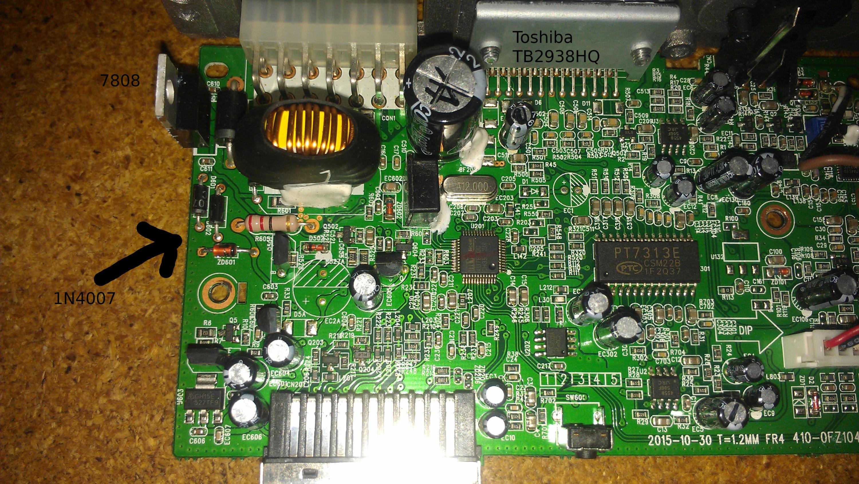

    Clarion FZ104PA stereo has no lights and dark LCD display.
    Check those diodes around 7808; those are 3 small 1N4007 diodes act as TVS, after replacing few of those, the lights and LCD display becomes visible. Sadly this stereo has no adjustment for brightness.
    Our fleet of buses all has this stereo. It goes take a while to fix all this. Very simple but tedious works. I hope this will help someone else.

        Re: Clarion FZ104PA stereo has no lights and dark LCD display.
        Thank you number 22 for your suggestion, unfortunately that didn't work for me. I've had a dim readout for a couple years now and had hopes this would be the cure. Any chance you've come across any other defective component(s) that resulted in the same readout condition?
