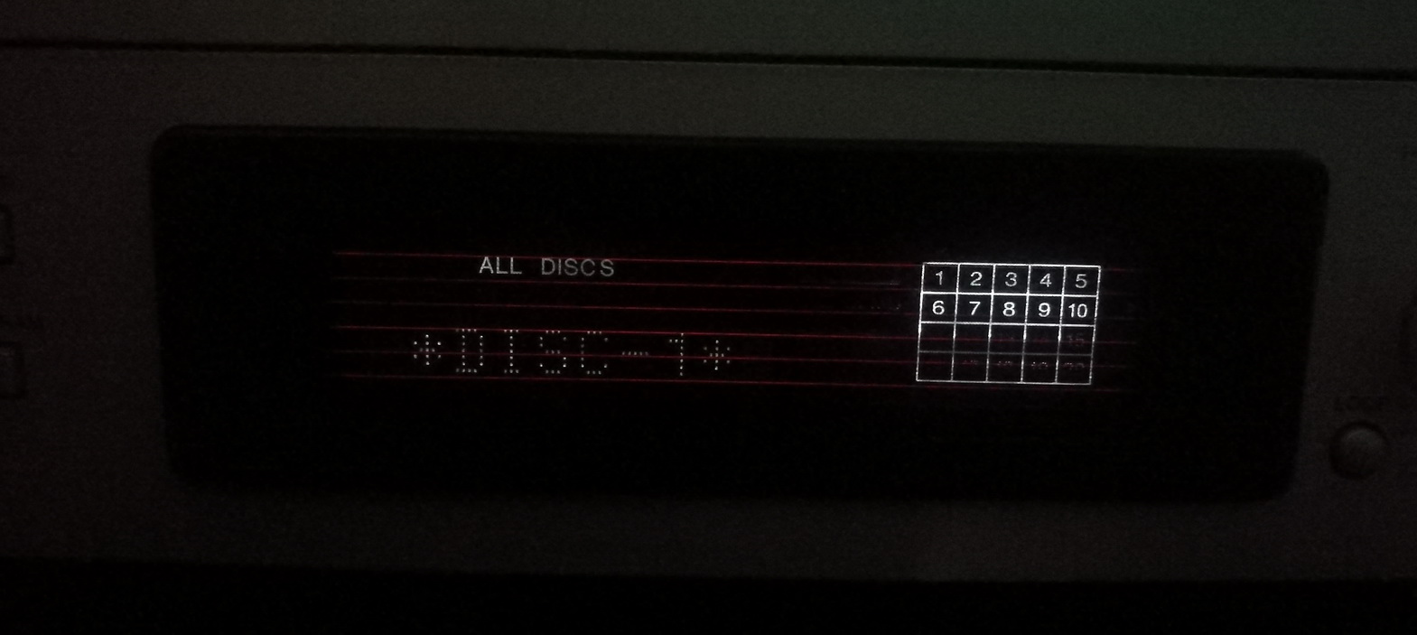

    To add more details, cd display heaters are visible, here is pic. Overvoltage?

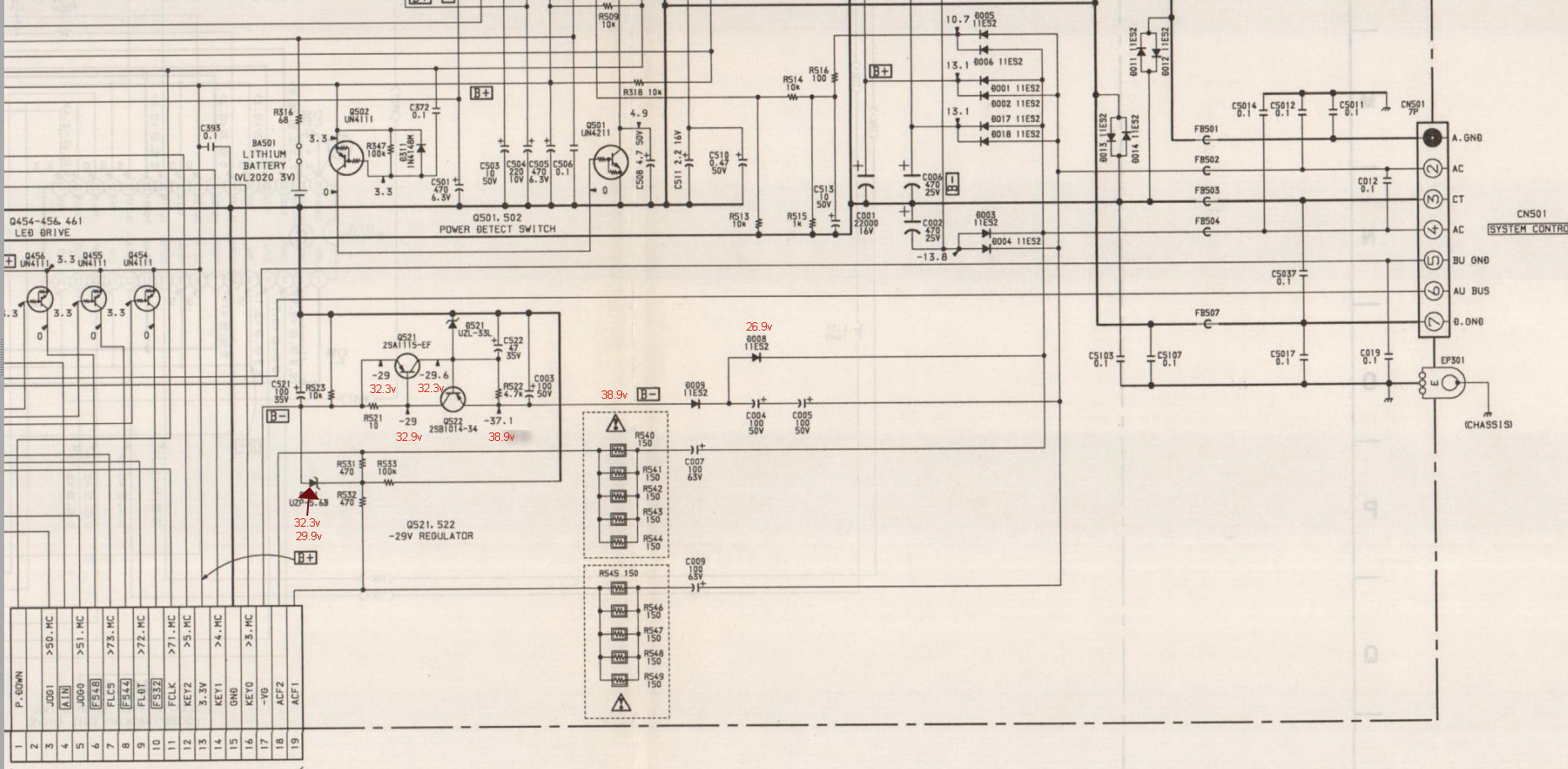

      Update monologue On MD (MDS-EX77) i check voltage on ribbon that connect main board and front board (display), pin 18,19 (ACF1,ACF2) show ~30v and pin 13 - 3.3v. So i assume main board is good and the problem is in front board/display as it is getting enough power. Hm.

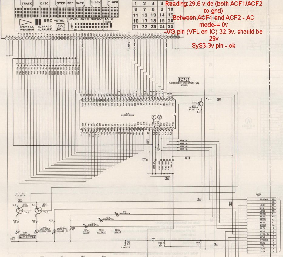

          Voltages that come from main board and feed front board/display do not match service manual. First thing strange is that VFL pin on display ic driver show 32.3v and not 29v. 3.3V pin reading is normal. Somewhere i read that AC probe between filaments end should draw few volts (ac) and i have 0v. Still, in dc mode, end of filaments to ground show normal voltage.
          On main board section (pic included) i have removed and check all resistors, diodes and transistors, everything seems to be normal. Im not sure where im wrong.. maybe problem is Q521/Q522 transistor. Any ideas? Thanx in advance!

            If the heaters are visible in post #2 then you must have acf1 and acf2, it is usually around 3~4 volts ac measured across them, not to ground
            The schematic is not correct, D521 is a 33 volt zener diode, so the voltage on Q522 collector should be about -33~-34 volts.
            Check the zener diode (covered by arrow) and make sure it is not shorted. If you have a scope check the ripple on the B-. If C521 and C522 or C003 are bad that will cause a dim display. I would try bridging them with another 47µf and see if it helps
            I see part of the display is bright [1 ~ 10], it could be that the display is bad, if it was a problem with the voltage it should effect the whole display not just part of it.

              Hello. Well post #2 is cd display which is second problem but still, its working so for now im not touching it. I'm talking about md display and schematic is related to that. I have check diode covvered with arrow (uzp-5.6b) with simple multimeter diode check and its not shorted. Q521 collector voltage is 32.3v now and should be 29 (-29) as display IC driver pin (-VG to VFL pin) get 32.3v now so i assume schematic is correct. Between acf1,acf2 i dont have reading, 0v ac. Still acf1 to ground and acf2 to ground dc i have reading ~29/30v if i remember. Thanx for effort and im looking forward. I'll check caps c521,c522,c003.

                Re: DHC-EX77MD problem with display
                Schematic

                  Ok, I understand it's the other display. With no a/c for the filament Check the caps C009, C007, Check if you have a/c (3~4vac) between C007 + and C009 +, If you have the ac voltage there, either one or both caps are bad or the resistors in that line are open.
                  That q522 is a simple regulator, its output voltage is based on the "base" reference, in this case a 33 volt zener, so the output will be aprox 33 volts, being a couple volts high or low will not effect the display where it would be noticed
                  measuring 33 volts on the acf1/f2 to ground is normal, It comes from B- via uzp-5.6b zener diode and through R532, there is no current drawn at the moment so there will be no voltage drop. Its there to apply a small dc voltage on the filiment, again it should not effect the display brightness

                    And........ it was C007! Everything work like a charm now! Man you rox !! Now im going to fix cd display dim with your tips and will update here. Do you accept donations or so? Cheers!
