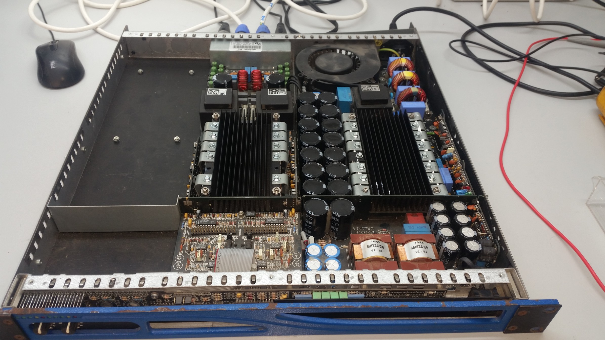

    Hi guys, anyone here familiar with these amps?
    The one I have has no output from the PSU board, when switched on it draws a very small amount of power from the mains (I can see my current limiter bulbs glow very very dimly) but that is all.
    I have the schematics but for the life of me can't figure out how this amp is supposed to power up
    I have about 250V DC on VRECT and CTRSWITCH (when the front power switch is on) but I have no VAUX so I can't see how it could ever power up in this condition.
    As much as I have looked over the schematics I can not understand where VAUX is derived. I would have expected to find a small switch mode or even a regular mains transformer providing VAUX, but no. All I can see is VAUX comes from A on SCH.QD-ALSU but it isn't obvious to me how that should work.
    Or maybe I am totally misunderstanding how this amp should start up?

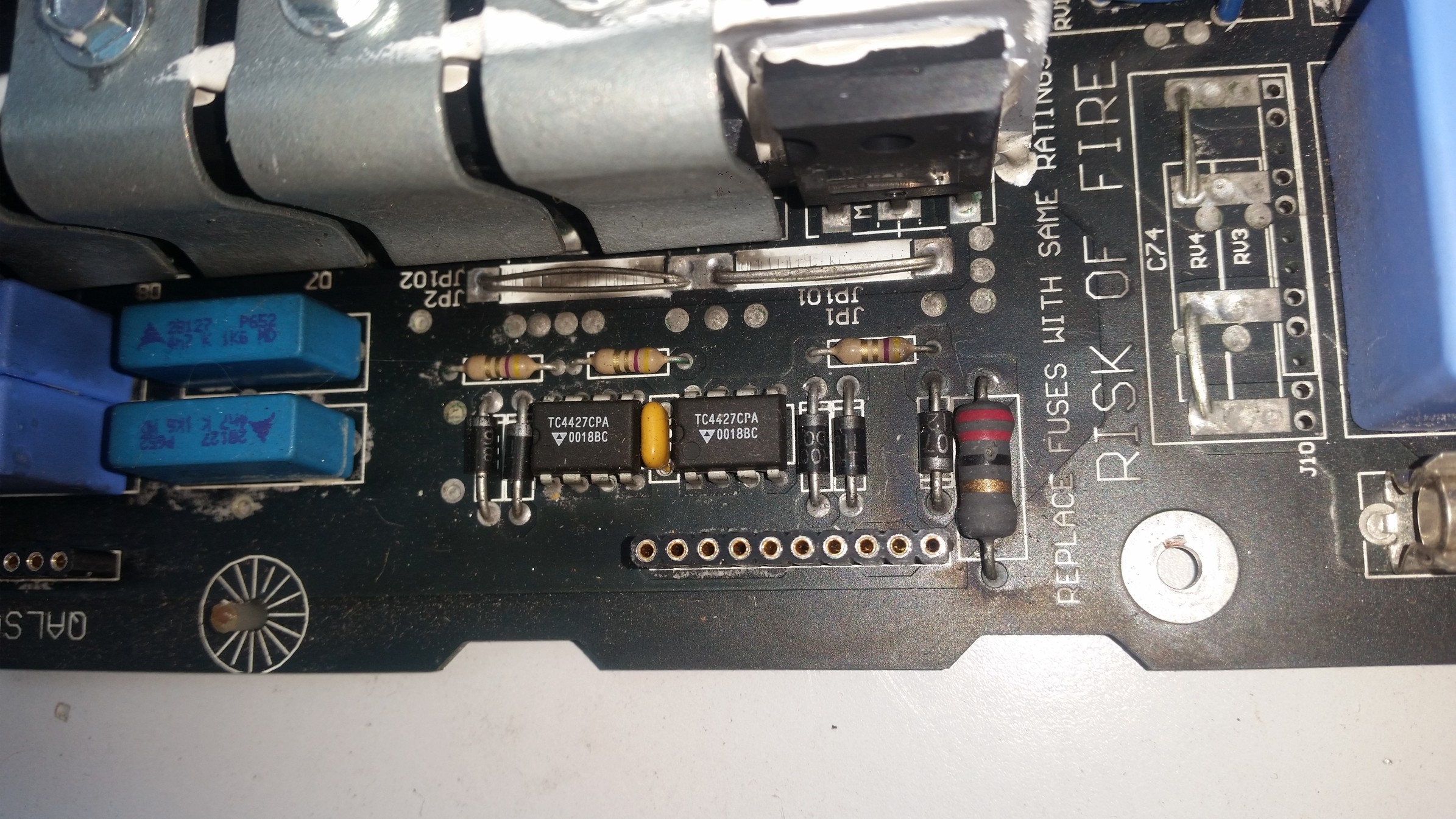

                      Ahaa I got it
                      The Junction L1, R1, J5 pin 2 does indeed connect directly to J3 Pin 1 (CTRL S) on ALSU. It just doesn't show the connection on the schematic because whoever created the schematic obviously didn't do their job properly!
                      CTRL S is one side of the front panel power switch. CTRSWITCH is the othe side.
                      I previously thought I had a high voltage on CTRL S and CTRSWITCH but I don't, just about 11V slowly charging up.
                      The fault was a simple one - I'm surprised I didn't find it before but think somewhere down the line I've confused myself
                      R42 on QALIN14 is reading very high resistance (should be 22 ohm)
                      I'm not sure what wattage that is, can I tell by the size? I think it may be 2W... in which case would this physically smaller resistor be OK as a replacement? I'm sure that is 2W, just a different type. See pics

                        At least for testing, i'm sure it'll do the job. It's there just to act as a "soft fuse", as it were, to limit the current drawn by the control board circuitry.
                        If they're rated the same (and especially if the new one's not some random Chinese "ebay special), then the new one should be fine, despite the smaller physical size.
                        Glad we finally manage to nail the main(?) issue Looking forward to hearing back post-resistor-swap...

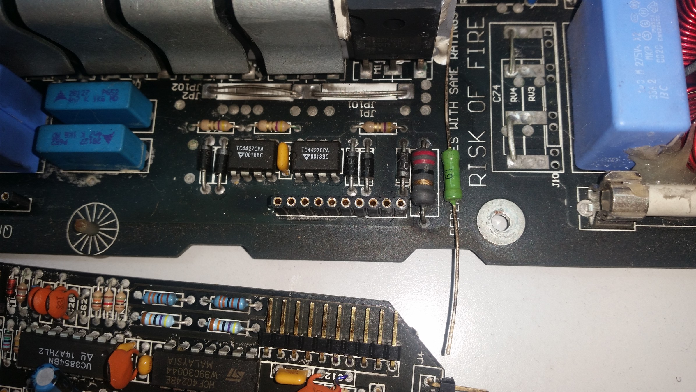

                          Re: Powersoft D4002 no power
                          Hi Khron
                          Yes it's fixed and I have to say mostly due to your help
                          What's even better this amp came to me via a new customer i picked up who has become a regular. He has a previous repair shop and they couldn't fix this one.
                          And it's funny how it turned out so simple in the end, isn't that just the way it goes sometime..
                          I got a whole box full of those type of resistors, I picked them up with a load of new old stock at an Amateur Radio rally some years ago.
                          I fitted and ran the amp for about 30 mins. The resistor isn't even warm to the touch afterwards. I guess it is gonna be just fine
