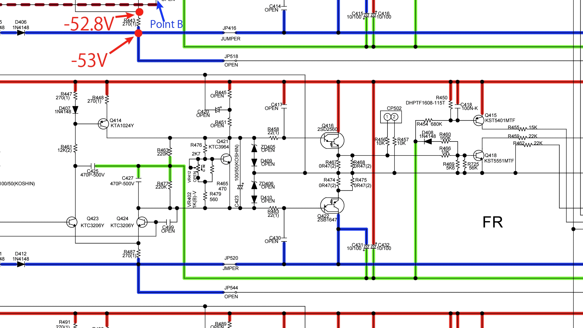

    Left front channel blown both Darlingtons shorted C-E. Emitter resistors R467 and R468 open as well as base resistor R458.
    Is there anything else that might be suspect judging by the failed components ? I can look at the schematic but my inability to "read" it and see what's really happening leaves me at a disadvantage.
    Is it advisable to use the Dim Bulb tester on an amp driven by a microprocessor like these are or that doesn't matter ?
  • redwire
    • Dec 2010
    • 3910
    Re: Marantz SR5012 Blown Channel
    R468, R467 are the Front Right channel.
    When audio power amp output transistors short, the previous (driver stage) is usually also dead or damaged. You must parts check upstream.
    If the 22R fusible resistors are blown, then an overload went back to previous stages. Bias transistor Q421, Q414, Q424 could also get overloaded, and need to be checked. If Q421 is open-circuit, then C423 would pop.
    I just check every transistor with a multimeter on diode-test, it takes a couple minutes. Comparison readings to other (working) channels can also help.

      Yes you are correct it was the right front channel that was blown. Base resistor R483 for the other darlington was out of spec as well. I borrowed parts from one of the surround back channels to repair the right front channel.
      Upon testing the Left Front channel is lower in volume than the other channels. Worse yet there is no HDMI output to the tv.

        I guess you'd have to see if the power amp channel is quiet, although rare because you usually get distortion if a part is not working. Other Marantz models people are replacing the volume control IC. Have to inject a sine-wave and measure ACV to know for sure.
