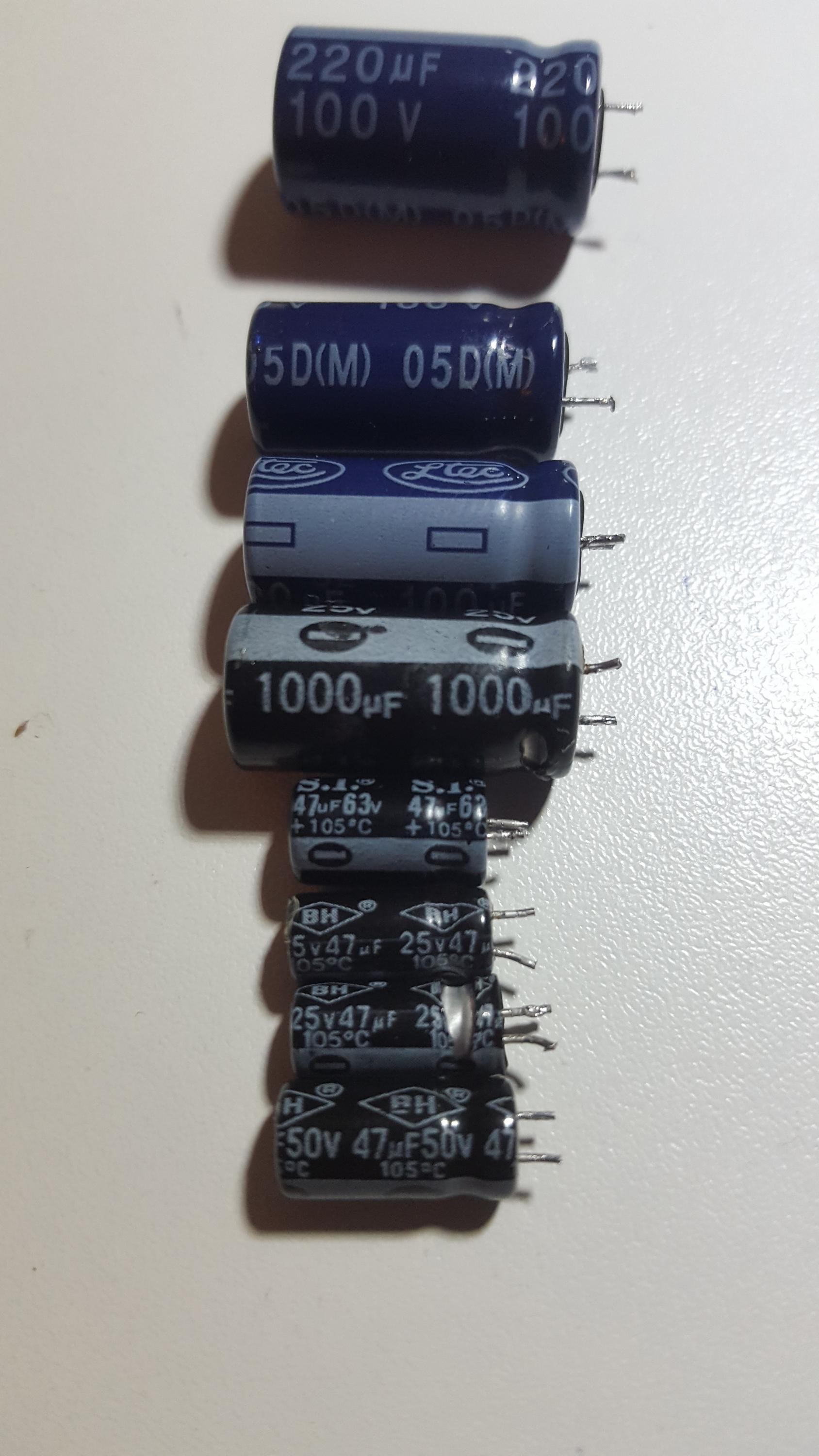

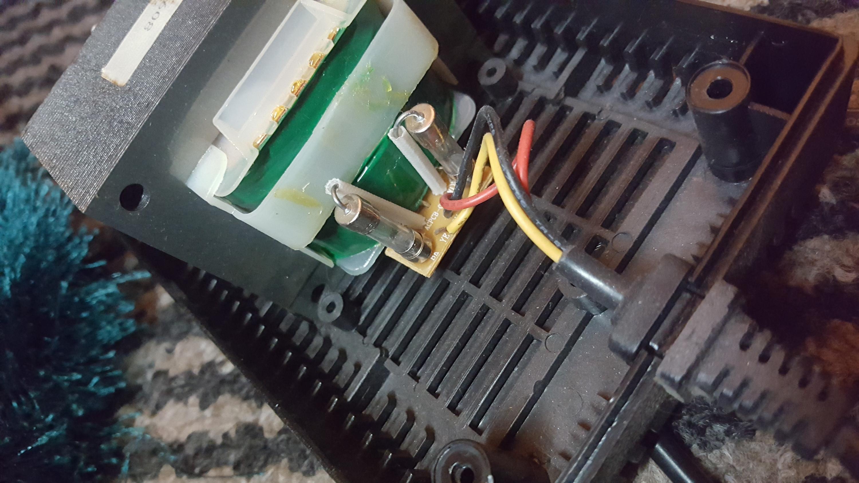

    Hi, guys brilliant forum I have used it many times to help me with info. I am currently working on a Behringer eurorack mx 1804x which keeps blowing the adapter fuses upon opening it up I have found two capacitors which are slightly bulged at the top they are s.i 2200mfd 35wv which I think means 2200uf 35v so I'm planning on replacing them but I'm not sure of which capacitors to choose for there replacement I was on mouser and I'm not sure of the esr and ripple current I need any suggestions guys. I do think this power board has been recaped before as it has none of the xunda caps.
    Any info much appreciated

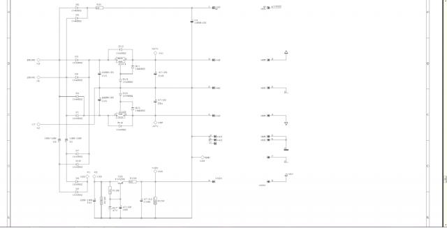

    Re: BEHRINGER MX-1804X Blowing Adapter fuses
    http://www.paullinebarger.net/DS/S.I...%20Limited%5d/

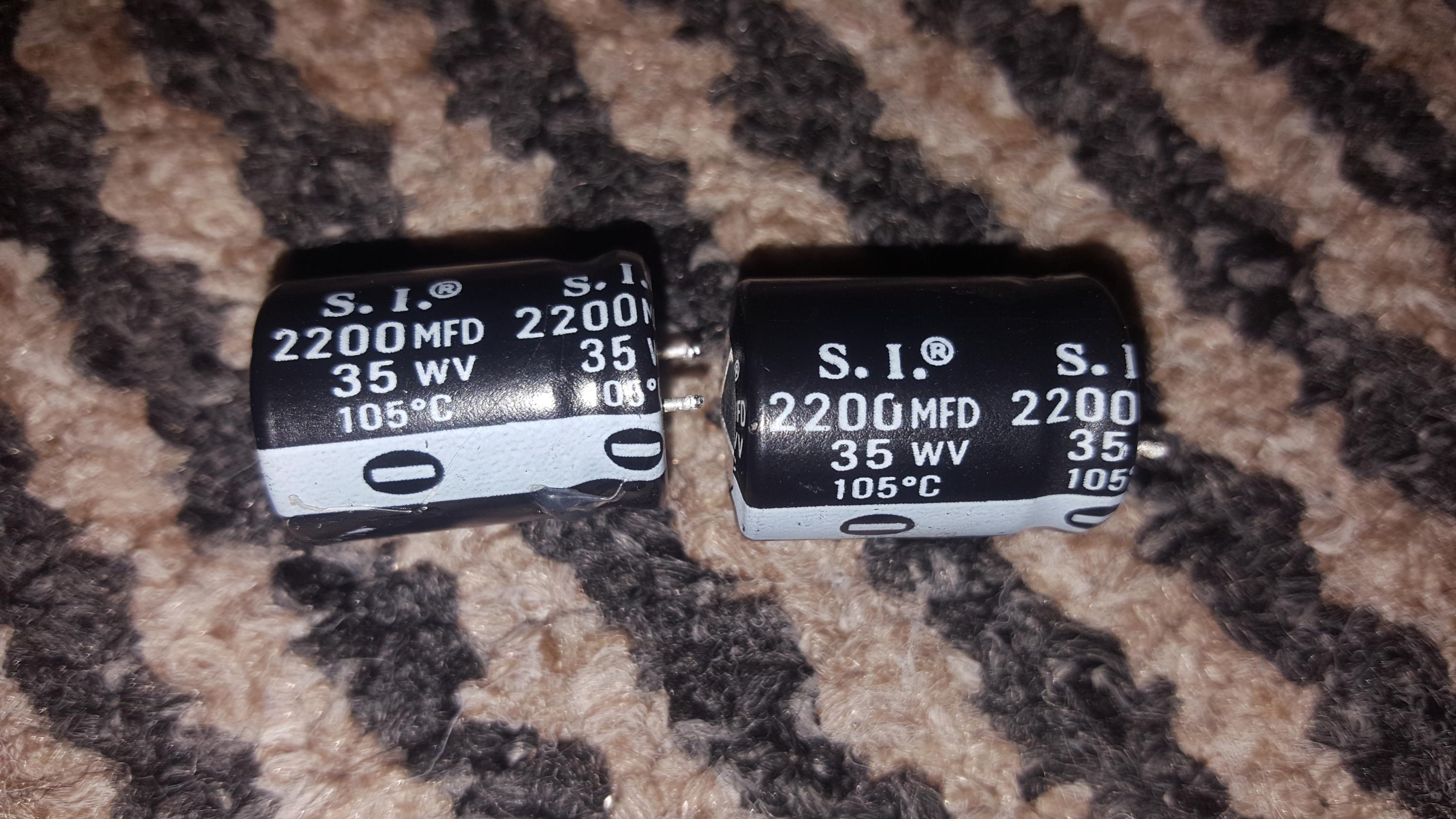

        Thanks guys for the info, capleaker how do i find those pacific series of caps in mouser it just tells you the brand ..Thanks

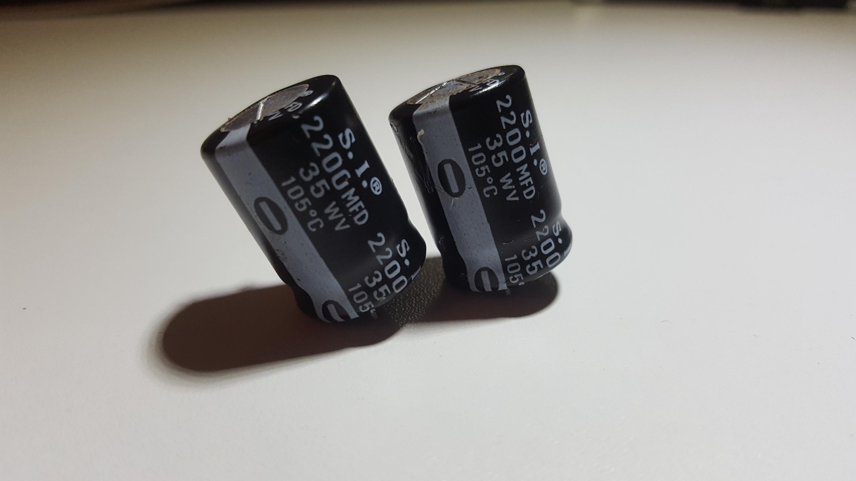

          will this do it mouser part no 667-EEU-FR1V222B
          Cheers guys
            Cheers guys
            It tells you in the datasheet that those are FR series (Same as FM). Those are the ones! Also a part of the FR1V222B sez FR. Anything that I fixed with Panasonic, Nichicon and Rubycon caps hasn't come back yet.

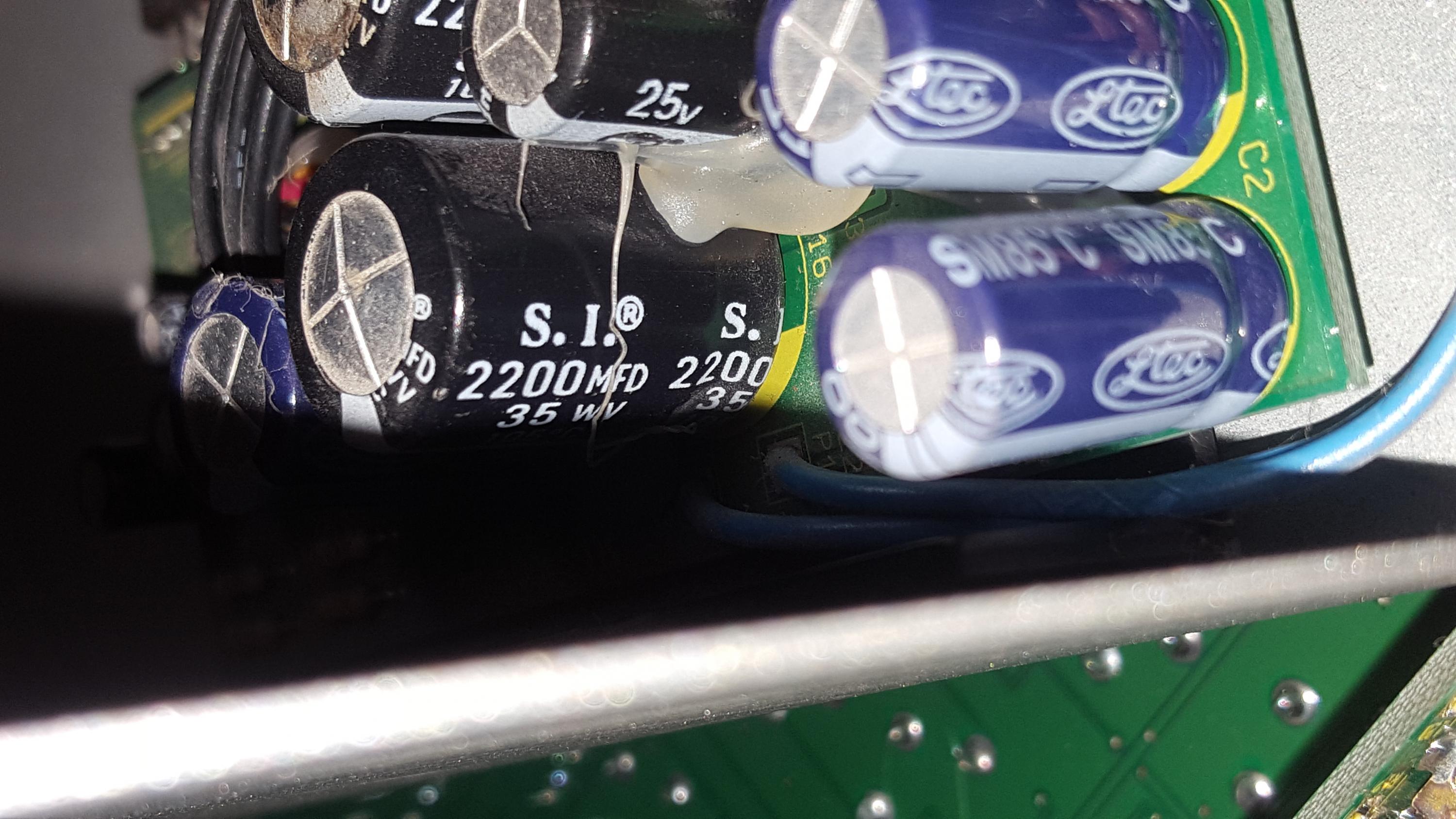

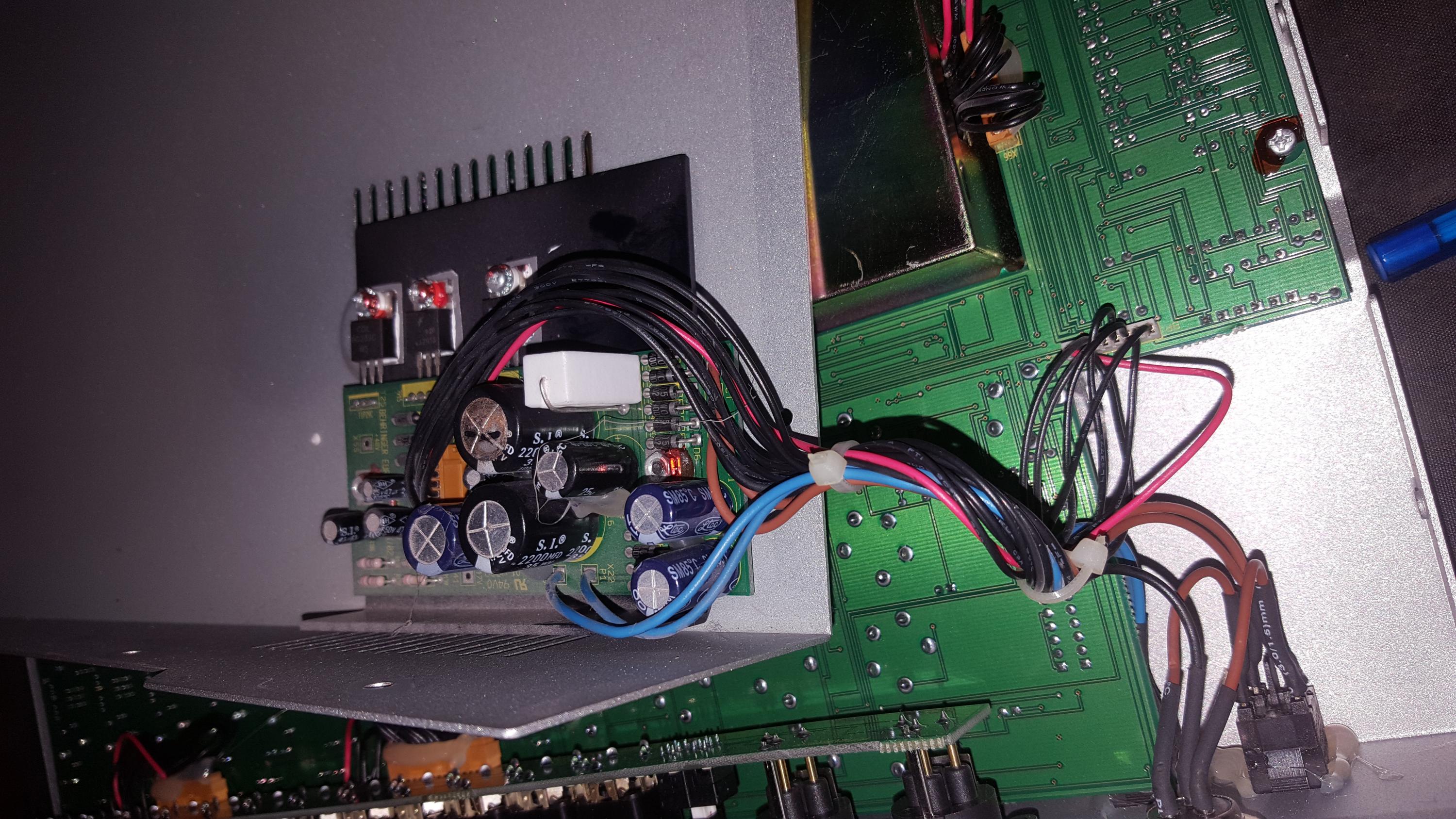

              For garbage no-name caps like these, I don't even bother looking at any datasheets. I just look at the circuit and go with something that is made for it.
              For example, I see your power supply is a linear one, as seen by the oldschool line transformer in this picture:
              https://www.badcaps.net/forum/attach...1&d=1528014886
              That means you don't actually need low ESR caps. 85C general purpose caps will likely be fine, unless the device runs very hot... in which case going with 105C-rated caps or entry-level low ESR ones that are rated for longer endurance is probably a better option.
              Just stick to any of the major known-good Japanese brands, and you should be fine - i.e. Panasonic, Rubycon, Nichicon, and Chemicon. And as long as you stick to buying from Mouser, Digikey, or any other reputable place/site (NOT eBay, Amazon, and AliExpress), the caps should be genuine too.
              As far as what to pick... probably any of these should do, among others:
              Panasonic: M, EB, FC, FK, FR, FM, FS
              Rubycon: AX, PX, YXA, YXJ, YXG, ZL, ZLH
              Nichicon: VR, VZ, VY, PS, PJ, PM, PW, PA, PV, and HE
              Chemicon: KMG, KMQ, KMY, KY, KYB, LXV, LXY, LXZ
              And from these series, anything after (to the right, and including) Panasonic FC, Rubycon YXJ, Nichicon PS, and Chemicon KY is usually a good pick for switching PSUs as well - i.e. PC PSUs, LCD monitor PSUs, and small switching adapters.

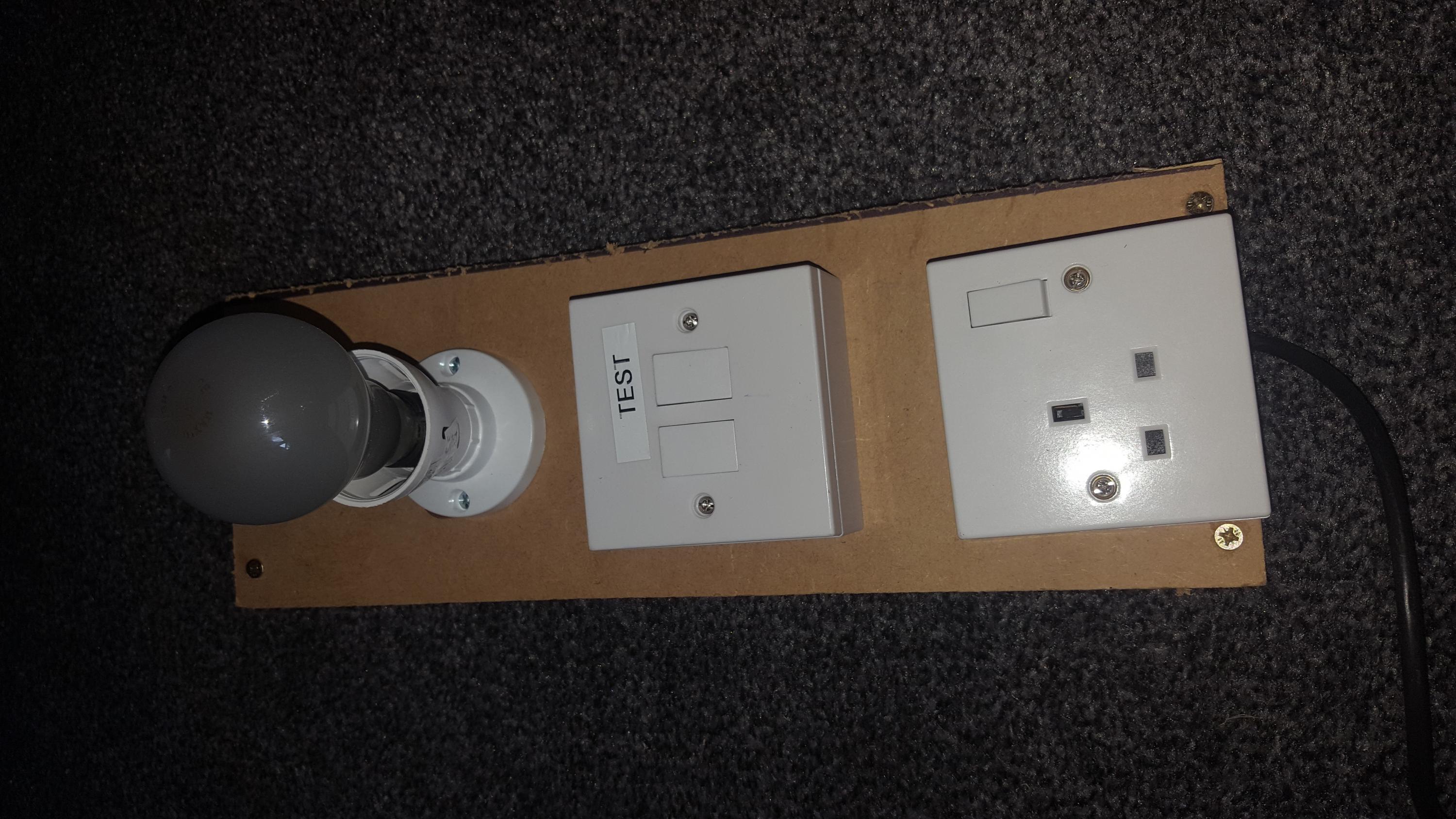

                    I did use a current limiting device ie a bulb with a socked on it but not sure if it actually did anything to protect it.
                    It stops the initial inrush current surge blowing the fuses again and sometimes doing even more damage if you haven't fixed all of the faulty components. Remember you need to use an incandescent bulb. Lookup "lamp limiter" on google for lot's of detailed reading and bulb sizes etc. ...
                      Hi, Check12 thanks for the info I have made a current limiting device I will attach a picture I found the instructions to build it on google. Cheers

                        Yeah that looks about right ... looks like a plastic bulb socket though (check what it's max rating is) ... probs about 100watts. Just be careful not to use it for high power devices e.g. large power amps or if there is a fault it could melt really quickly ...
                          Nah, even if you use a bulb with much higher power rating, it won't be an issue in this application - not unless the bulb fully turns on and stays that way for more than a few minutes. It takes time for incandescent bulbs to built-up heat in the socket (whereas the bulb gets hot almost immediately - but that's not a big deal).
                          Just don't leave this plugged in with a very powerful bulb unattended, that's all. Otherwise, it should be absolutely fine.
                            Yes just re-read that and it does give the wrong idea... I've seen someone else use the exact same super cheap socket and instead of a switch to bypass the bulb they used a shorted bayonet fitting (to negate the chance of leaving the bypass switch on by accident) ... the socket melted in a few seconds with a faulty large power amp. I should have put all the details in the post above. But the moral of the story is keep an eye on these as they can get hot ...
