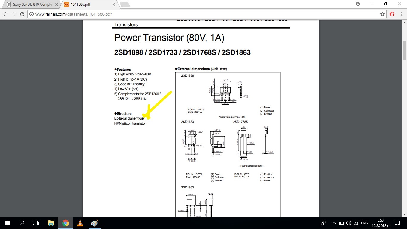

                      Q1205 is NOT Darlington
                        From service manual: Q1205 8-729-048-78 TRANSISTOR 2SD1733-TL-QR
                        Panasonic datasheet is Darlington TO-220
                        Rohm datasheet is BJT 80V 1A 2W hFE 82-390 DPAK
                        Does Q1205 get hot?

                          2SD1733 is a NPN silicon transistor, not darlingon. You can see your web link / / is wrong. 2sd1733 is not hot, absolutly cold.
