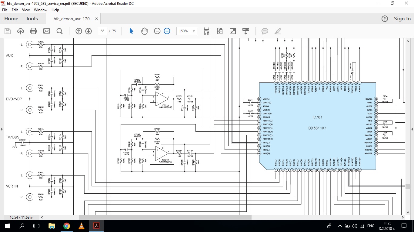

    Hi. I have Denon AVR1705, without sound on output terminas and no sound on headphone. I check all voltages and they are normal. +1.2V and +3.3V also normal.
    This amp is with Sound Processor build with Mode/Input selector BD3811K1 and i thing the problem is may be on this chip. Do you know some solution on this problem.

    Re: Denon AVR-1705 no sound
    I have an AVR-3200 that plays "dead" until I crank the volume up to about at least -20 dB. After that, it will start playing sound. Not sure how similar your amp is internally, but give this a try anyways: crank the volume all the way up while playing something, then turn it down.
