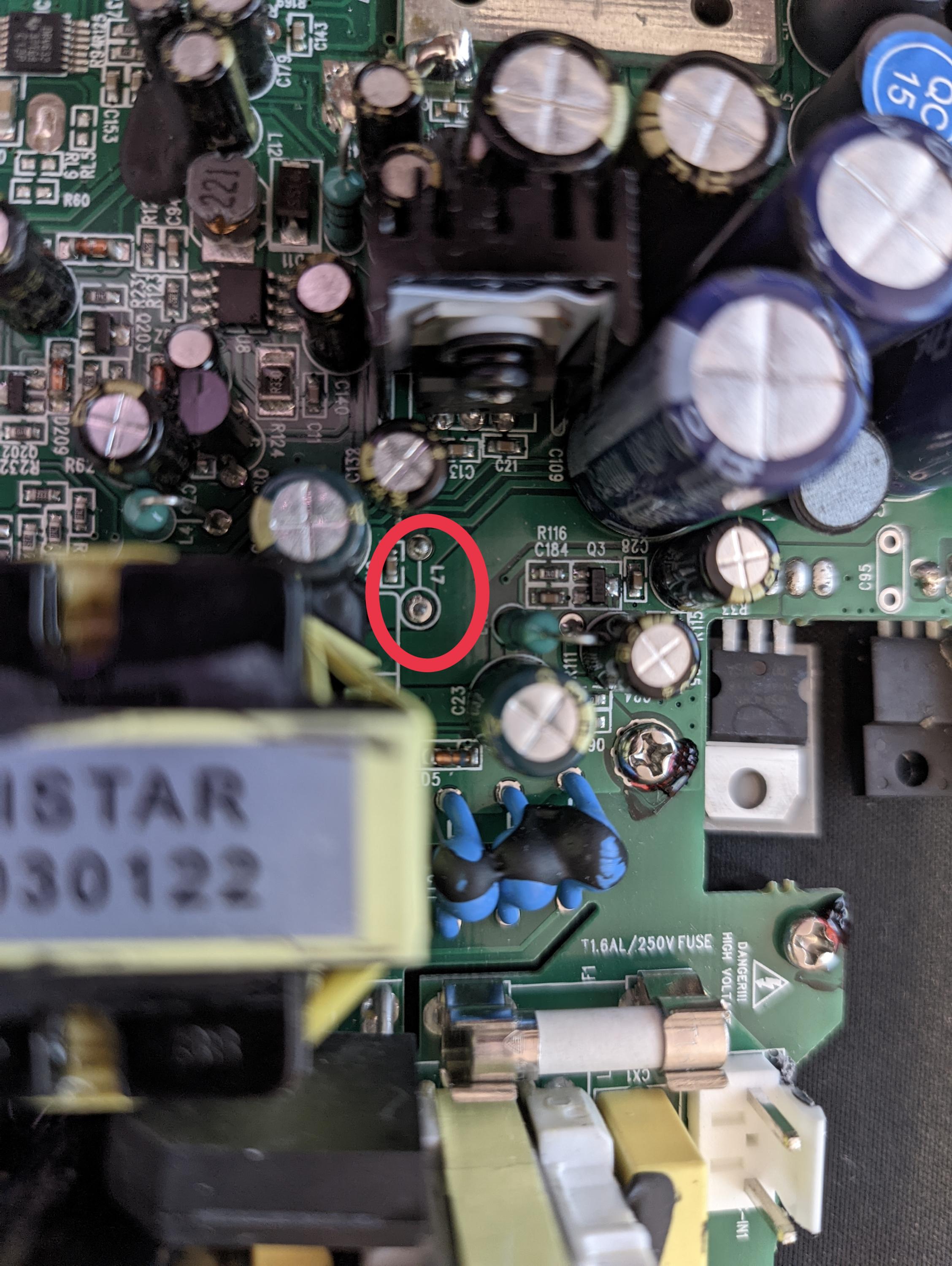

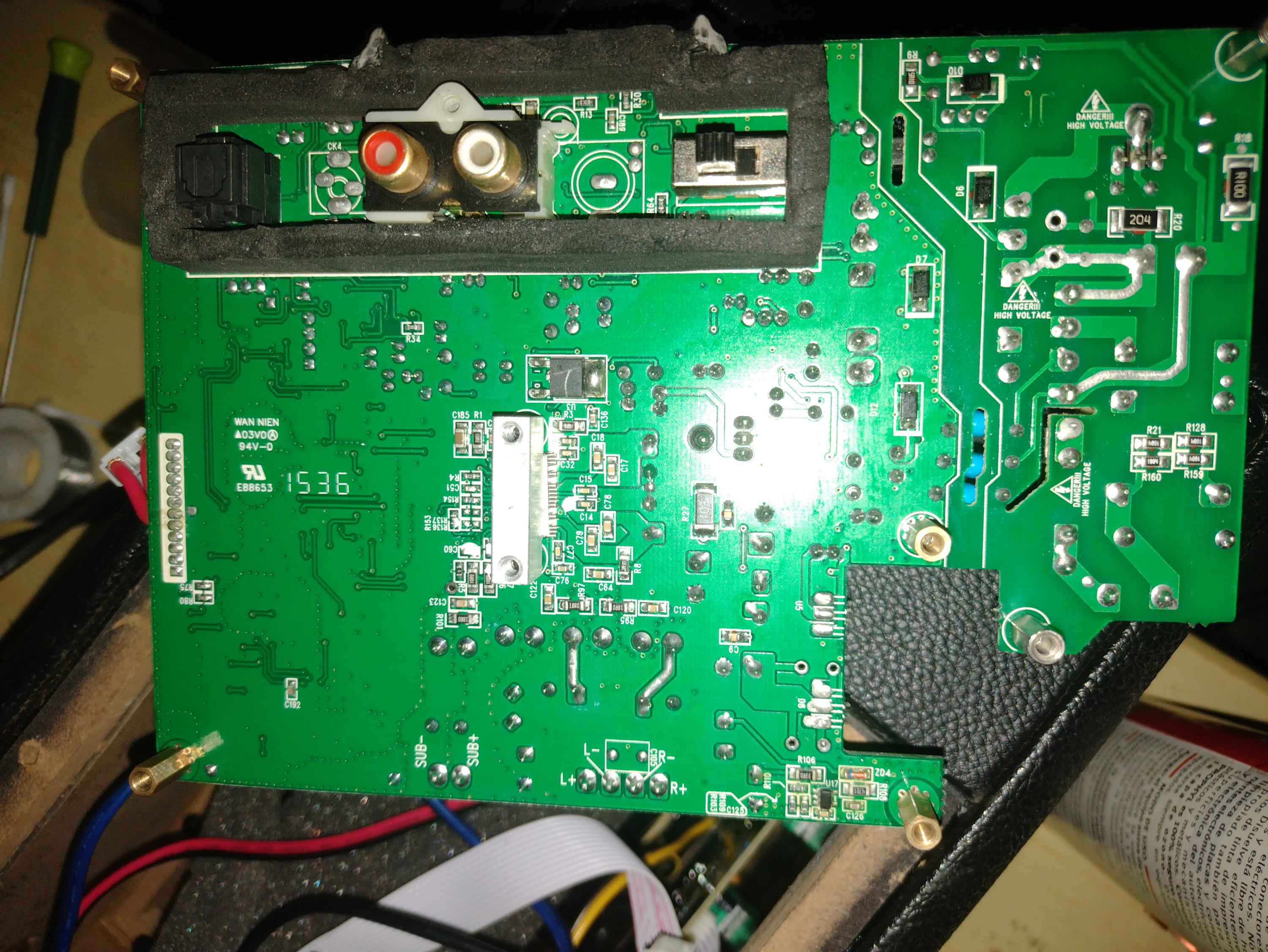

Marshall Stanmore Repair
  • Arl96
    replied
    Re: Marshall Stanmore Repair
    Hi, I'm from Argentina. Does anyone know what are the models of the transistors marked in the photo? I have received a Marshall Stanmore team with the lack of these two
    Leave a comment:
  • hann
    replied
    Re: Marshall Stanmore Repair
    how did you know that its shorted?
    Leave a comment:
  • TimelessTech
    replied
    Re: Marshall Stanmore Repair
    I'm not sure if this thread is still active, but my Tristar 13030122 is as shorted as can be and I hoped that maybe someone on here knows a suitable replacement part for it. Maybe via Aliexpress or something. Kind regards
    Leave a comment:
  • ceedjay
    replied
    Re: Marshall Stanmore Repair
    Hi.
    I have tried to move the transformer between the two and the whining is not moving. This means that it is not the transformer that is "faulty". If i remove the rectifier diode on the 14V line that feeds the LM817 the whining disappears. Everything is working so what can be wrong, maybe something on the 5V?
    Regards
    Last edited by ceedjay; 01-24-2023, 06:38 AM.
    Leave a comment:
  • ceedjay
    replied
    Re: Marshall Stanmore Repair
    Last edited by ceedjay; 01-23-2023, 01:31 PM.
    Leave a comment:
  • ceedjay
    replied
    Re: Marshall Stanmore Repair
    Hi.
    I have successfully repaired two stanmore. Both had identical faults. 220 ohm resistor to optocoupler burned. I have replaced all capacitors on the hot side. I have changed Mosfet,pwm ic, various resistors including 0,1 ohm shunt. I have replaced everything between pwm ic transformer output and the pwm ic. All diodes except the full bridge. All rectifier diodes after the 3 transformer output. 7812 and power amplifier. Both are now working but one of them have a high pitch transformer whine that also leaks into the sound. If I mute the sound the whining can be heared very clear out of the speaker.
    Does anyone have any idea what i could do?
    I have changed all 1000uf,470uf and 220uf capacitors as well.
    Regards
    Last edited by ceedjay; 01-23-2023, 01:39 PM.
    Leave a comment:
  • DeeJayAlex
    replied
    Re: Marshall Stanmore Repair
    #3-30v DC
    #1 and 2-14v DC
    Leave a comment:
  • Walzzu
    replied
    Re: Marshall Stanmore Repair
    Originally posted by DeeJayAlex
    This speaker barrel has 3 outputs
    # 2x14v and 1x30v
    Hmm... Which voltage should go where?
    Two first are the grounds but what are the other 3?
    Thanks in advance.
    Leave a comment:
  • DeeJayAlex
    replied
    Re: Marshall Stanmore Repair
    This speaker barrel has 3 outputs
    # 2x14v and 1x30v
    Leave a comment:
  • Walzzu
    replied
    Re: Marshall Stanmore Repair
    Could someone tell me the cold side voltages coming out of the transformer?
    Hot side is completely buggered, so I think i will bypass it and use different switching psu.
    My tristar transformer is showing opens.
    Leave a comment:
  • DeeJayAlex
    replied
    Re: Marshall Stanmore Repair
    Originally posted by StephE
    on mine R96 is 10kOhm, (labeled "01C")
    Do you know / could you check the values of ZD1 and ZD3 please if it is still open ?
    Regards
    Thank You for reply!
    ZD1 and ZD3 seem to be ok(0,7mV on diode check)
    they are zener diodes, which unfortunately I don't know what value they are
    Soon I will start to repair it and if it is successful I will check the voltage drop of the zener diodes so that we can figure it out and I will let you know.
    Regards.
    Last edited by DeeJayAlex; 11-16-2022, 03:50 AM.
    Leave a comment:
  • DeeJayAlex
    replied
    Re: Marshall Stanmore Repair
    Originally posted by SkyHeart
    can you post a picture of the location?
    The Location of R96
    Thx.
    Last edited by DeeJayAlex; 11-16-2022, 03:34 AM.
    Leave a comment:
  • StephE
    replied
    Re: Marshall Stanmore Repair
    Originally posted by DeeJayAlex
    Hello guys,
    R96 is burn can you help me with its value?Thx
    on mine R96 is 10kOhm, (labeled "01C")
    Do you know / could you check the values of ZD1 and ZD3 please if it is still open ?
    Regards
    Leave a comment:
  • StephE
    replied
    Re: Marshall Stanmore Repair
    did you ever figure out the values/types of the three diodes ?
    I have the same problem.
    And lots of leaking caps.
    Regards
    Leave a comment:
  • SkyHeart
    replied
    Re: Marshall Stanmore Repair
    Originally posted by DeeJayAlex
    Hello guys,
    R96 is burn can you help me with its value?Thx
    can you post a picture of the location?
    Leave a comment:
  • DeeJayAlex
    replied
    Re: Marshall Stanmore Repair
    Hello guys,
    R96 is burn can you help me with its value?Thx
    Leave a comment:
  • SkyHeart
    replied
    Re: Marshall Stanmore Repair
    Hello Guys,
    it's me again trying to fix this Stanmore speaker mess, after changing a lot of components I was able to fix the power issues, the speaker comes on, lights are on, Bluetooth connects fine, when I play music sound comes for few seconds then I will hear 2 or 3 loud static from the speaker and sound disappears.
    if anyone had a similar issue and was able to fix it please do share the information, I did change the TAS5342A IC.
    Leave a comment:
  • SkyHeart
    replied
    Re: Marshall Stanmore Repair
    I think it's an Inductor not a resistor, for me it's the first time I see an Inductor in the shape of a resistor
    it's been a while since last time I worked with Electronic it's been more than 15 years.
    thanks for the help guys.
    Leave a comment:
  • SkyHeart
    replied
    Re: Marshall Stanmore Repair
    Hi Folks,
    I was finally able to find the issue with my Stanmore, after changing the 12v regulator which is in the middle of the PCB (KIA 7812A) i found out that it's not getting any input current, had to remove it again to trace the input which is feed by L7 it looks like a normal resistor it was a bit toasty, I'm not sure why the numbering on the PCB says L7.
    my issue is number 2 from the first post, everything works without sounds output.
    I changed that L7 with a normal 47ohm resistor and I got sound.
    attaching a picture of L7 location.
    Leave a comment:
  • SkyHeart
    replied
    Re: Marshall Stanmore Repair
    Originally posted by kros
    Hi.
    My friend bought this IC from two different sellers they were new, At the first seller after replacing this IC there was no sound , bought 2 pcs and none of them worked, when he bought from another seller another two IC the IC was working properly, my friend said that there are a lot of fakes of this IC . And you have to be careful when buying.
    Thank you kros for the information,
    I got the amplifier IC's from mouser.com which is a very known website for selling electronic parts so I don't think they are fake.
    Leave a comment:
  • Kezi Gamer
    Marshall stanmore multi room
    by Kezi Gamer
    Hi, recently i have encountered problem with my Marshall stanmore multi room speaker, speaker itself works fine using app from my phone but knobs on actual speaker doesn't work. First thing that came up to me is that maybe something is shorted on the top board and after disassembling the speaker and checking with multimeter I could not find anything wrong, also on the panel multi, and next song button are working and nothing else. Any help is very appreciated​...
    03-24-2025, 08:37 AM
  • jingleslacks
    Marshall Stanmore II - chip flash
    by jingleslacks
    Hey Friends!
    I have both a live and demo unit. Demo unit firmware disables Bluetooth, power toggle, and other settings. Resets via button combos will not work on these. Reaching out to Marshall is not an option either.
    I copied my live CMOS chip and flashed it to the demo unit, but that didn't fix it (MX25U3235F) This has worked for other devices in the past. I'm not a chip expert, but I'm assuming the firmware is stored in another chip.
    If anyone has any experience or ideas, let's hear them!
    Stanmore II
    Stanmore 2​...
    03-23-2024, 05:09 PM
  • thuygsm
    Marshall Stanmore 2 (flash chip)
    by thuygsm
    hello
    in my case, the Bluetooth - AUX - RCA signal light goes off after 5 seconds and repeats, (sound is there then 5 seconds then gone and repeats)
    i forgot them and reconnected, but they do not play on the speaker, although i can still adjust the 3 modes Bluetooth - AUX - RCA (on the phone)
    after i loaded a new rom, i lost bluetooth connection and could not power off, no boot sound. i loaded the previously saved rom again, but the situation still cannot find bluetooth and boot sound
    hope everyone can help​
    04-08-2025, 10:27 PM
  • ohren
    Original Xbox 1.0 PSU: Foxlink FTPS-0002 Rev. B. — 12 V low, 5 V high — transformer?
    by ohren
    Hello!
    I'm looking at an original Xbox PSU: Foxlink ftps-0002 rev. B. The 12 V output is too low, and the 5 V output is too (?) high. Unfortunately I don't have an oscilloscope but only a DMM for diagnosis.
    Measured voltages with no load:
    After rectifier diodes
    12V: 6.17 V
    5V: 5.67 V
    Secondary transformer pins AC measurement (really don't know if this says anything)
    12V: 2-2.5 V
    5V: 1.04 V
    I also have another (working) Xbox psu from Delta. The same measures there, in order, being: 10.79,...
    03-18-2023, 10:33 AM
  • Sisko
    Onkyo-593 No power and now clicking sound
    by Sisko
    Hi all!!
    Ok just got a Onkyo SKW-593 sub woofer that has no power person told me that it smoked and that his GF let the volume full when she powered off the amp and when he came to turn it on the sub played but then suddenly smoke was coming out, didn't say from where. So opened it up and saw a resistor made of metal (pic) but can't see any writing on metal par so what ever was written on it was burnt. So I'm kinda stuck here with this. I did ask for a repair or schematics in the other group section and waiting for this but I hope someone here might lend me a hand to try and identify...
    10-03-2025, 02:18 PM
