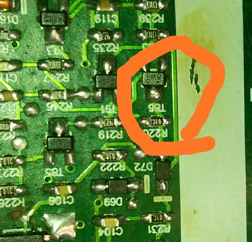

    hi i would really need a service manual on this power amp speaker.can't seem to find much on this on google,ect....
    i have a burn parts that look like a big resistor (r242)and cannot see the value of it,so would need to have the manual for parts and info...
    if someone have one around and could give me info i would really appreciat that.

    Do you have the working one that you can take apart and look since it is for PA system?
    Pictures of the board may help to determine the function of that resistor in the circuit.

      D92/15v
      D88/24v
      T86 t9/smd code 8w 0?

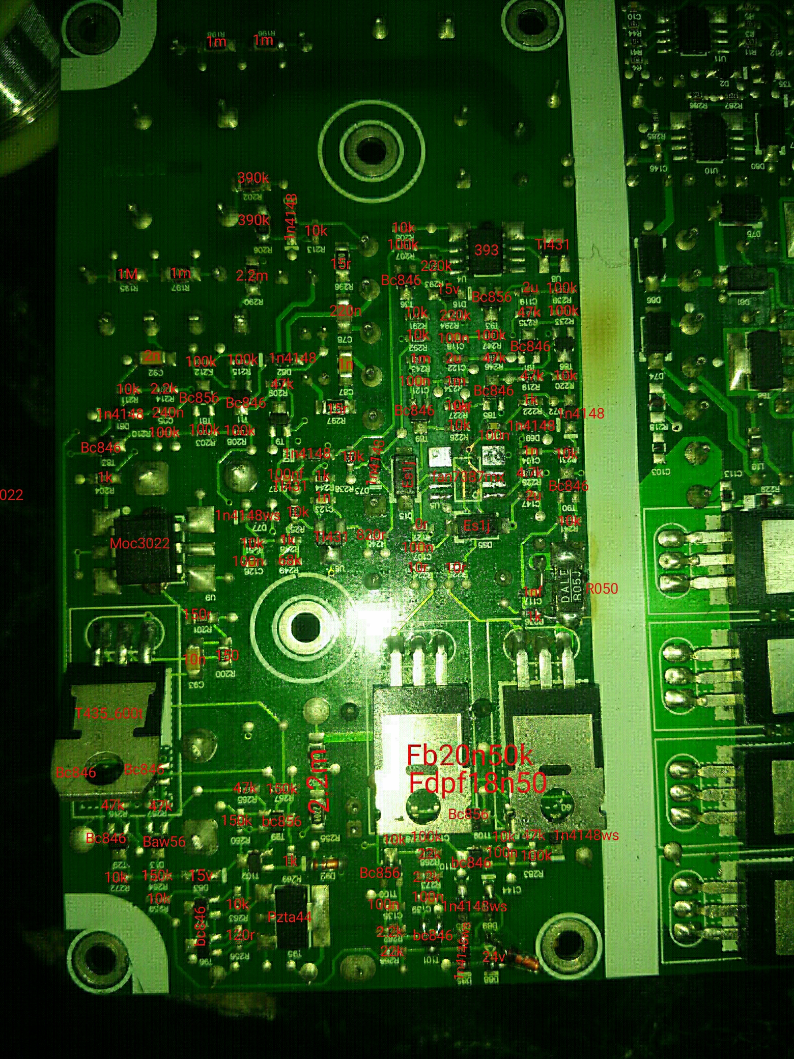

        U5-7387(FAN) , R242-0.05 , R236-1K , R245-820 , R224&225-10 om

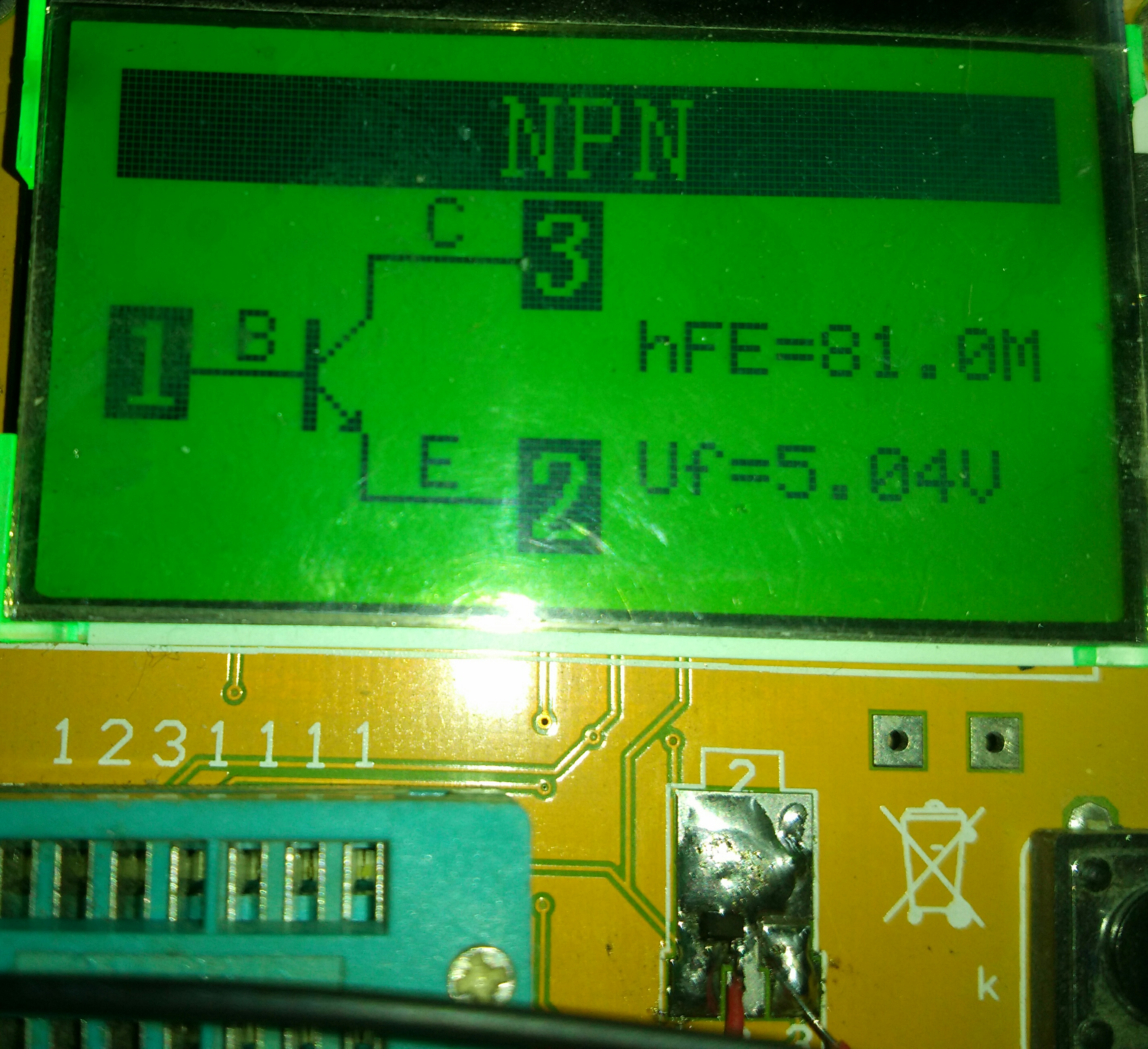

          smps Ev ekx transistors npn smd code 8w ? Please instructions

            my databook says 8w are zener diodes!

              Dtc114wn3
