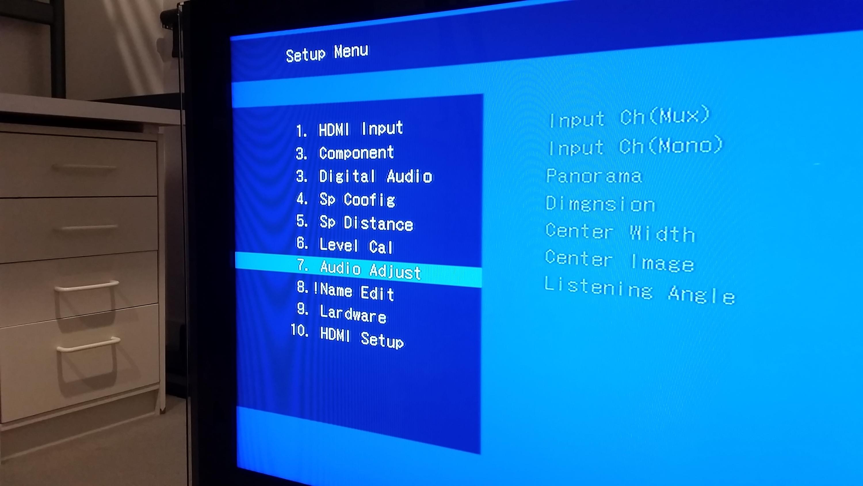

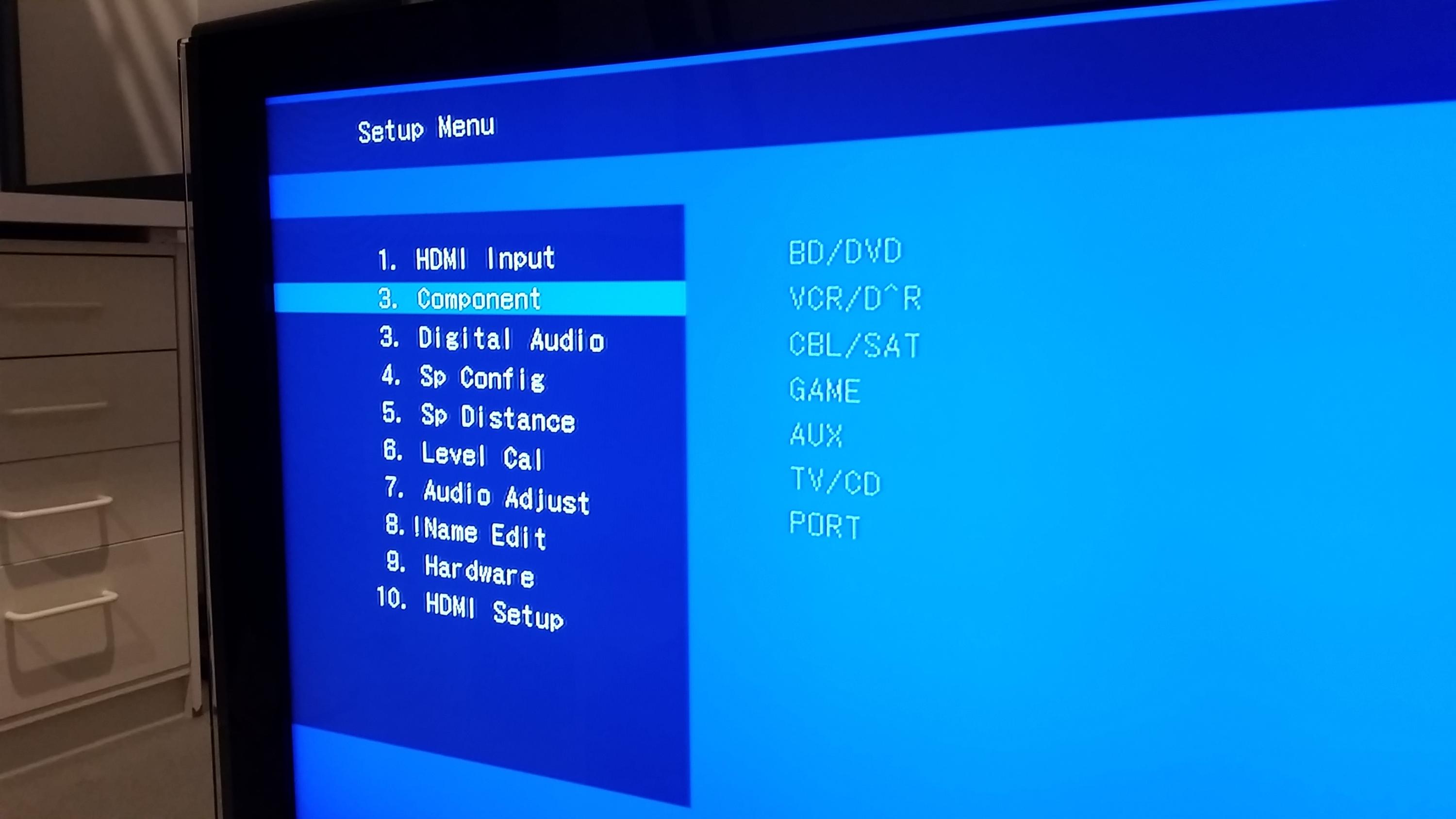

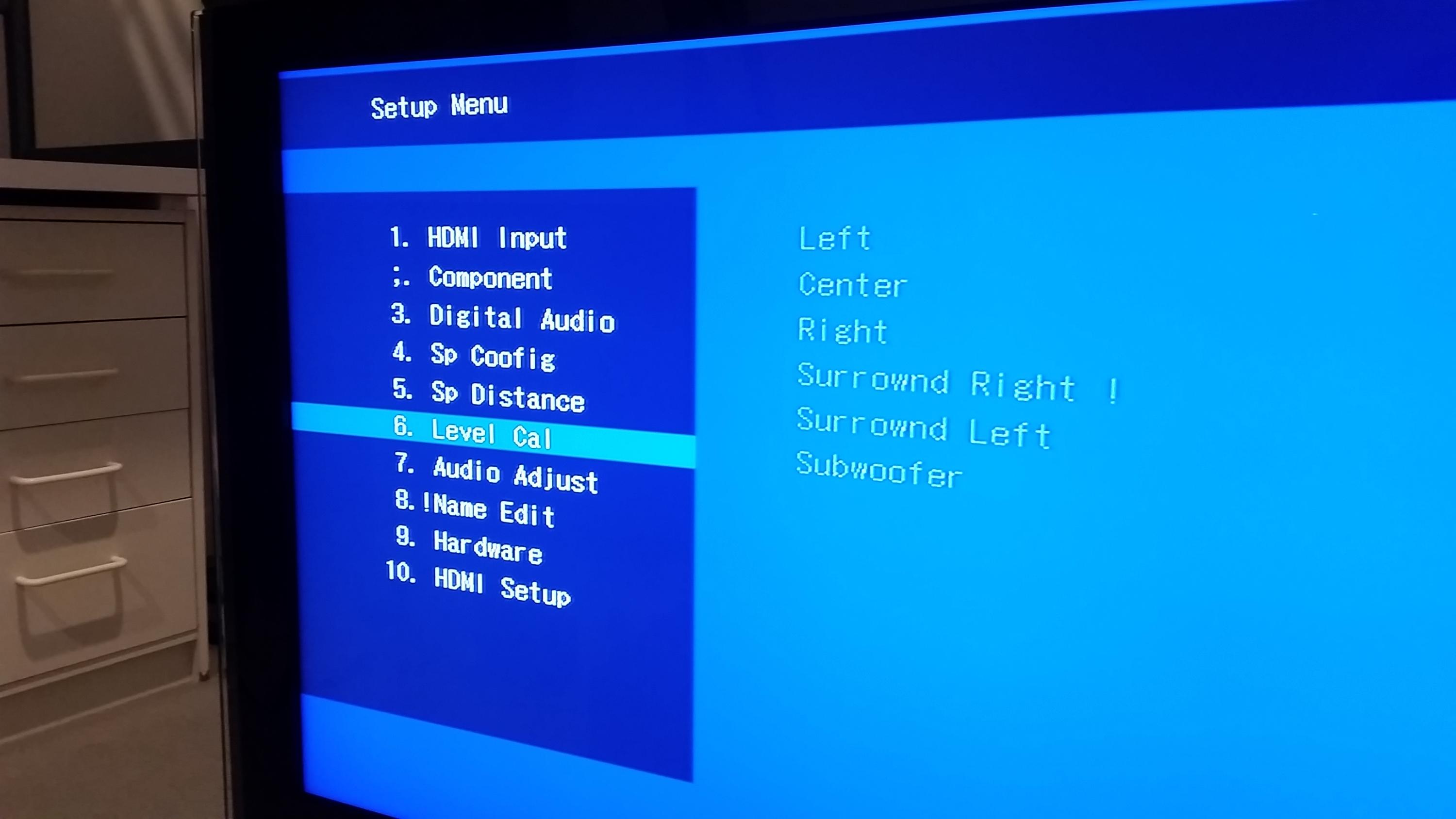

    Hi there,
    I picked up this onkyo receiver hoping I could fix it. I have done alot of TV repairs before and just started repairing AVRs where this is my third one.

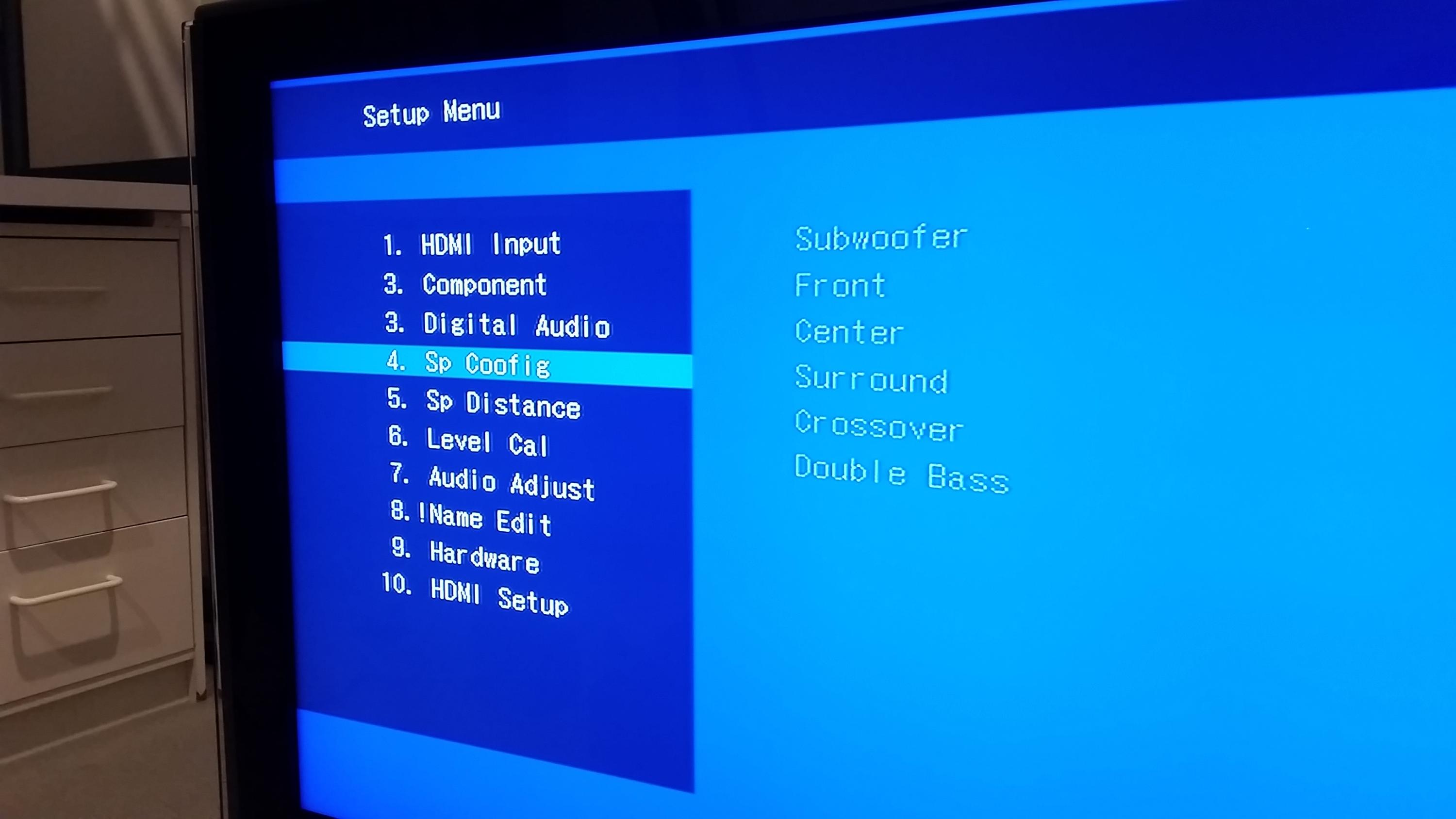

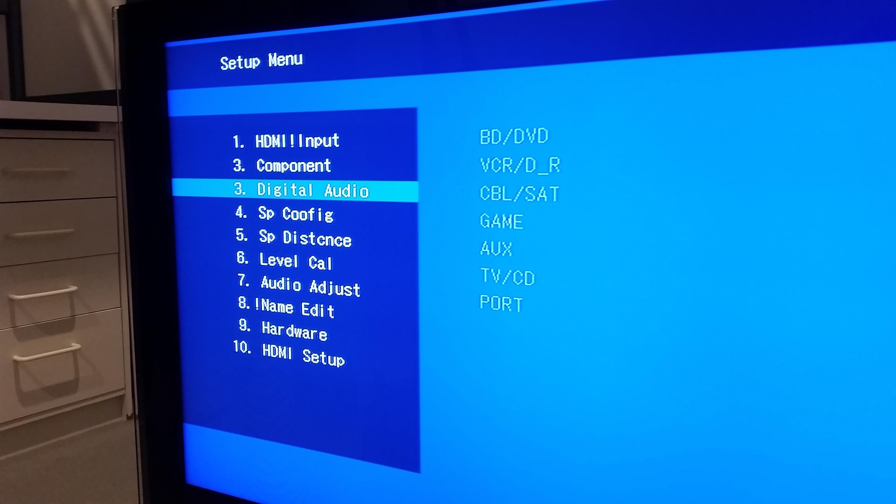

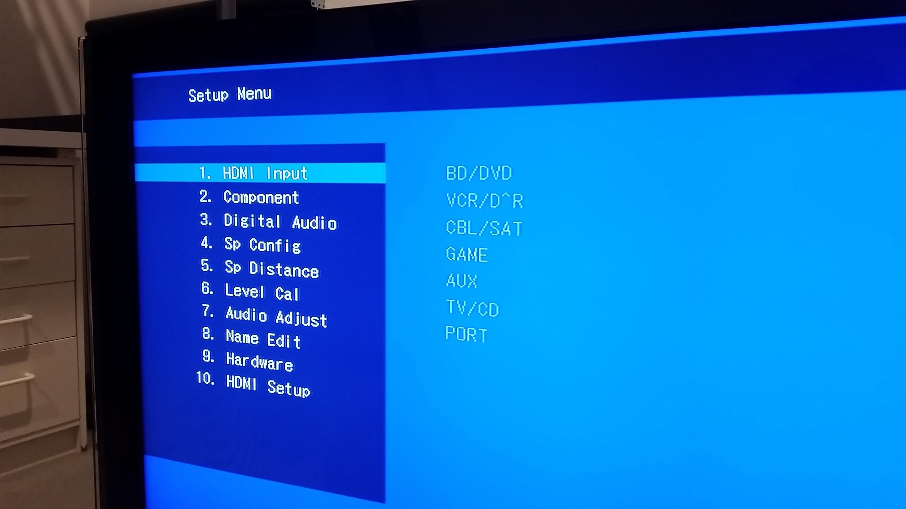

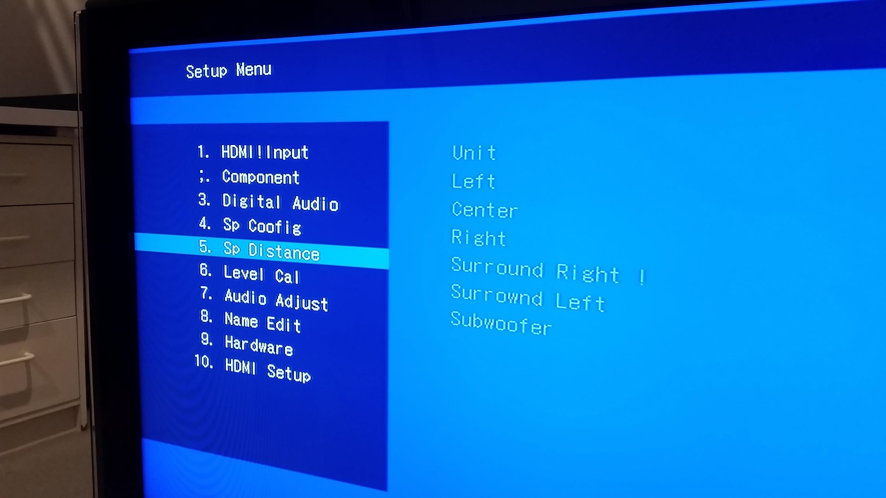

    The problem is there's picture but no sound from the main channels or even hdmi out. There is also OSD issues where the text changes and become scrambled as I move the cursor down (see images).
    First, I think I should reset/update the OSD firmware before anything else. How is such possible without even a USB port or internet connection? Is it possible to just simply reset the eeprom? Or can I order the chip, replace it, and it will write itself?
    FYI: I have already tried factory reset by holding down VCR/DVR and then ON/STANDBY.

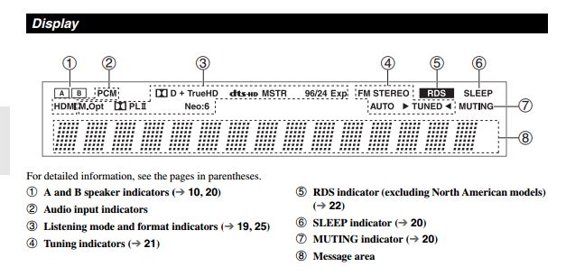

                  Do you have the speaker icons on the display at all ?
                  Will change the caps immediately and report to you.
                  The Onkyo model here doesnt use BGA soldering on the dts chip like others. I have fixed one previously by reflowing, but this isnt the case here.
                  This model doesnt have room for speaker icons on the display. Only listening modes on the text display and I have cycled thru all of them. See image below.

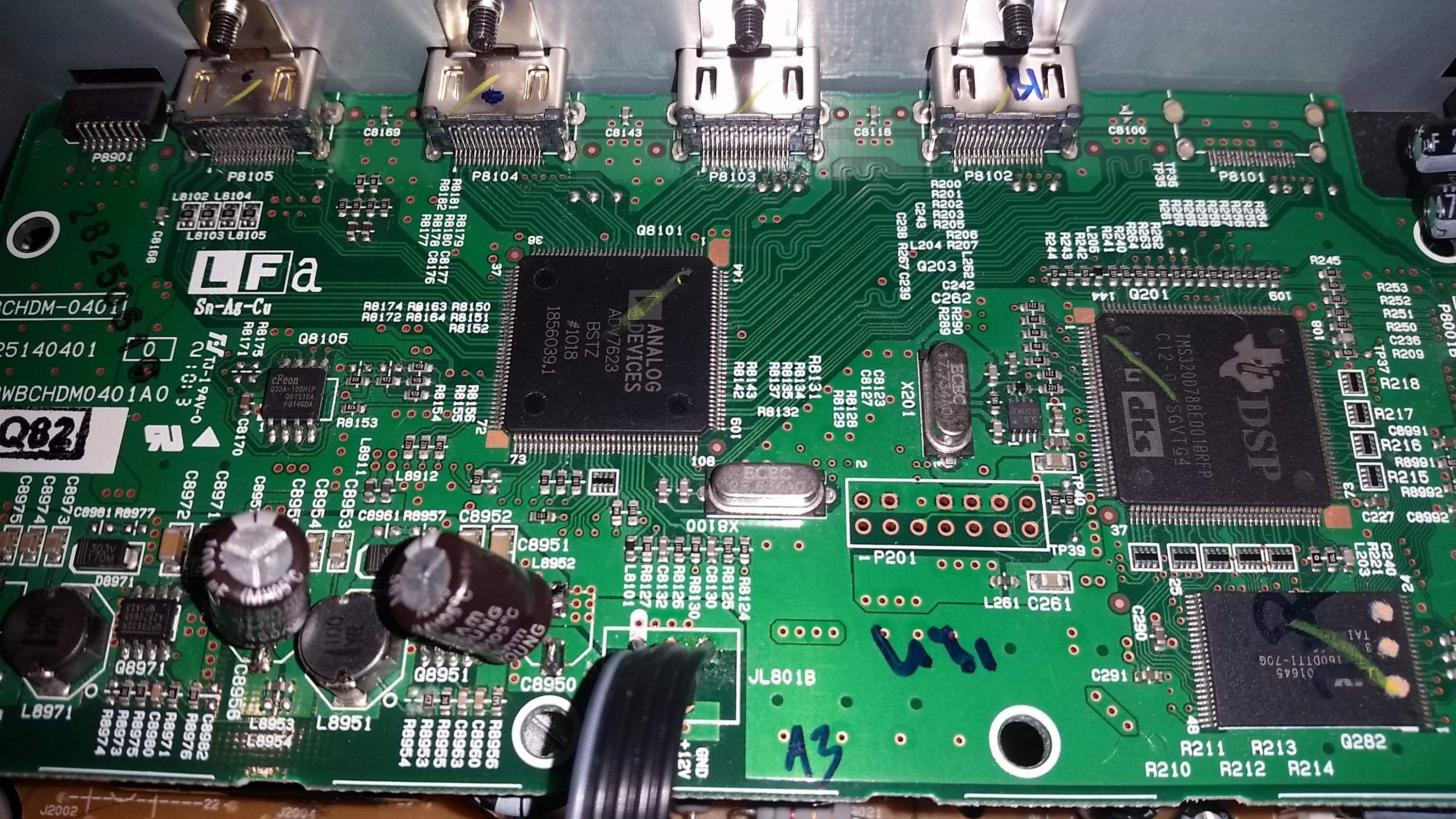

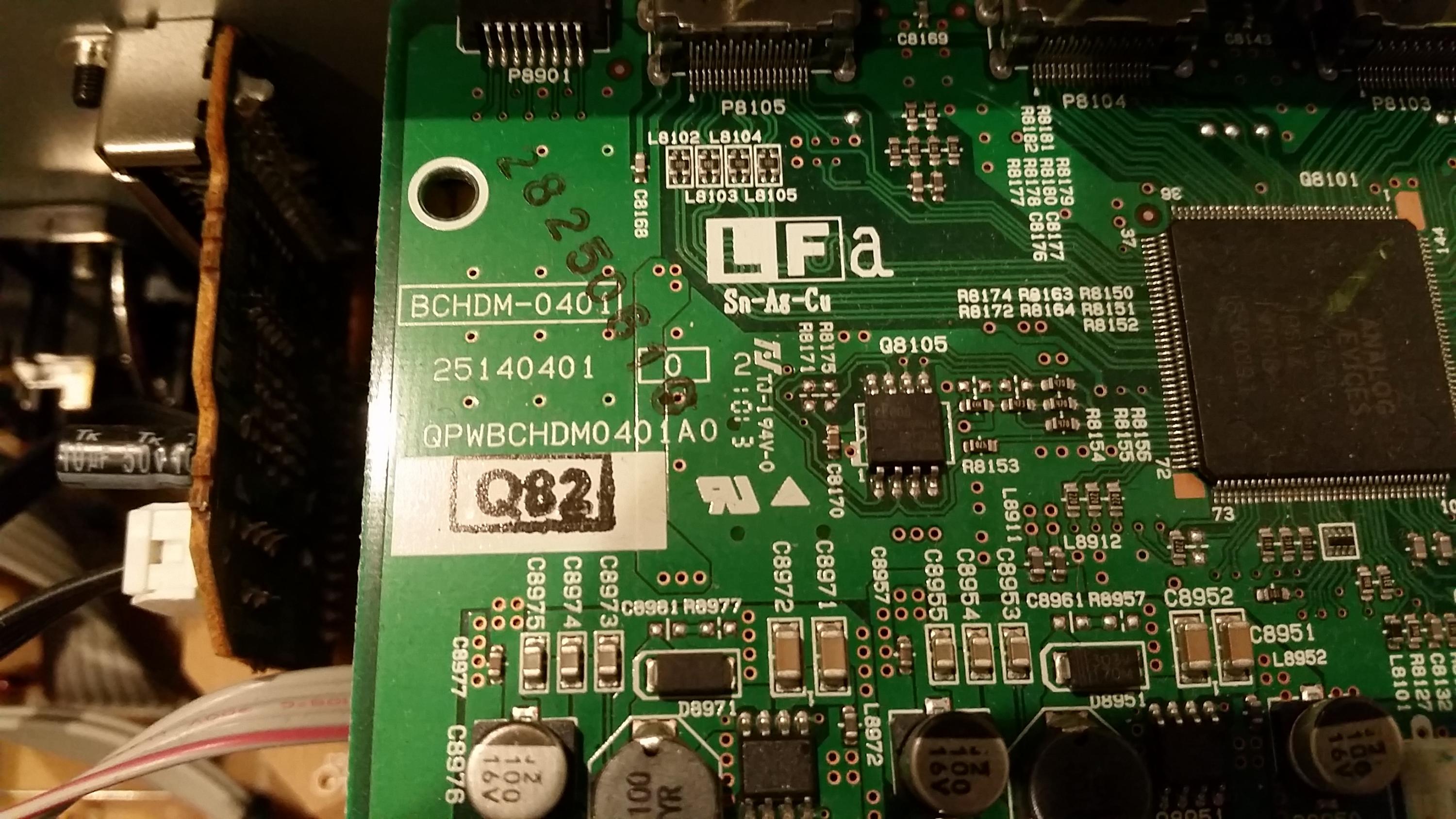

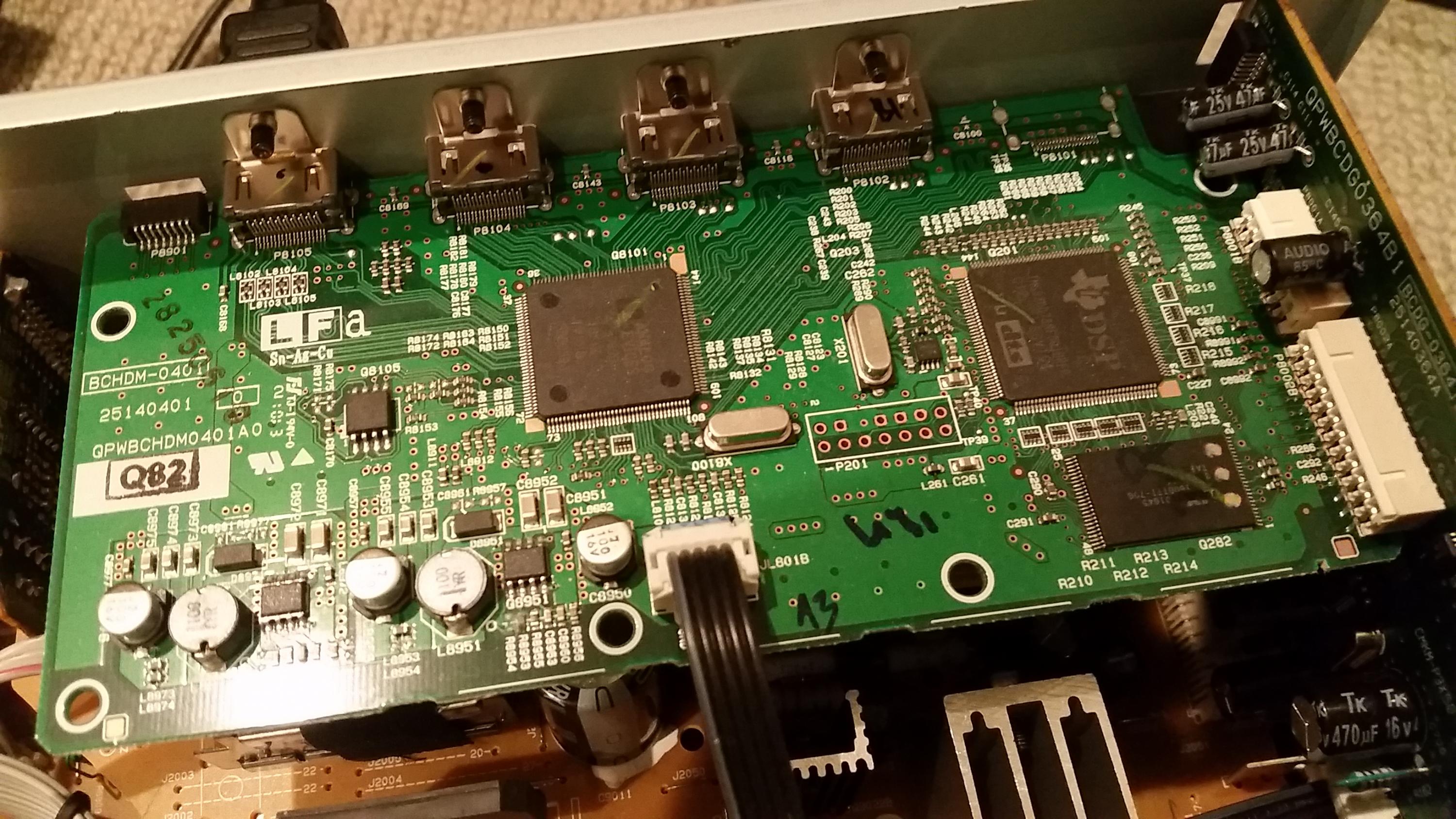

                              Abnormal voltages for 3.3V. Only getting 0.8V for this. The test point im reading from is pin 5 on P201 shown below. Does this mean the HDMI board is faulty? Or perhaps a regulator needs to be changed?
                                Re: Onkyo TX-SR308 Only picture No sound
                                This came as a surprise.

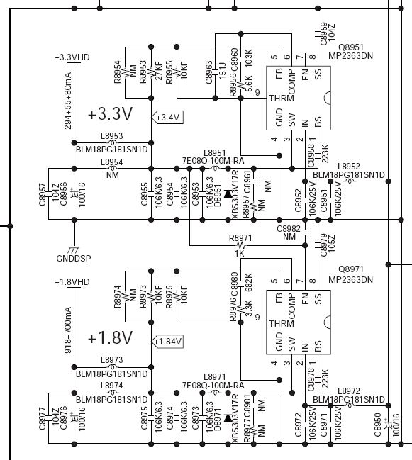

                                I traced the 3.3V supply back to its regulator using the schematics.
                                Next to the regulator Q8951, I found what looks like a burnt out, discoloured SMD resistor R8953 (shown in the attachment). Very hard to see without observing closely but it's there.
                                Now need to try and find a 27k ohm resistor somewhere.
                                  page 22 - there is the 3.3V power supply ( MP2363DN - q8951 ). Looks like all lower V are powered by the +12V on JL801b.
                                  Indeed all of that components are visible on the posted image.
                                  edit - just read your last post, so you found it .
                                  By the way - this HDMI PCB has been repaired previously. C895x caps are originally surface mounted. The JL801B is originally a "push-to-unlock" connector.
                                  I would suggest you to thoroughly inspect the whole pcb.
                                  edit 2 - here is a photo from my ONKYO to see a virgin hdmi pcb ( note the connector/socket and the caps ).
                                  Before repairing anything, be sure that the wires on JL801b are properly soldered. You should also consider installing there some kind of a connector.
