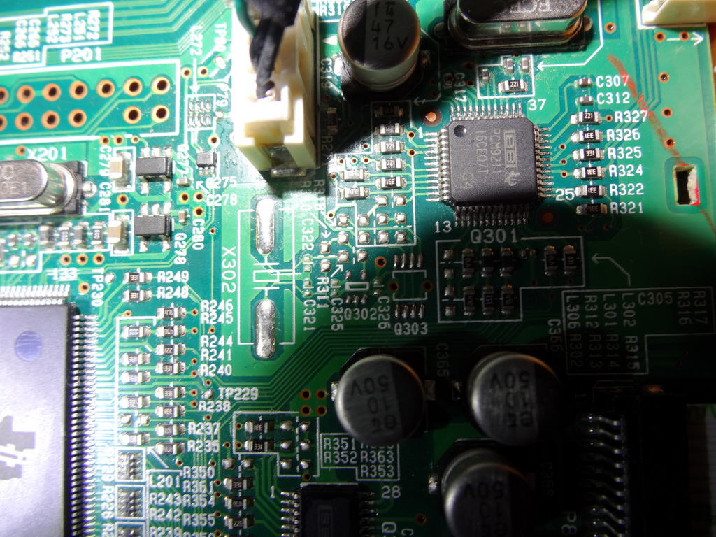

                        q302 you say.. hmm nope.. I do not see it on the pcb (see pics)

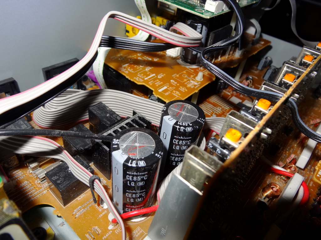

                                      I found some time to break apart the unit and replace the C4050 and C4051 caps ( manual page 6 ). Unfortunately without any positive effect.. so I installed back the original audio grade caps.
                                      I also found the hard way that the unit will not work unless all pcbs have the common ground from the back plate, which makes the troubleshooting a nightmare!

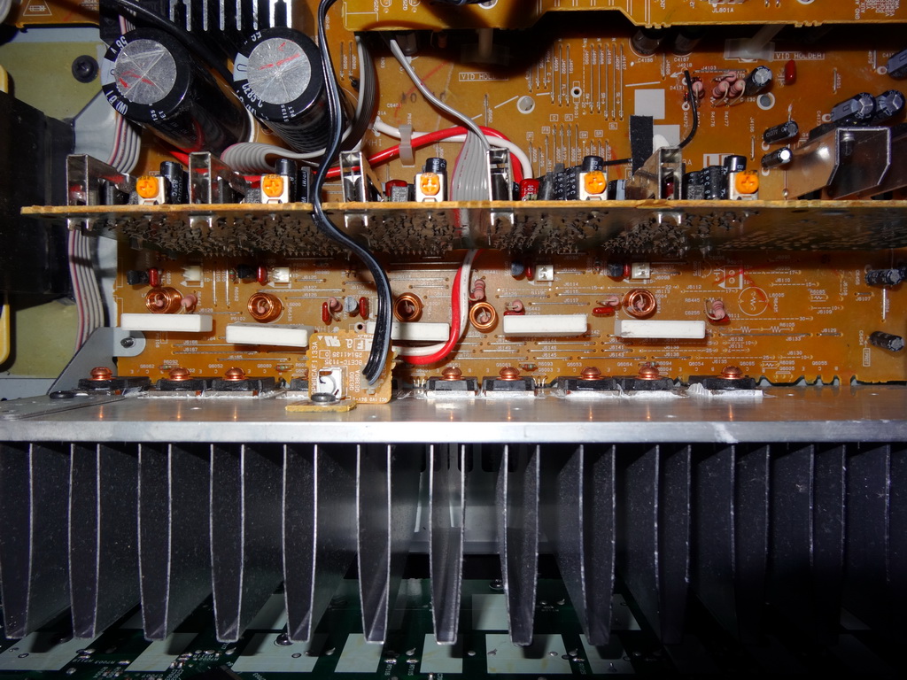

                                      While I had the business side of the main pcb in hand, I reflowed the output chip and the associated passive components ( + some pre-amps and power regulators ). Still no positive result.

                                        Yea I think at this point you may need the Oscope. The interference is low frequency so you might be able to trace it back with a rather slow scope , however if it is a timing problem the trigger to it could be happening quickly.

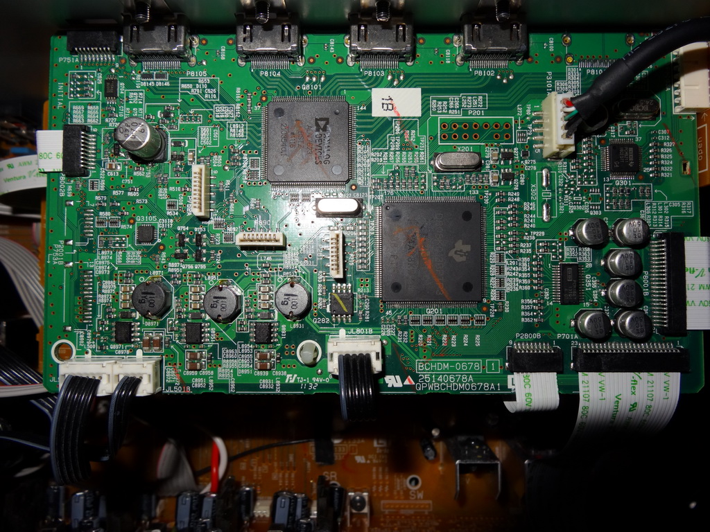

                                          Onkyo HT-R390 no sound output, video output ok
                                          by FrancescoV
                                          Good morning everyone,
                                          I'm trying to repair an onkyo ht-r390 that has no sound output, despite the volume being at maximum, the rest seems to work; the video output signal (coming from an hdmi input) is present, but the audio is absent. Similar situation if I send an audio signal from any input I have no output.
                                          The firmware reported is the following:
                                          M:1.00/11107BLP
                                          D:?.??/????????
                                          O:1.00/11107AL
                                          The DSP firmware given the question marks seems corrupt.
                                          On the BCHDM-0678 - 25140678 - QPWBCHDM0678A0 board the chip that usually seems...
