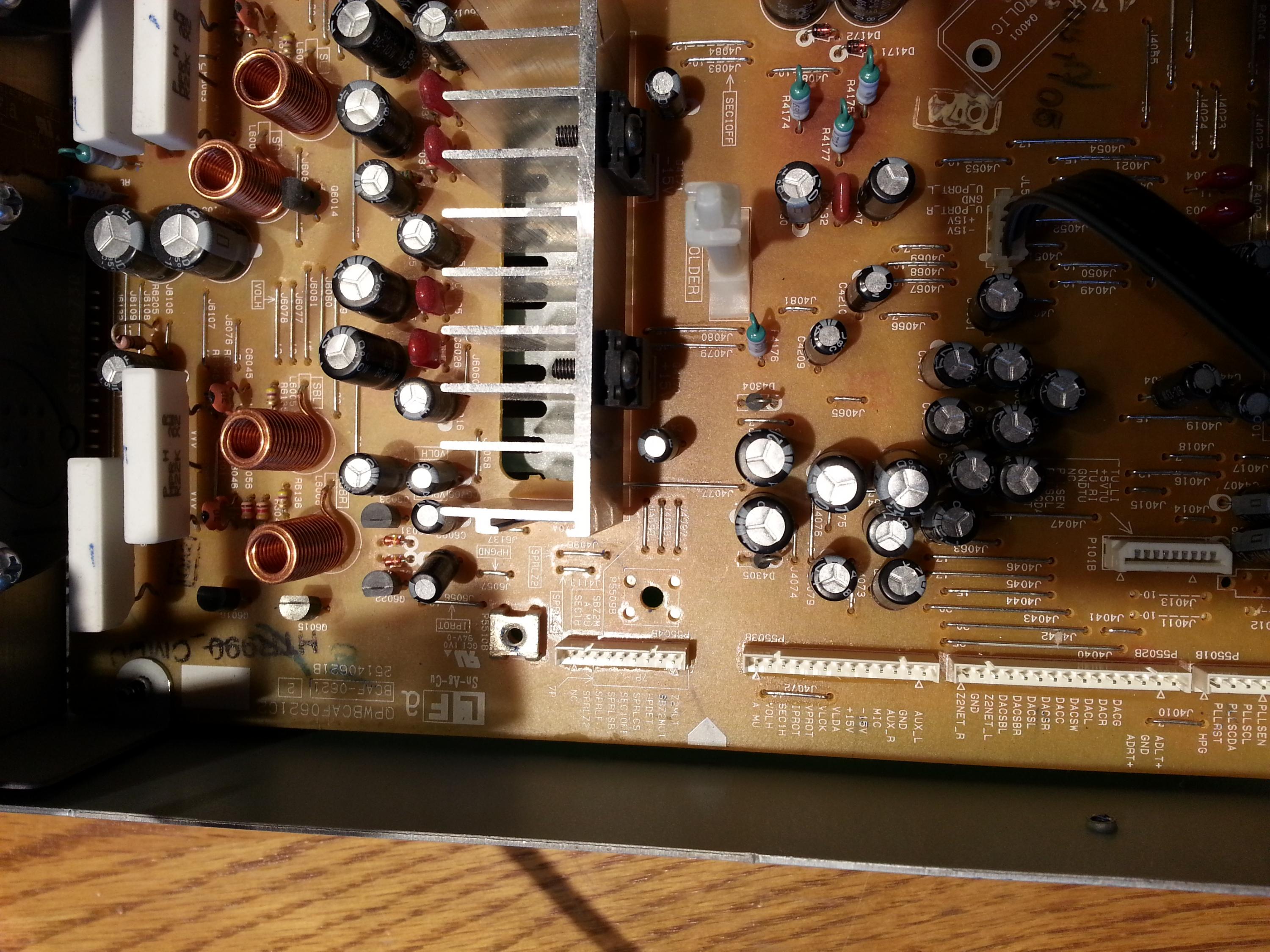

    has anyone worked on this receiver, is there a way to check the amps on this machine it has only three power amps. pics on the way and schematics.

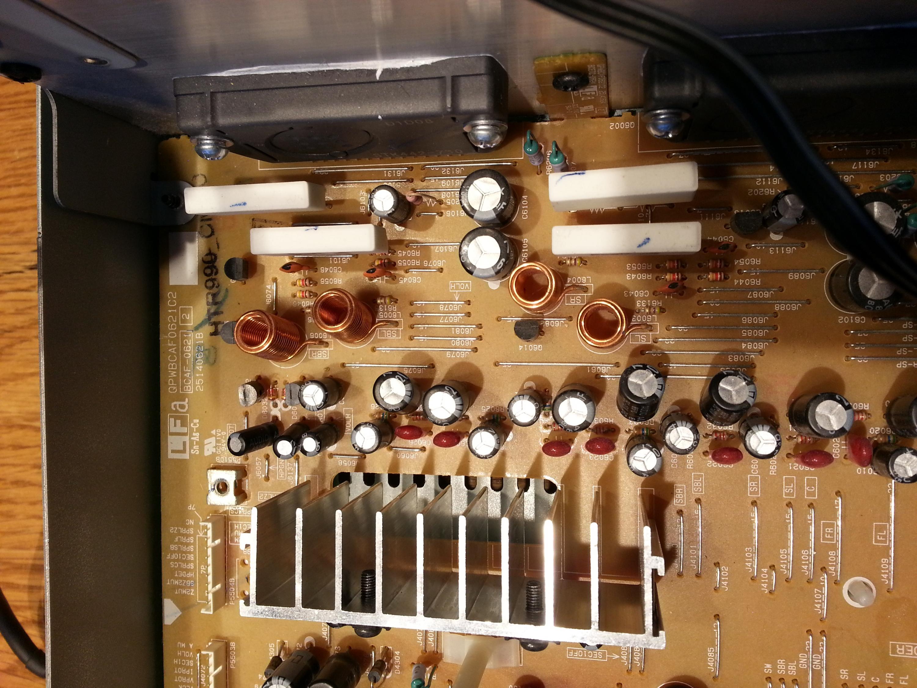

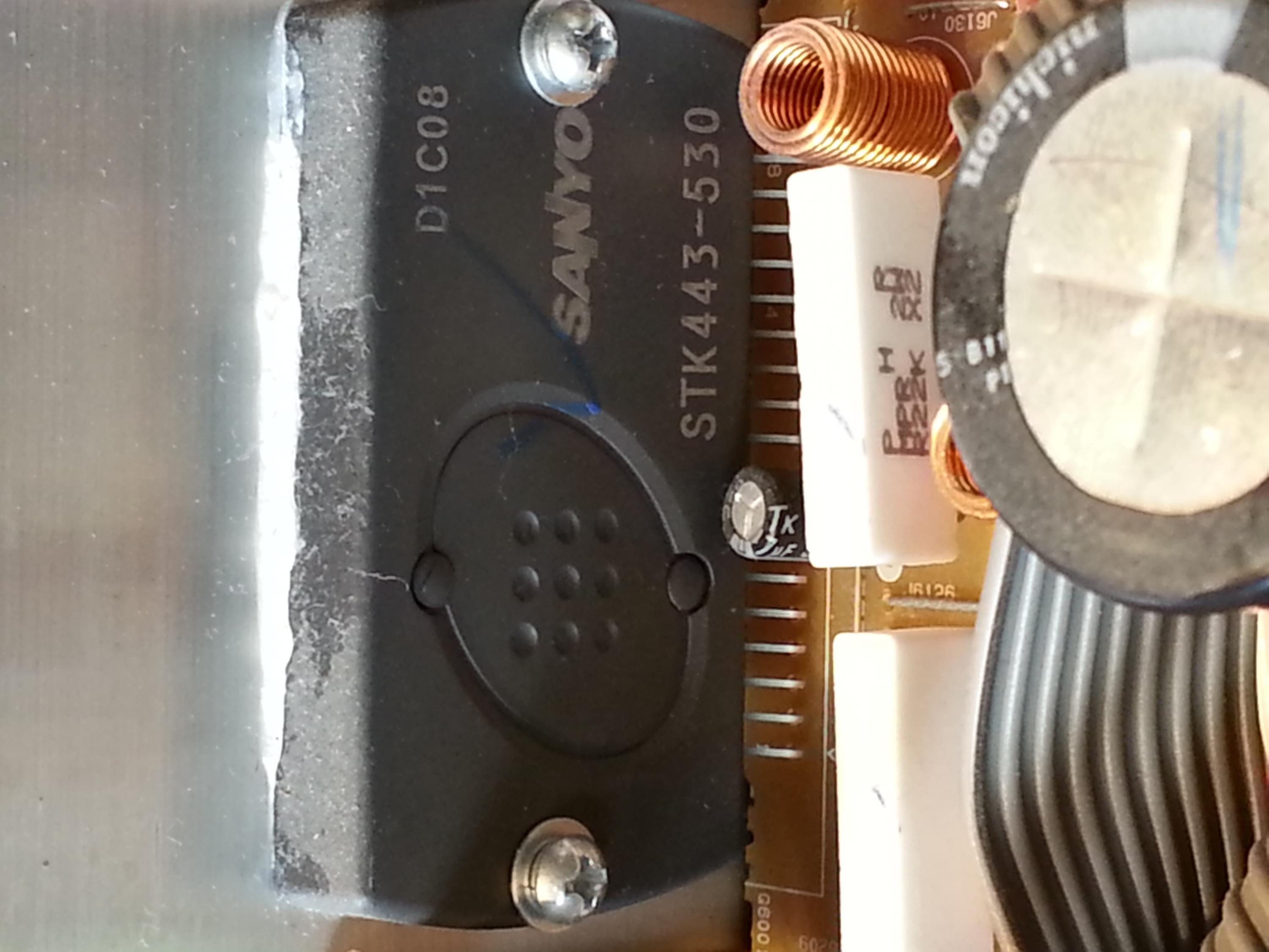

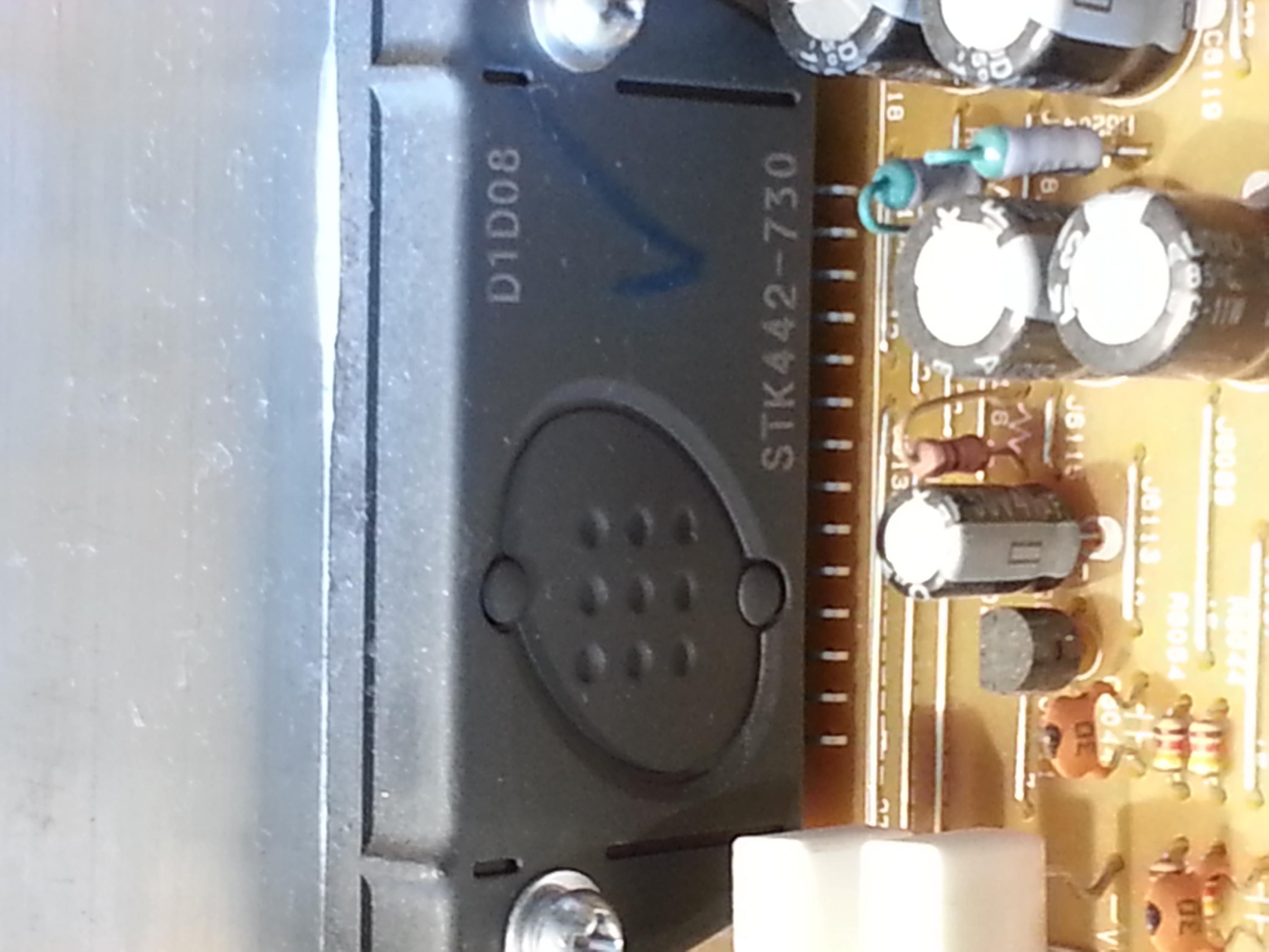

    Page 7 quite clearly shows the "main features" inside those amplifier chips, that you need to know.
    First step would be to check if any of the (internal) output transistors are shorted: +Vcc to ChX+RE and ChX+RE to -Vcc.

      yes I saw the chip layout but I don't know anything about audio amp chips, the industrial side of electronics doesn't cover that.

        ok no shorts on any of those pins on any of the three chips. does the hdmi board control the sound of all the receiver? should the radio still play if the hdmi is bad?

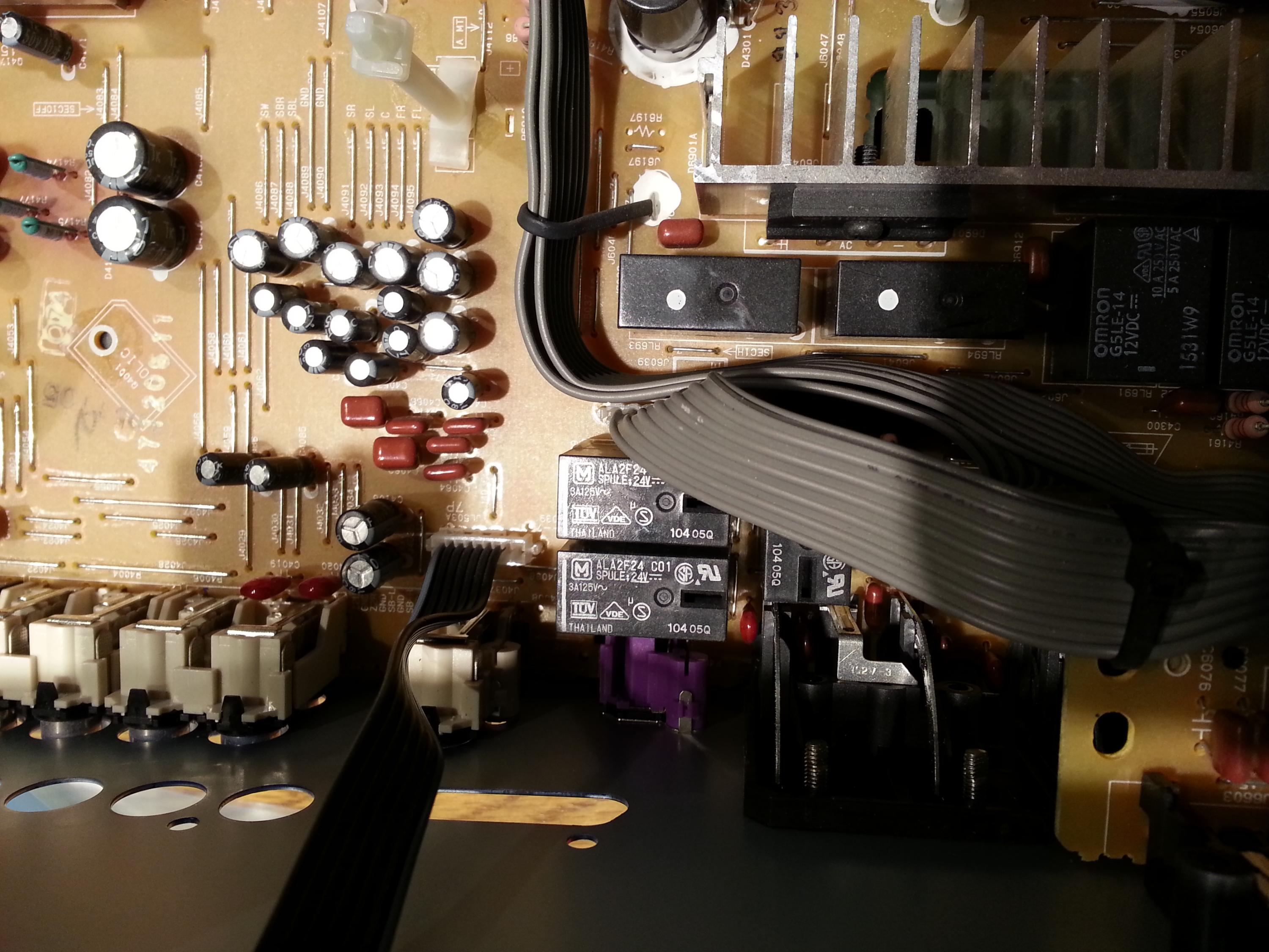

            yes the receiver powers on display works, only the first set of relays click on. the second set of relays do not power on ,it goes into protect mode. no I don't have a signal generator, all I have is a good fluke meter the will check diodes and caps, ac,dc volts and mv

                  no it does not say protect on the display, I only have one click powering the main circuit. the board only has q6022 and q6023 on it the other two transistors q6021 and q6024 are not there. also diodes d 6020 through d6026 are not on the board. also on c 6092 there is an arrow pointing to the + side of the cap saying v prot a.nd on c6706 saying v olh
                  with the exception of q6010 through q6016 those are the only transistors on the board.

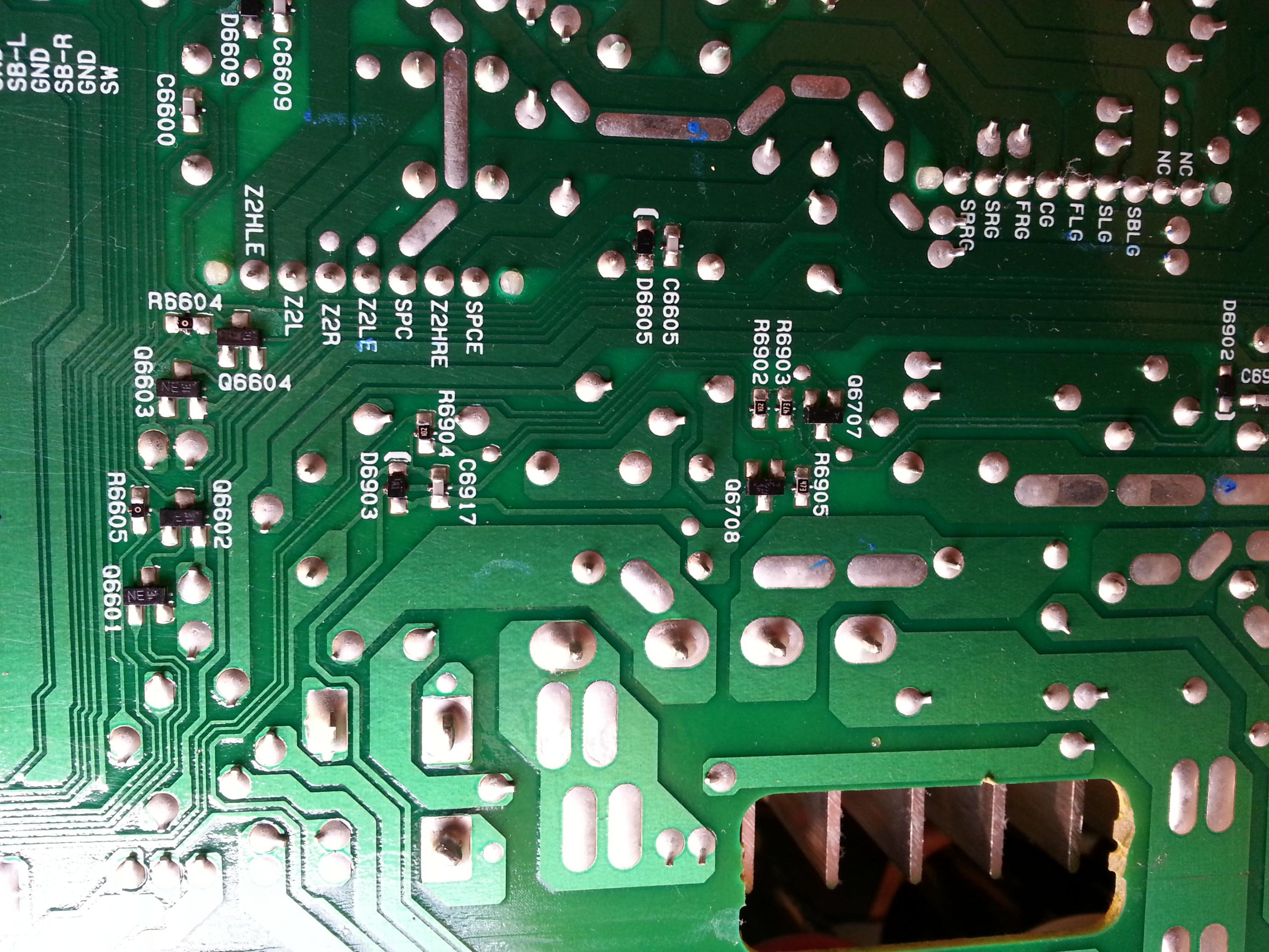

                      Are you positive all those components are "not on the board"? Or are they just not where you might've expected them to be? Just because they're right next to each other on the schematic, doesn't mean it's the same story on the board itself.
                      The +/-15v seem to be coming of of two REGULATORS. Yes, discrete transistors can also be packaged in TO220 cases, but the 78xx / 79xx series are voltage regulators (look up the datasheets).
                      Have you tried resoldering those legs? Or can you at least provide a photo of that area?

                        im going to resolder them this morning, yes I know the 78/79 are voltage regulators. I will send pics of the entire board.

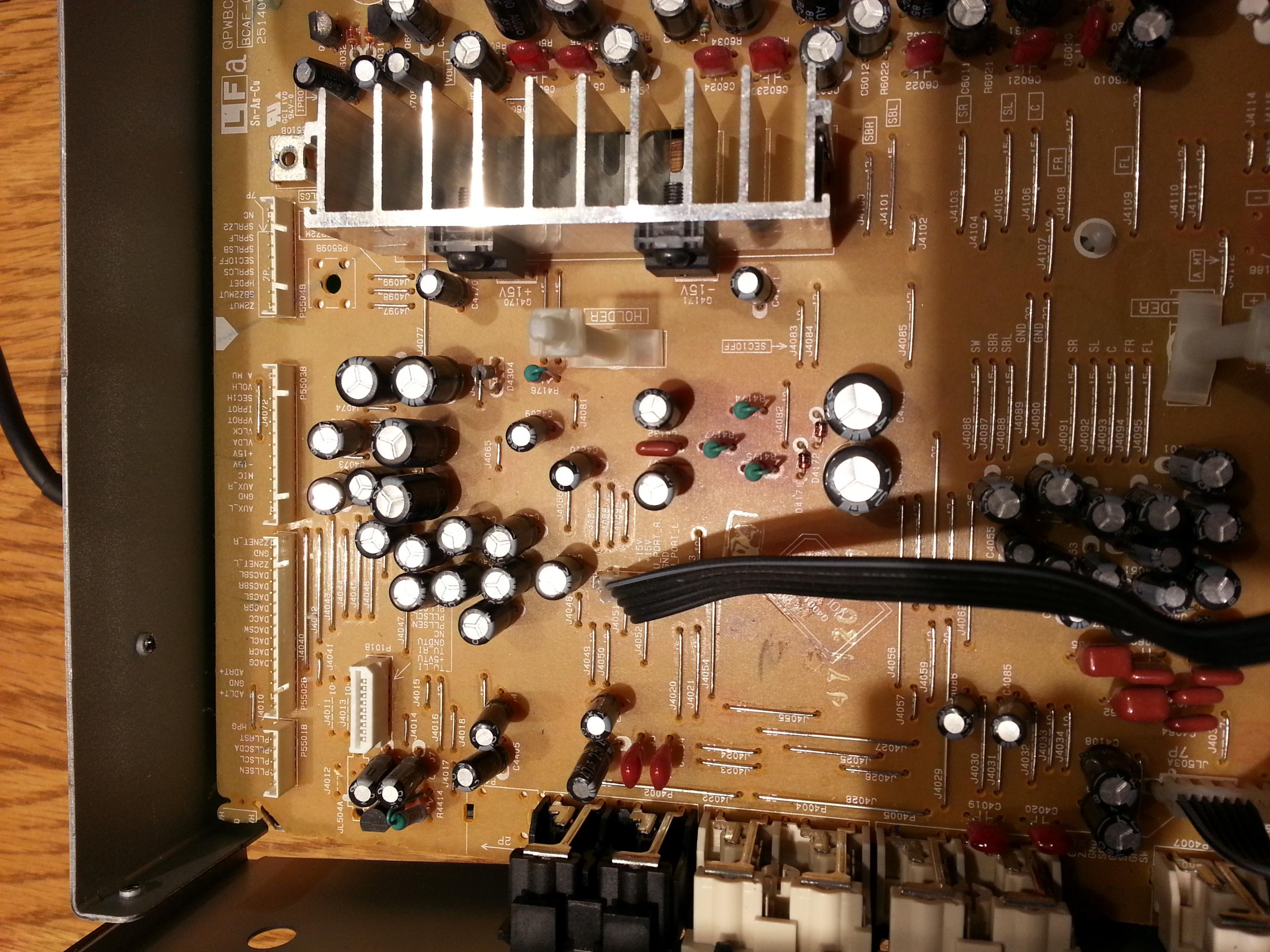

                          ok found all the transistors and diodes they are on the bottom of the board. they are very small.

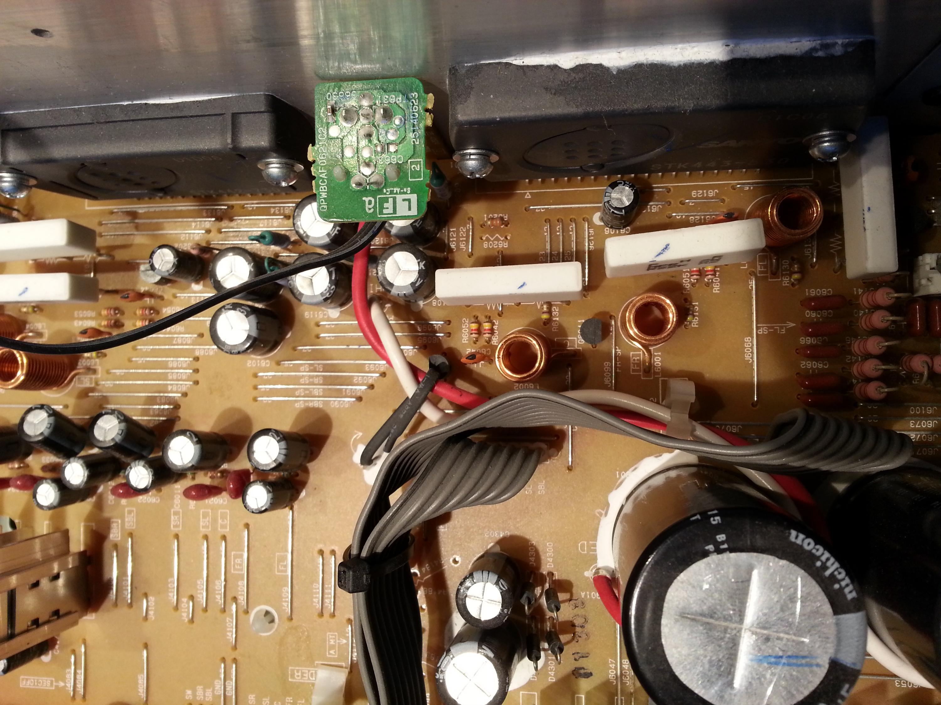

                              ok on page 6 we have the 15 volt regulators. with two caps and two diodes on the out going side. taking a reading at the regulators I have 15 volt + and - .if I take a reading after the diodes I have 29 volts. then following that on to the 7 volt I have 13 volts ,past the two resistors on each leg.

                                You have +/-29v(?) after which exact diodes? Or are you measuring between the two outputs of the regulators?
                                If you've got the black probe on the negative rail and the red one on the positive rail, then it sounds ok (ie. within acceptable tolerances; 15v above ground and 15v below ground add up to 30v between them; 29's close enough - same logic for then +/-7v rails).
