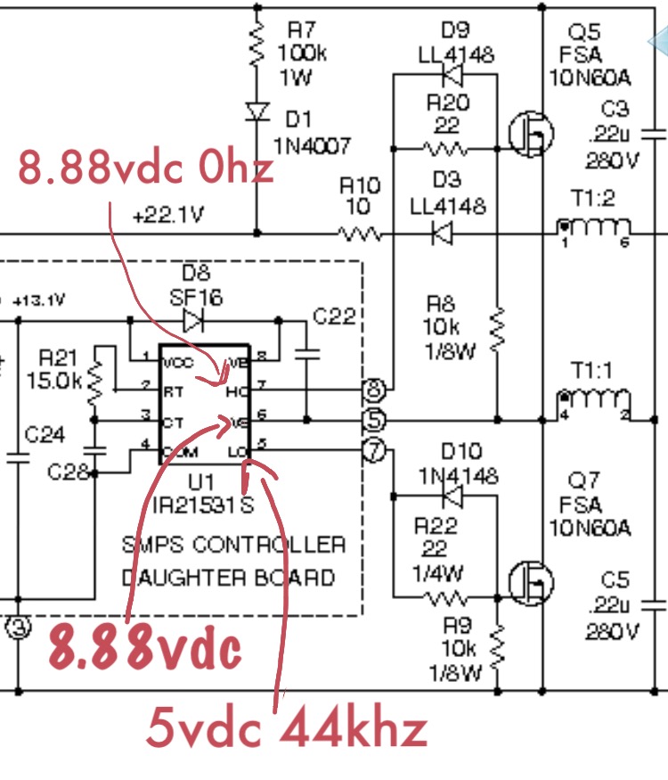

    I have this Klipsch Pro Media computer speakers that I originally found a blown mains fuse and two shorted switching mosfets.
    Has all kinds of glue on the board covering the daughter board and secondary side so can't really test much but I did find a schematic for it. Any help would be appreciated

              Ok so removed most of the glue and before simply soldering in a new fuse and two blown mosfets, I tacked on wires to the driver ic's Vcc and Com with 11v from adjustable supply.
              I'm only seeing frequency on one of the MOSFET gates (LO as shown in the schematic) nothing on the other gate (HO). Im not sure if that's normal or if both should be receiving a freq at same time.
              Does this conclude the ic is good or?

                Re: Klipsch Pro Media 2.1 Speakers - Keep blowing mosfets
                Do the blown MOSFETs have resistance between Drain and Gate which will take out the drive output of IC U1.
                • caphair
                  • Nov 2011
                  • 1249
                  The blown mosfets measure 0 ohms in any gate, source, drain configuration
                    Then the IC is damaged, you need to check those resistor/diode network on the Gate pin to make sure they are not damaged either.
                    BTW, the AUX winding on this one is T1:2 PIN 1 and PIN 6. for generating running DC (D3, protection resistor R10, filter cap C13), same concept as other SMPS power supply.

                          0 ohms in any direction. Does that usually means blown ic when you get that reading?

                              The IC was more likely has the Gate drive output damaged when you have shorts between Drain and Gate due to high Voltage from power supply dumped in to the Gate drive pin of the IC, that is why must check the resistor and diode on the Gate pin also as shown in the diagram

                                      Friend said because there's voltages on the gates after powering ic externally that means the ic is bad? Wouldn't voltage be there in normal operation to turn mosfets on?

                                        When the power MOSFETs are removed, then there will no longer be any heavy load to cause the TH1 to blow like that, shorted bridge will be the one or shorted Caps.
                                        The Gate drive outputs will be switching ON and OFF at high frequency not steady DC.
