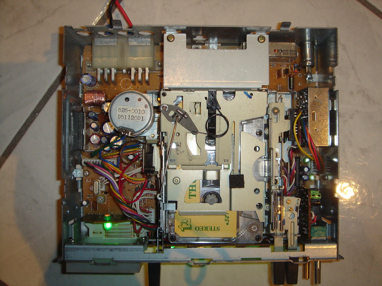

                          I got the radio to turn on a few days ago. I can inserte a cassette tape and see the motors spin in action, but I have a big problem, and that is I can't see anything on the LCD display on the front.
                          There is backlight to the LCD and buttons, but no text on the LCD display. IMO, I think it might be a broken solder joint since the LCD metal pins are soldered directly to the PCB. What else could be wrong?

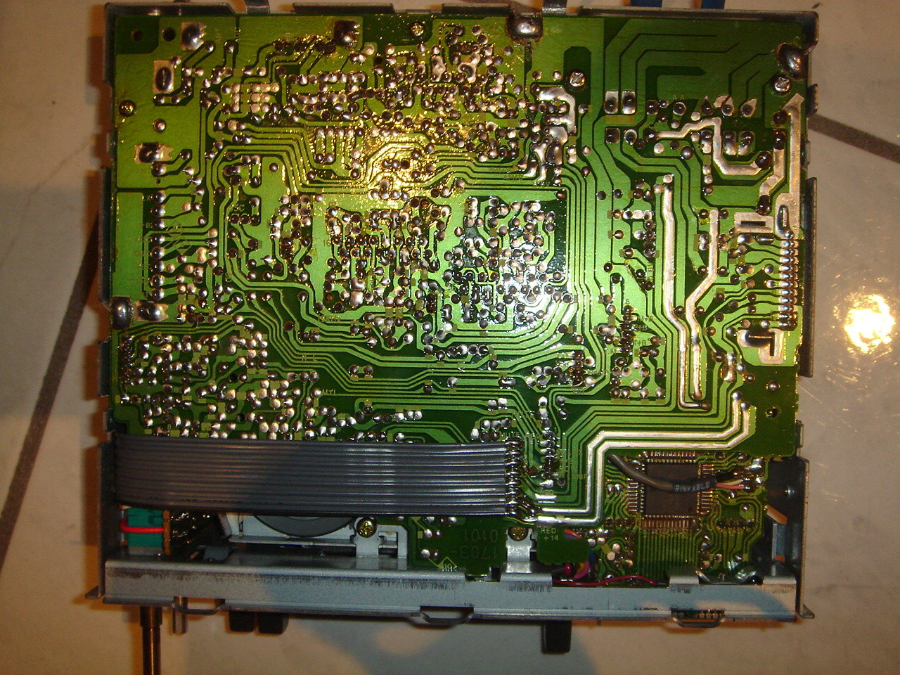

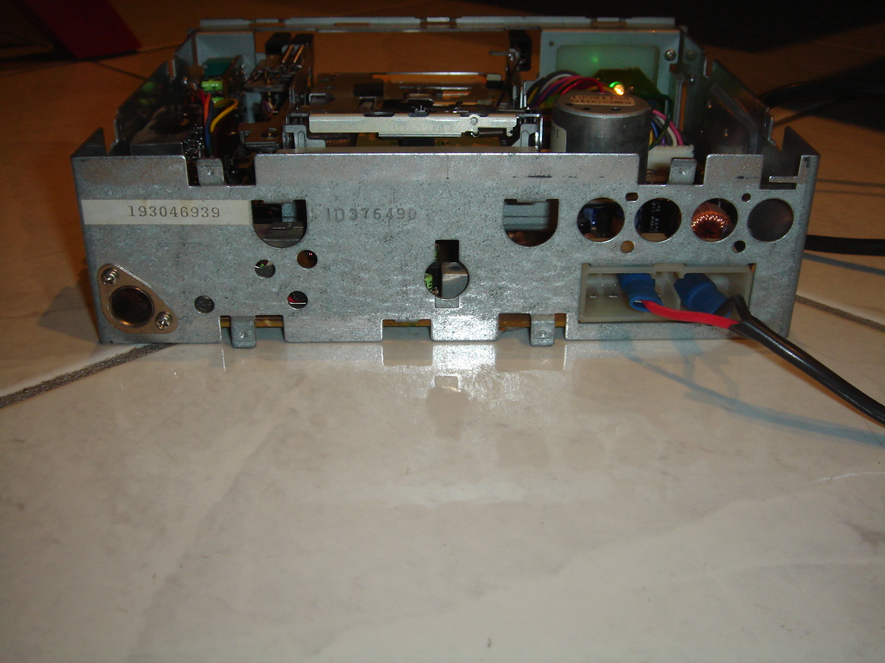

                            I have some images of the radio cassette unit I am talking about. I removed the fron bezel/ cover so in the images you can see that the unit is on but there is no LCD display although the back light is on.
                            The PSU being used to test this radio cassette unit is a Delta Electronics 250W P4 ATX PSU, so I don't think power is a problem.
                            Can anyone please help me find out why the LCD isn't displaying anything??.

                              Re: What do I need??

                                Originally posted by Spyke
                                "Always On" positive terminal connected?
                                Is the "always on" terminal the permanent terminal? I haven't connected any wires to the permanent. I thought the permanent wire was to allow the radio to remember the presets??.
                                If I need to connect the "always on" cable... what voltage whould it be? 12V?
                                I still remember that a long time ago, another car radio had the permanent wire disconnected and everytime the car was started up again, the radio would lose the time and presets, but the LCD still worked though.
                                Thanks.
                                Don't find love, let love find you. That's why its called falling in love, because you don't force yourself to fall, you just fall. - Anonymous
                                • Spyke
                                  • Aug 2006
                                  • 13
                                  Yeah, its 12V, same thing as the "On" voltage.
                                  A lot of models power the low power electronics section with the "Always On" voltage. This almost always includes the display controller as well.
                                  • hardwareguy
                                    • Jun 2006
                                    • 405
                                    Like others said, some radios need both the B+ and Memory lines connected.
                                    B+ powers the amp, tuner and tape on every radio but some use the Memory line for not just the clock but the MCU/display as well. In these, the clock is likely part of the MCU/dispay controller.
                                    Judging by the circuitry, 1.5A should be enough to see if it still works (a small amount of output will be available) and 5A will be needed for full output.
