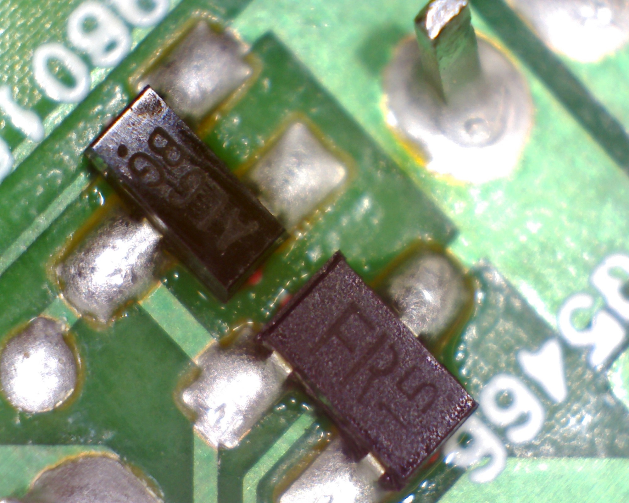

    I have picked up this receiver with this fault showing for like two seconds and shuts off.
    I have found the bad final transistors at channel SBL and bad 0.22Ohm resistor, so I have cut there terminal and the receiver turned on.
    Now I'm looking at bad components and I have found a transistor on the pre-amp section with these markings and I don't know which transistor would this be?
    FR 15.
    I'm attaching some pictures.
    I can't find schematics for this receiver.
    Any help would be appreciated.

    Re: ONkyo TX-NR626 Check SP Wire
    probably 2sa1037
    • tibimakai
      • Jan 2012
      • 3680
      How did you get to that conclusion?
      I would like to find out myself, how to read this little devices.
      It looks like the F is 2SA1037 with hFE 180-390 which is R.
        Is there another one on the board with the same P/N? Check to see if good one it is PNP type.
                    You are pretty certain that the 2SA1037 is that transistor?
                    I would like to place the order this morning.
                    I'm not in front of the receiver, to test it if it's NPN or PNP.
                    I don't know where to place that magnet in that software(magnet has to be in it, or just the rest). I have never used this kind of stuff before.
                      It is just general purpose PNP (60V 0.15A, if it is PNP), then you can use through hole PNP that you may have around to try it out first.
                                        There are two capacitors bulged(10uf and 220uf), 120 and 2.2ohm resistors, show a weir value also.
                                        That transitor is completely shorted. The other one next to it it's fine.
