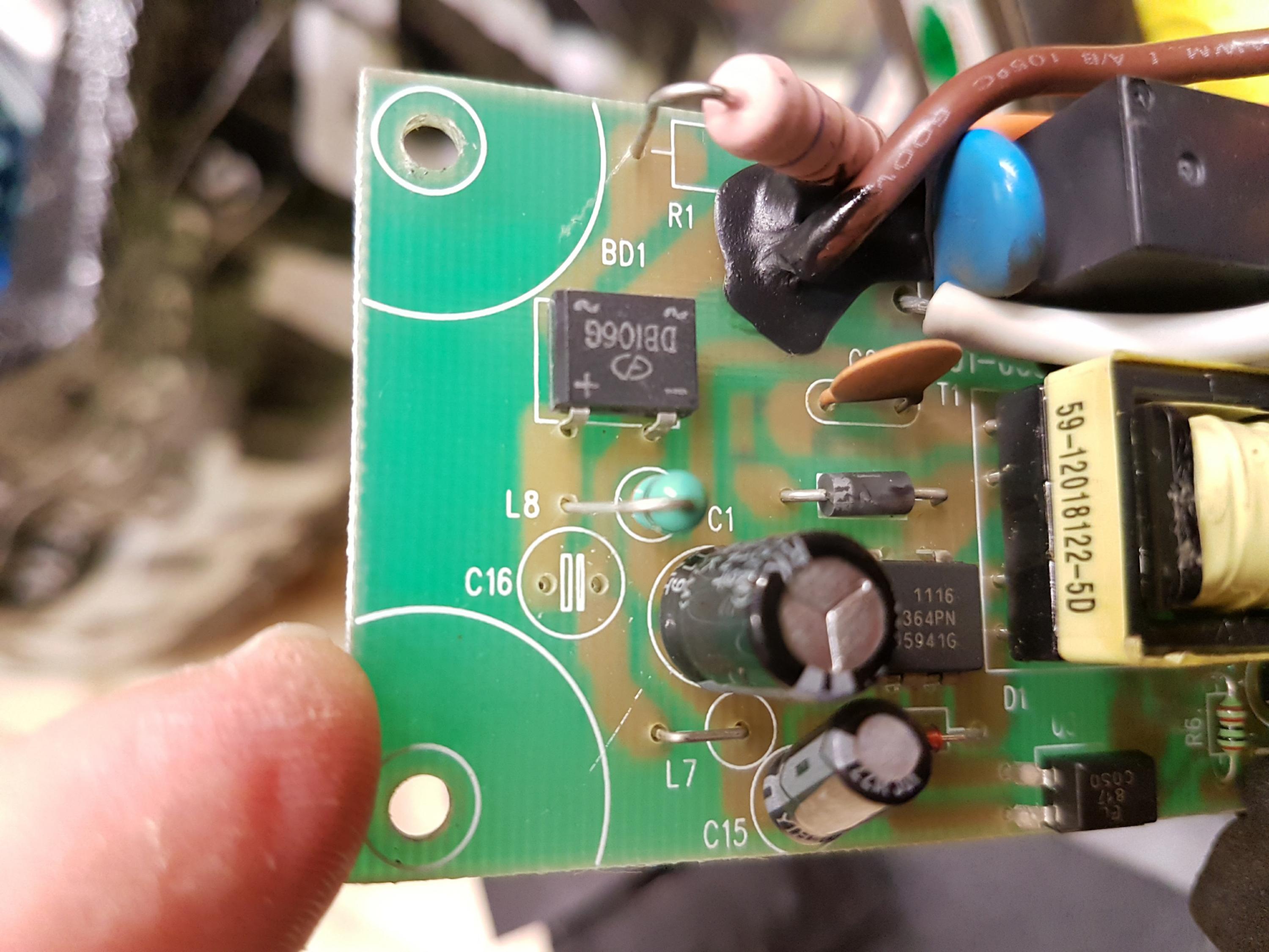

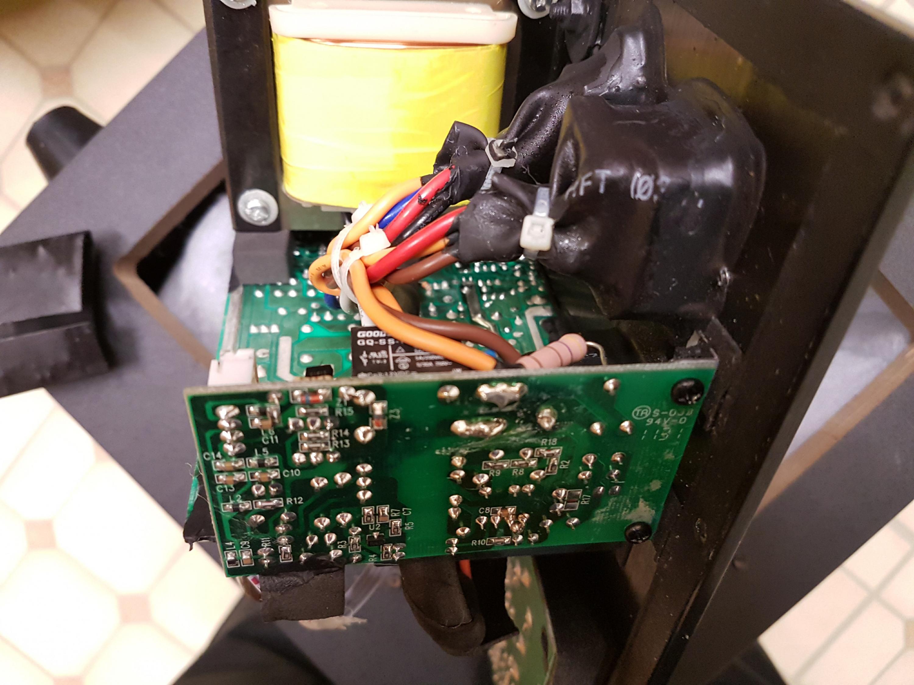

                                    Hi. I have a dead VW-8 which seems to have failed components in the AC power supply.
                                    The circuit diagrams which have been posted don't seem to match mine.
                                    The main AC input seems to go to a control relay which isn't pulling in (no AC getting to the mains transformer). It also goes to a large resistor (R1 4.7ohms I think) which seems to be open circuit. This resistor seems to feed into a bridge rectifier which has a failed inductor on it's output side (casing cracked) and a diode also looks like its overheated.
                                    None of these components seem to show on the schematics here!
                                    Does anyone have any different schematics for this amp?
                                    • Agent24
                                      I see dead caps
                                      • Oct 2007
                                      • 4950
                                      • New Zealand
                                      #58
                                      Re: 35v DC at speaker terminal!
                                      It would be greatly helpful if you can post photos of your unit, the blown components, etc.
                                      The soft-on relay circuit may be simple enough that you won't need a schematic anyway.
                                      -David VanHorn
                                      • Adder
                                        • Jan 2017
                                        • 3
                                        • Great Britain

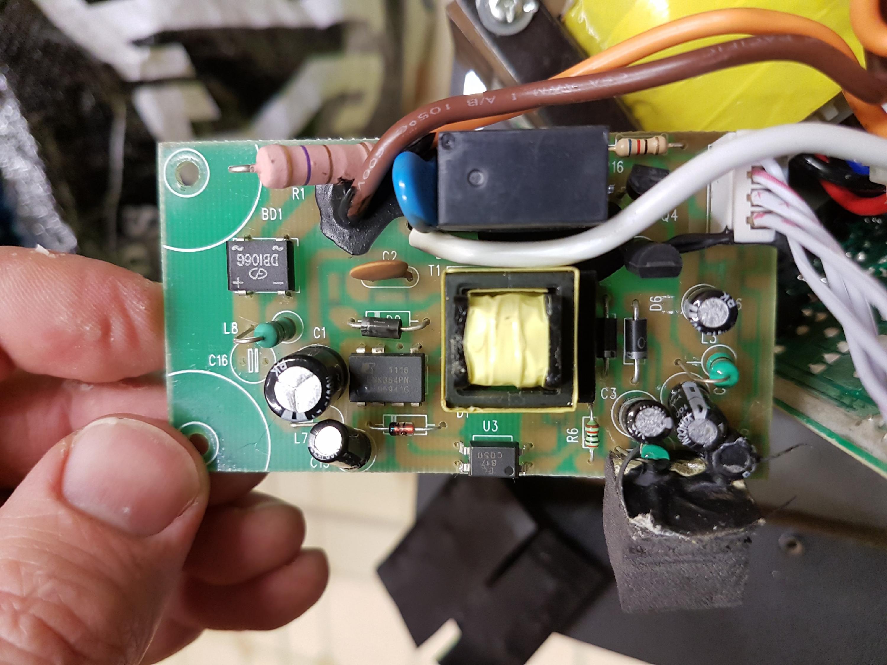

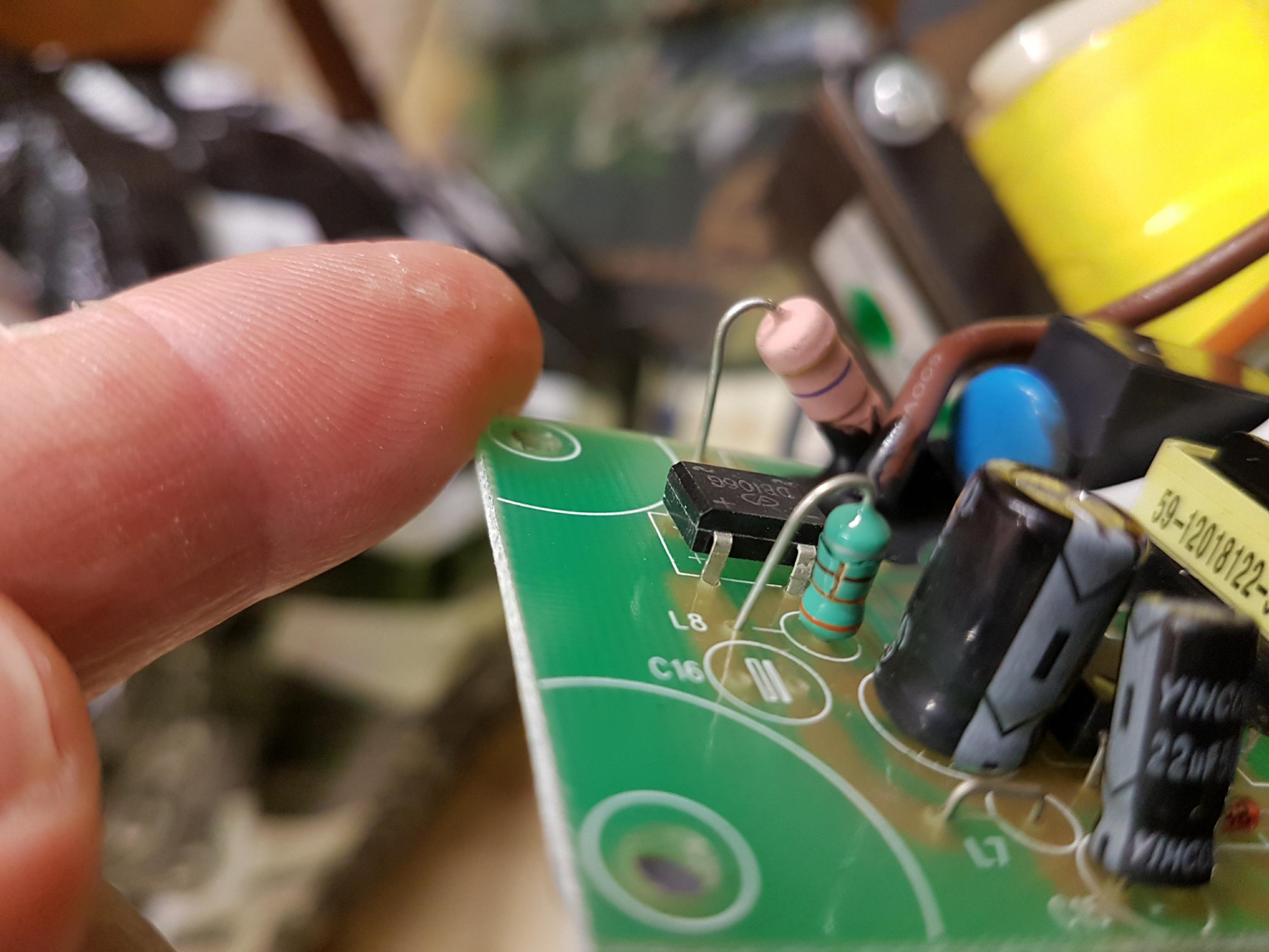

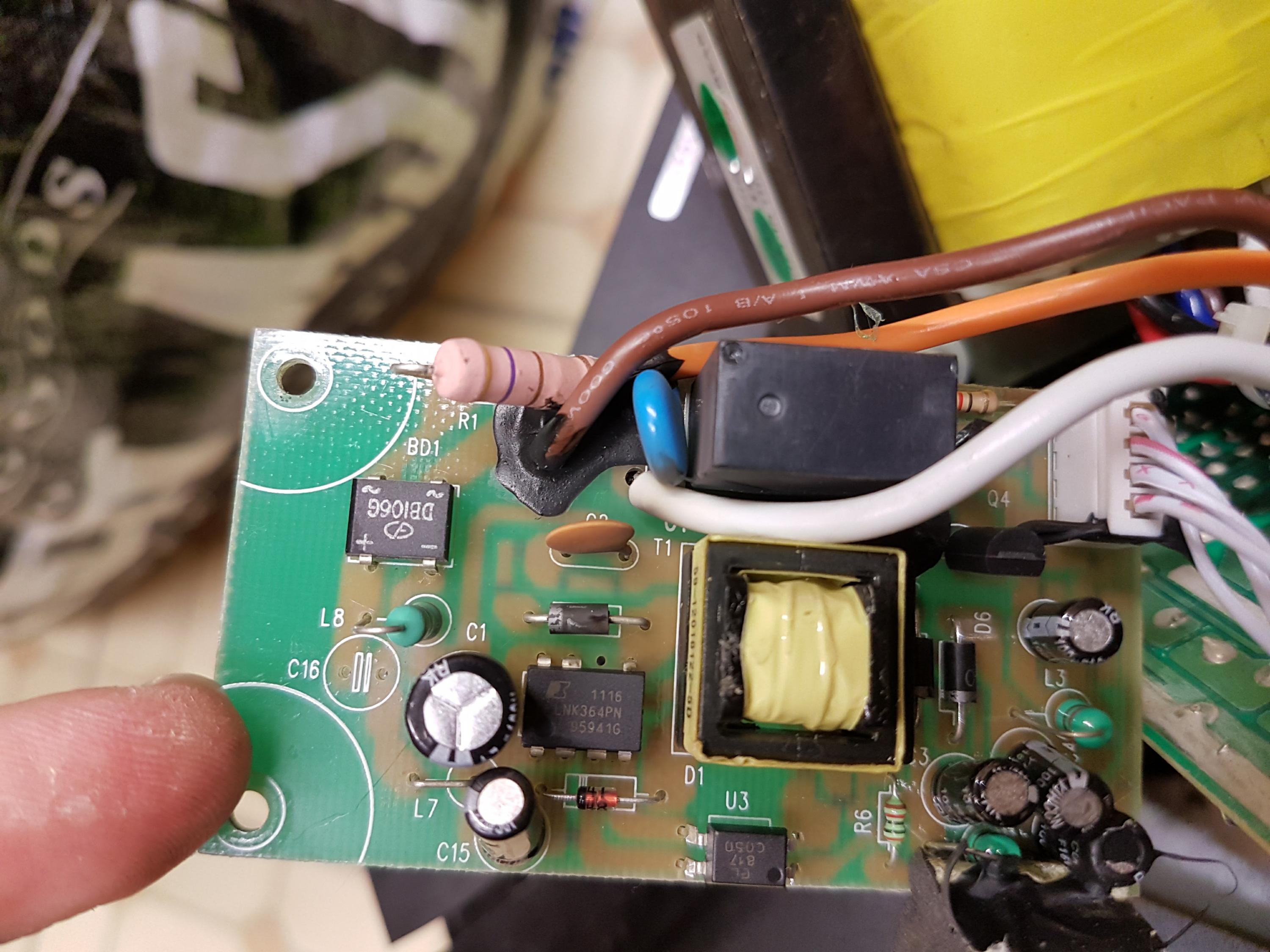

                                        #59
                                        Here should be some photos of the board which seems to have the fault:
                                        https://drive.google.com/open?id=0B5...ndMQ2NkWmpRQVk
                                        Resistor R1 seems to be open circuit (8Mohm across it)
                                        Inductor L8 has a cracked case but seems to have continuity still.
                                        I thought diode D2 looked overheated but it still measures 0.5v drop across it ok.
                                        There seems to be around 24 ohm across the output of bridge BD1 (seems a low value)
                                        The mains switching relay doesn't pull in (hence no AC to transformer).
                                        I didn't see any of these parts on the schematic which had been posted for the VW8.
                                        Connector at end of board is marked as CN3A.
                                        Any ideas?

                                          #60
                                          I've attached your photos here so that 1) they're easier for everyone to view and because 2) external links have a habit of disappearing after some time
                                          Anyway - replace R1, obviously.
                                          D2 may test OK but it's definitely been stressed and should be replaced.
                                          Maybe a good idea to replace the bridge rectifier for the same reason.
                                          L8 may still have continuity but may have lost inductance (shorted turns) so replace that too.
                                          Probably with that low resistance reading you will find the LNK364PN controller IC has shorted. This may have been caused by D2 going bad in some way - it appears to be part of a snubber network which protects the IC. Or maybe the IC went bad and burned D2.
                                          Check C2 is not bad, check any SMD parts (R2 underneath?) connected to D2\C2 as well. Check C1 does not have reduced capacitance. Check\Replace D1.
                                          You may find that the U3 optoisolator has been blown up as well, if the LNK364 has died spectacularly enough.
                                          After doing all that, power up with a series lightbulb to the mains supply and see what happens.
                                          -David VanHorn
