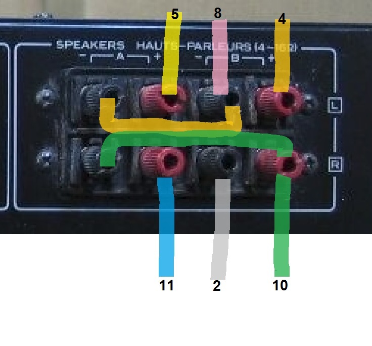

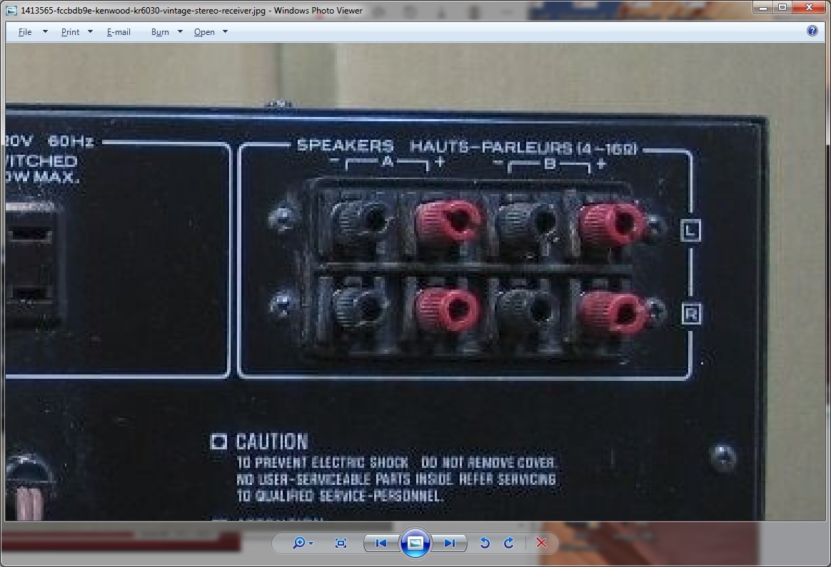

    Click image for larger version  Name:	enlarged2.jpg Views:	0 Size:	173.1 KB ID:	3716305 Click image for larger version  Name:	enlarged.jpg Views:	0 Size:	203.8 KB ID:	3716295 If you click on the pictures and make them larger you will see the pin numbers I put on them. Are you using a computer or a phone? You wanted to know the pin numbers on the switch, so I numbered them and gave their destination

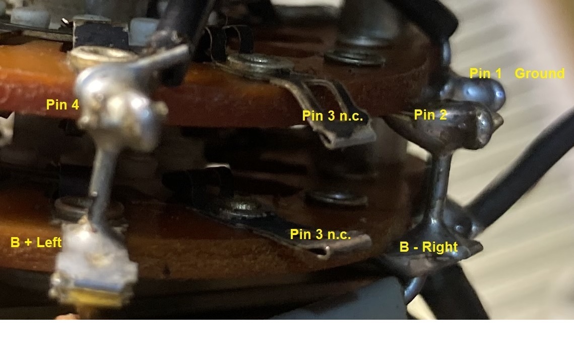

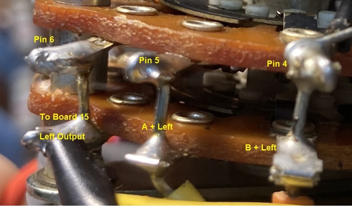

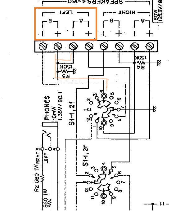

    I used the pictures you provided, and numbers the pins as per the service manual
    Pin 6, To Board 15 (Left Output) goes to the amp board, pin 15
    Pin 5 goes to Left speaker "A" + positive (Red terminal)
    pin 4 goes to Left speaker "B" + positive (Red terminal)
    Pin 3 is not connected (n.c.)
    Pin 2 goes to Right speaker "B" - negative (Black terminal) Click image for larger version

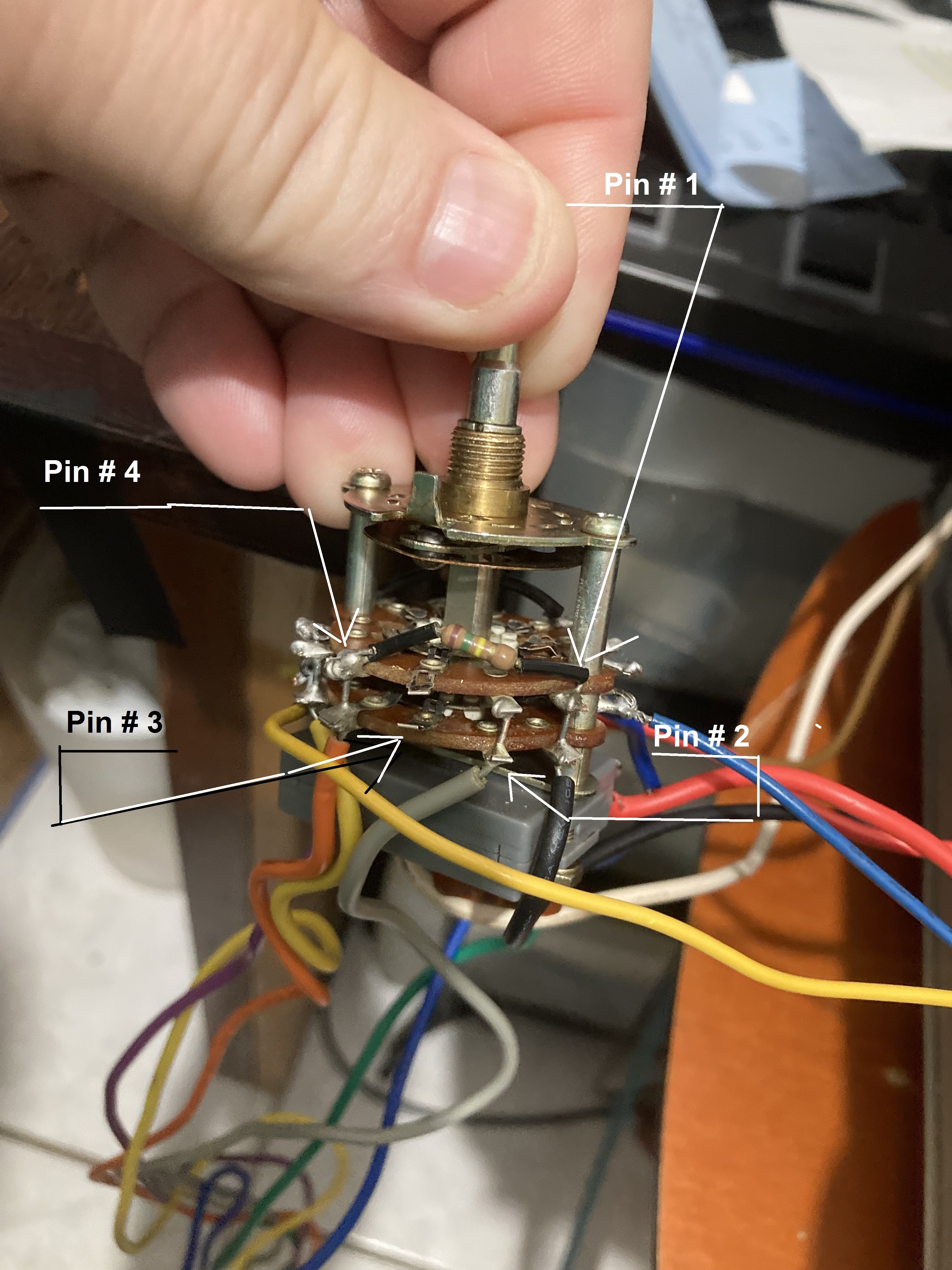

      #62
      Originally posted by DrDos
      R_J, are you saying that the numbers are on the white circular thingys in the center? I do seem to see what look like faint markings on them. I will check this out further.
      Thanks much, you could be a life saver because it never occured to me to look there.
      Can you see these numbers? the switch pin numbers count around the other side up to pin 12
      Click image for larger version  Name:	marked image_396906.jpg Views:	0 Size:	3.02 MB ID:	3716359

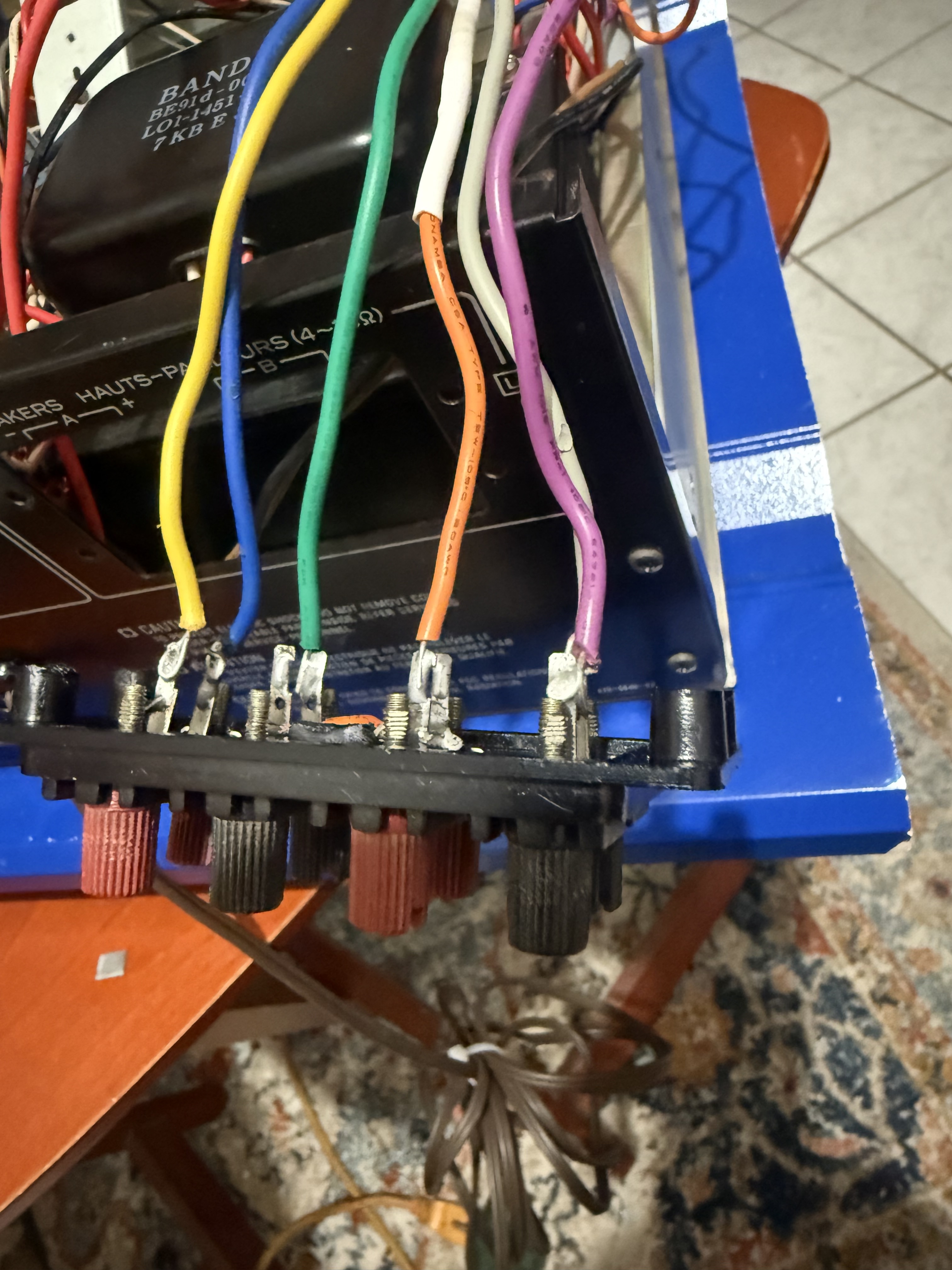

          Well I should say I hope you are right because none of th wires you picked were in the right place on the speaker output terminals, so I'm going to rewire the speaker output terminal section just the way you listed them. You were dead on with 15 and 16 going to the relay board so I guess everything else aught to be okay. I had been thinking for a while now that somebody got in here and messed up this wiring, mainly because there were no wires on B negative left or right just the jumpers for the A + B which if I am correct should go from A- left to B + left and A- right to B + right? Thanks very much for the help R_J.
          • DrDos
            • Aug 2025
            • 93
            • U.S.
            #65
            After studying what you gave me I mapped everything out and found the only wire missing was B + right and A- Left and I assume those are the jumpers from A- right to B+ right and A- left to B+ left to complet the A + B speakers selection. If I am right then you were sent to me by God J_R. Thanks. I am learning so much. I may even take a short beginners class course in this tuff to get better at reading resisters and stuff. Thank you.
            • DrDos
              • Aug 2025
              • 93
              • U.S.

              Sorry to bother but I thought that the notch on the wafer meant pin 1 to the right, but that is not how it goes so how do you know? I mean where is the benchmark for wafer switches so a person can find pin 1? Your wiring is totally different than what was there which explains why I had music coming out only one A or one B I guess once I got it up and running. Teach me how to tell where pin 1 is located on any wafer switch please?
              • R_J
                • Jun 2012
                • 9608
                #67
                I went by the schematic, and the one giveaway was pin 3 which is not used and is not connected to anything. I am not sure how alps numbers the switches, but in this receiver, this is how they are numbered. It looks like this switch has the mounting bolt between pin 1 and 12. This switch was likely custom made for Kenwood

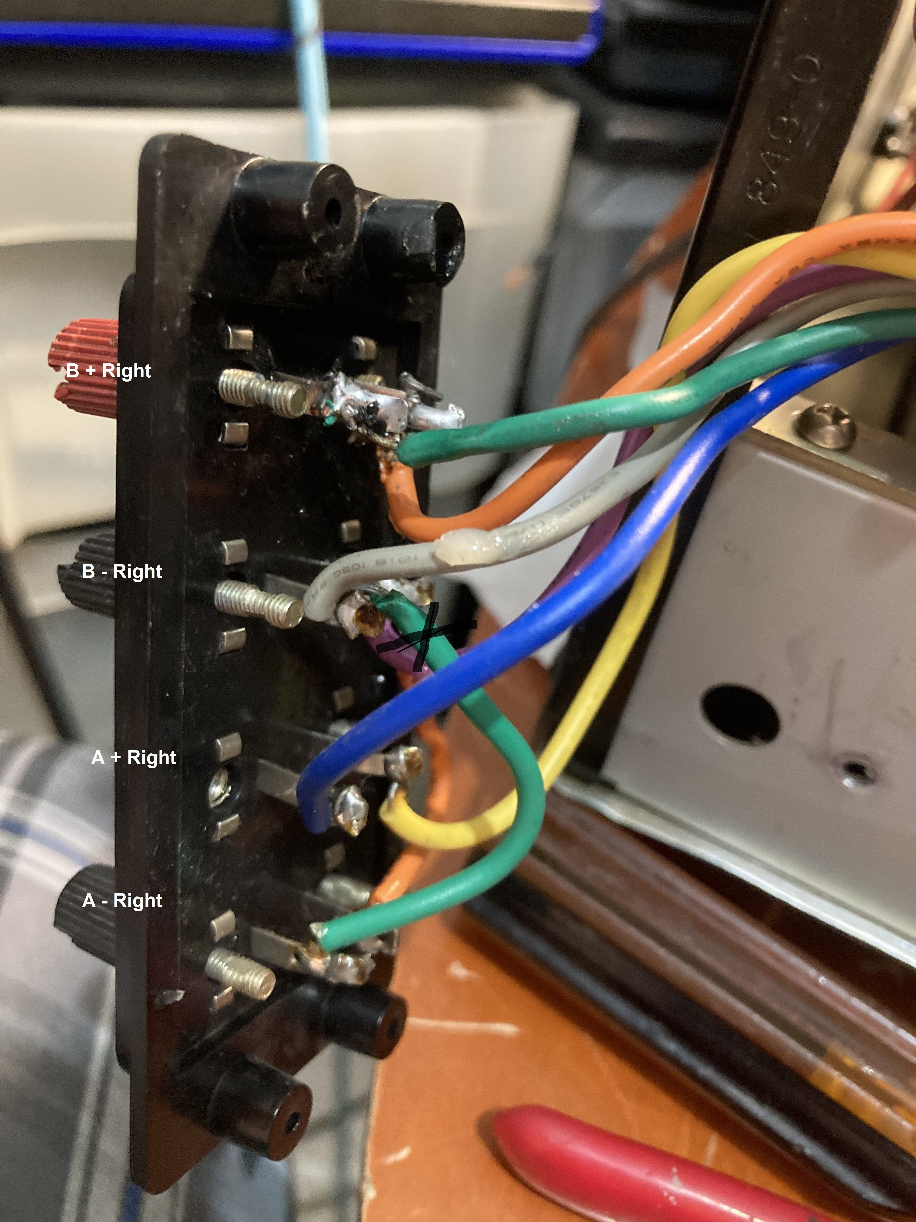

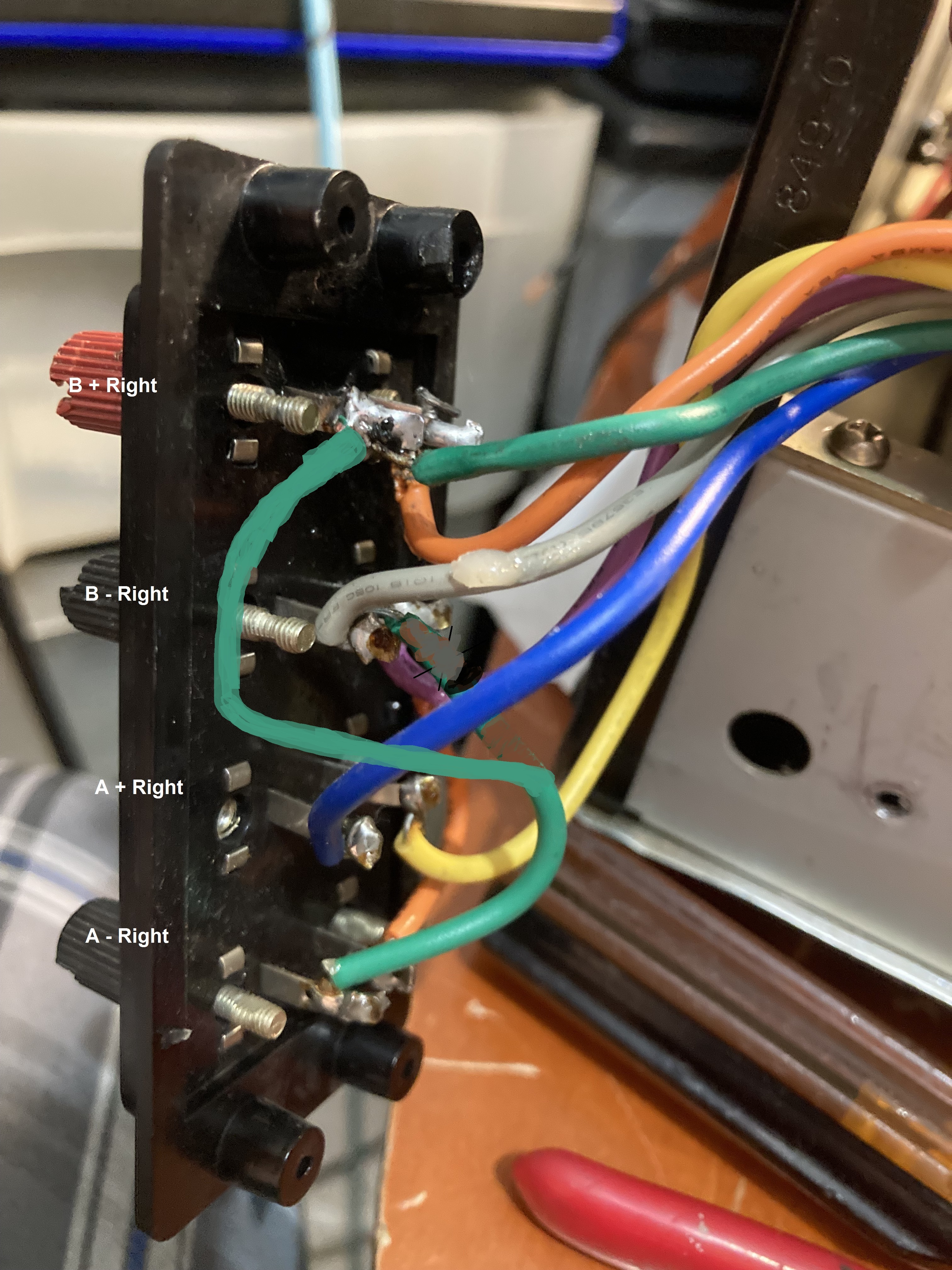

                    The small green wire connected to A - Right is correct but the other end should be connected to B + Right (green wire to the switch) NOT to the grey wire on B - Right
                    • DrDos
                      • Aug 2025

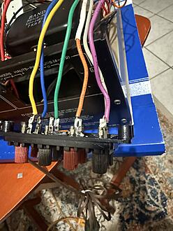

                      Hey J_R. This is how I put the wires for the speaker output. A is on the right and B on the left. The top row is left and the bottom row is right. I hope I did it correctly
                      • R_J
                        • Jun 2012
                        • 9608
                        #71

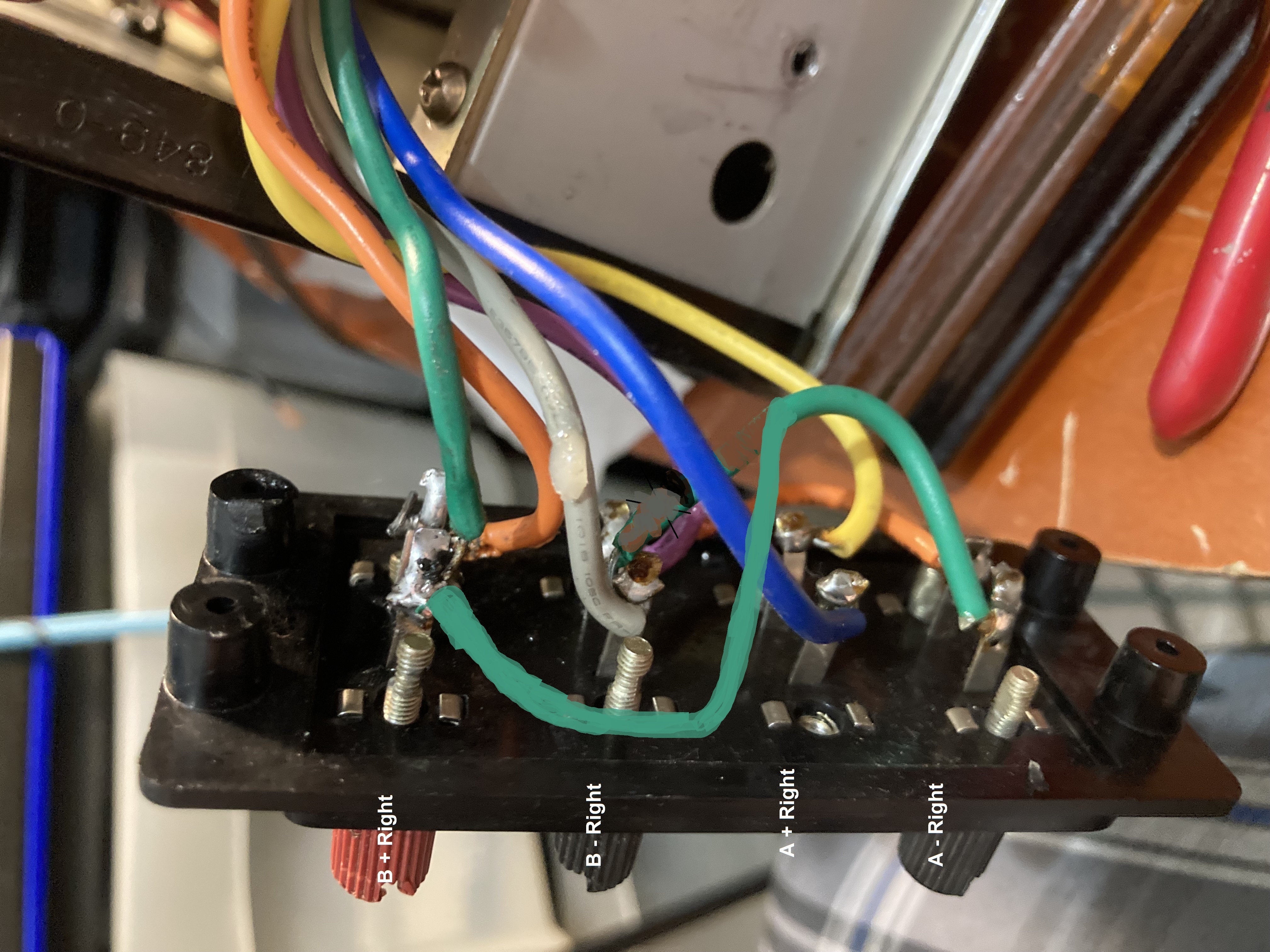

                        The original speaker jack was wired correctly other than that ONE green jumper. If you want to wire it differently that's up to you
                        The A and B are not wired in a row, see attached picture

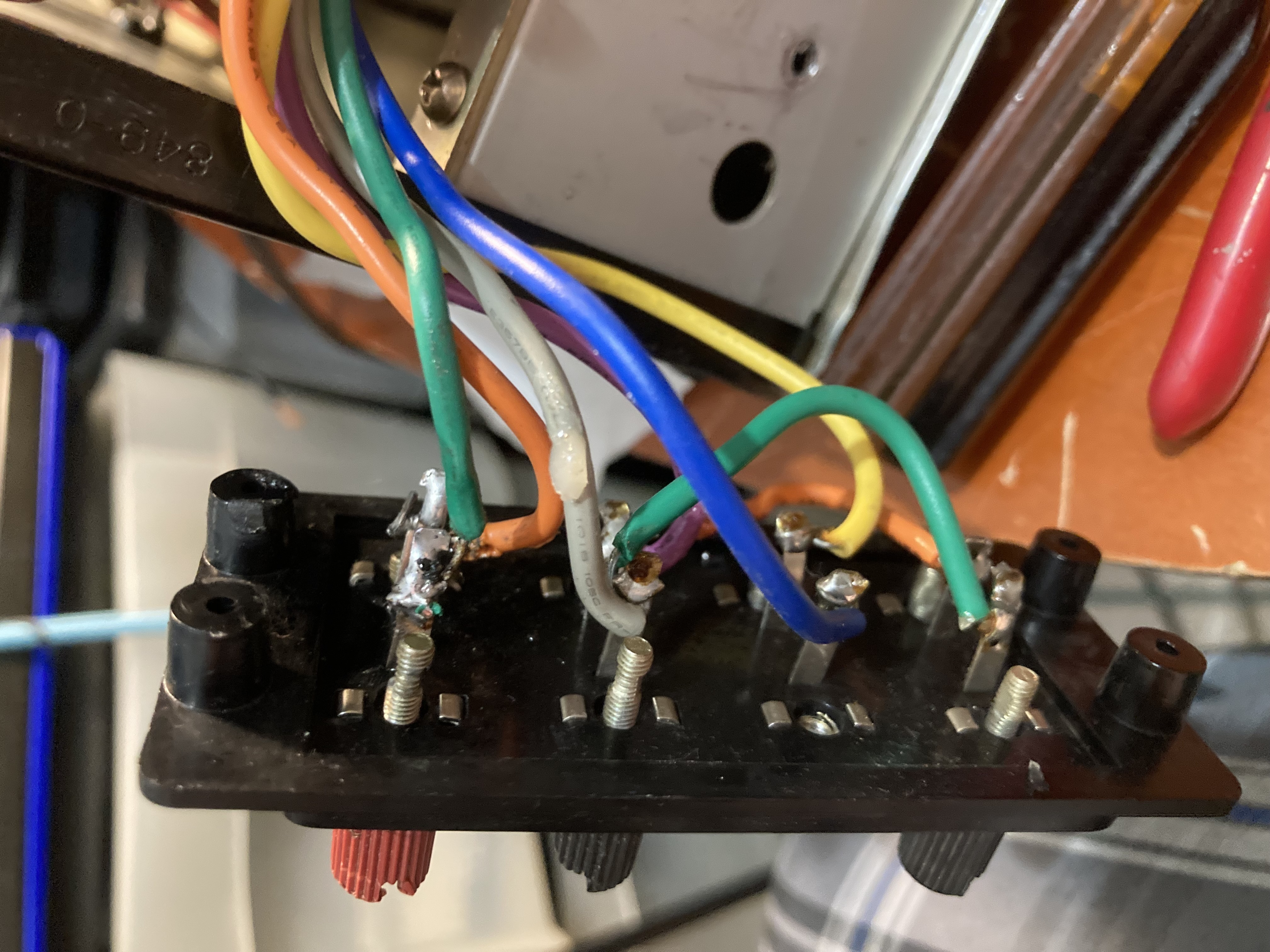

                            #73
                            I've added a better look at the wires I hooked up so you can see the jumper also for the A +B speakers according to the schematic. Please keep in mind that I have only 2 to 3 weeks of learning here and may not understand a schematic well, yet. If I have to put the wire back the way they were ok but I am just trying to understand what I see in the schematic vs what should be now. I most vertainly am wrong but I need to know why. Thank you for your help.

                              #74
                              Here is a picture from the manual. See pin 4, see orange wire and where it goes. it does NOT connect to B+ RIGHT! It was originally on B + LEFT with a small ORANGE jumper wire to A - LEFT as well which was correct.

                                Click image for larger version  Name:	turned_spkr jack green jumper.jpg Views:	0 Size:	3.24 MB ID:	3722638 Click image for larger version  Name:	image_398882.jpg Views:	0 Size:	1.51 MB ID:	3722633 Click image for larger version  Name:	image_396682.jpg Views:	0 Size:	3.23 MB ID:	3722634
                                Look at your original picture. they are NOT WIRED THE SAME all you had to do was move the green jumper wire that was soldered to the grey wire by mistake and solder it to the green wire (B + Right) and all would have been correct, but nooooo
                                • DrDos
                                  • Aug 2025
                                  • 93
                                  • U.S.
                                  #76
                                  Ok I can tell you're getting a bit frustrated with me. I will put the wires back the way they were and change the green from it looks like B- left to A- right. I'll get on it right away.
                                  • R_J
                                    • Jun 2012
                                    • 9608
                                    #77
                                    The GREEN wire coming FROM the speaker switch should be connected to B + RIGHT AND A - Right terminal so which ever terminal you connect it to, also run the (green jumper wire) so both terminals are connected together.
                                    This also applied to the small (orange) jumper wire that connected A- Left to B - Left. Both jumper wires seem to be missing in your last picture.
                                    In post 69 I explained what needed to be changed, move the end of the green jumper wire, that is all that needed to be done, not rewire the whole speaker terminal. The RED terminals are Positive the BLACK terminals are Negative
                                    ¿ The small green wire connected to A - Right is correct but the other end should be connected to B + Right (green wire to the switch) NOT to the grey wire on B - Right
                                    The Blue to A + Right is correct
                                    The Grey to B - Right is correct
                                    The Green to B + Right is correct
                                    The Orange to B + Left is correct
                                    The Pink to B - Left is correct
                                    The Yellow to A + Left is correct
                                    The Orange jumper between A - Left and B - Left is correct
                                    So, the only wire that is wrong is the small GREEN jumper wire

                                      Okay I got it. Return wires to original places and move green wire from gray to green. Got it. and thank you very much. I'll try to find someone on youtube that teaches how to read schematics because even the layout of them is troublesome. Thank you R_J.
