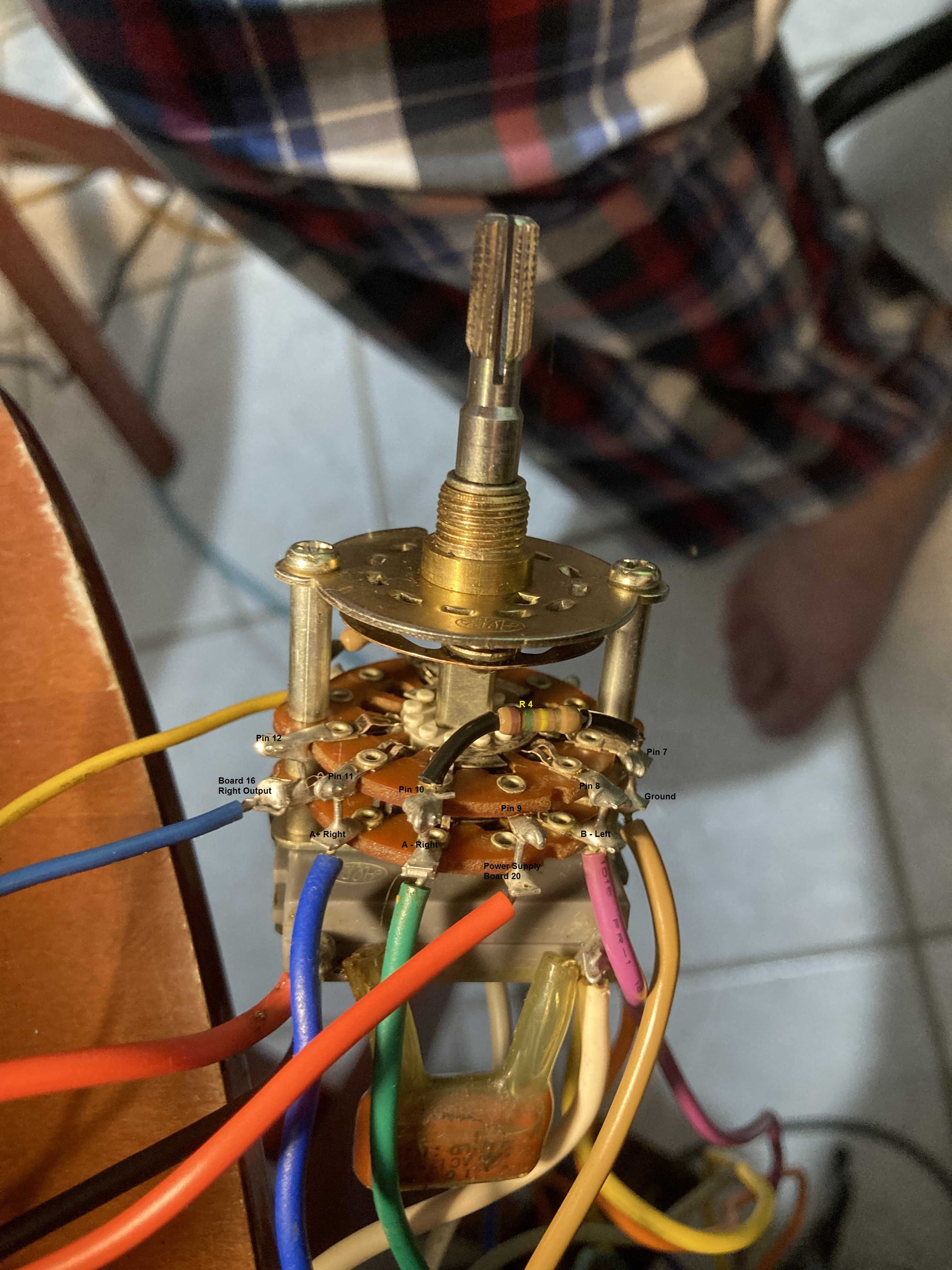

    Well I have continuity on all the wires leading from the switch to the speaker terminals. I also noted another of those wires but it was hooked up black to black so I left it lone. I don't have any deoxit so I'm going to use vinegar and hydrogen peroxide (sparingly) to try and clean the switches contacts. I will rinse it with 91% alcohol. Then I will resolder the joints of the switch just in case (like you say) bad solder joints happen in things 50 years old. I keep you informed.
    • DrDos
      • Aug 2025
      • 93
      • U.S.
      #42
      Well now the blue wire from the four hole connector off the power amp broke off the switch and I can not find where it came off or where it goes on the schematic. I'm really screwed here.
      • DrDos
        • Aug 2025
        • 93
        • U.S.
        #43
        Well, I think I need a new switch. At least it is working. It just doesn't want to work right, however, this is what happened. I got rock music on 3 outputs A left - B-right + left. Then I got nothing and all I did was wiggle the speakers wires going to the speaker. I just pushed them in with my hand I did not mount them. Then I got nothing and the blance knob only worked on the left side. So I'm going to buy the strongest deoxit and try again. I must have screwed something up cleaning the switch or it has just met it's last days. I can't find one anywhere I may contact Kenwood, maybe their techs know where I can get one. Any idea's?
        • Agent24
          I see dead caps
          • Oct 2007
          • 5080
          • New Zealand
          #44
          The switch doesn't look broken from your other photo, but it's hard to tell given the angle.
          Can you take some more photos of it?
          Switches usually fail when the contacts wear out from age, or something breaks off.
          If it's not that, then it could be dirty/tarnished etc and a good cleaning should fix it.
          Make sure if you fix it by cleaning, that you lubricate it afterwards, or it will definitely wear out sooner rather than later!
          I very much doubt Kenwood will have stock of a switch this old, but who knows.
          Hopefully it is just dirty.
          Of course, if the sound cuts out when you move the speaker wires, you perhaps have dirty/broken speaker terminals, or cracked solder connections between the internal wiring and the terminals, for example.
          I can't imagine wiggling the speaker wires should cause any mechanical interference with the switch.

            Okay, if the pics are not good enough or not the right angle let me know I'll send more. Now this is wierd, again I find another wire attached from a black lead to a red lead on the inside by the speaker outputs. That has to be what is knocking out the speakers. Soldering a wire from black to red just does not make sense., so I am taking it apart again and taking that wire off. The output leads all have wires attached coming from the switch and they all have continuity so I just don't understand why the wire was used. Somebody tried working on this and gave up or just knew even less than I do, I guess. The speaker terminals are broken I was just shoving the wire into the hole and holding it. You can still attach wires to the terminals for speakers but I was just doing a test. We'll see what happens when I remove this wire. Thanks a bunch. Oh, what are your thoughts about this wire?

                      Sorry for the bad pic. I am trying to check the wiring in the switch. It would be great if the schematic used colors. I can't tell where #1 is located. For A (right) it should be orange and purple wires in slot 10 and 11 or the switch. They are not unless slot 10 is 4 slots down from orange. For A (left) green goes to slot 8 but grey is showing connecting to blue which is the positive side of speaker B left. This just doesn't make sense to me. Can you explain why this happens? The brown and green have a resister connecting them in the switch. The orange and black have a resister. The black goes to the power board well underneath it by the filter caps. The brown goes to the same bunch of pins where the black went. It's wierd because it appears they are going to grounds but yet listed as positives for A and B speakers. I tried to give you a better pic of the switch schematic. Please let me know because right now I think the speakers are all F'd up.

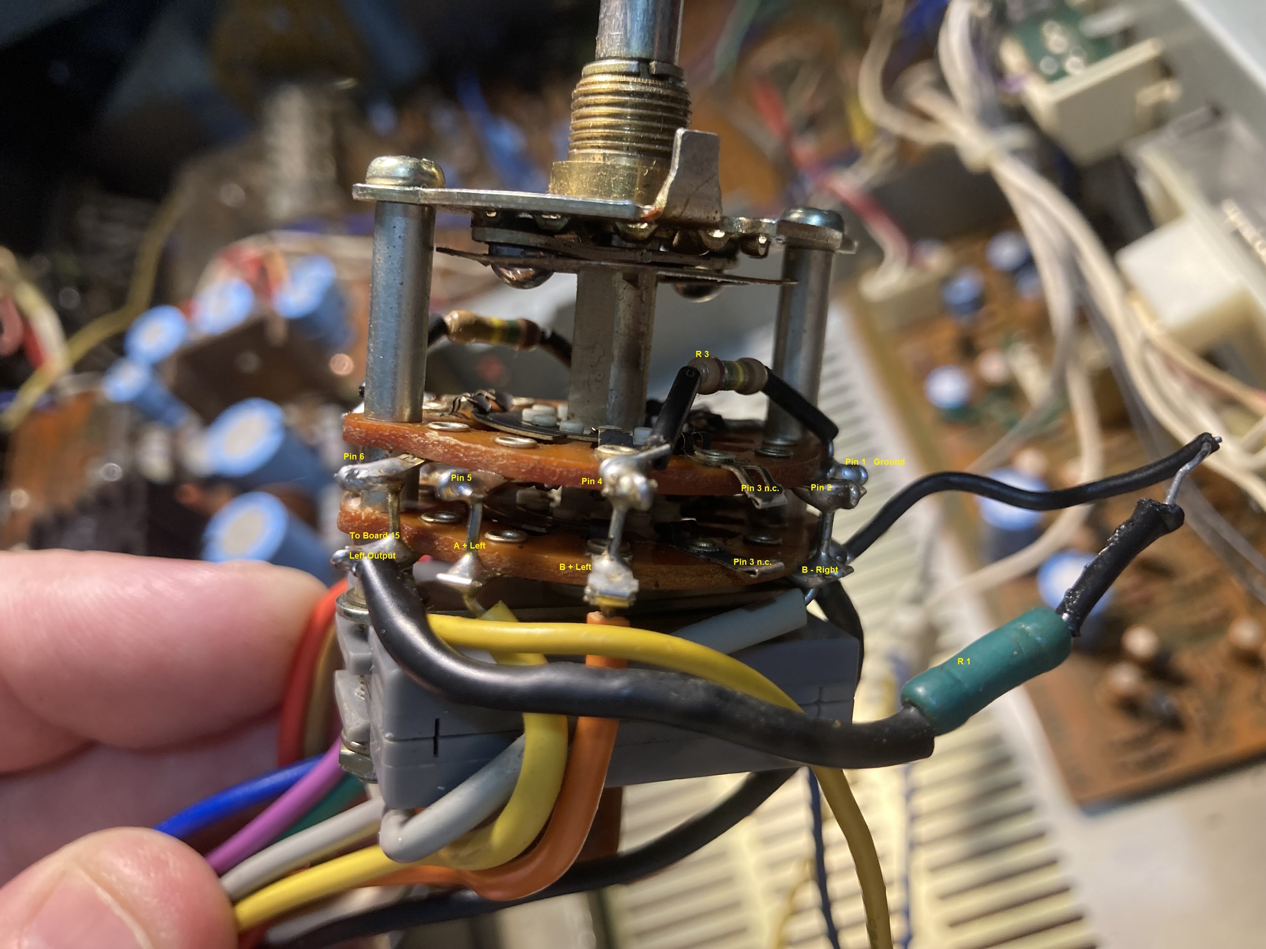

                            Here are some pics I'm trying to figure out where post #1 is because I think it is not wired correctly.

                              I don't know which one is Pin 1 but I don't think it's wired incorrectly - all the solder joints I can see look original.
                              Well, all except the blue wire on the far right, perhaps, in the 3rd photo.... seems to be multi-stranded while all the rest have solid core wire.. maybe it's something someone changed, I don't know.

                                Okay, thank you, The blue wire came off while I was messing around with the switch. I was and still am unsure where to put it. There is a yellow wire that is all by itslef on the wafer going to the plug on the relay board. There was another solder joint on the switch similar to the yellow so I cannected the blue wire there. It just seemed logical. I hope it works. I placed it as close as I could to show you a pic. I'm waiting for parts.

                                  Well, I understand the schematic as far as where the wires go to the speakers but what gets me is in the schematic the pictures of the wafer show each one in a different position
                                  when they are both soldered together in the same position. I still would need to find (and be sure of) just one pin that was wired correctly for me put this together.

                                    The best I can make out from your pictures is the following, the numbers may be hard to see but they are there

                                      R_J, are you saying that the numbers are on the white circular thingys in the center? I do seem to see what look like faint markings on them. I will check this out further.
                                      Thanks much, you could be a life saver because it never occured to me to look there.

                                          Okay, I have not found any numbers BUT I have learned a new electronic symbol which helped me to figure out the numbers on the switch. Thank you everyone for the help.
