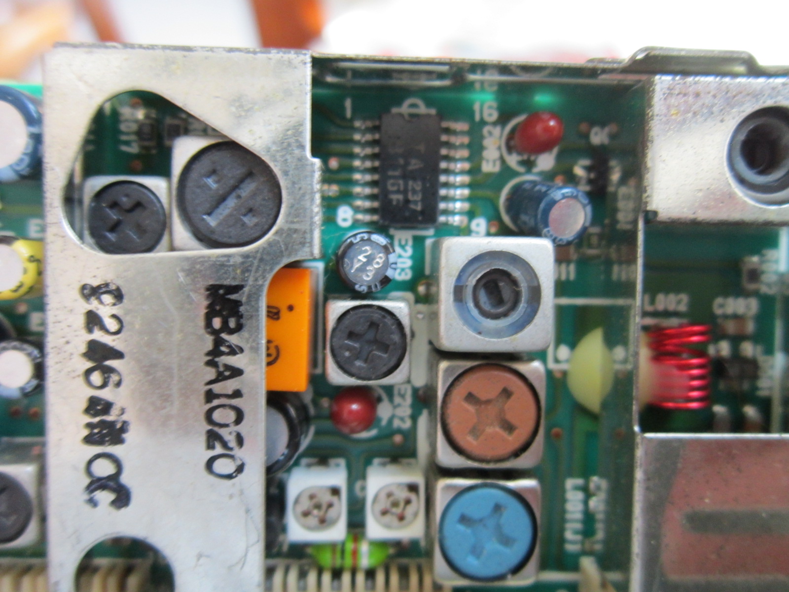

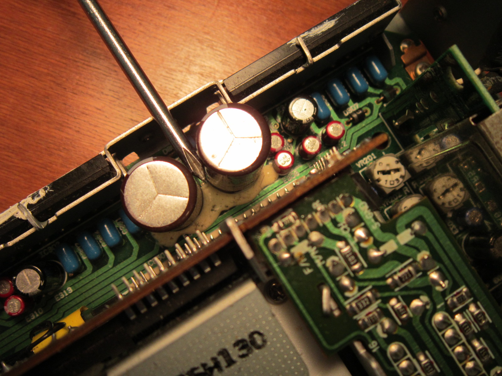

      Haven't gotten that far but upon opening the unit I see 2 suspicious looking capacitors; I assume the two with "goo" at their base are shot. Is that correct? It's the first time I've seen any like that.Here's picture.
      When I look them up on the schematics they are in the pre-amp/amp part of the system so makes me wonder if they're the culprit.
      The screwdriver points to the "stuff".Any help is appreciated.
      thanks
        • 31111
        Re: Alpine 7525 car stereo
        that's glue, and those are related to the speaker outputs.
        what's the part number on the amp chip?

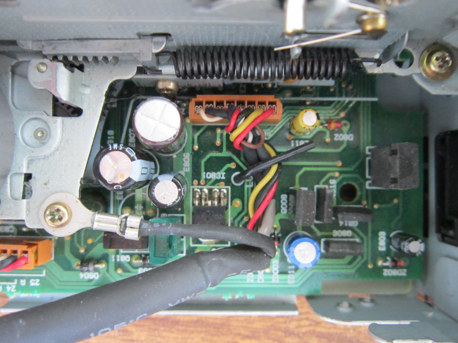

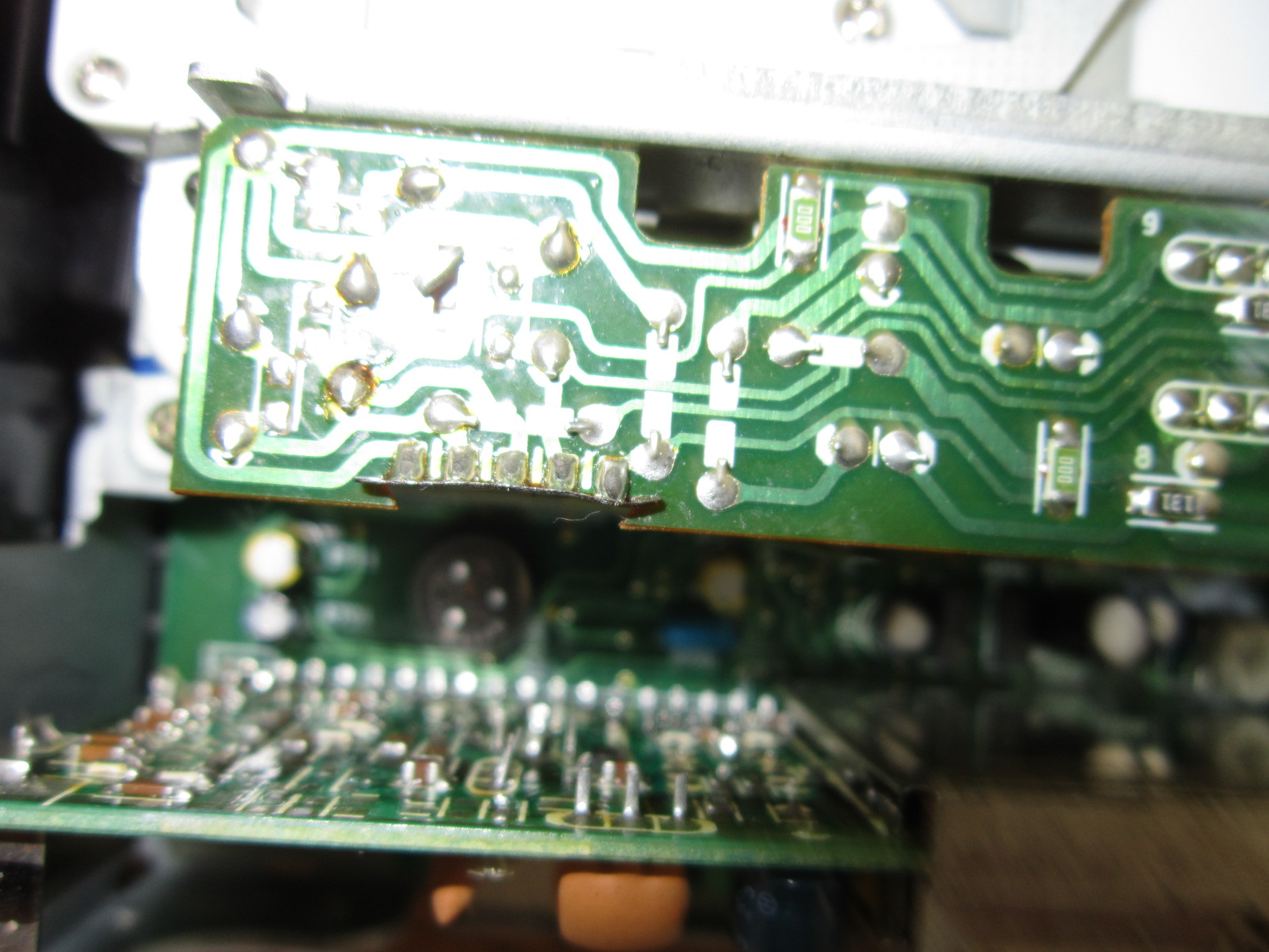

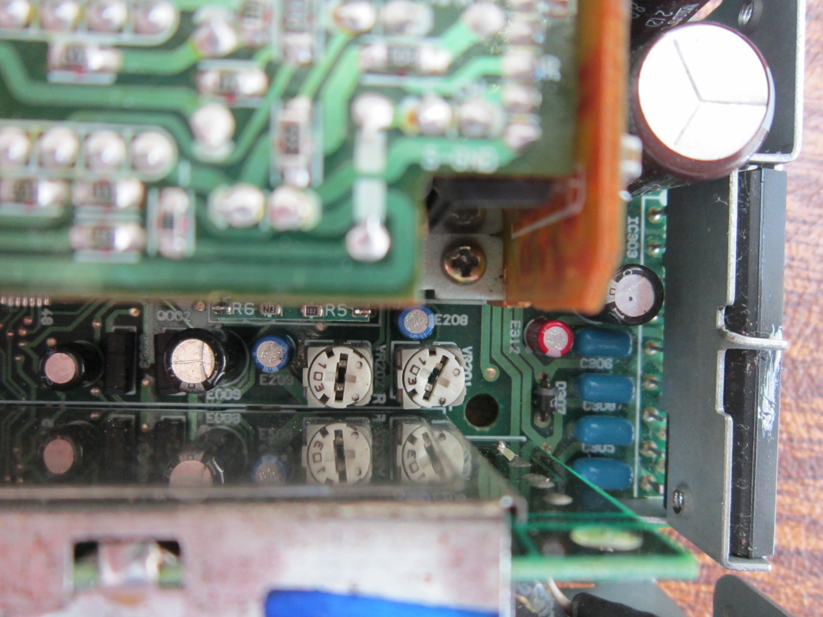

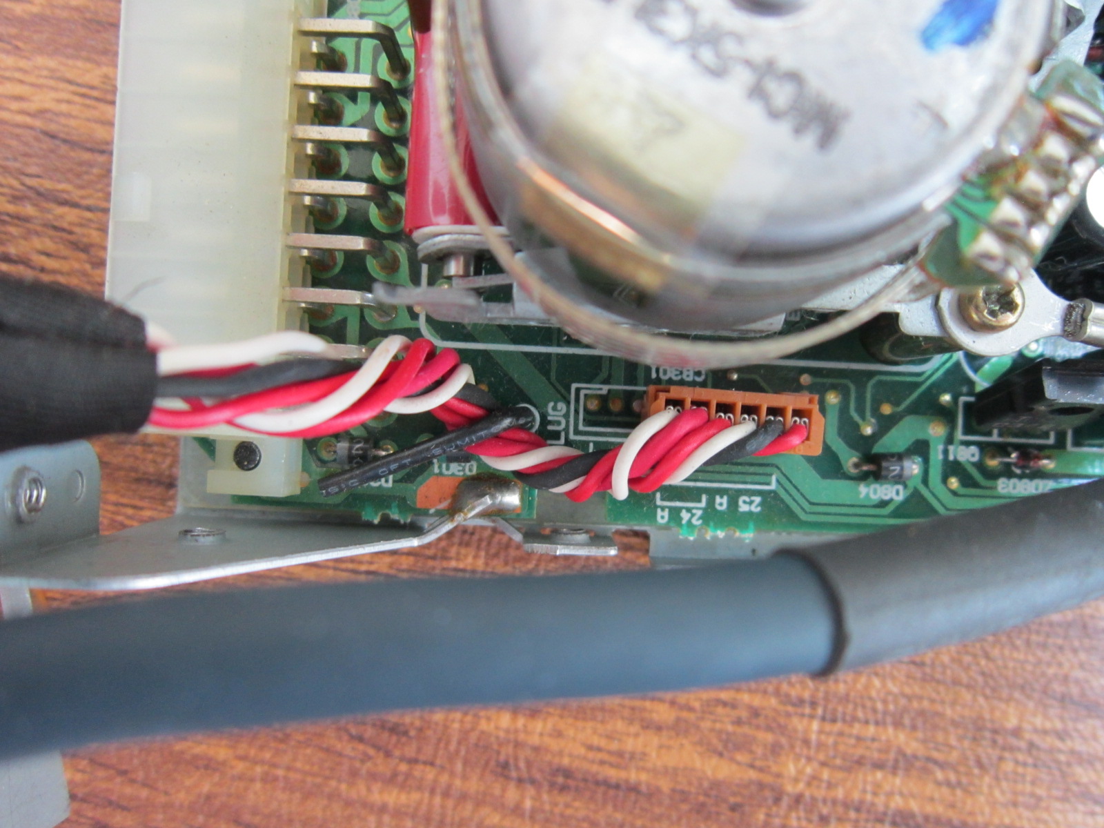

                Try posting a picture of the entire unit. There may be another fuse or fuses inside the stereo. The pictures would also give us an idea of where to tell you to look for signs of trouble.
                • Philpc
                  • Feb 2013
                  • 29

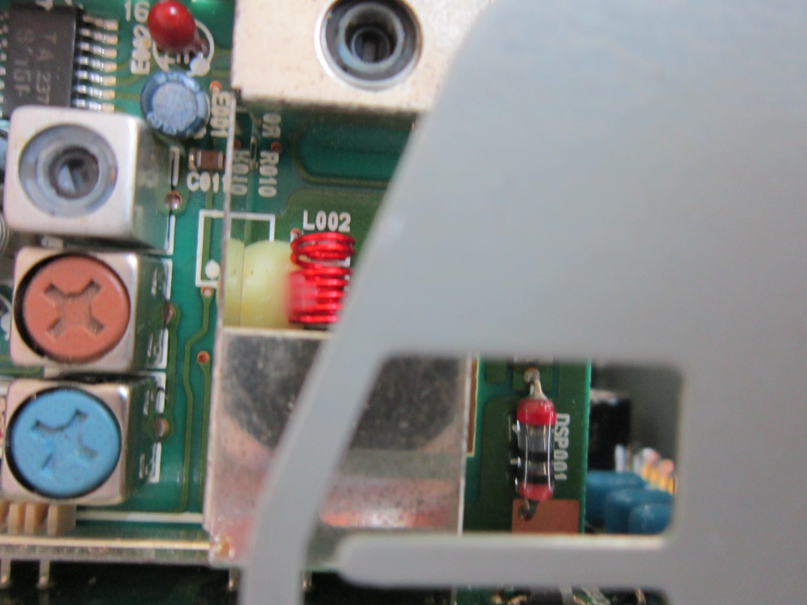

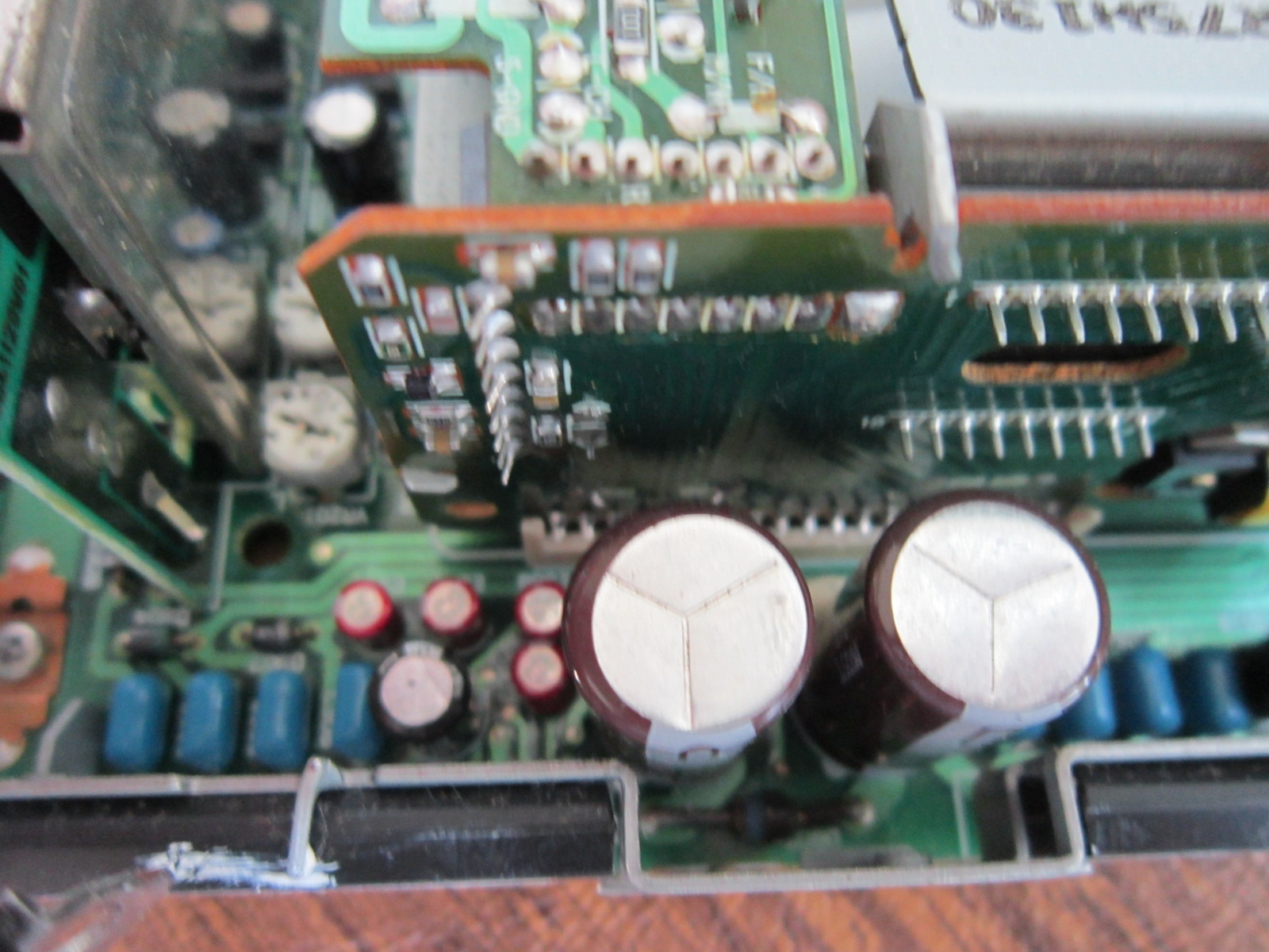

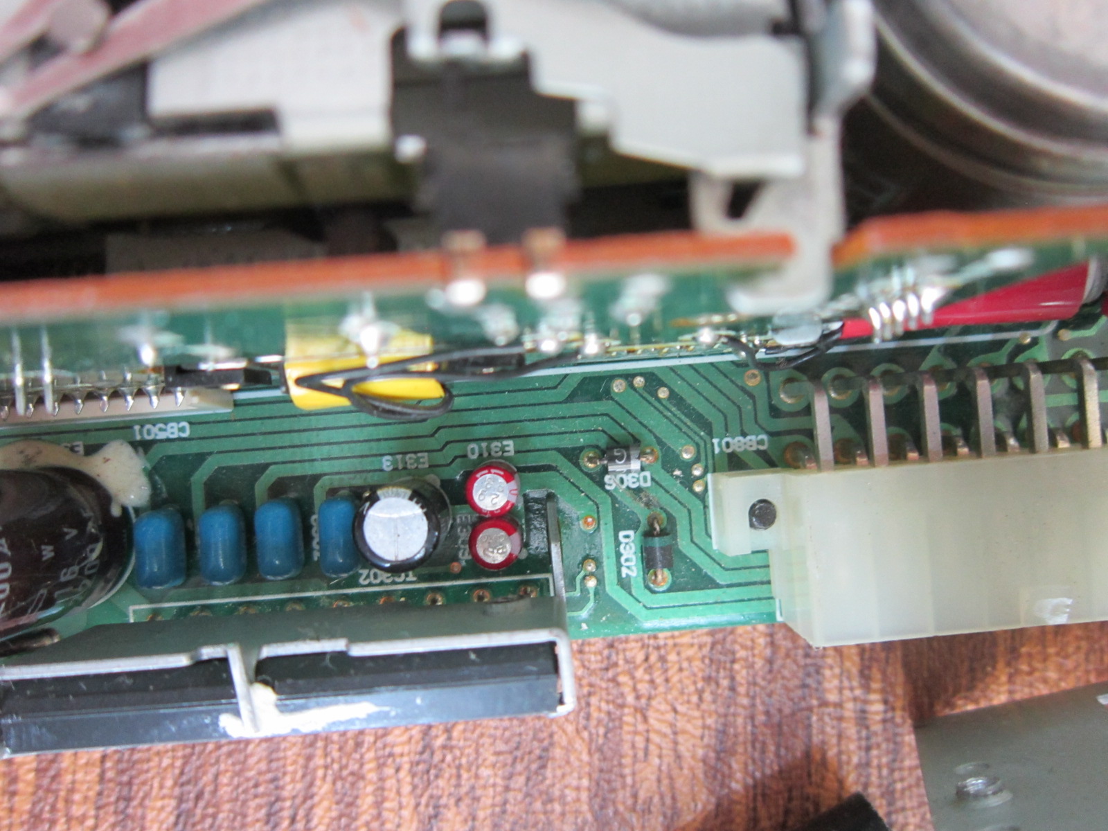

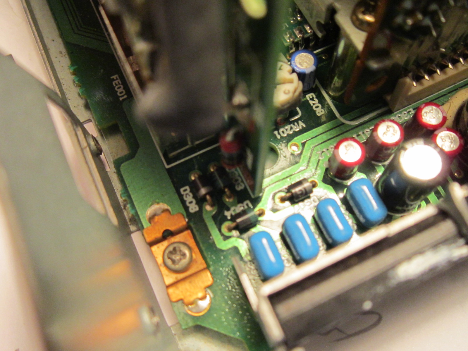

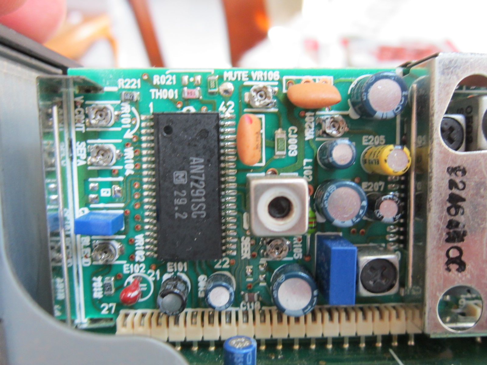

                  Here are some pics. Will post the schematic after I get my scanner working(having a problem with windows drivers.ugh!)
                  thanks again for any help
                    master hoarder
                    • May 2008
                    • 12175
                    • Bulgaria
                    Sorry to be such a downer, but the pictures are still from a bit too close so it's hard to tell how the boards connect and where power comes from.
                    On the second picture, IMG_0300[1].jpg, there's possibly a thermal fuse - TH001. Measure its resistance to see if it's good. Should be very low - a few Ohms, if even that (depends on how low your multimeter can read too). Post back what results you get.
                    Q811 (second to last pictures) also appears to have been running a bit warm - though it could be just the way the shadows appeared in the picture. And there still should be a fuse somewhere on the board. I doubt that little thermal fuse is all the board has. Perhaps there is also an enable/sleep signal on the harness? Check with the schematic.
                    And check all solder joints thoroughly.
