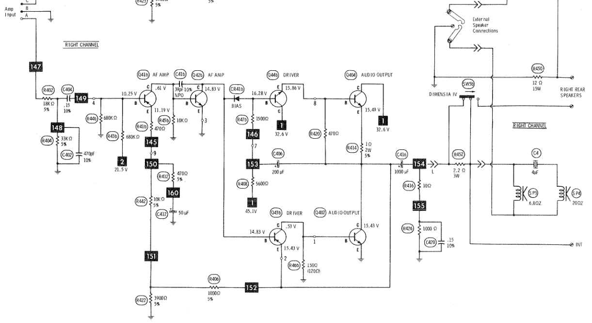

    Its an RCA VTT301L turntable with 2 channel amp.
    Instead of retyping everything and what I've done if you could please read it here:
    https://www.edaboard.com/threads/i-n...ier.413493/​
    I will upload the schematic here if that helps. Thx

    well looks like most of the work is done isn't it?
    Did you try swapping C416 and C417 or swapping the suspect bad capacitor with a spare or even a smaller µF if you don't have an exact one?
    I think you can ignore R416/R426/C420 and R417/R425/C419 for now, they shoudn't fail in a way that would cause no audio output. They will pull a weak capacitor to 0V as they are a resistor network after all.
    So you say the speakers are good, so C416, swap it and see... A dried up, broken C416 will behave the way you seem to observe.

            The power amp uses output coupling capacitors, it's not DC-coupled. If the problem is the power amp, measure some voltages. The schematic shows many of them. The voltage at C416, C417 will indicate overall health of the amp and 15.43V is expected on (+) side and 0V on the (-) side.
            It's not a capacitor problem for something vintage 1974 to have a dead channel.

              Technically in steady state/quiescent/0V input, the voltage at the input of the capacitor should be about half the rail. and the output should be near 0 V because the speaker is pretty much a short to ground at DC. If it's not 0V there's an open somewhere after the capacitor...
              if there's no open after the capacitor and all the voltages prior to the capacitor matches the other channel, then you'll need the oscilloscope to find where the signal is lost. Severe loss in volume is a rare failure mode in circuitry unless it's a bad pot/connectors/loose ground or something like R402 got really high resistance but not go completely open somehow...
              You did test both channels independently right, i.e. not using a stereo source and seeing if one channel is working or not?

                            Reading your other followups in the other forum it looks like you failed to follow an important mantra when working on something you don't understand:
                            >>> Change one thing at a time.
                            Your first priority is to fix your previously working channel and you definitely did something to break it. Check all your connections carefully.
                            Also I disagree with the person who claims low frequency scopes are of limited use -- pretty much any scope, due to the low frequency of audio, is usable. In fact a bandwidth of 100KHz is sufficient for most debug and a 200KSPS DSO is plenty for audio work, unless you're trying to debug some really high treble issue -- but a totally silent amp is not this.
                            Another useful tool is a signal injector or just something that you can inject audio signal into the signal path to see if it propagates to the output. The finger induced 50/60Hz hum (from line frequency noise) works too but you have to be careful to not touch dangerous spots and it doesn't have very low impedance, which will get swamped out by transistor drivers. Also depending on the bandwidth of the amplifier and how big your speakers are, 50Hz can be hard to hear.

                                  Did you only disturb electrolytic capacitors or did you also replace ceramic/polyester caps? I don't think any capacitor really needed to be changed but for the "J"/Left channel:
                                  capacitors removed/broken that would cause no sound: C403 C417
                                  The other ones would cause sound quality issues.
                                  If C403 and C417 are intact, then did you check all the voltages against the voltages on the schematic and find a point where the voltages don't mismatch?

                                      So I have been going through the power circuit, waiting to get an oscope tomorrow, using my DVM at the moment. Anyways on the attached image I isolated the power supply and I do have approx 32 volts at pad 1. I tested the circuit to pad 2 and before R42 resistor I have 32v, after the 680k resistor I have approx. 14 volts. It appears that this also feeds the other channel circuit as well. Is this an issue, am I doing something wrong? Thanks
                                      • eccerr0r
                                        Solder Sloth
                                        • Nov 2012
                                        • 8711
                                        it appears that power is used solely for biasing the bases of Q41a and Q41b. What are the voltages there?
                                        This is a high impedance power supply so it will be heavily dependent on these loads.​
