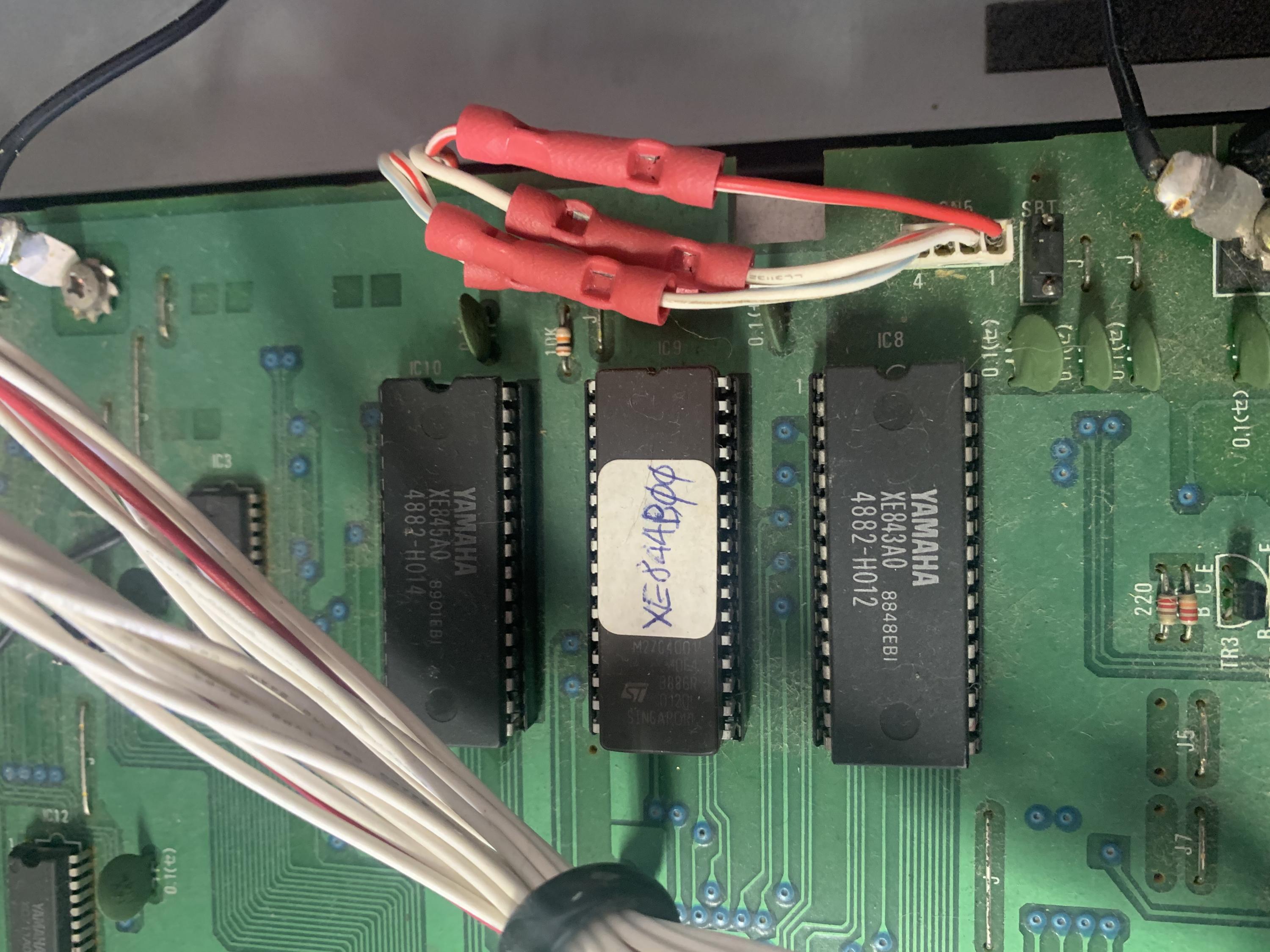

                        DKNEYLE I'm wondering if I have your CLP550!
                        Howdy all. I've 'inherited' a free CLP550 which seems to have the same issue described. Crazy sounds but amp and MIDI working fine. While handy with a soldering iron, am going to pass the task of programming the 27c040's to a mate with an EPROM programmer. I'll use the BIN files posted lower down and report back.
                        Now RE the comment above about maybe having DKNEYLEs CLP550, I live in Sydney and inherited this from a fellow who said he got it for free from someone else. I opened it up and can see someone has already put in IC sockets and started "fiddling" with the ROMs.
                        So how would we know if this is yours? Here's a pic of the ROMs (attached), mid one has been changed. Recognise it?
                        Anyway, plan is to resurrect it for my 3 year old pink., May give it a hot pink spray job. Will report back

                          Re: Yamaha Electric Piano CLP550 no keyboard output
                          Had a look at your image, and no, not my old piano. I'm pretty sure my old piano still resides in Bega where I donated it to an analog synth group.
                          I was just having a quick review of this forum and how far everyone had got in resurrecting the ROM code and getting their pianos going again. From the seed I planted we got to this point. Congrats to all who participated in the project.
