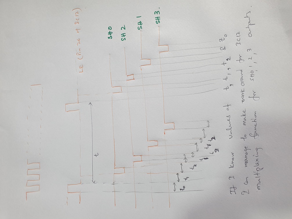

      There are two modes I can test my CLP-550 in:
      - One is a normal operation,
      - Another one is when you put the device in a test mode (A-1 + C7 + PowerOn, refer to the last two pages of the Service Manual), and then, according to SM, you can output the continuous tone, by pressing C0 or D0 or E0 keys (F0 stops the tone).
      In my case, I prefer the latter, as it gives me a consistent behavior.
      I think, the DAC chip IC13 is not working properly, as I can see all correct supplies (+12V, -12V) and input signals (CLK=3.2 MHz, Frame signal (aka Latch Enable or LE, and input serial data SDATA coming in), but there is no analogue output on the VOUT pin of the DAC. So, I have ordered the replacement, and will in a meantime continue the investigation, as I suspect that this DAC is not the only problem in my case.
      As for the signals SH0, SH1, SH2, SH3 that you have requested: They are all present in my piano, all the time, even when there is no serial data transmitted to the DAC. I will try to draw them below using ASCII art :-)))
      The waveforms below are digital signals, negative-going pulses, in the following order (from top to bottom): SH0, SH2, SH1, SH3:
      '''U'''''''''''''''''''''U''''''''''''''''''''' ... - SH0
      '''''''''U'''''''''''''''''''''U''''''''''''''' ... - SH2
      '''''''''''''''U'''''''''''''''''''''U''''''''' ... - SH1
      '''''''''''''''''''''U'''''''''''''''''''''U''' ... - SH3
      Looking at the schematics, those are just the MUX IC15/IC16 control signals, telling which stereo channel (Left or Right) the analogue DAC output should go to.
      I have also noted one possible discrepancy: in your picture (attached to the post #88) you show the EPROMS labelled (from left to right) A, B and C.
      However, throughout the course of this thread, I think the EEPROM name A corresponds to GEW ROM1 (IC8, XE843A00), EEPROM name B corresponds to GEW ROM2 (IC9, XE844A00) and the EEPROM name C corresponds to GEW ROM3 (IC10, XE845A00).
      If I am right just above, then you have ROMs A and C swapped around, as the ICs order on the board (as shown in your picture) are (from left to right) IC10, IC9, IC8, so they should be C,B,A.
      Could that be the reason why using the correctly programmed GEW ROMs didn't work in your case?
      Just a thought.

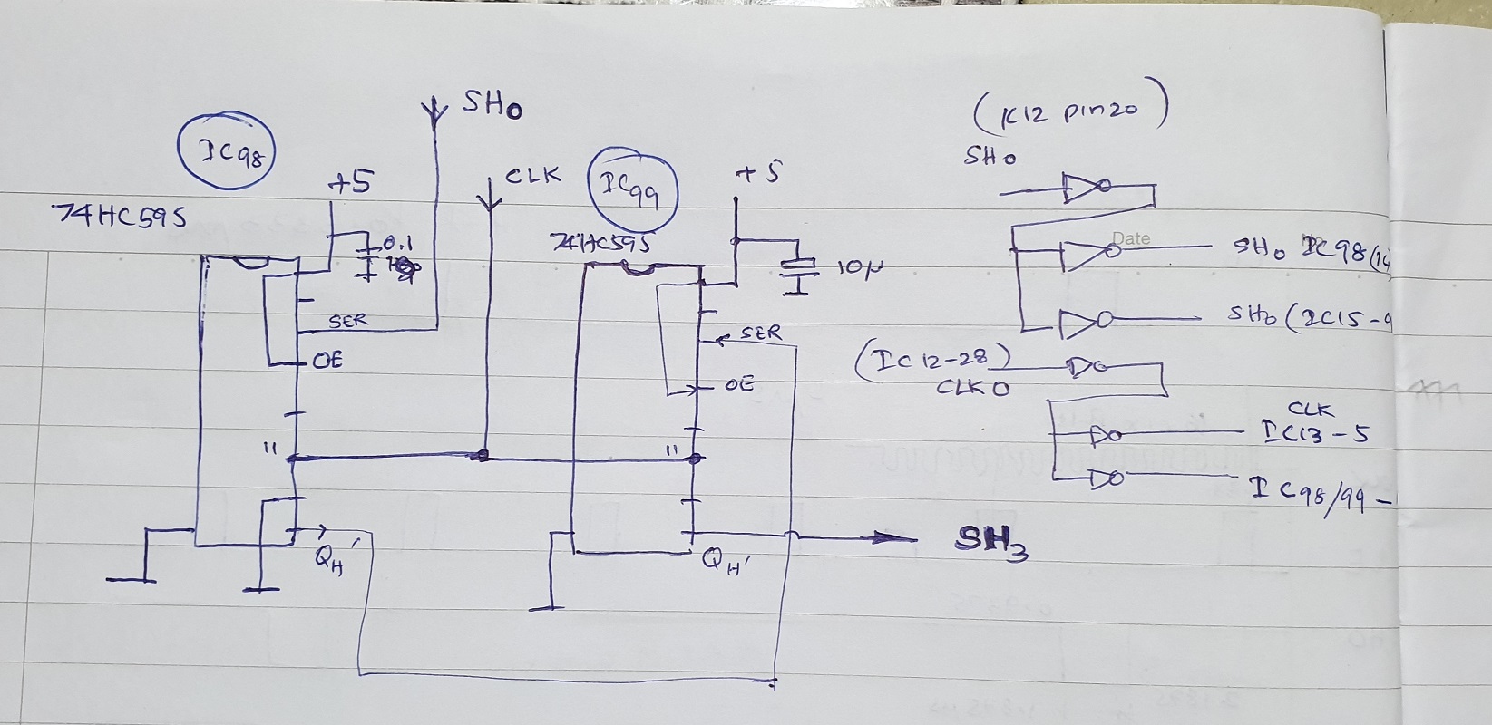

        DS,
        Thanks for your response. dont get wrong about the chip names A, B, C. i continue the previous peoples dump naming convention as i remember. but to avoid people get messed with, i have carefully name the attached files with chip name. IC number, ect. when refer the files, there wouldn't be any doubt as name correctly says what was the chip that file meant for.
        i know you were going through the very systematic approach to fault finding. i went through same, and some other too before and we all replaced the DAC without any improvement and wasted time, money and effort. finally everything went working, once ROMs are replaced. but me too loved to follow the way my gut feel guided and what observations suggested.
        as per your timing diagram for SH0,1,2,3 now i know my suspicion was correct as one output from IC12 not coming out and some information's of the stereo signal is not properly adding into output audio envelope. that must be the case for distorted sound output of my piano, except that rest of the systems working fine after ROM replacement.
        could you be able to tell me few more things about the SH0,1,2,3 pulses when next round you looked at. i sure that some sort of continuous serial clock pulse coming to IC12 continually via pin SYW or 0G or SO0 or SO1 even key pressed or not as you mentioned. as IC12 not available, im thinking to make program one small micro controller to do the pulse out function of SH0,1,2,3. if you can give me some timing details as attached diagram, i can make mine working back with add-on module. it will emit the missing pulse in-sync with others 3 outputs.

          Hi, PMD.
          I can do that, no problems, but if you are missing only one of the four signals SH0 to SH3 (btw, which one is that you are missing? Is it stuck low or high?), and three other signals are OK, you can easily figure out the missing channel timing. Here's how:
          Basically, there is one error in your hand sketch of the waveforms: The time gap between the pulse on SH3 and the SH0 is shown too long. In reality, all pulsewidths for SH0 to SH3 are exactly the same (you call them t2), and all the time gaps between the pulses (you call them t1) are also exactly the same, meaning that the time between the end of pulse at SH3 and the beginning of the next pulse at SH0 is also equal to t1.
          So if you can measure all three existing pulses, you can easily see where the missing fourth one should be located. It's a fully symmetrical and repetitive pattern.
          But, having said that, I am going to connect the 8-channel signal analyser to the DAC section, and will report the requested timings to you once I have the waveforms recorded. May not be today or tomorrow though.
          Looking at the schematics, I think SH* names stand for Sample-and-Hold, because those pulses just control the sort of S&H circuit formed by IC15/16 and the holding capacitors at their OZ and OY outputs. I haven't worked out the exact logic of its operation yet, but it is irrelevant in my case, because nothing comes out of my DAC analogue output anyway, and that's what I am going to concentrate on for now, thanks God I have an analyser and the Datasheet for the DAC chip.
          BTW, do we know what IC12 is and what it does? My search showed that it is a CPLD or FPGA of some kind. Yamaha proprietary, of course.
          Regarding the DAC replacement (irrelevance) : I hear you, but if all input signals are coming in and no output is coming out, that fact is hard to argue with. That's why I will be analysing the digital input protocol. Not that expensive to replace either - about six bucks. Not much for surely getting one big variable out of the equations! :-)

            Hi DS,
            Thanks for your inspiring inputs. im not in a hurry and take your time to do the next testing when you got DAC. SH should be sample and hold and IC15 & IC16 used to sample and hold also to eliminate switching and DA glitches as both Left & Right Audio channels decoded from single DAC. IC12 they marked as SFD-2( sequential frame decoder ???), but cant find SFD-1 anywhere. Yamaha seems using more than one 16bit packet for generate tones as IC14 used at DAC output as level controller with two bit control output from IC12 and according to 2bit inputs(A,B) IC14 deliver full, half, quarter or 1/8th of DAC output level based on SFD-2 command.
            SFD-2(IC-12) datasheet found from old publication from SANYO but not given the exact logics programmed into the gate array. i attached it here.
            as per your inputs i had figured the way i might produce the outputs of missing SH signals with remaining signals. even same principal can execute even 2 or 3 outputs of SH signals are not working as it purely time based signal as per you and present always even without any key pressed. cant workout if all the SH outputs not present as not knowing where to sync the particular SHx signal.
            hopes your repair would be successful and waiting to hear another success story soon!

                                I will go through my captured analyzer waveforms to see if i can extract the exact timing data for those SH* pulses relative to incoming clock. If I manage to get it out, I will post them here.
                                I got an impression somehow, that the exact clock position of your missing SH pulse is not that important, as long as it is located between the other two SH pulses with enough gaps, as we discussed above.
                                What I am coming to is that it should be possible in your case to re-create that missing pulse just using two monostables (74HC4538) - the first monostable (triggered by the previous SH pulse) will determine the offset of your re-created pulse, and the second monostable (triggered by the first one) will make the required SH "active-low" pulse. That'll be not as neat as a digital implementation, but I think in this case it should do the job just fine.
                                • ds2010
                                  • Oct 2016
                                  • 21
                                  • Russian Federation
                                  #116
                                  Re: Yamaha Electric Piano CLP550 no keyboard output
                                  Hey PMD,
                                  As I said, please find attached the waveforms of SH* signals relative to clock and DAC LE (Latch Enable). Some notes:
                                  The clock is 3MHz,
                                  The LE frequency is 200 KHz, pulsewidth is 0.333 uSec (1 clock period)
                                  The SH* pulse frequency is 50KHz, pulsewidth is 1.875uSec (6 clock periods)
                                  The gaps between SH* pulses are 3.125 uSec (10 clock periods).
                                  Look at the waveforms for further info.
                                  NOTE! See the correct sequence of SH* pulses in analyzer channel labels - I think I might have gotten their order wrong in my ASCII art before - the labels here are the correct ones.
                                  Once again, I don't think the exact location of the SH* pulse is critical, as long as it sits comfortably in between of two LE pulses, because the DAC analog output does not change between the LE pulses.
                                  Anyway, this should be enough to get you going. If you have any questions, I will be happy to answer.

                                    #117
                                    Hi DS,
                                    Congratulations on your success and Thanks for contribution to the forum! we have fully workable solution to the ROM related issues now!( except main ROM, we havent backup yet!).
                                    Thanks for the inputs and nice timing details on SH signals where i had struck for some days. i found very simple design to create missing SH3 signal. i replicate SH3 with reference to SH0 with 5uS delay using small basic uController and expected program was below 50lines of Assembly( fast and accurate timing). i too think SH pulse placement not that much matters but keep it at latter half of the window will be better as it gives enough time for DAC output to settle properly and had to give enough time in pulse width(low time) for sample hold cap to stable its charging and turn off the SH signal just before the next LE pulse to avoid glitches. with all constrains SHx need to sit in right slot and haven't have much tolerance to play on. thanks a lot for your inputs!!
                                    will update the forum once test done with source codes and diagrams, of course photos too. hopes to get the main ROM backup too.
                                    PMD

                                      #118
                                      Hi PMD,
                                      Oops, I have already closed back the piano and returned it to the owner, so I can't read out the main ROM. Actually, we don't even know what ROM part is used, as Yamaha gives a cryptic MAIN#2067 name to the main ROM IC. We can only guess by the number of address lines (17: A0 to A16) coming to that chip and by writing on its schematics symbol that it would be 1Mbit ROM (128K x 8) perhaps 27C1001, judging by the pin layout.
                                      If that's true, then it is much smaller transistor density of the dye, and therefore is not as prone to getting corrupted over time, as the technology is not pushed to its limits (we are talking mid 80s, remember)
                                      Desoldering the chip may exacerbate or even create the data corruption problem for it, with the risk of rendering the whole piano useless, as the good dump for it is not available.
                                      So, I guess, we have to ask people with the defunct piano (killed by the reasons not related to ROM data) to take out the main ROM from the corpse and read it.
                                      PMD, wrt your SH3 restoration exercise: using micro seems a bit of an overkill to me. I think I have a better solution for you: in fact, what you need to do is delay SH0 by 16 clock cycles by fifo pipelining it. Shift register 74HC595 is your answer! (a dozen a dime). You need two of those dasychained (each one shifts by 8 clocks). Feed your good SH0 signal to the serial input of the first one and take your SH3 from the QH' output of the second one, and you are all good! (CLK should be fed to both registers). No code development time, no code maintenance required! :-) Fun's spoiled! :-)))
                                      Have a look at those HC595 registers and tell me what you think. If you elect to go down that path and need help with the design, I'll be happy to offer it.

                                        #119
                                        Hi DS
                                        it seems your proposal is more practical, faster and accurate except one concern. i already got parts for construct it as well, but one question arises to my mind, whether we can tap the LE and SHx signals parallel from there existing usage points??. we have to drive some extra TTL loads at our new circuit. will the IC12 output work normally with extra loads in its outputs?, we might need some extra buffers to get this done? pls advice!
                                        i here attached a proposed design sketch. your inputs are welcome!!
                                        • ds2010
                                          • Oct 2016
                                          • 21
                                          #120
                                          Hi PMD,
                                          Well done. Here are my 5c worth:
                                          1) 74HC595 is not a TTL. It is CMOS, meaning that it presents virtually no load to the outputs of the driving ICs. So, I wouldn't even bother buffering the CLK and SH0, as the CLK frequency 3MHz is so low (relative to the dynamic capabilities of those ICs). So my first suggestion is to remove your buffer inverter and connect SH0 (pin20/IC12) directly to SER (Pin14/IC98), and connect CLK0 (Pin28/IC12) directly to both SRCLK pins (Pin11/IC98 and Pin11/IC99). You should be fine with those very marginal extra loads.
                                          2) Unused inputs:
                                          /OE pins (pin13/IC98 and pin13/IC99) are pulled up - that's correct.
                                          RCLK pins (pin12/IC98 and pin12/IC99) should both be pulled down (to GND)
                                          /SRCLR pins (pin11/IC98 and pin11/IC99) should both be pulled up (to +5V). Hard pull up (with wires, rather than resistors) is acceptable.
                                          All eight parallel outputs (Qa to Qh) should be left unconnected.
                                          3) Before connecting the new SH3 output of your daughter board to Pin10/IC16, I would disconnect that pin from the driver output (pin18/IC12).
                                          This is to avoid multiple drives of that net, in case pin18/IC12 still drives hard that line permanently low (as you wrote before).
                                          I guess, you probably can cut that pin (pin10/IC16) right at the PCB level and then (carefully!) lift it to be able to then solder to it.
                                          DO NOT CUT IT NEXT TO THE BODY OF IC16 (or you will have nothing to solder to!)
                                          WHEN LIFTING, DO THAT EXTREMELY SLOWLY AND ONLY MOVE IT BY 2-3mm JUST TO DISCONNECT IT FROM THE PAD! BE CAREFUL NOT TO BREAK THAT PIN!
                                          (Note: cutting off the pin18/IC12 instead might not work, as the pulldown short/drive may be in the PCB, not necessarily coming from IC12)
                                          You may elect to do the above disconnection in a different way (for example, cutting the track) - it's up to you.
                                          I would also check first that the SH3 output of your daughter board is as expected before connecting it to Pin10/IC16. Do you have a CRO?
                                          Good luck and let us know how it goes!...
                                          Best,
                                          DS
