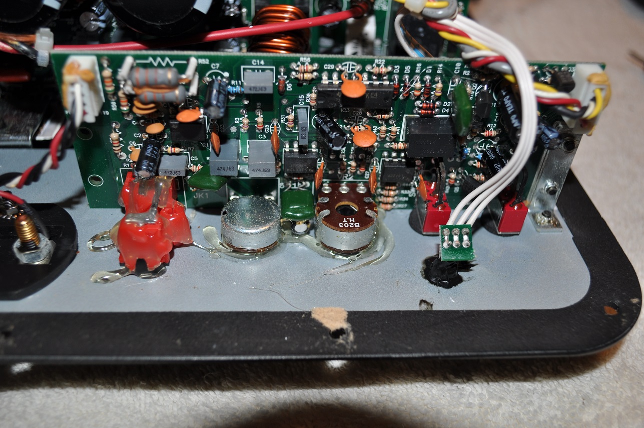

    I recently got a sub off of a friend and am attempting to repair for him. I do not have much experience with these at all. Symptoms were no power on. When I first took it apart 3 of the capacitors where obviously bulged so I though here is the problem. Replaced all three and it still will not power on. I did check the main fuse its good. It appears to have voltage going into the large transformer but I can not detect DC voltage anywhere on the board. Any ideas where to start?

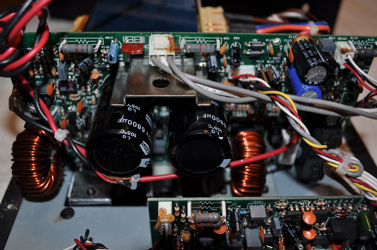

        Re: Axiom EP 350 Powered Sub
        budm sorry I missed you post I will test those points. Upon another look at the psu board I found what looks like a blown out cap. I attached a picture of the same type of cap that is blown out. It is a polyester type. Can I substitute a diff cap with the same values? 0.1uf 100v

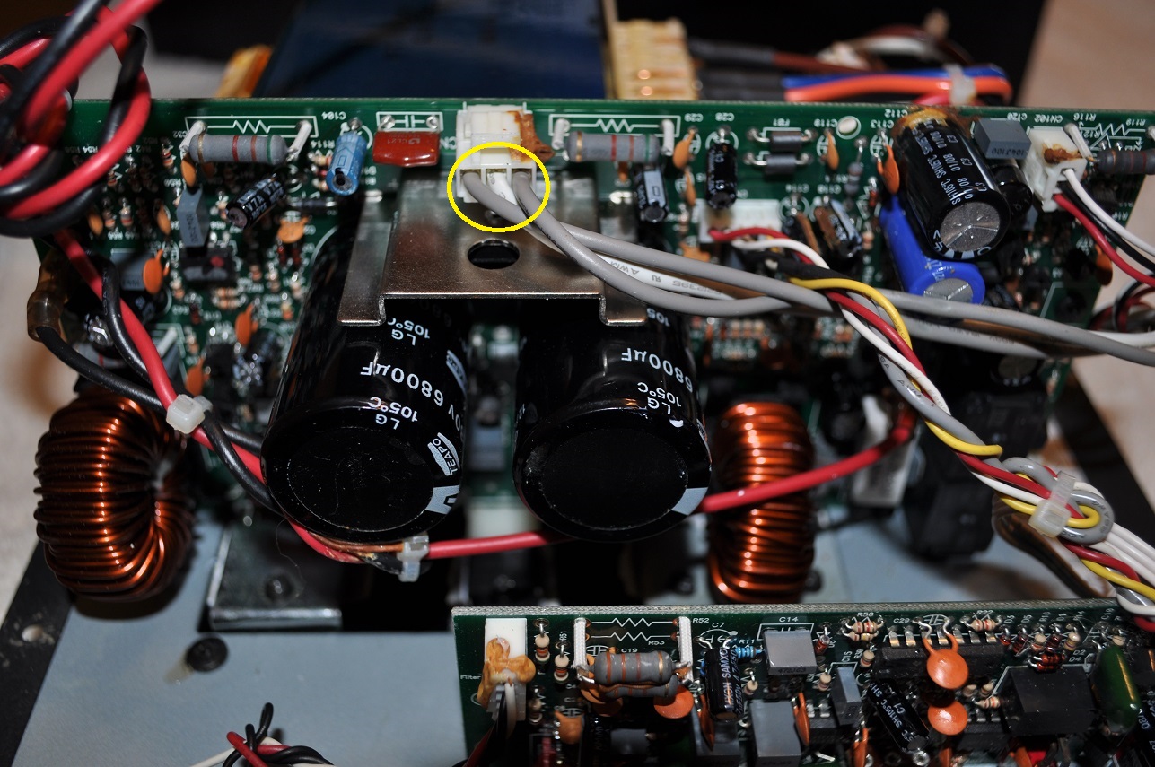

          budm, Yes I am testing 44vac on all three leads of the connector circled. changed the additional bad cap and it still does not power on.
            44VAC between grey and white wire? if that is the case, the transformer is 88VAC with center tap, so the DC voltage of each one of those two big filter caps should be around 60VDC.

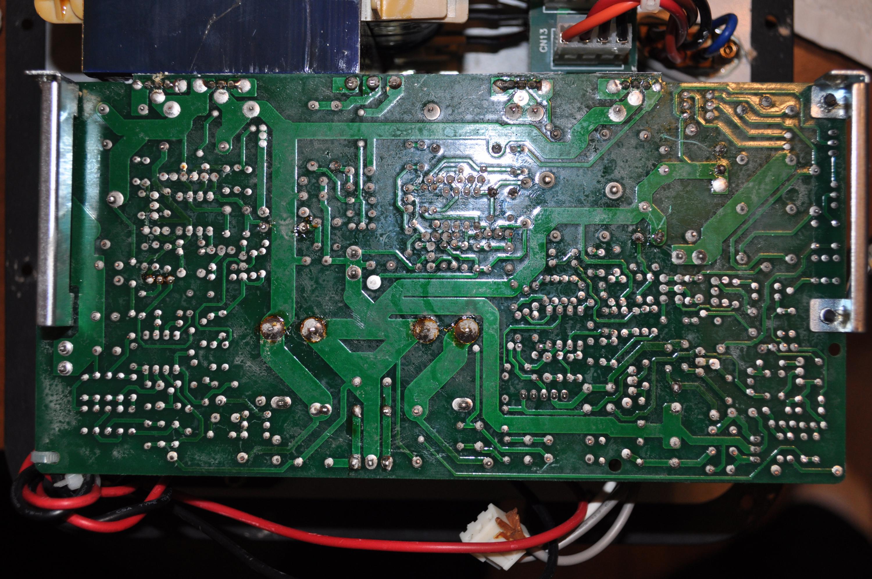

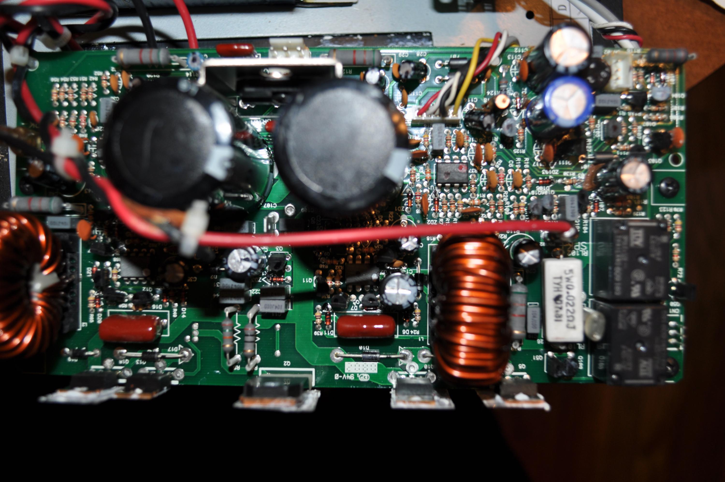

            Can we also see the bottom side of that power supply/power amp board so we can see the bridge rectifier that is fed by the transformer.
              Here you go

                I may have been testing incorrectly. If I test for Ac voltage at the connector on the power board from grey to white there is no voltage present. In the earlier test I was using the white lead where the AC comes from the power cord as the other side.

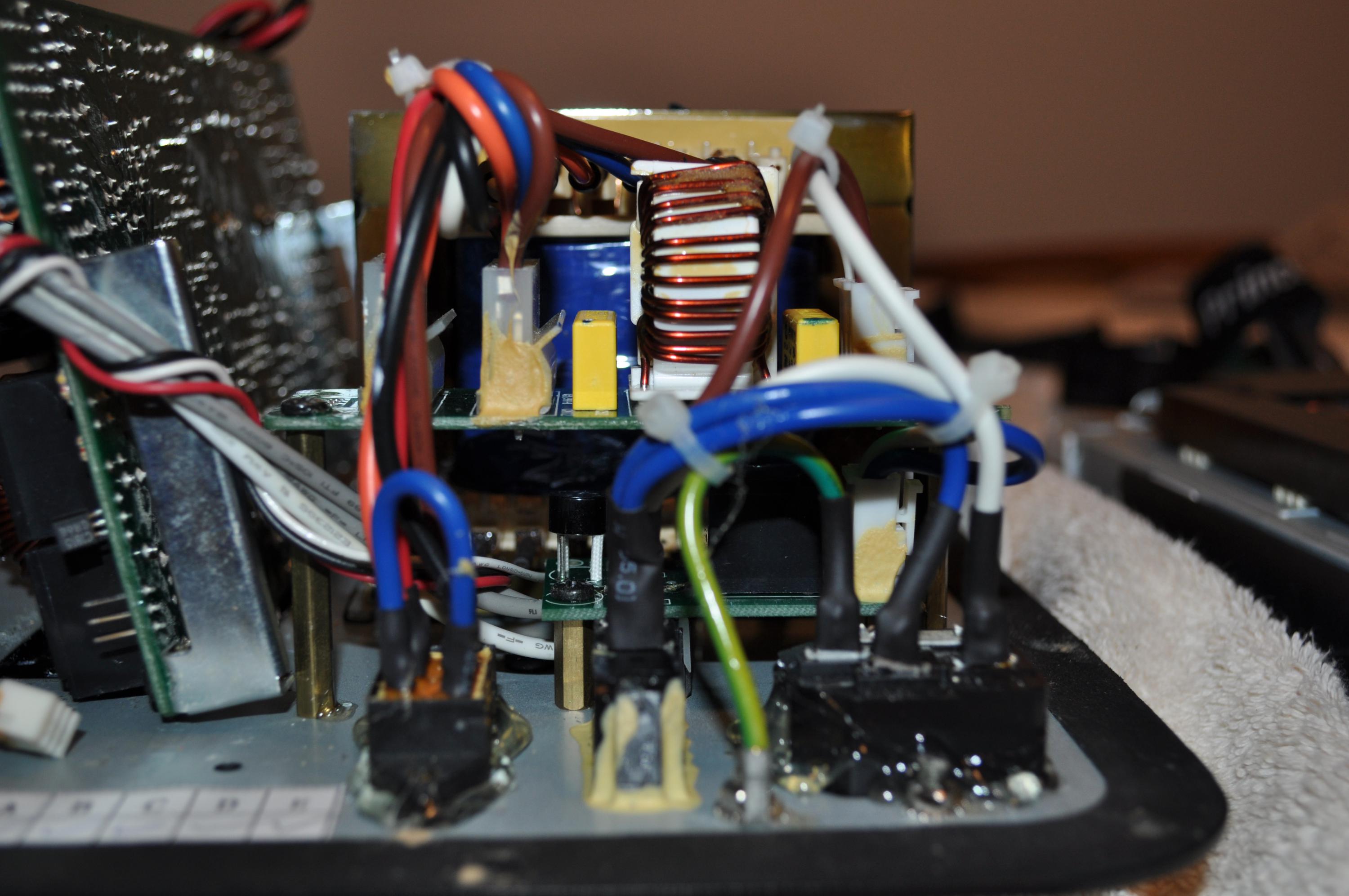

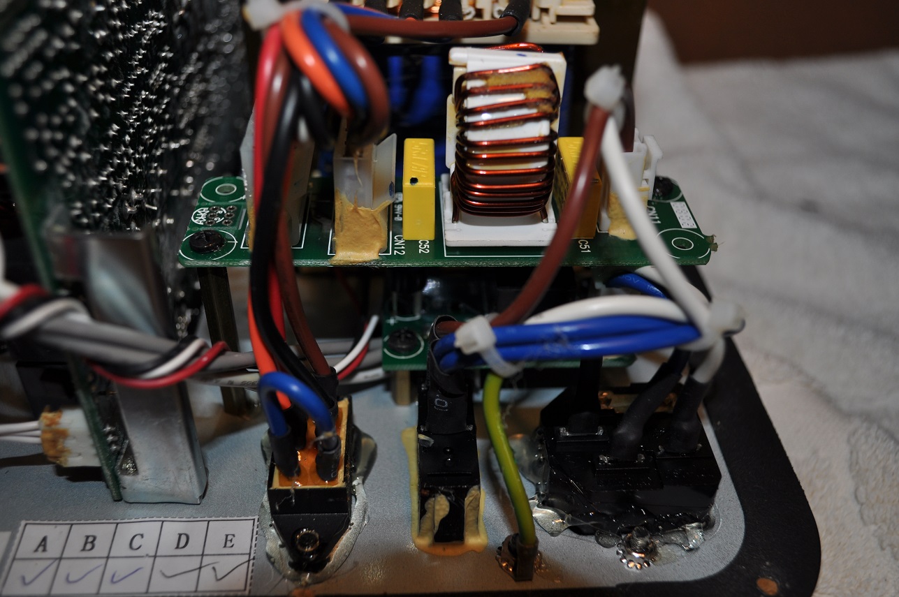

                      More pics

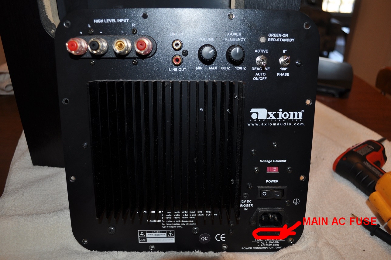

                        See post 9 for the main AC fuse location.
                        The AC readings on post 10 are not right at all.
                          OK tested fuse first its good. I then used the power cord with switch on between the flat leads it appears open 30meg ohms.
                            That means we have open primary windings which I do not believe it is since it has dual 120V windings connected in parallel for 120V input. Need to trace out the resistance from the AC input jack to the primary windings to see where the open circuit is, also make sure the power switch is OK.
