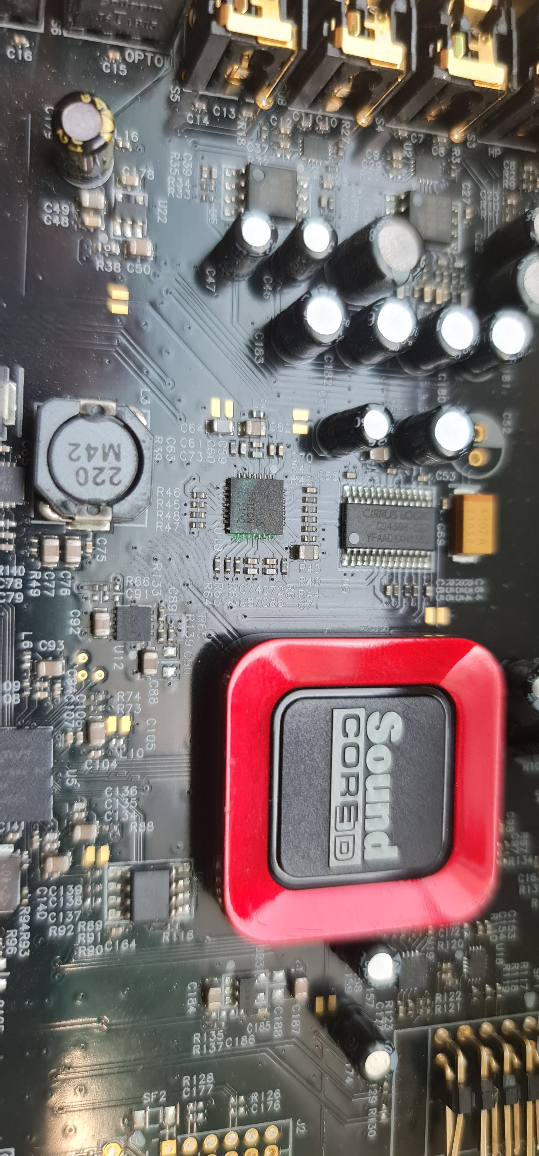

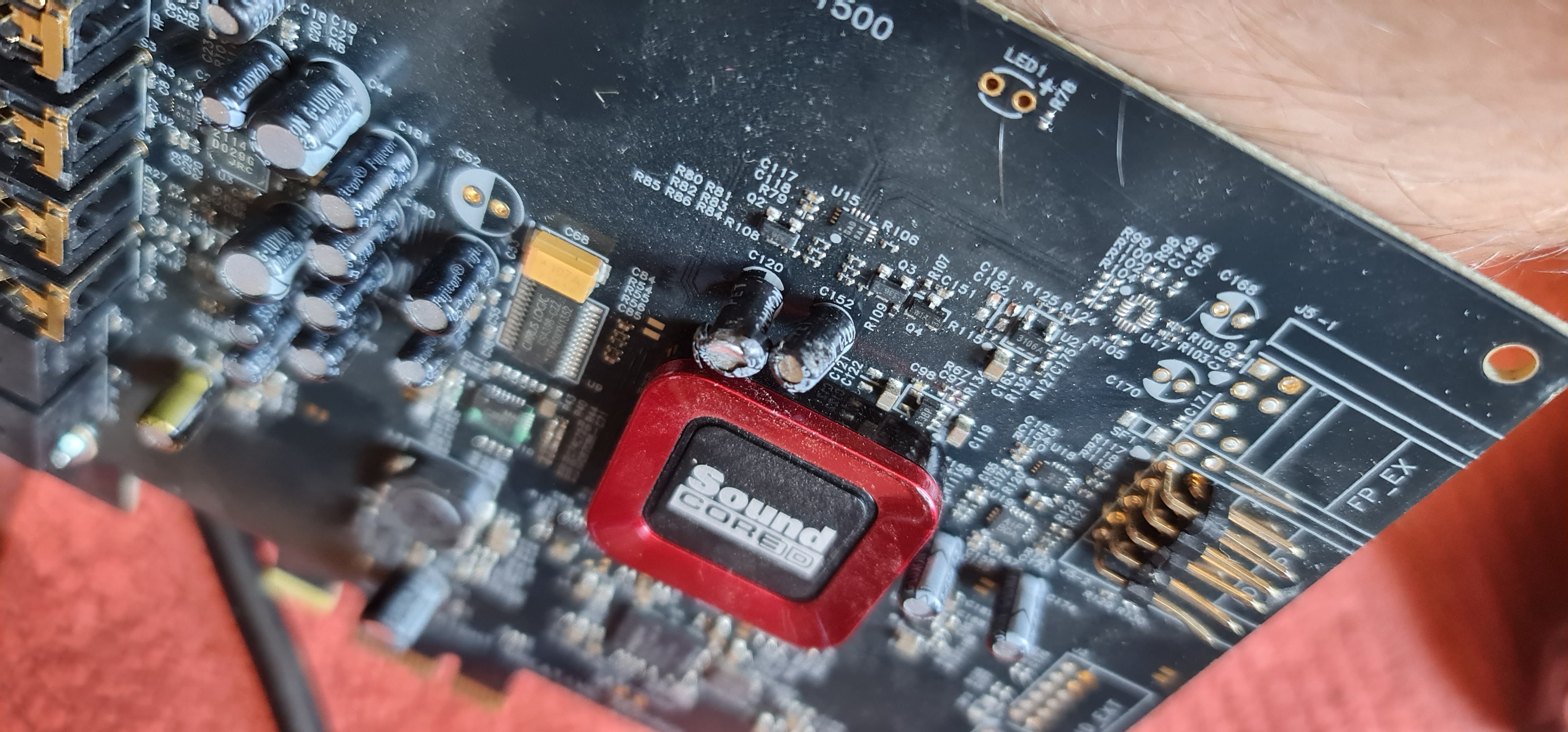

    Hi guys.
    I ordered the used sound card, but I got scammed.
    clearly these caps are probably in bad condition and need replacement How can I check them?
    It is the sound blaster Z SE sound card.
    And the bottom part is a lot scratched.

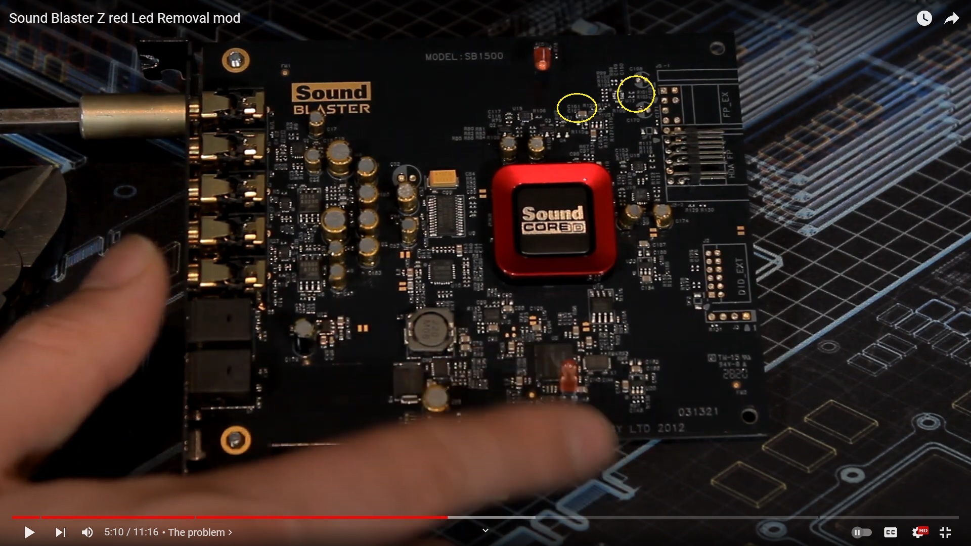

    That card looks in bad shape, I suspect the two capacitors are working fine it is just their cover that is damaged, I did notice other components that seem to be missing like C161, R101, R103 and maybe others, I took this image from a video
    If you look close at those solder pads you can see that there were components there at one time and were broken off, I would look closely at the rest of this board as there are likely more missing components, and I suspect the card may have been defective before it had this damage.
    After a closer look at the rear picture it sure looks like there are cut traces.

      So yeah, googled and figured out.
      The one is showing very low resistance which means its bad.
      I wonder if the card would work properly without it, since I don't have replacement one.
        • 21441
        I`d replace all of them as they`re G.LUXON and Fujicon . Whats the green stuff on the chip ,is it corrosion
          Dunno...it was on chip (I removed it) and it is on pins.Want me to picture it close?

                    If any of those scratches have cut through a track that will need repairing. There might or might not be a corroded via under the chip, you can look at the opposite side of board,dead opposite,if there are any vias there then the chip would need desoldering to see how bad the damage is. If you can clean up around the chip and it looks ok use some caps with a higher rating,just for testing, if it works ok order the right ones.

                                    Yep, C161 missing, good job, ah I guess I will throw it in garbage.

                                      Traces on the back of the card looks OK-enough to me. Scratched a little - yes... but doesn't looks like the scratches are that deep to have cut them. Could/should check for yourself, of course. However, I suspect none are that deep. Also, most of them look repairable.
                                      That said, did you try the card out in a PC? At worst, it just shouldn't work. At best, it could be working OK.
