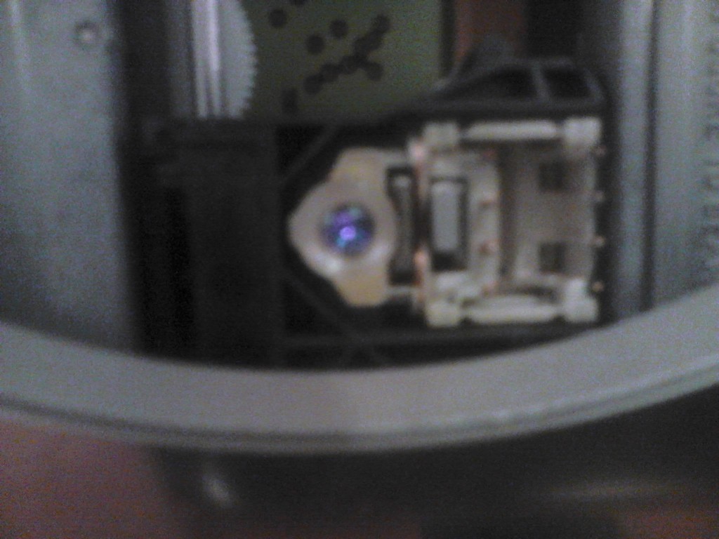

    Hi to all in this forum.
    I have in hands a B&O Overture that CD wont spin.
    Have clean laser and diode.
    Have made the tests with service mode.
    1- test focus (i can see light with camera)
    2 - off
    3 - Spin clockwise (ok)
    4 - Stops
    5 - Moves laser (ok)
    Changed caps on mech board all 6.
    Any ideia????

          Does the CD spin several times and device try to read it, or do you only get a single spin and single blink from laser.
          I'm thinking maybe the laser is going weak/bad.

            Re: Beosound Overture CD wont spin some help
            Hi
            Just changed today the laser.
            Now it spins you can hear the laser moves but stops spining.
            Like the laser did´t found focus.
            Did not change any ajustment. Just Caps
              When you say the laser moves, do you mean that the entire laser asembly module moves too, or just the laser lens?
              • irep
                • Oct 2013
                • 40
                • portugal
                the entire assembly tries to focus the cd spin then stops
                  What i´ve check is the service manual that i have the board that controls CD and adjustments are diferente, can´t find resistor that ajusts current to laser it should be on board nº8.
                  But there there is no resistors ajustments.
                  The manual says that when you change the laser that´s the first thing to do, or CD will spin and stops because exceeds 25mv.
                  Help in this isssue. Please
                    Maybe the adjustable resistor was moved on the laser assembly? Or see if they just bypassed the adjustable resistor with regular resistors.
                    Other than that, you may have to find the driver for the diode yourself and mod the circuit yourself to adjust the laser current. Probably not easy to do, though.
                      I beleve that should be another service manual for a futher modification model, or the new laser that bought is´t the right.
                      I´ve read in other foruns that B&O made several lasers and board control and all diferent, mine is one from 1995 that i changed the caps.
                      i ask, could it be also the caps? i´ve put normal caps and the ones that came on original board was smd, but i dont beleve that was the problem.
