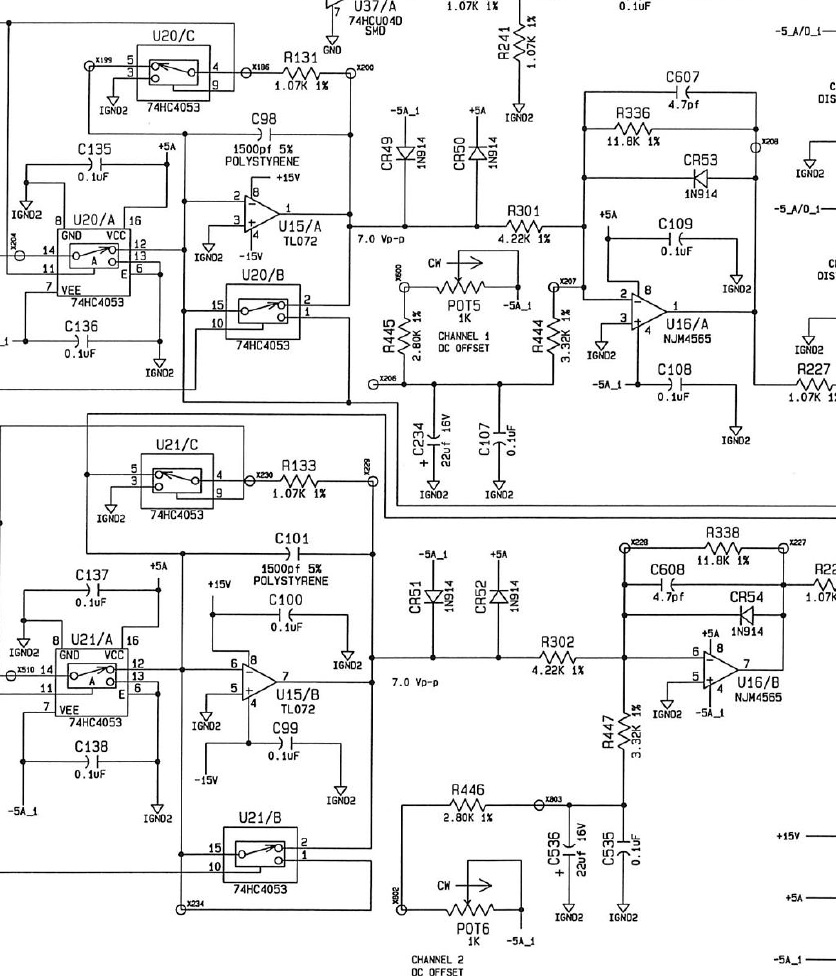

    hi,
    I'm new this forum but hope to add my insights and contribute in respect of Samplers and Loewe TVs

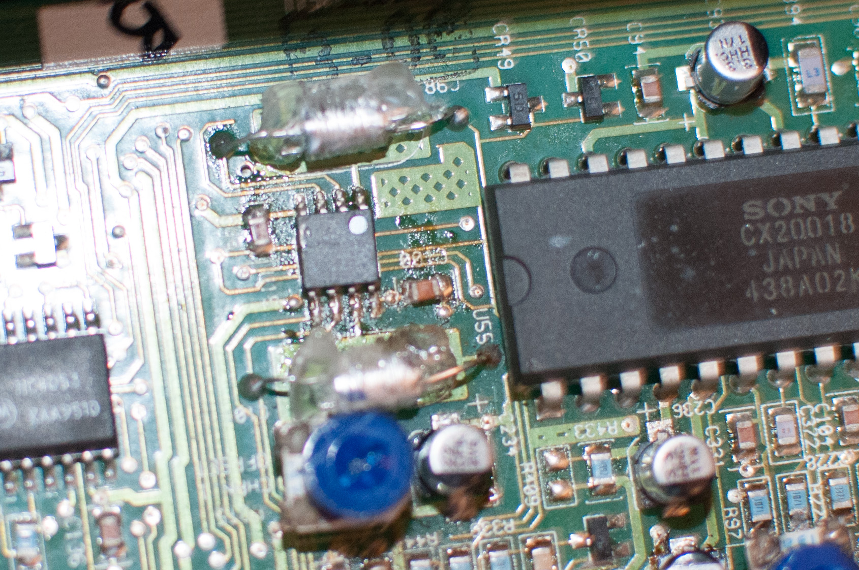

    My present problem is related to a TL072 OP-Amp on an Ensoniq DP4+ FX rack. I am getting a 'Bad DC offset' message on boot up and indeed the DC is not zero across the op-amp. This is causing feedback across channel 1 and noise.
    I have recapped the Alu-Cap and also swapped out two SMD 0.1uf caps, but neither of those components seems to be the issue and I wonder if it is a bad Op-Amp.
    I attach a photograph of the circuit board and also the schematic.
    Any pointers would be gratefully received.

              Re: Bad DC Offset TL072 Op-amp
              In the pic I don't see the TL072's pins 5-8 soldered well, can you touch that up. It's a $0.72 part so instead of swapping them, I would just replace it before the PCB tracks get damaged.
              Did you notice the trimpot labelled offset? Sometimes things drift with age and you just have to recalibrate. It looks like it runs to pins 5-6.
              The DC could be upstream of the op-amp, but I'm not sure what the cct looks like.
                Hi, I have already re-seated the tl072 and also cleaned the pads underneath. There is a trimpot for the offset but it does not make any difference. The troublesome tl072 is also running very hot compared to the others, too hot to touch. Prior to the op-amp there are inverted audio streams (balanced audio) and there some alu caps on the way but i have replaced those.
                There is some further history to this board. It looks like someone, stateside tried to swap out a converter on the output and the blew off a transistor and caused irregularities on the voltage regulators. There was track damage near where the output converter had been removed, i have fixed all of that and I can now get audio from ch3/4 but there is noise on ch1.

                        here you go.
                        Just be reading an article regarding oscillation and this does some to be the likely problem. But i can't see that the 0.1uf ceramic caps are at fault. Could it be the film caps?

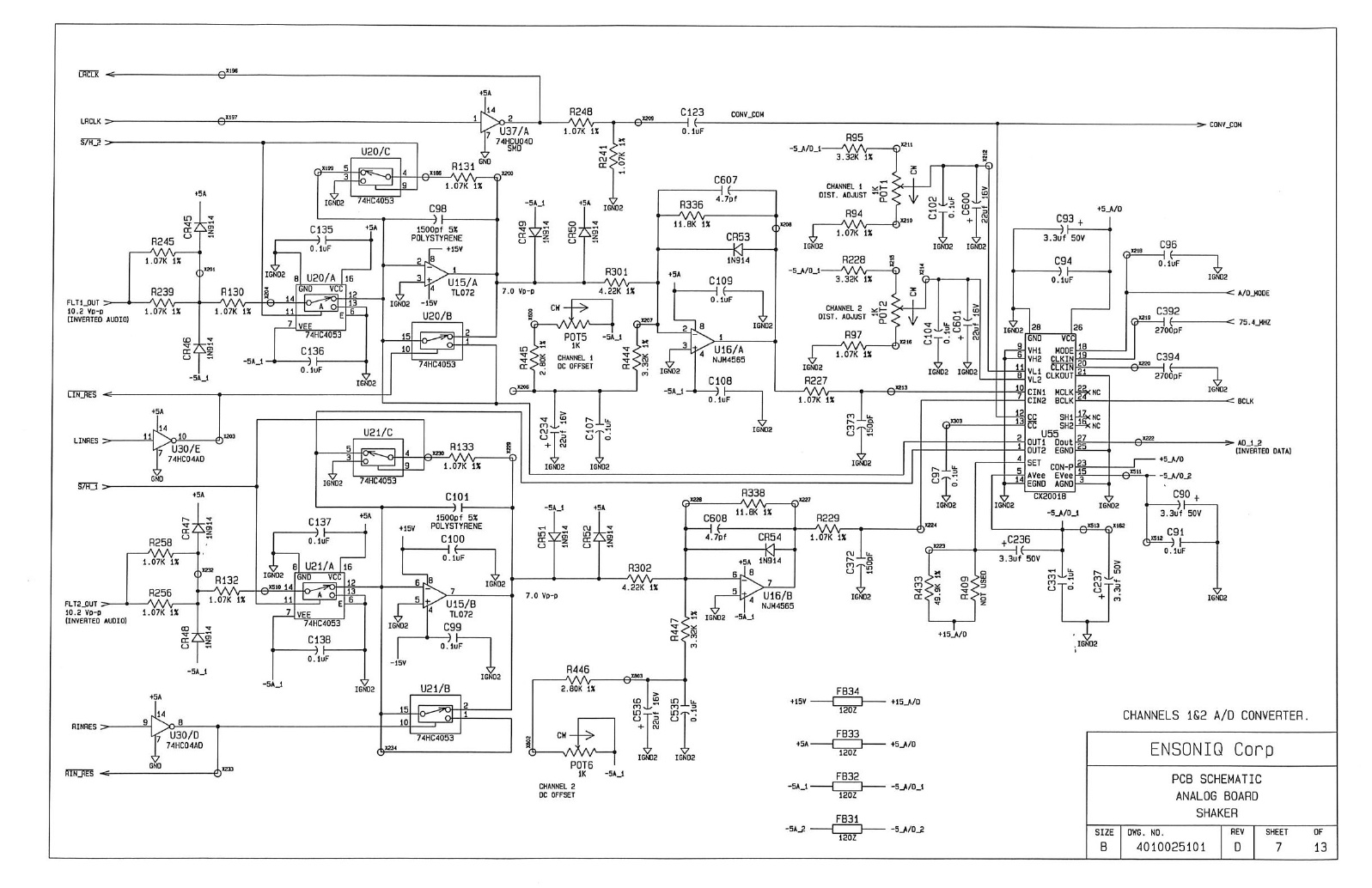

                          the entire schematic is here:
                            Thanks for posting the schematic, that makes it much easier.
                            Note the dual PSU voltages involved: +/-5V and +/-15V. Can you measure those, especially after seeing someone else was in there.
                            *If the TL072 outputs (offset) ever goes over +/-5.7V, it will dump current into the 5V rails and get hot (because it runs off +/-15V). I'm saying a good op-amp would heat up then. It might move the 5V rail too.
                            Possible reasons for too much offset would be:
                            Damaged op-amp TL072
                            CMOS switch IC 74HC4053 is no good
                            ADC IC current output1 has too much offset
                            The TL072 (in-) pin2/6 should be 0V, it is a summing point for many signals. If it's even +/- 0.005V the op-amp will have many volts of offset on its output.
                            I hope some of this helps. I'm not sure how far you can troubleshoot with a multimeter. The ADC normally runs warm.
