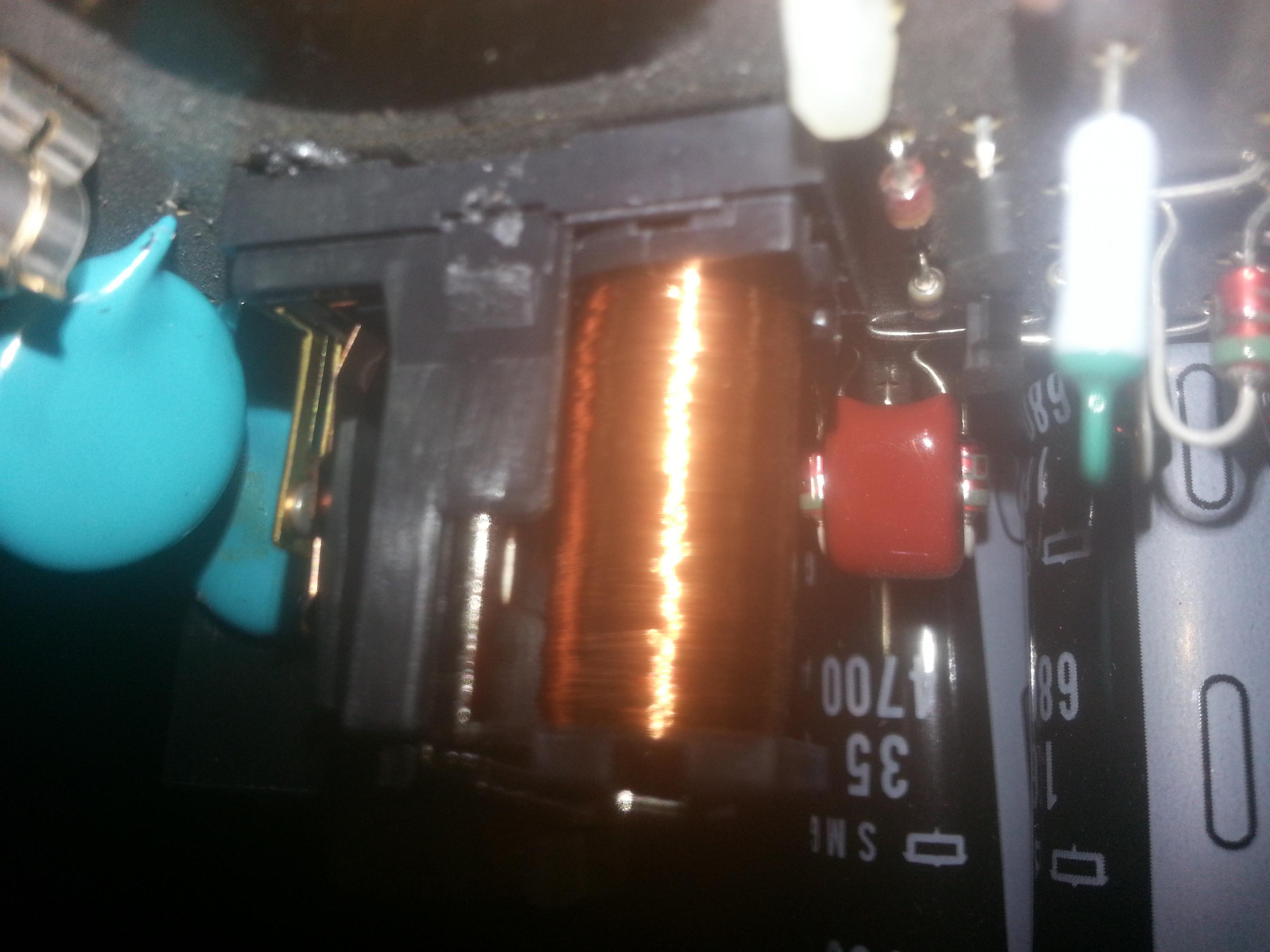

    Re: Denon 3808 - No Display / Audio Output
    Originally posted by tom66
    Could just be dust. Also be wary of some meters with continuity. Often show it for far higher than you expect. Retiredcaps says some do it at up to 1,800 ohms!
    Wow! Definitely not dust, unit actually looks brand new! That coloration you see is definitely internally, not on the exterior. Thinks i'll just replace it to be on the safe side, whats a few bucks lol

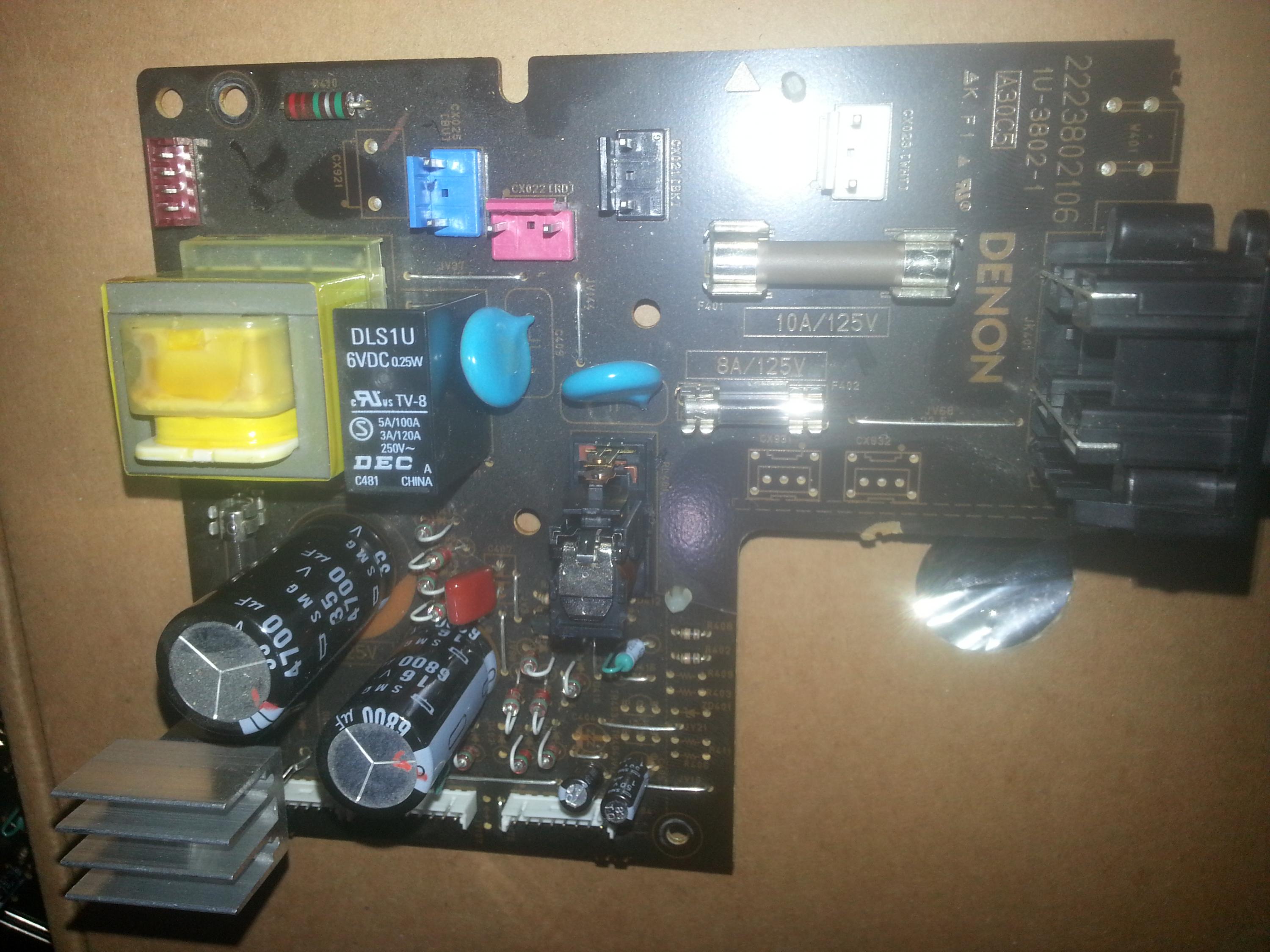

            Alright, first off, thanks again for all your help thus far.
            I was finally able to pull out the main power board (what a PITA!) to get to the relay. I've removed the top cover of the relay to make it easier to see what's going on. This is RL401.
            I'll work on bypassing it, just wondering if there's a different way to test the relay? Once it's bypassed, due to the intricate design, I am thinking I'll have to completely reassemble to test.. blah!
            Once again, I apologise for the poor pictures. I should have my DSLR back any day now.

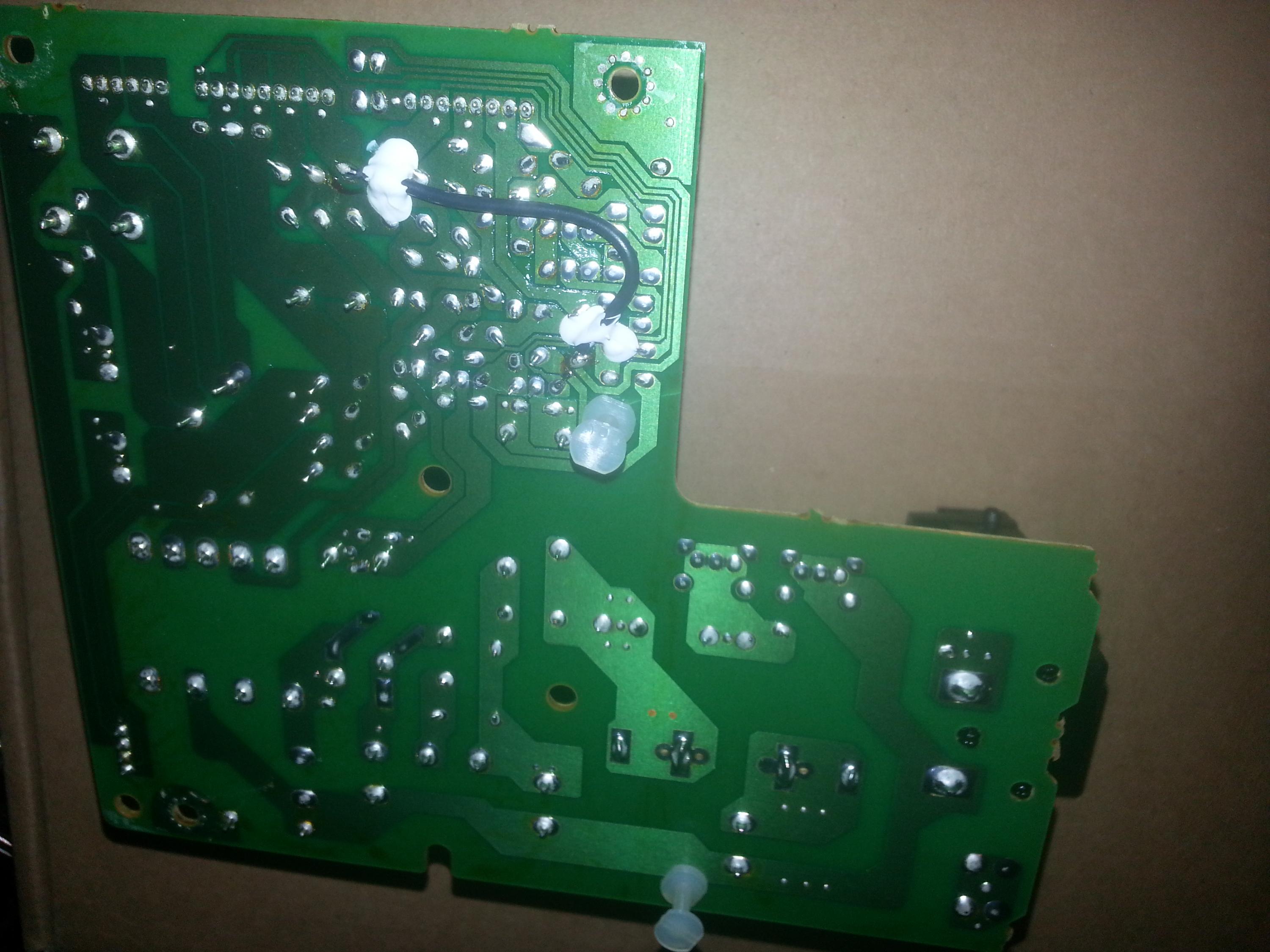

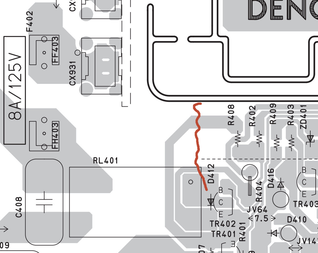

                    #29
                    Update, visually inspected the board more. There is a very small and minor hairline crack (indicated by the line in my picture) that went right through the relay (RL401) and D412. Likely from the dismal drop.
                    Relay pulled out of circuit, the board still showed a circuit.
                    Remove diode D412, tested, and it tested bad. With D412 removed, the board does not show circuit across RL401, where it previosly (and shouldn't) have had a circuit.
                    Testing the few other parts in circuit, but I am hopeful!

                      #30
                      Is it a DLS1U like the one in the picture - if so, shouldnt you be testing with 6 volts?

                        #31
                        Same exact one. Yes, definitely 6 volts, but all I had was 8.. and was frustrated
                          #32
                          Well, for some reason the relay isn't being triggered. Check R402, and the diode across the coil.
                          Edit: NVM, saw your above post.
