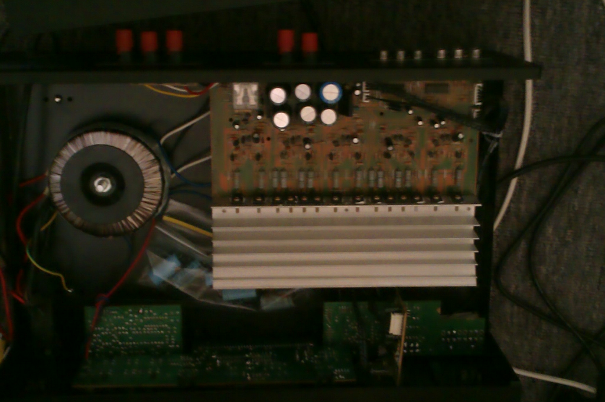

                    • Amraks
                      • Nov 2011
                      • 725
                      Re: Harman HA-7.1hd(stuck on the same volume)
                      sorry for photo quality.
                      I need to invest in a new camera some time.
                      • gilly1984
                        • Jun 2012
                        • 751
                        That certainly is not a harmon kardon amp lol.
                        That looks like very poor quality, i bet its not even dts or dolby digital. Most likely just dsp to make it feel like surround sound.
                        Also looks like 5.1, not 7.1.
                        Can I have a pic of the front and the back. Interested to see what it looks like.
                        Hope you didnt pay much for it
                          What's that plastic bag at the bottom of amp? Looks like spare capacitors???
                          BTW, as "good" as Harmon Kardon sound, there are a lot of poor component choices in them leading to early failure, in particular poor quality caps.
                          I see 14 transistors, there are two per channel, so it is a 7 channel amplifier most likely.
                          • gilly1984
                            • Jun 2012
                            • 751
                            You get technical by counting transistors so are probably right. I just counted speaker terminals Lol.
                            surely harman kardan amps have more components than that. I imagine this is just like one of them akura receivers off eBay that claims to be 600/1200w.
                            still interested in some more pics though.

                              • Amraks
                                • Nov 2011
                                • 725
                                Those are the old capacitors I have put in a bag, just not throwing them out until I show the customer what his bad caps were doing.
                                I didn't pay for the amp it was out of the back of a van scam apparently.
                                Its actually a 5 channel amp. front L/R, C, Rear L/R.
                                The lightest home theater amp I have picked up.
                                I'm unsure why the center speakers and rears aren't turning down on the main volume control. when I turn these down with there individual controls they turn down.
                                I will post more pictures when my phone charges up.
