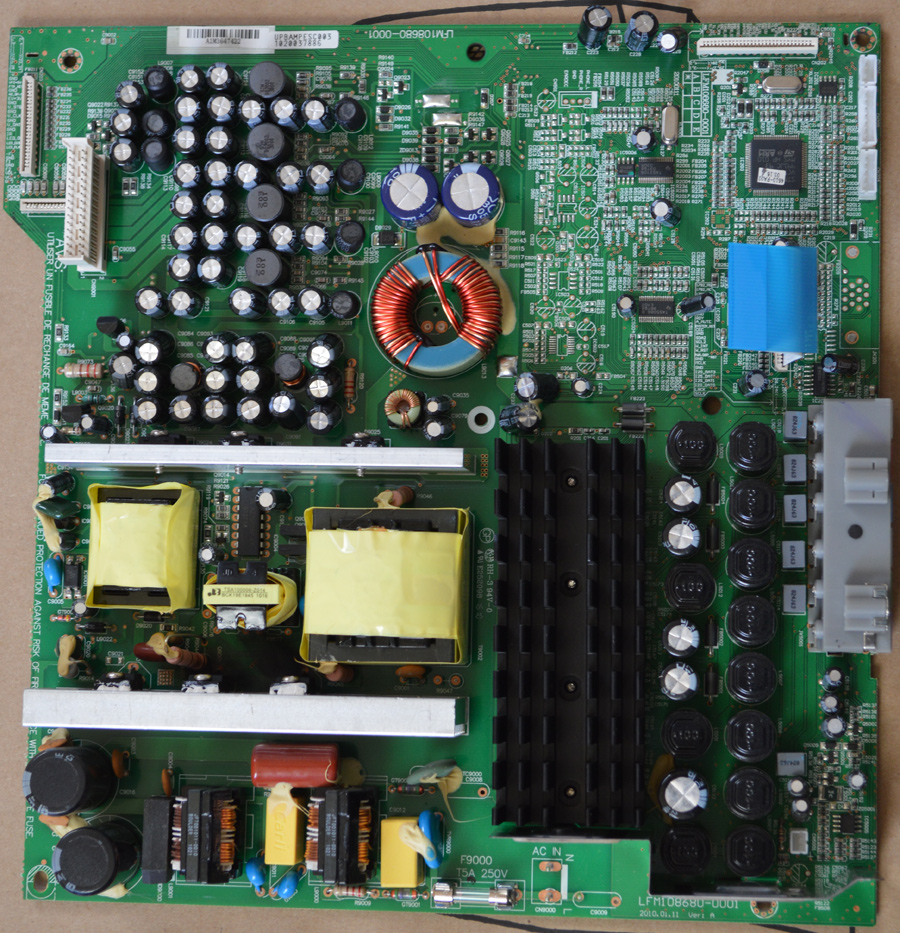

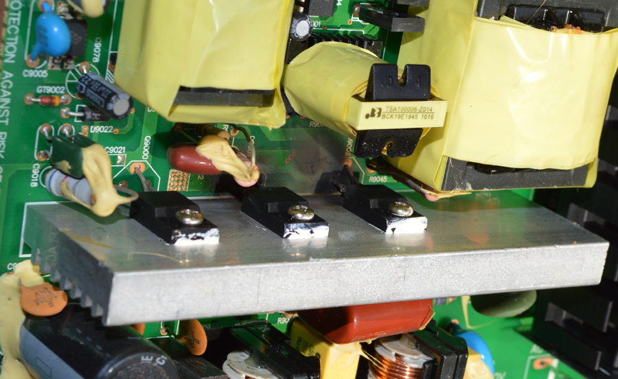

    Would not power on, replaced fuze and plugged in and 2 of the 6 resisters/rectifiers(?) mounted to the aluminum heatsink instantly burned up. Looks like they are marked as FMXG22.
    If I replace these what are the odds it will function, or could there be other possible damage?
    I searched for that exact model number and came up with squat, is there any other way to properly identify without schematics?
    Thank you for your time.

    If the original fuse was blown you should have done some tests before just replacing. It is a bit odd it didnt just blow again- did you use correct size.
    There is quite a bit of yellow/brown glue which may also be shorting try and remove it all.
    Can find any FMX-G22 to buy but here is the datasheet
    http://www.alldatasheet.com/datashee...N/FMX-G22.html
    If you get the main characteristics you should be able to find something similar.

      Is this what you are looking for?
      http://elektrotanya.com/philips_hts3.../download.html
